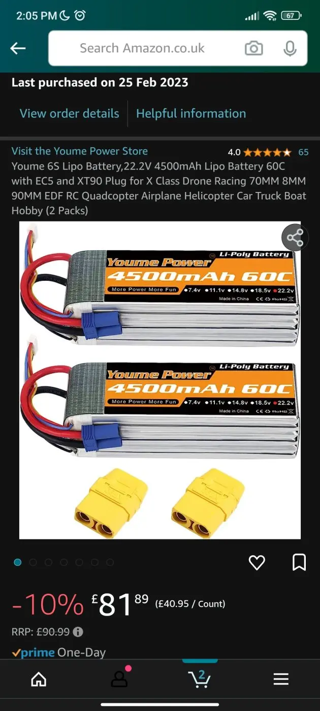

I use these and really like them, they went down to £72 during prime day tooIn the UK, the 6S 4500 hardcase Gens is about £85 - so far from cheap.
