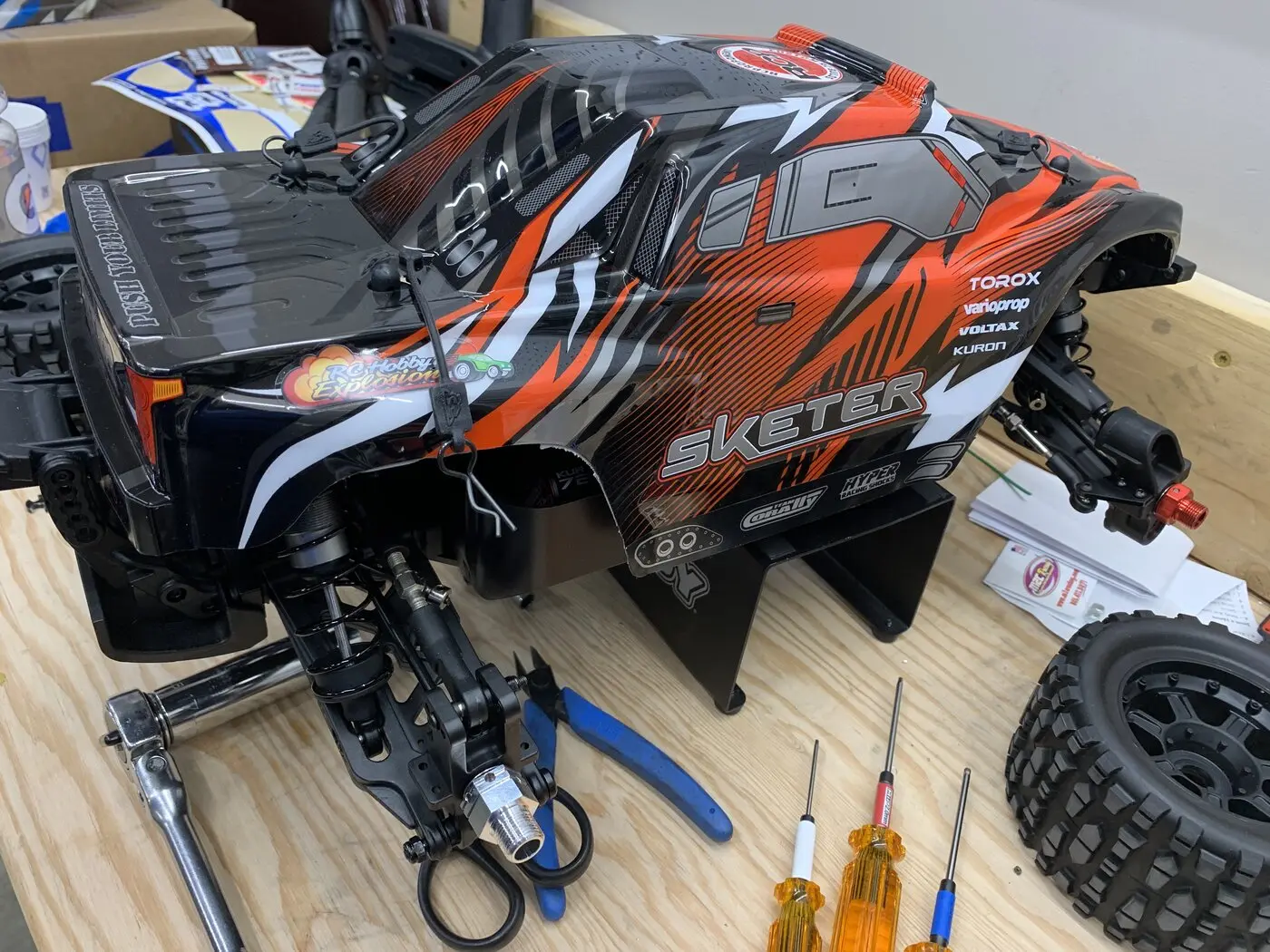

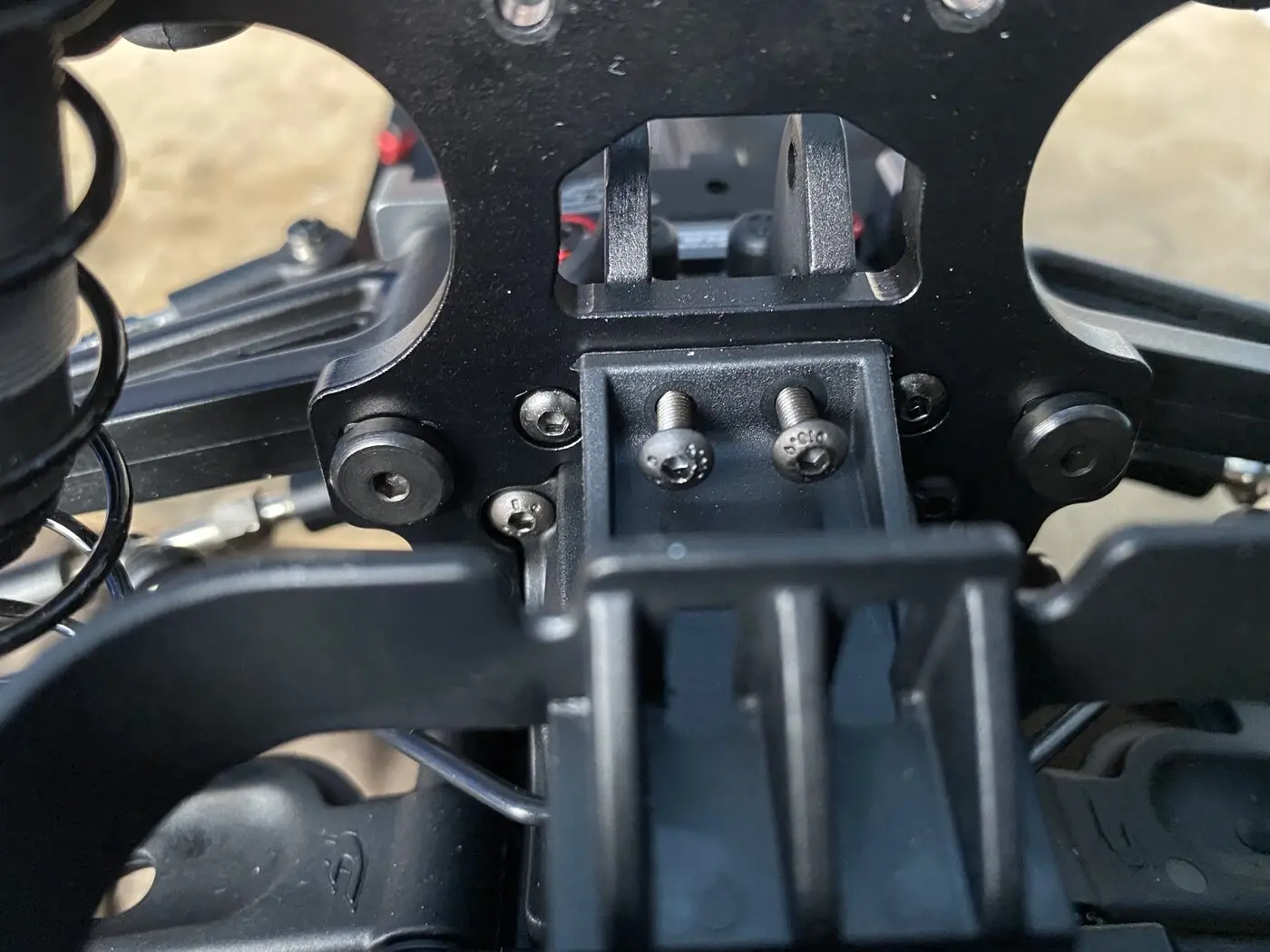

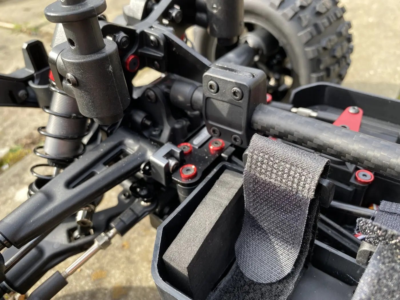

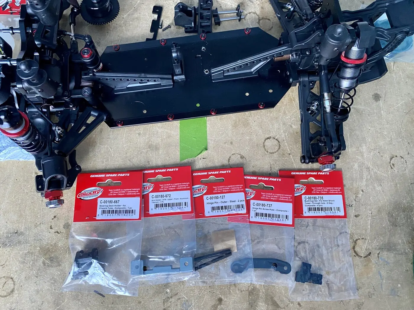

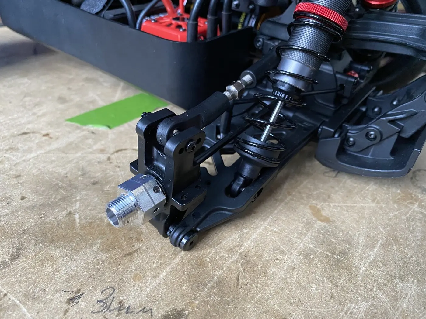

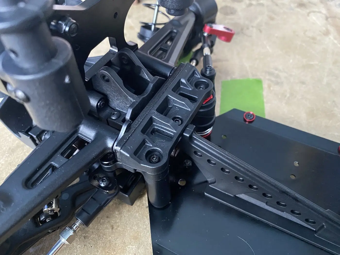

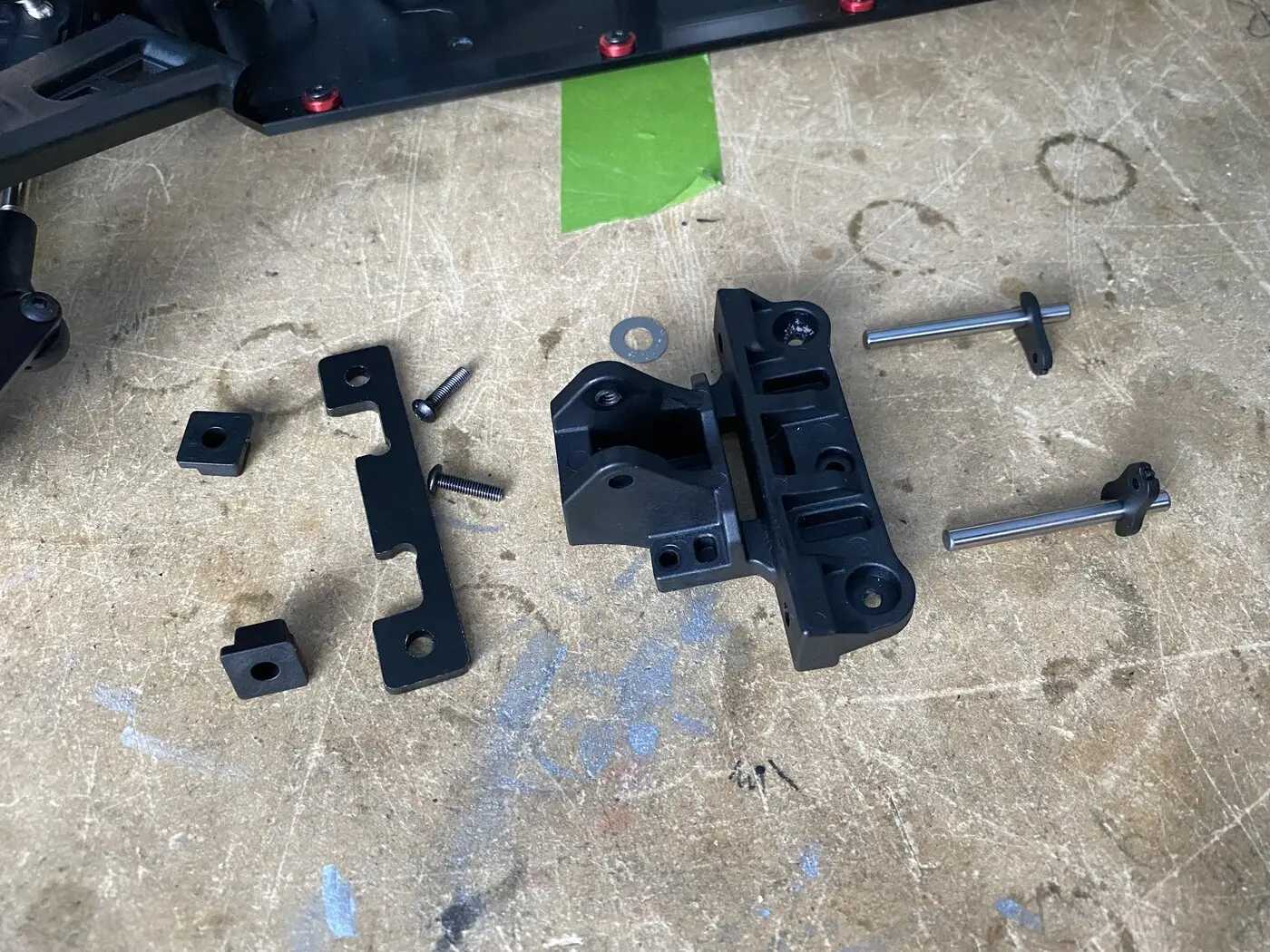

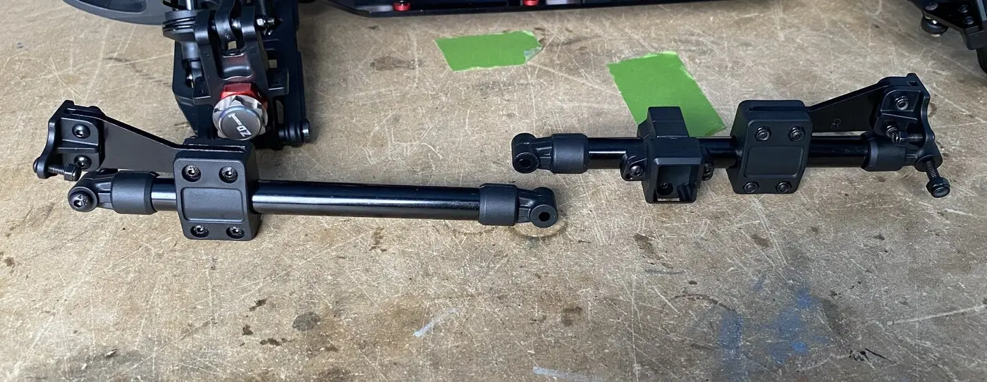

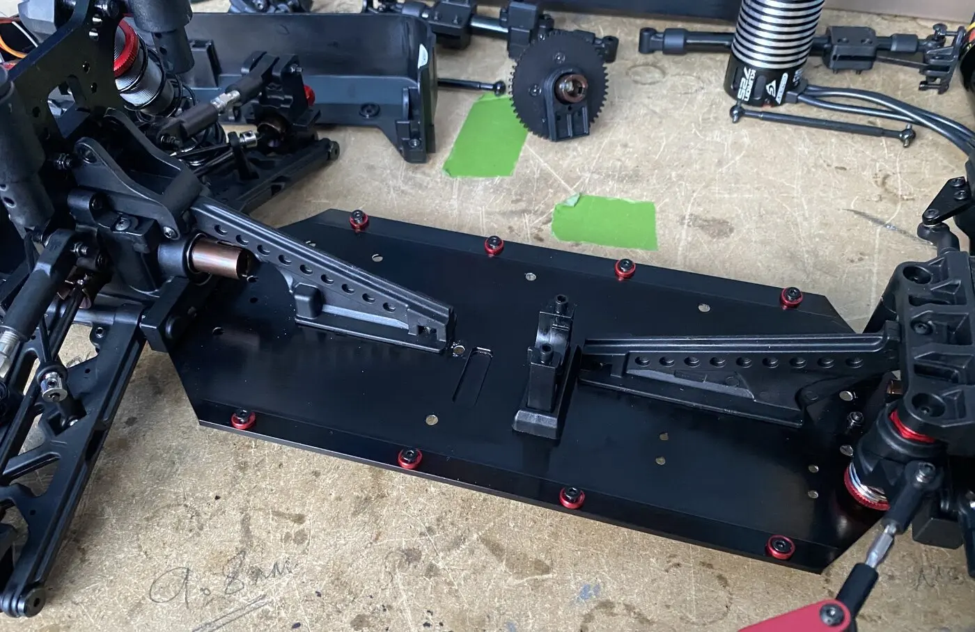

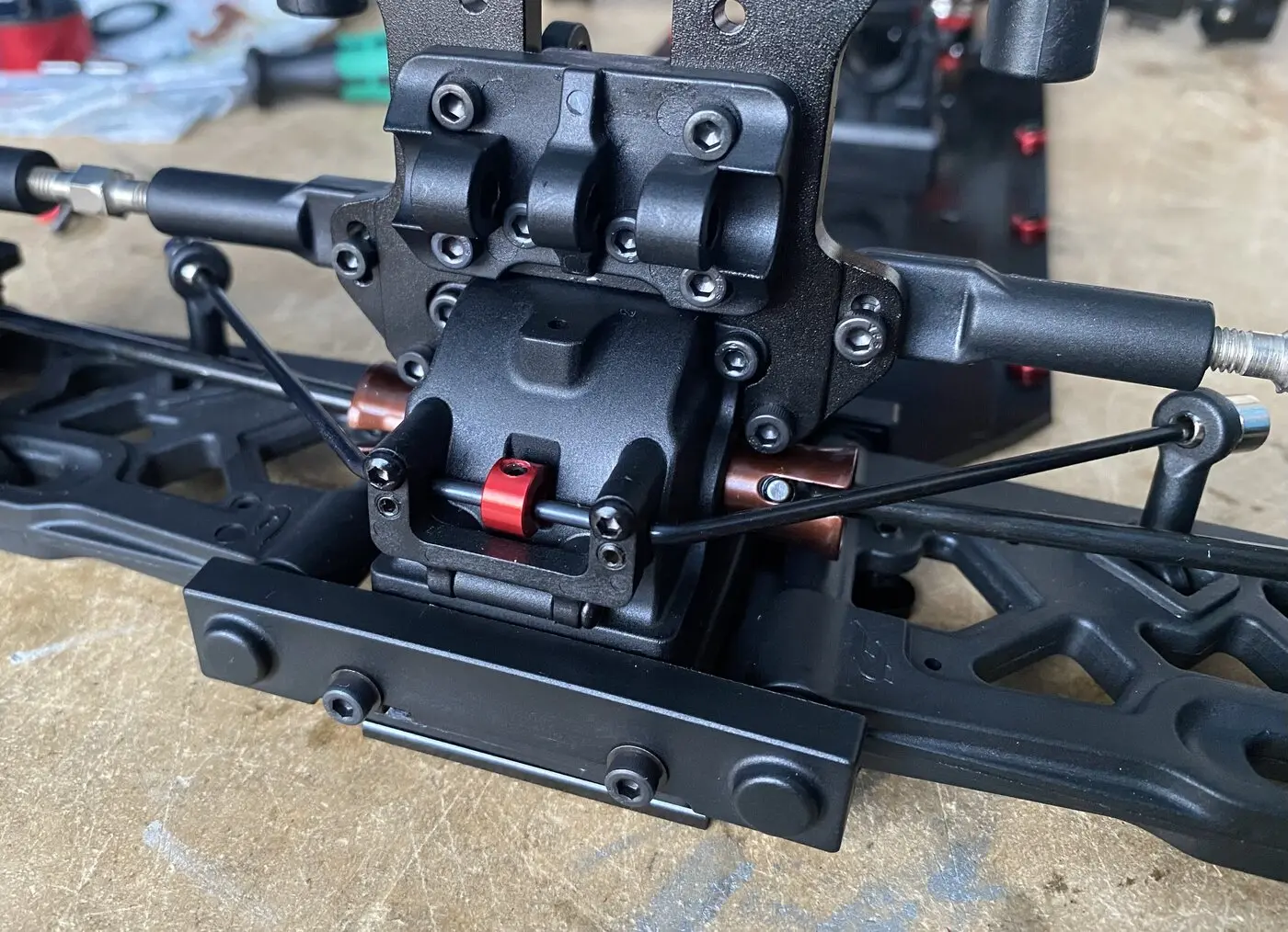

This time I broke the front bumper again and also the wheelie bar, both removed for good now because I'm fed up replacing them, also bent the rear shock towerI'm sorry but this proves to me that the bracing does nothing in my opinion..

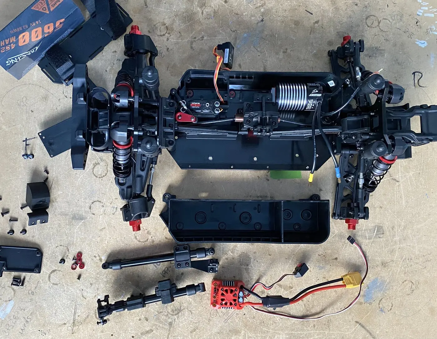

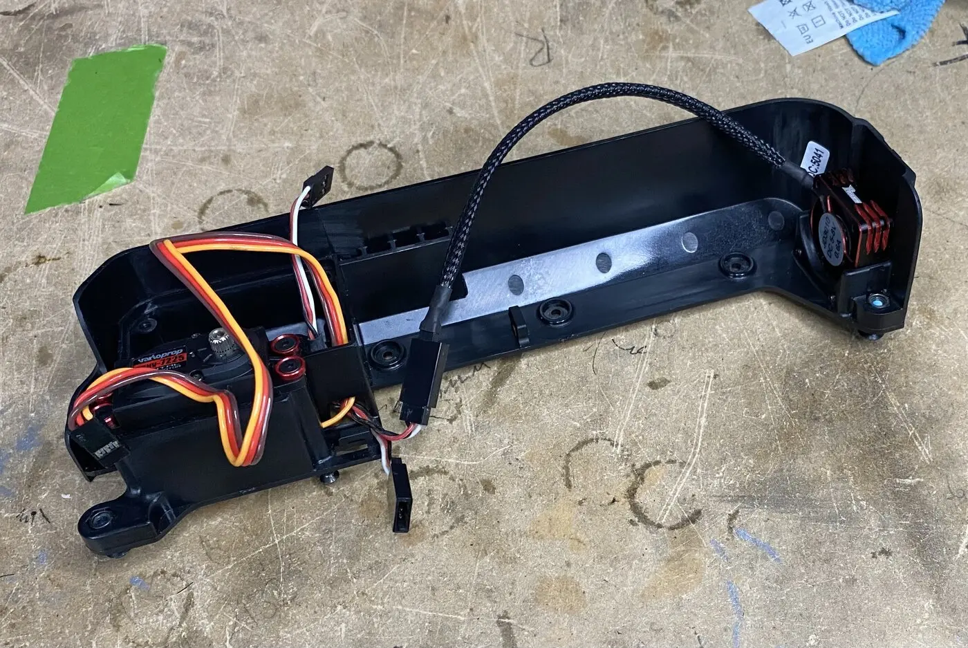

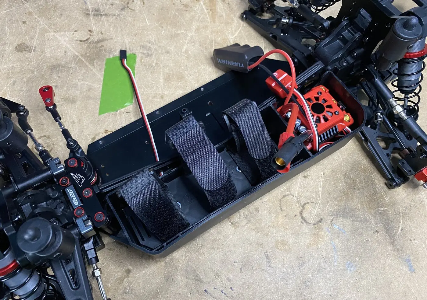

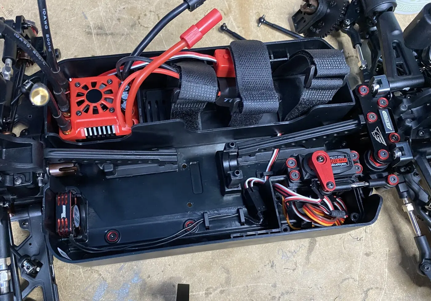

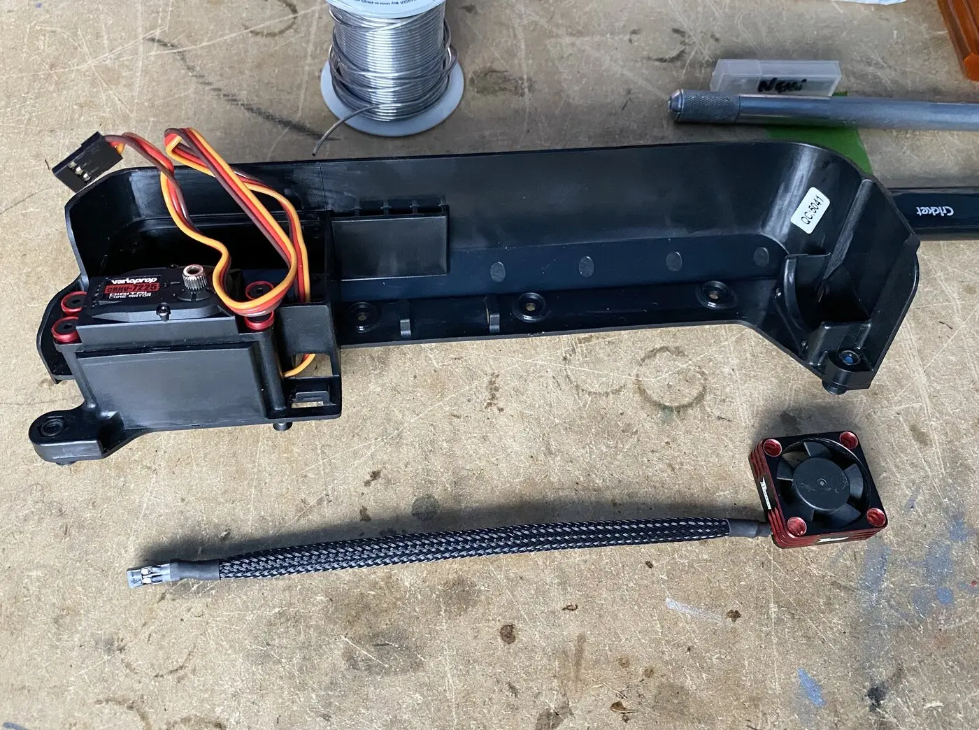

Quick strip down and bit of vice treatment and we're as good as new

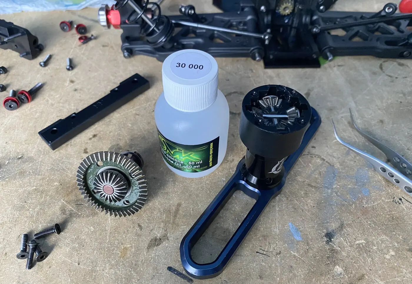

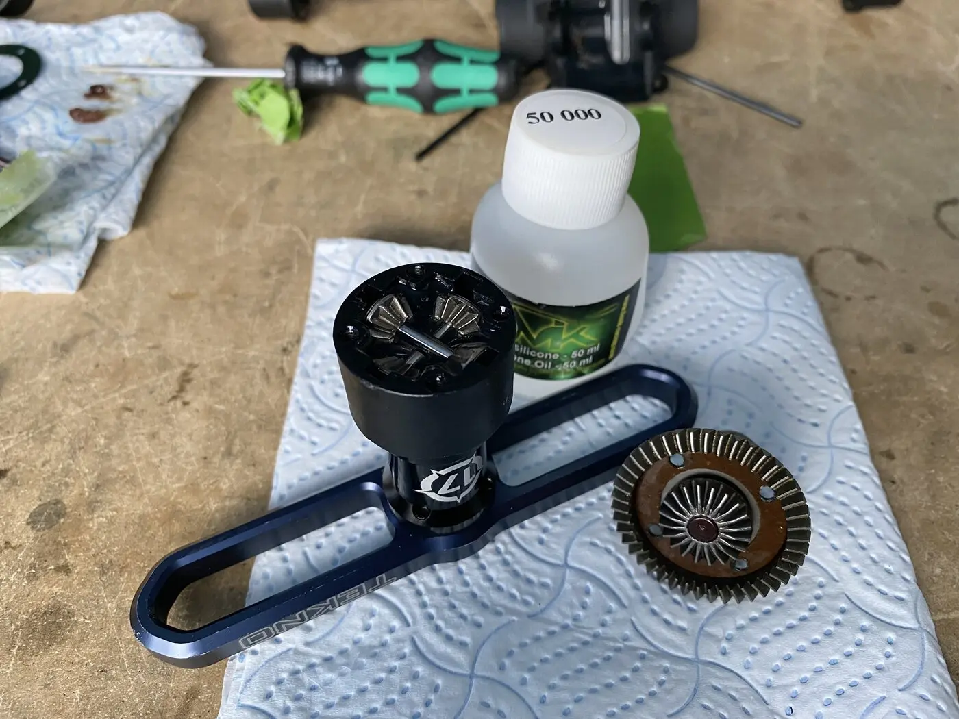

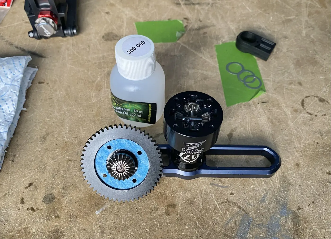

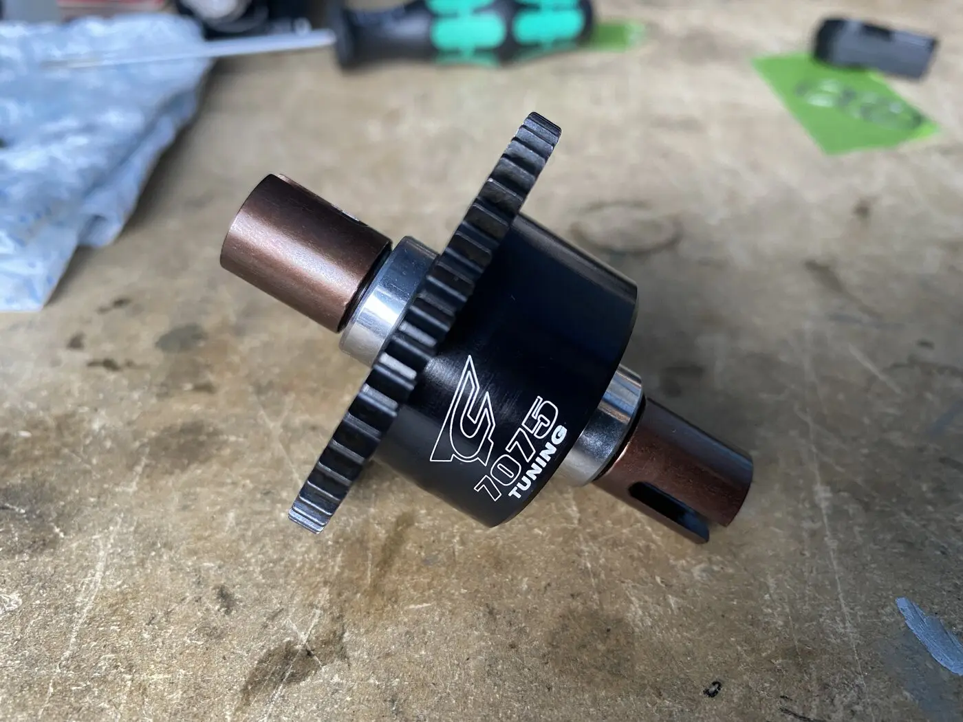

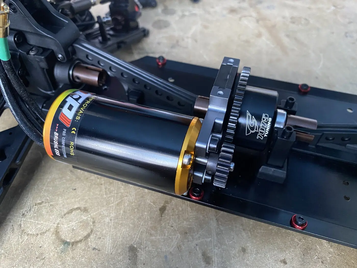

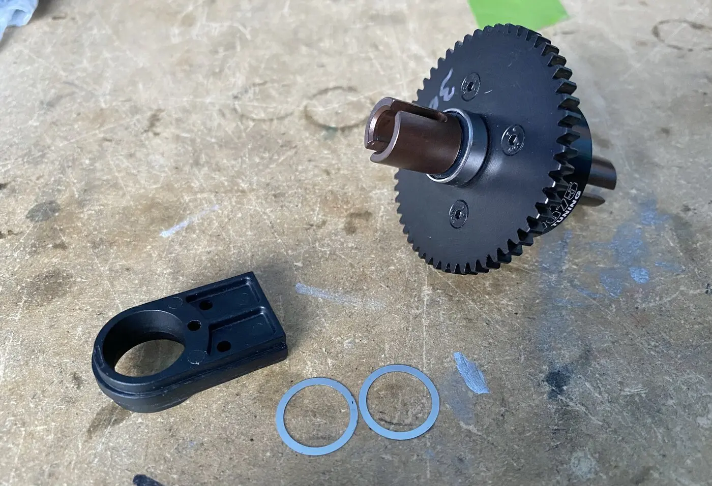

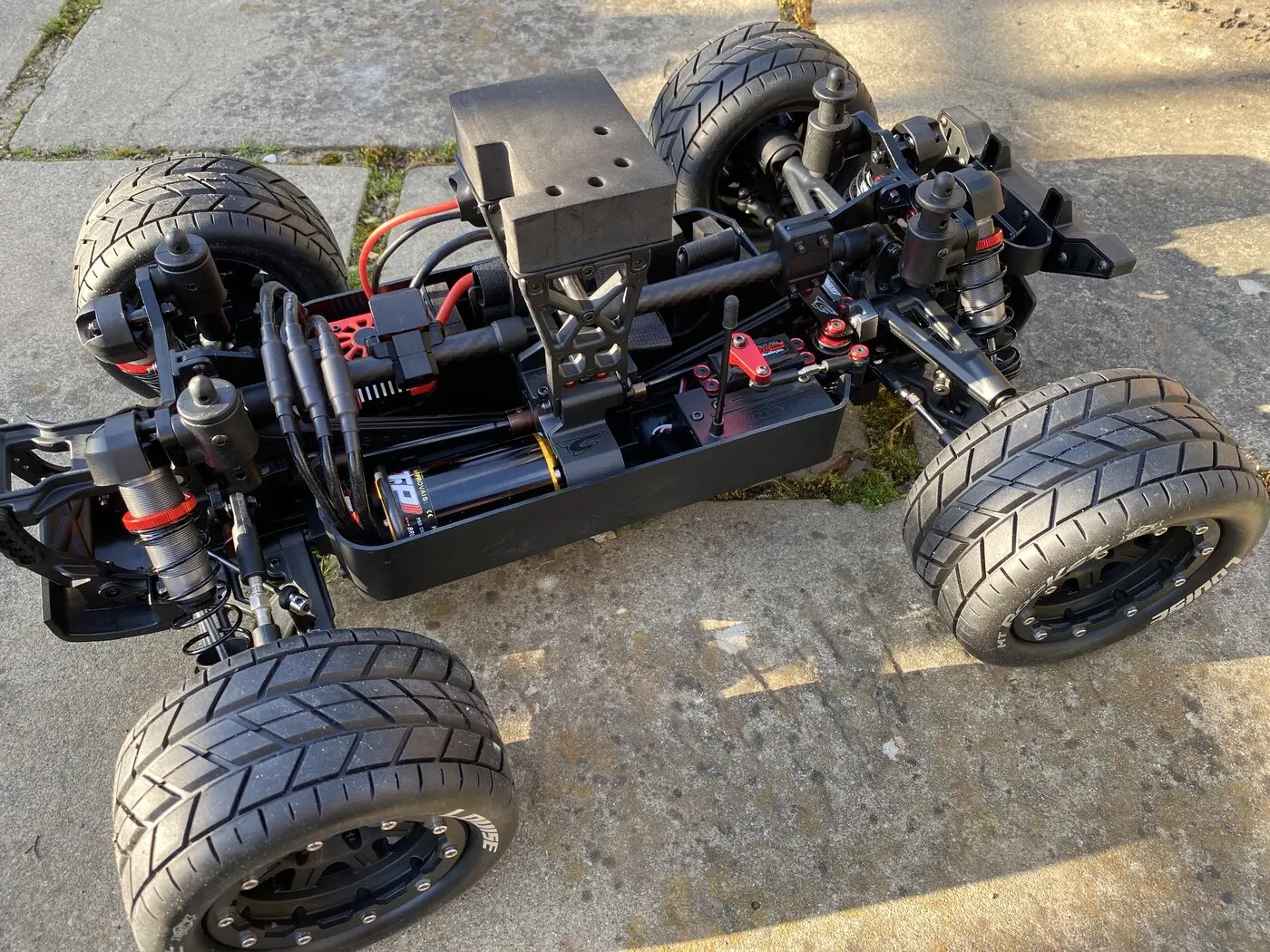

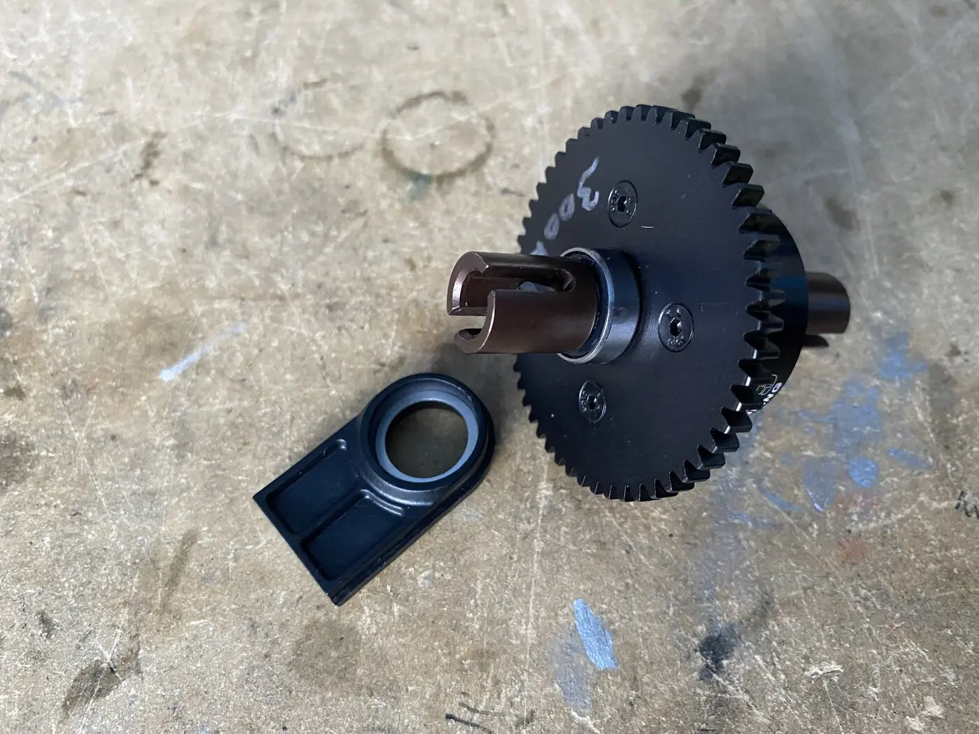

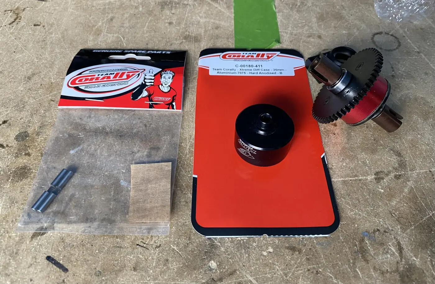

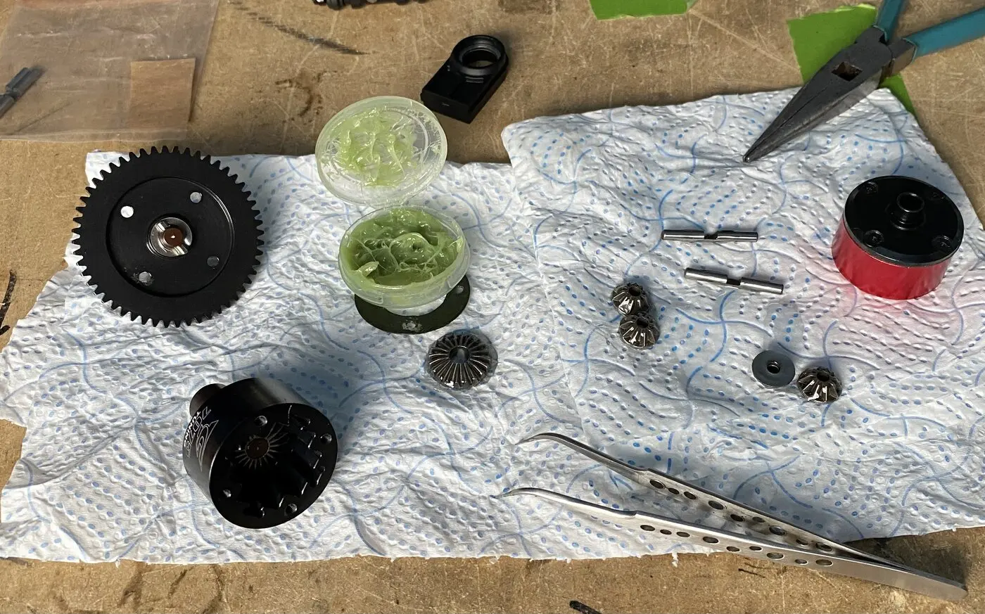

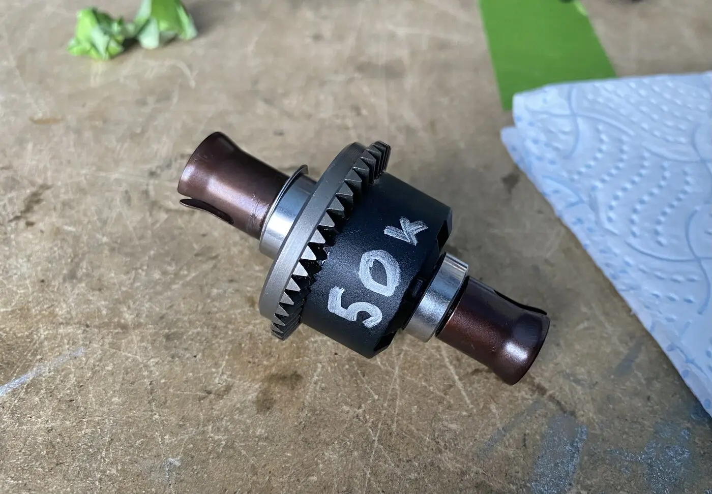

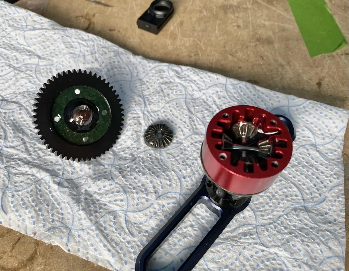

Changed the center diff back to stock 52T and upped the oil to 500k also changed pinion to 18T in the hope that I can get the temps in check once and for all

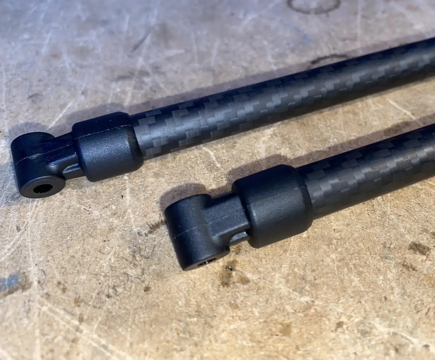

Also, I don't think the function of the center brace is for preventing the shock towers from bending, it's to keep the chassis itself from bending? Either way, sorry to hear of the breakages. We're still waiting over here for the '22 models to be back in stock unfortunately..
