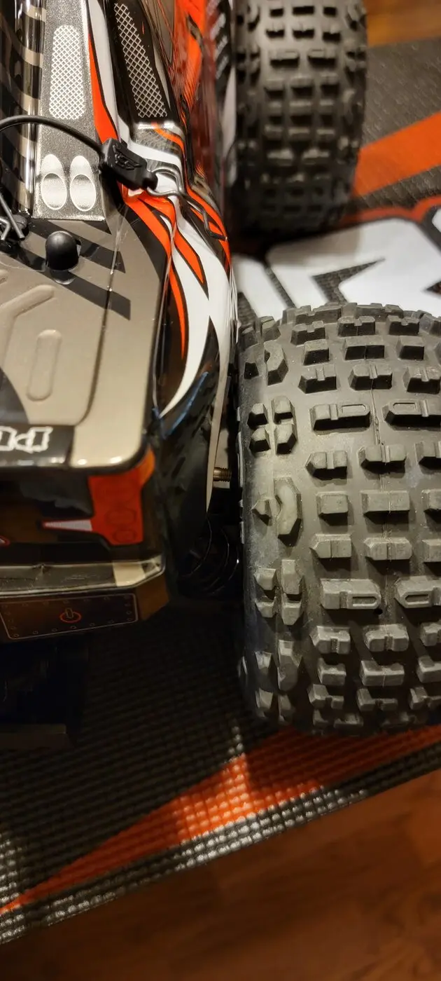

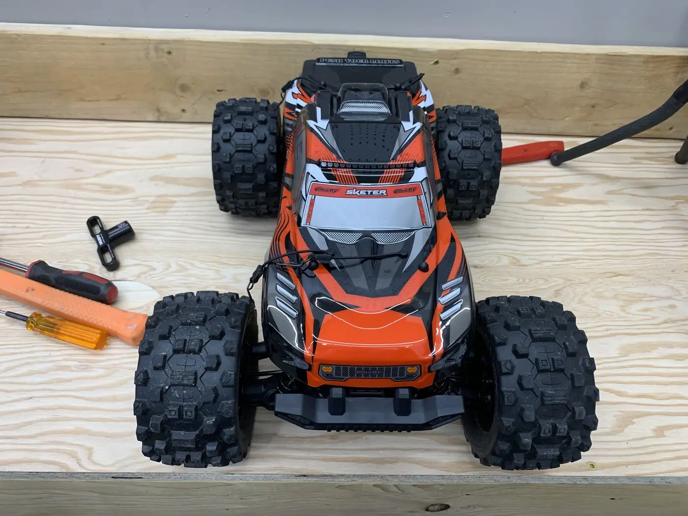

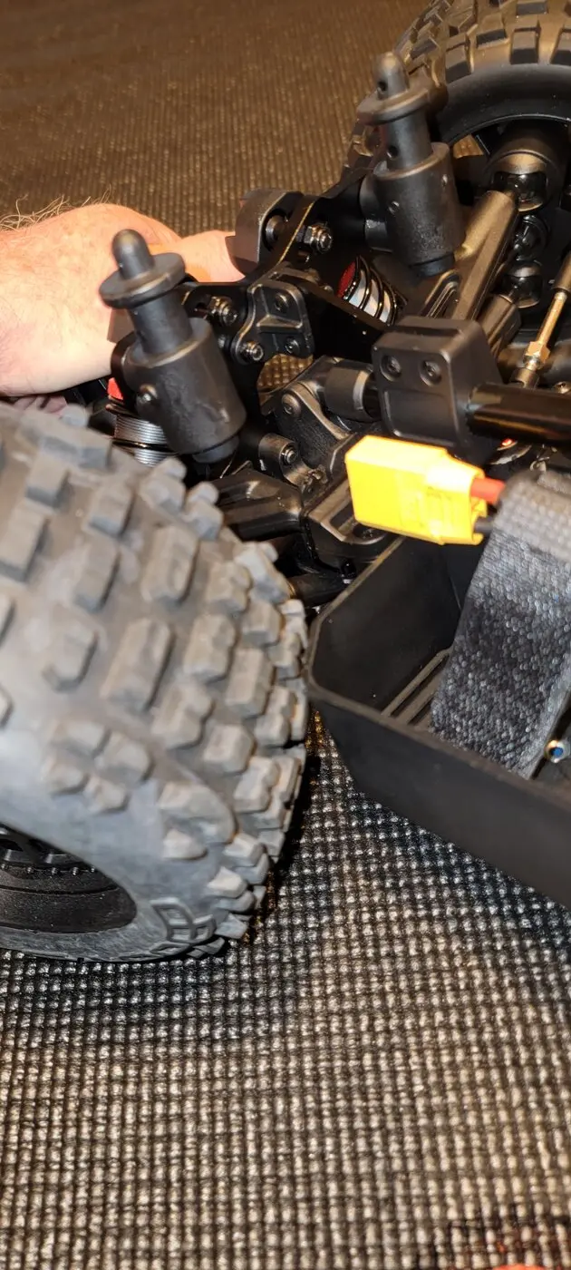

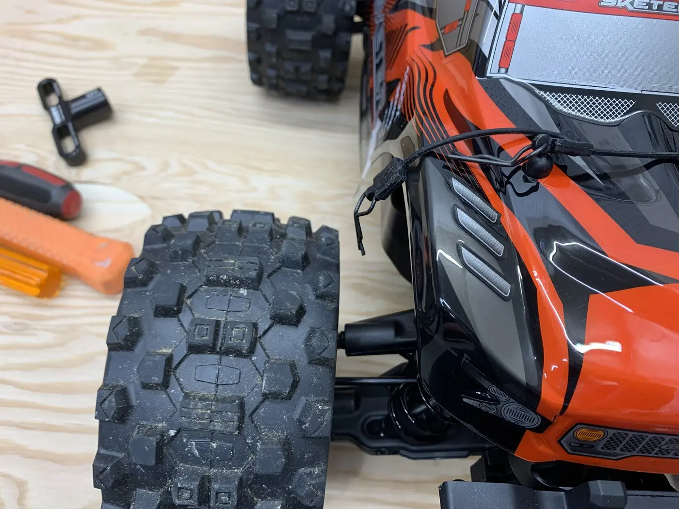

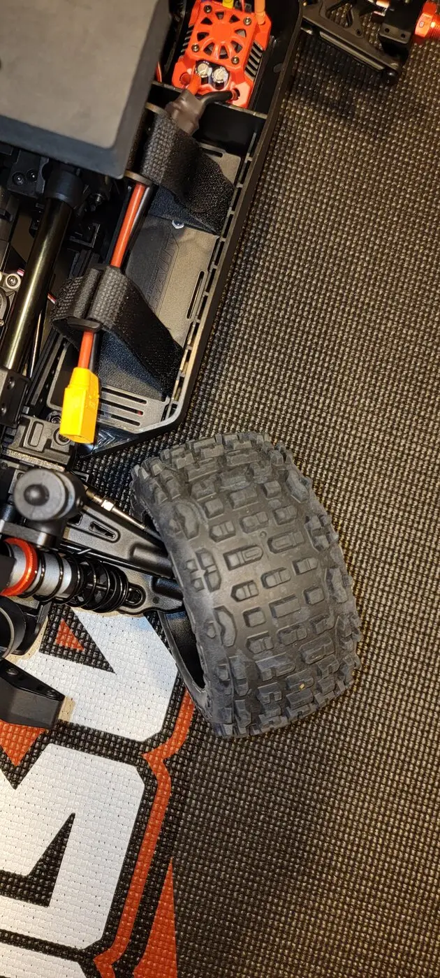

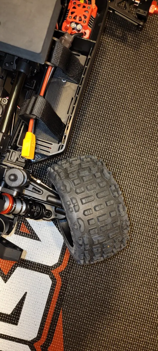

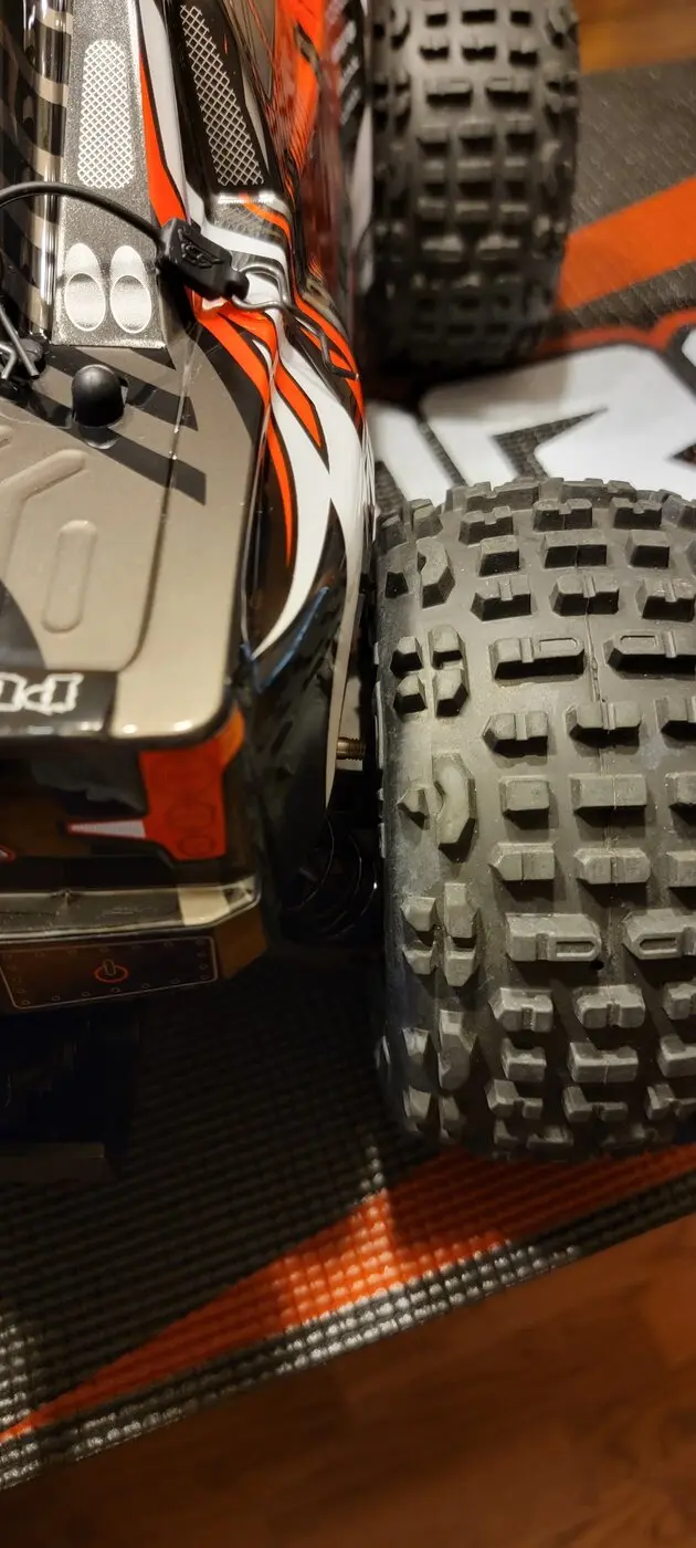

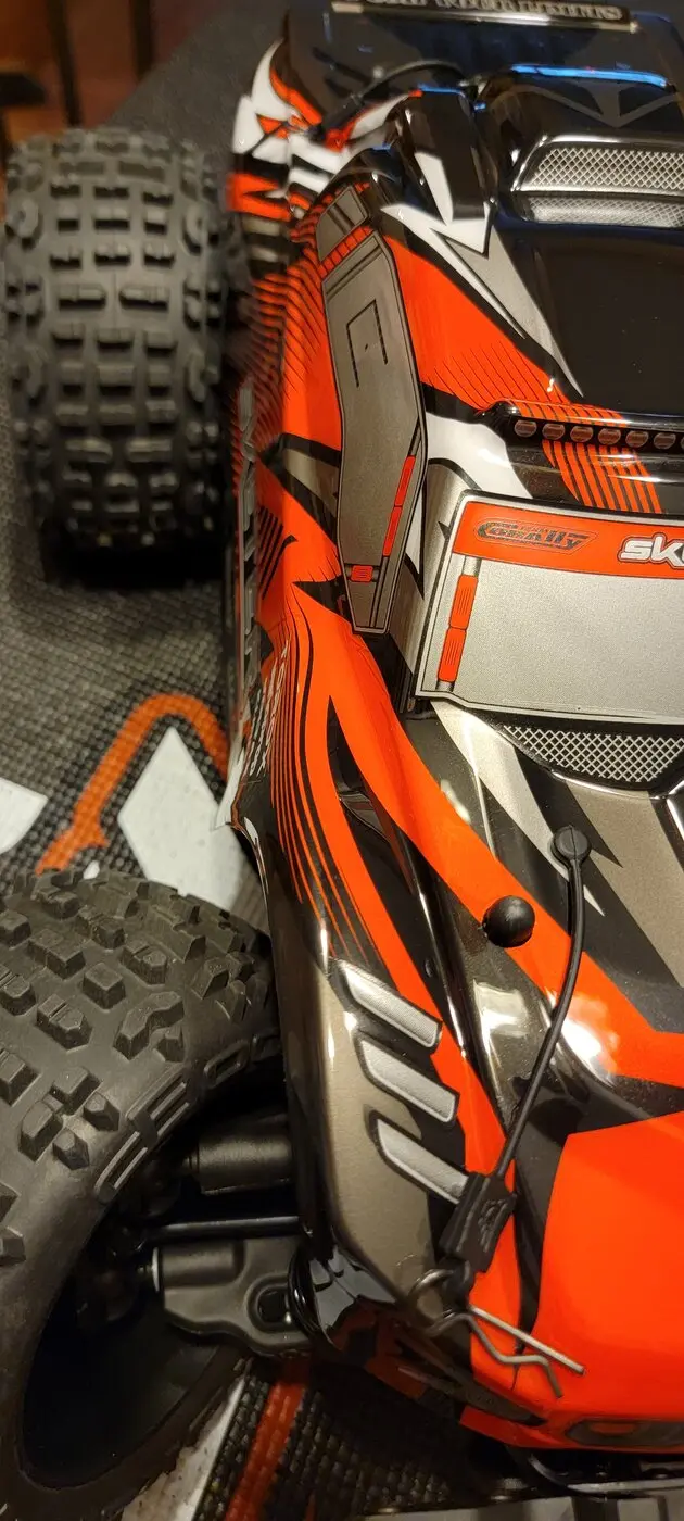

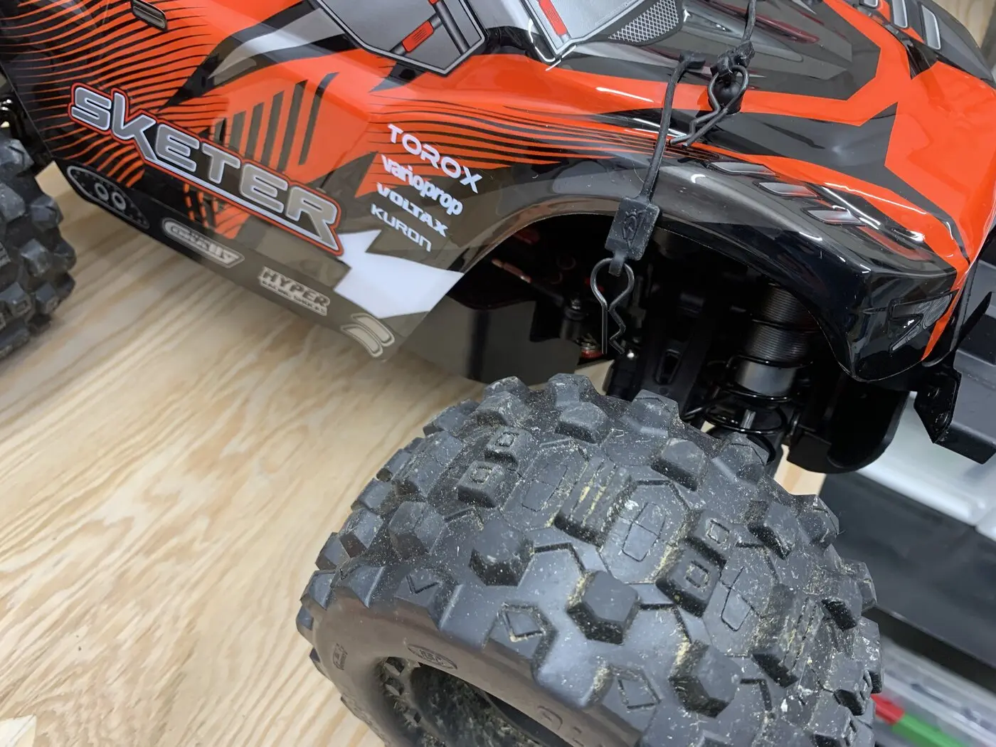

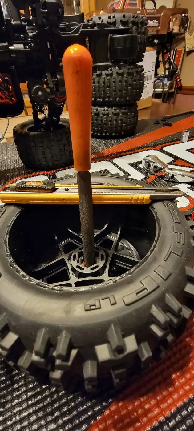

I know these Backflip LPs are too large. Without a body, they work but the front tires almost contact the chassis trays under full compression while turned full lock( which may or may not be a normal situation for you). I didn't actually measure the offset but you get the idea in these pics. They may work with a negative offset wheel or like you're planning, with hub extenders.

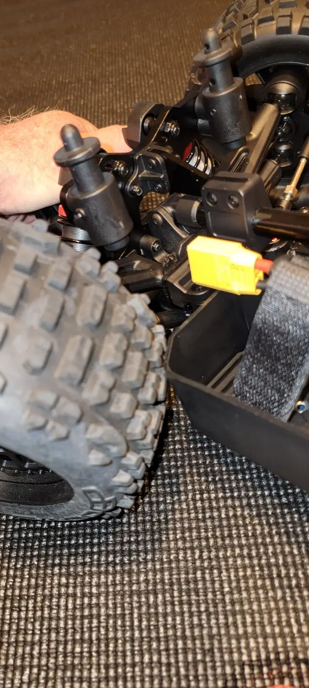

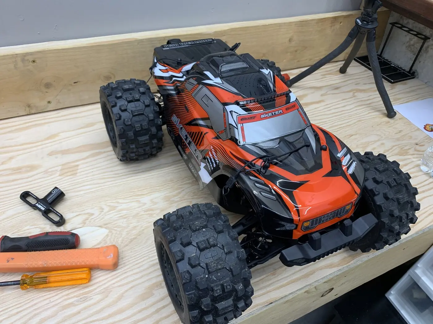

I think even with the wider hubs I just got ballooning might still be an issue. Will give them a dry fit tomorrow, I have all the parts except one axle stub.

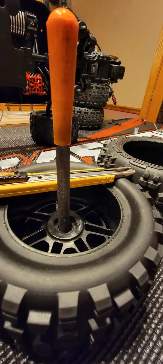

Which wheels?Thanks a lot for that. Do those tires have the 1/2 in offset also?
The 3.8s. If those don’t have the 1/2 inch offset then that plus the 10mm extenders just might work.
Lol, did ya see the backflip LPs?Wow that is a tight fit!

Yea the kaiju wheels are too big too. HahaLol, did ya see the backflip LPs?
Compressed, and uncompressed below.View attachment 398View attachment 399
