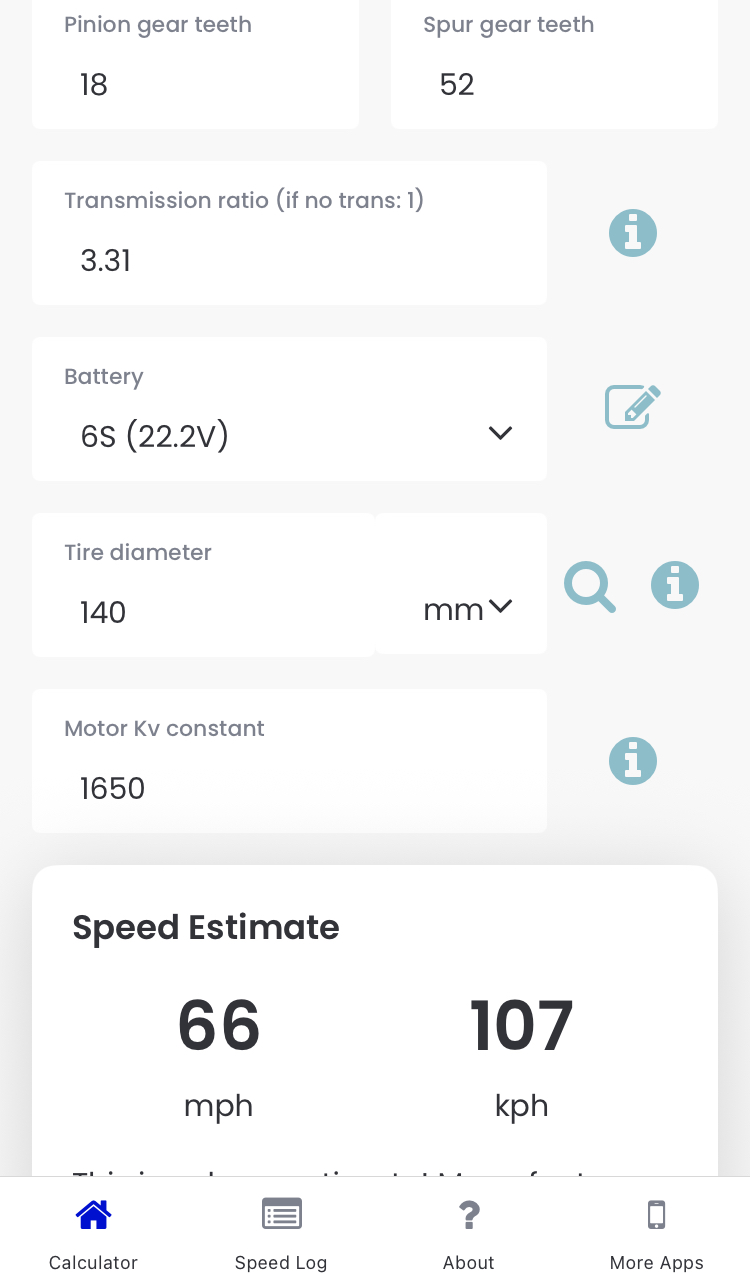

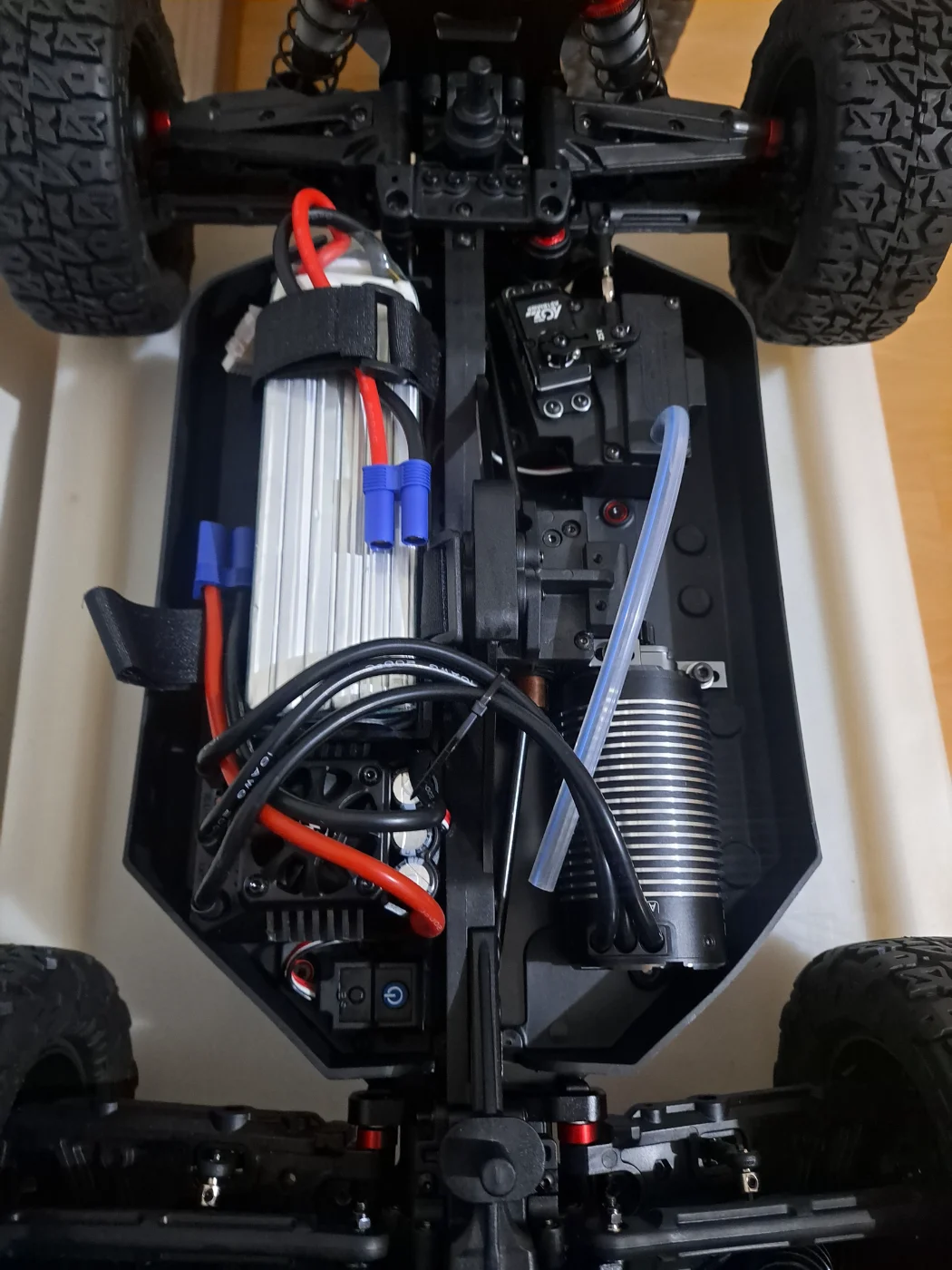

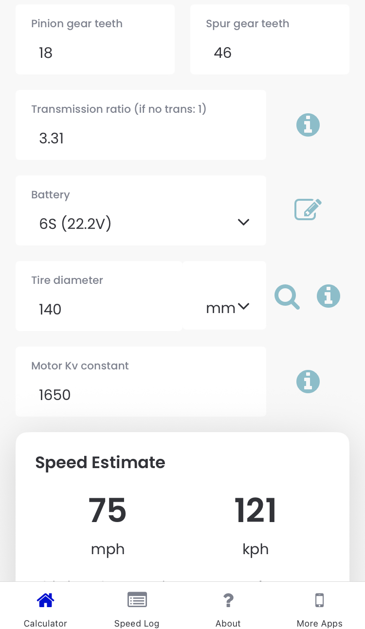

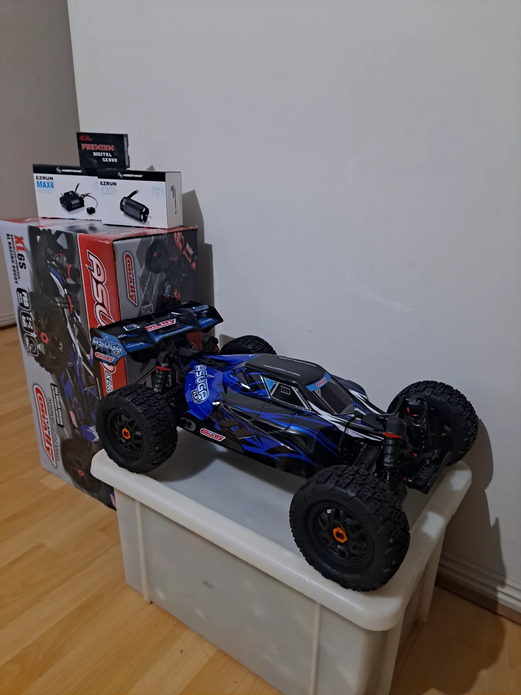

Big thanks to Atomic Skull, Nelson.81 and Horatio for the chats and advice over the last year. Finally on my 50th birthday it's complete. Got $65 off the max6 v3 1650kv combo, figured I don't need sensored and got the ali 40kg load springs and 55kg agfrc monster torque servo, I know is over kill but it's fast and quite. Topped off with the terraforms. Starting off with an 18t pinion, can't wait for Saturday. Thanks again fellas
Looks fresh . Also the 4985 over the 4990 saves you from cutting the sideguards, only thing left to do is get it dirty & enjoy.
