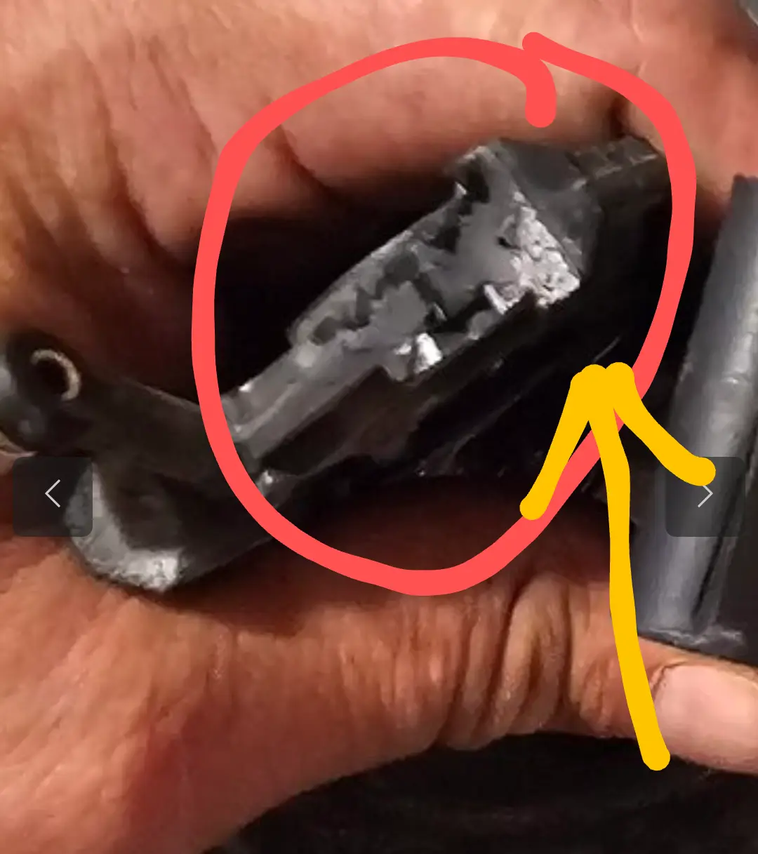

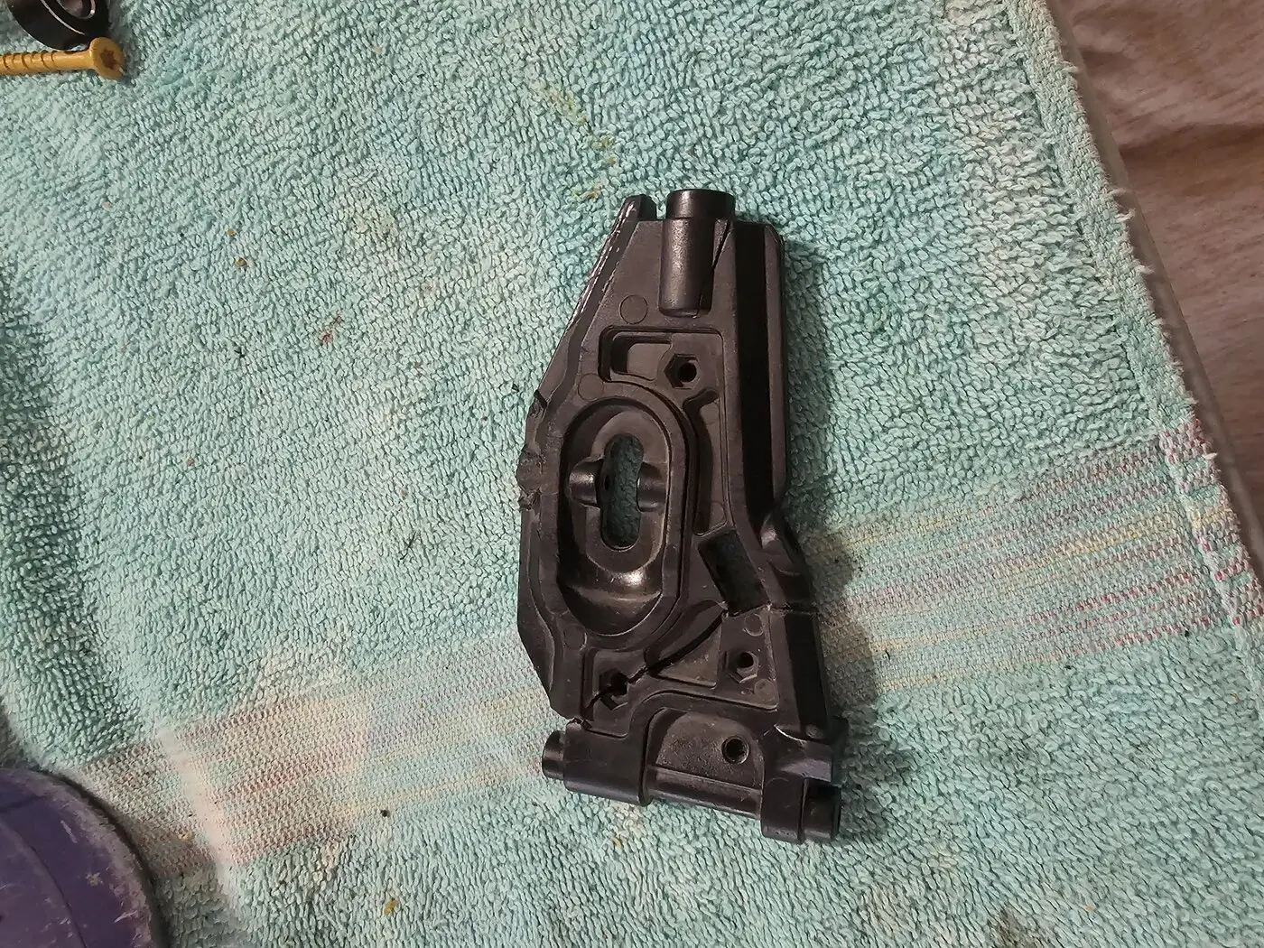

@AnthonyJaques, please could you get a photo of the fracture face of the broken bit please, just the section that I've (badly) circled and arrowed?

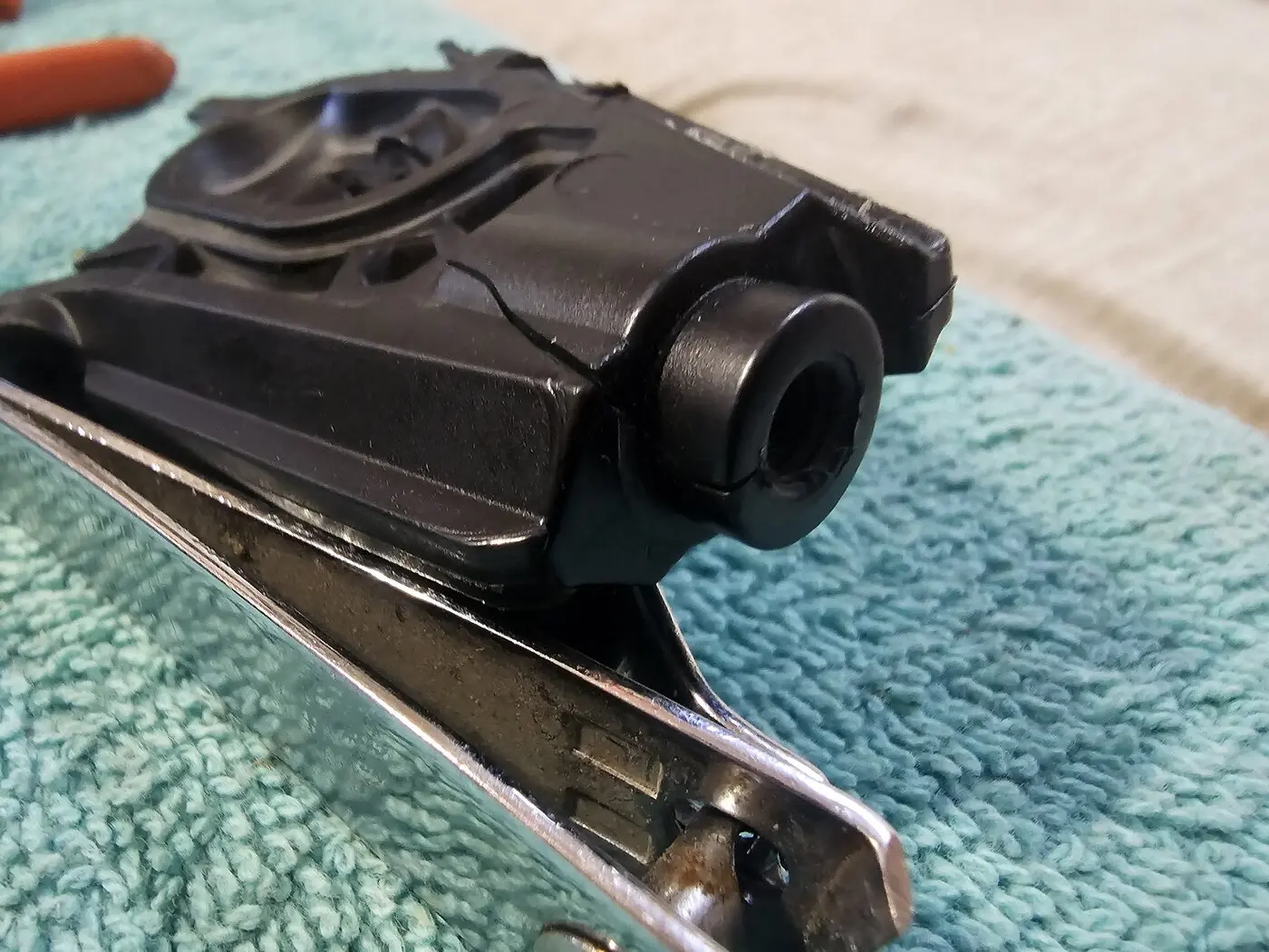

Here ya go

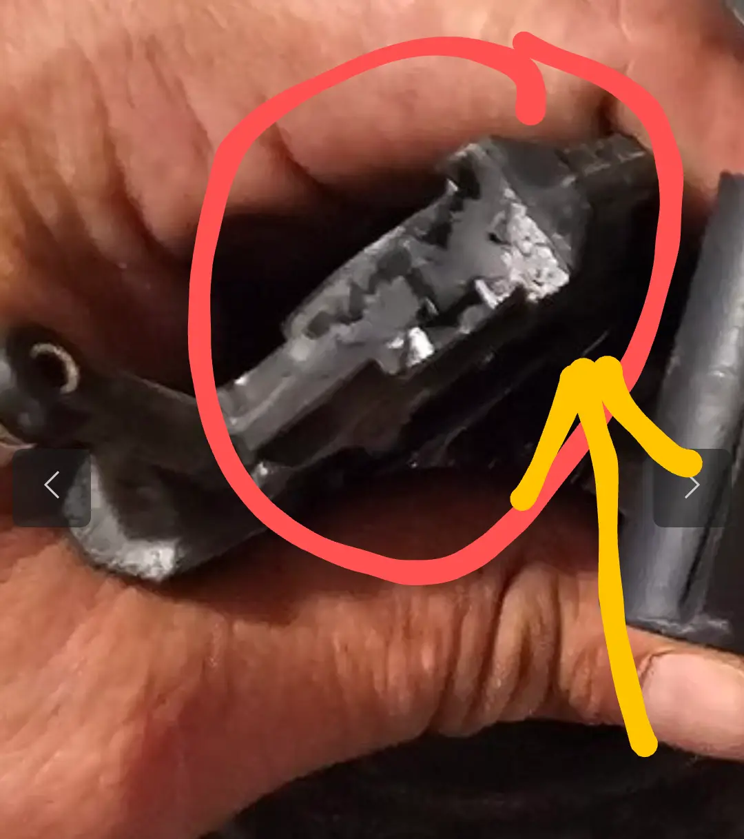

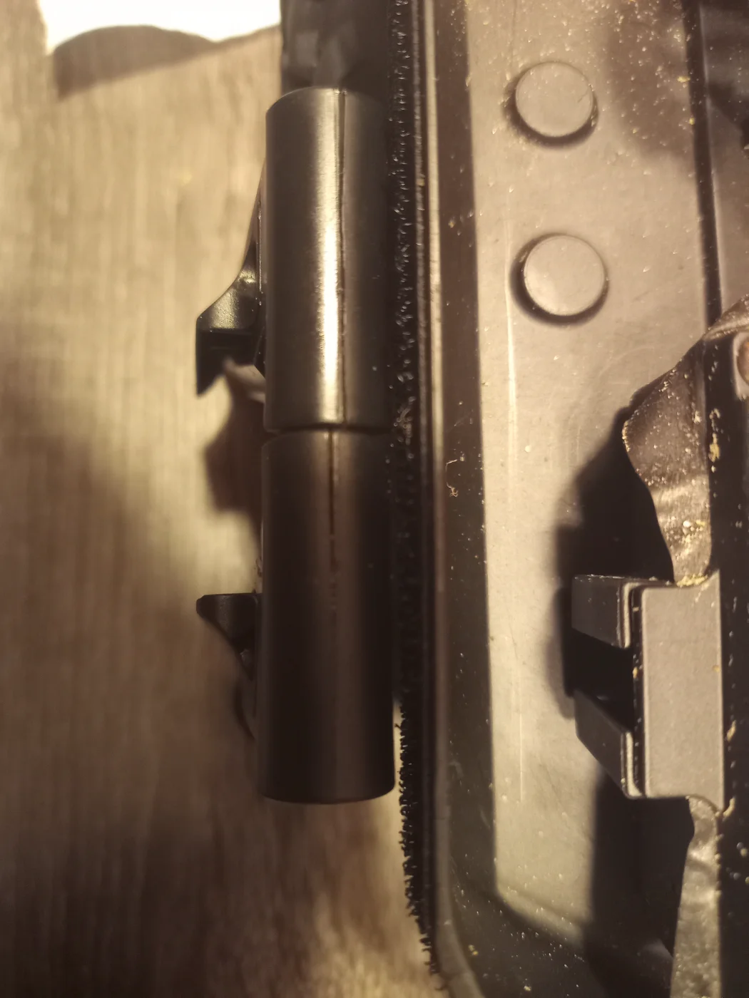

On the initial photo of the fracture, there's a shiny section, which might indicate a lack of fusion between the 2 surfaces, and hence a weak point. Does the fracture face have areas that look different? Can you get a photo of the break across the cross-section?
The break down by the pillow ball thread also doesn't look like a normal break in fibre reinforced polymer, possibly suggesting that the 'surface optical effect' penetrates quite a way into the bulk of the material, knocking down the material strength by quite a margin.

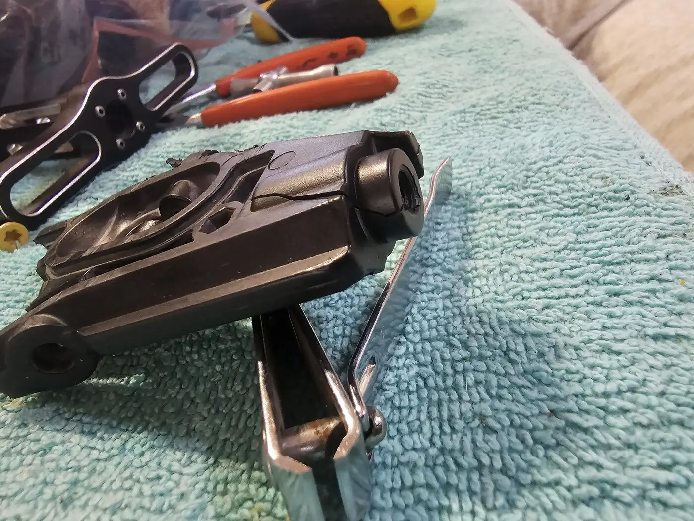

Yes very much so
Yes very much so
