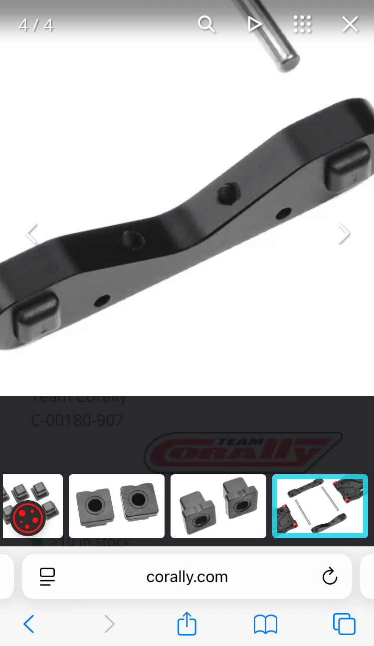

This part here: COR00180-907
https://corally.com/en/product/c-00180-907/
I'm in the middle of service and got these mixed up. I thought I knew but the image I am looking at in the manual conflicts with what I thought. Do the 1's go in the Front Rear or do they go in the Rear Rear's? Do the numbers face "right side up" on both sides?

Using a straight edge across the D block and measuring to the hub with my calipers, I am showing equal toe in with the #1 pill upside down on the front left rear and another #1 pill right side up on the front right rear. With the #1 pills both right ride up, the left rear didn’t match the right rears toe.

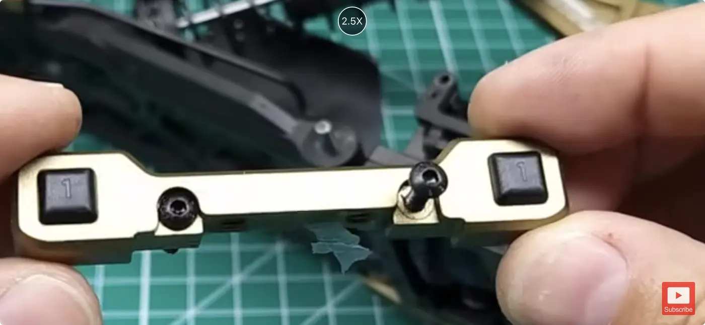

This goes against what you can see in the corally part photo. Also sadly jennysrc photo does not show numbers on the pills, maybe this is a LE specific part for now?

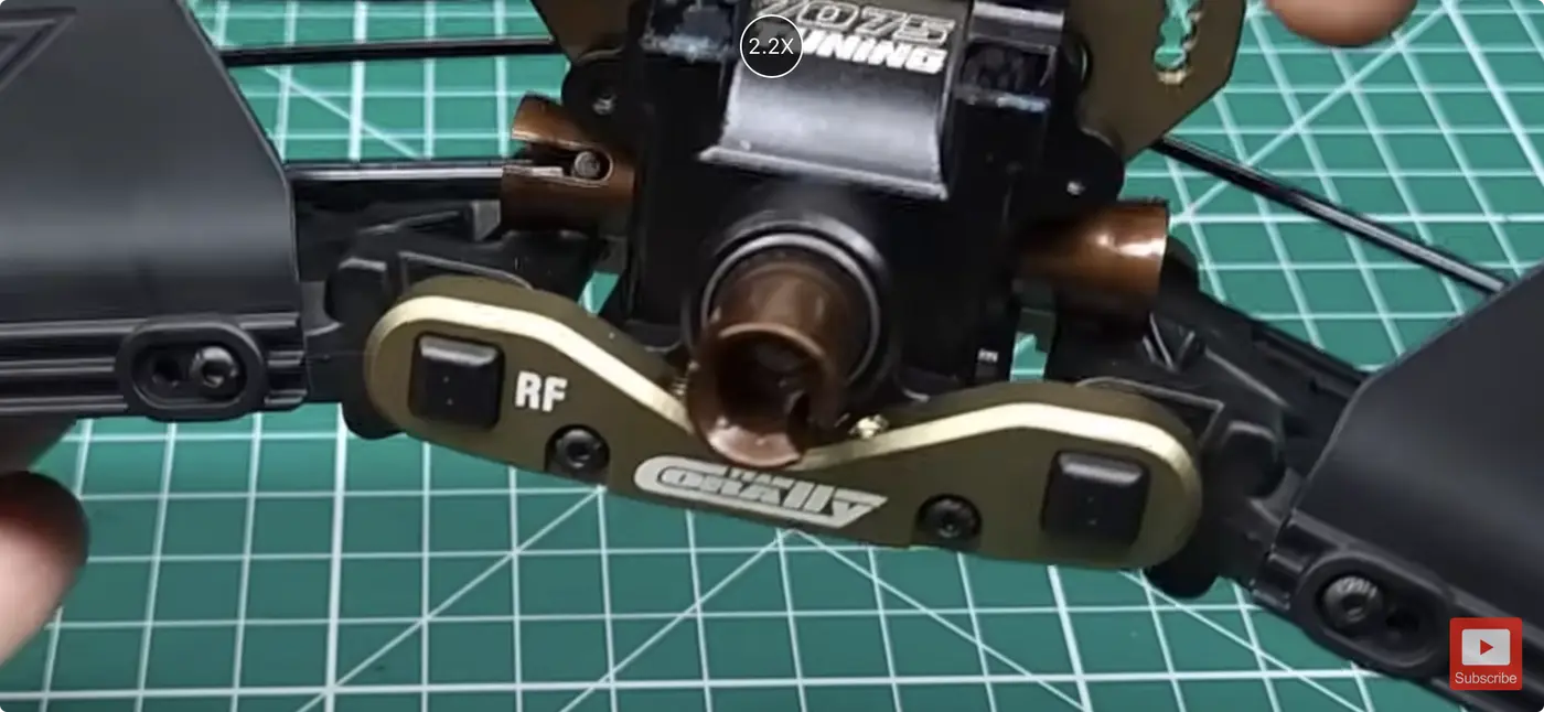

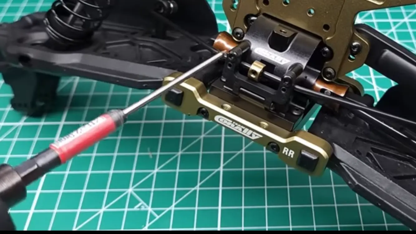

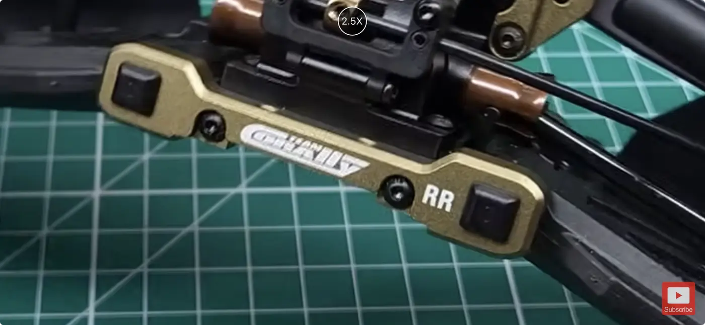

Might get a better look on corally vid but this is do rc vid should look like this can see the toe angle on arms wider gap at front c block compared to the rear d block.

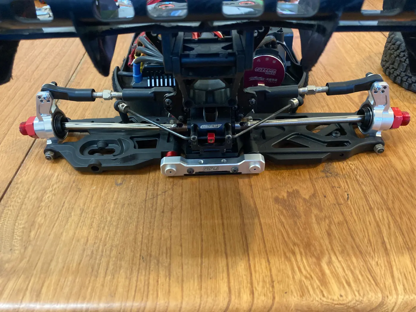

This is the RR (D block). Mine has zeros in here.
This is the FR (C block)Looks like 1’s as well, both right side up.
Unless I’m missing a core concept, 1’s all around will cancel each other out?

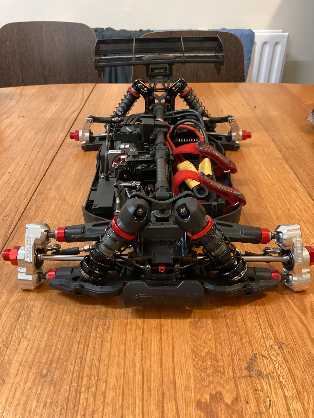

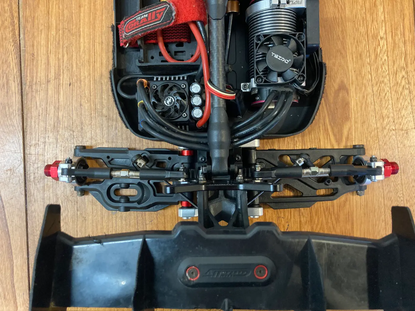

Don’t really see them on many bashers or on Aftermarket hinge pin holders most don’t use the pills just a fixed setup more a tuning aid used on race buggy’s/truggys. Design of the arms also comes into it I changed the rear arms on my buggy to typhon ones and design of the arms changed the toe angle.

Don’t know if adjusting toe will improve landings probably more shock tuning area want look at. Fitted typhon arms so could fit scorched hubs
