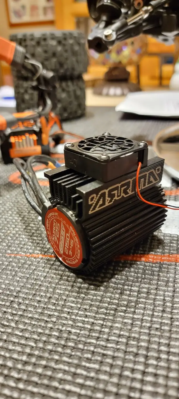

Swapped in a 15T pinion last night and ran at my local park today.
I have to admit, it makes a big difference in launching and top speed. On 3s she still moves pretty well, almost like stock 13t on 4s.
Drivability was still pretty good but I feel like it's more prone to rolling.
Temps after 1 battery pack.
Ambient temp 74 deg.
Motor 182 deg
ESC 132 deg.
The motor definitely needs a fan. 15T is pushing it.
