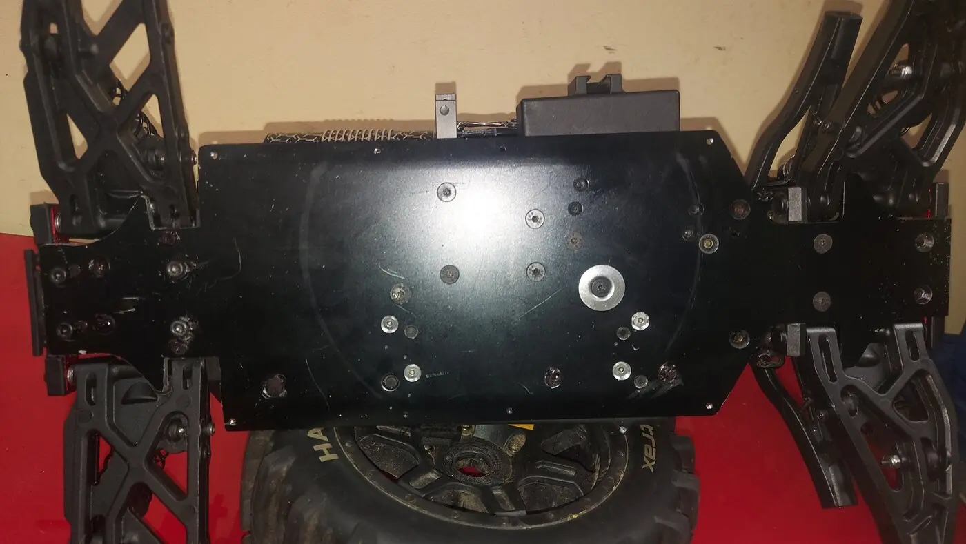

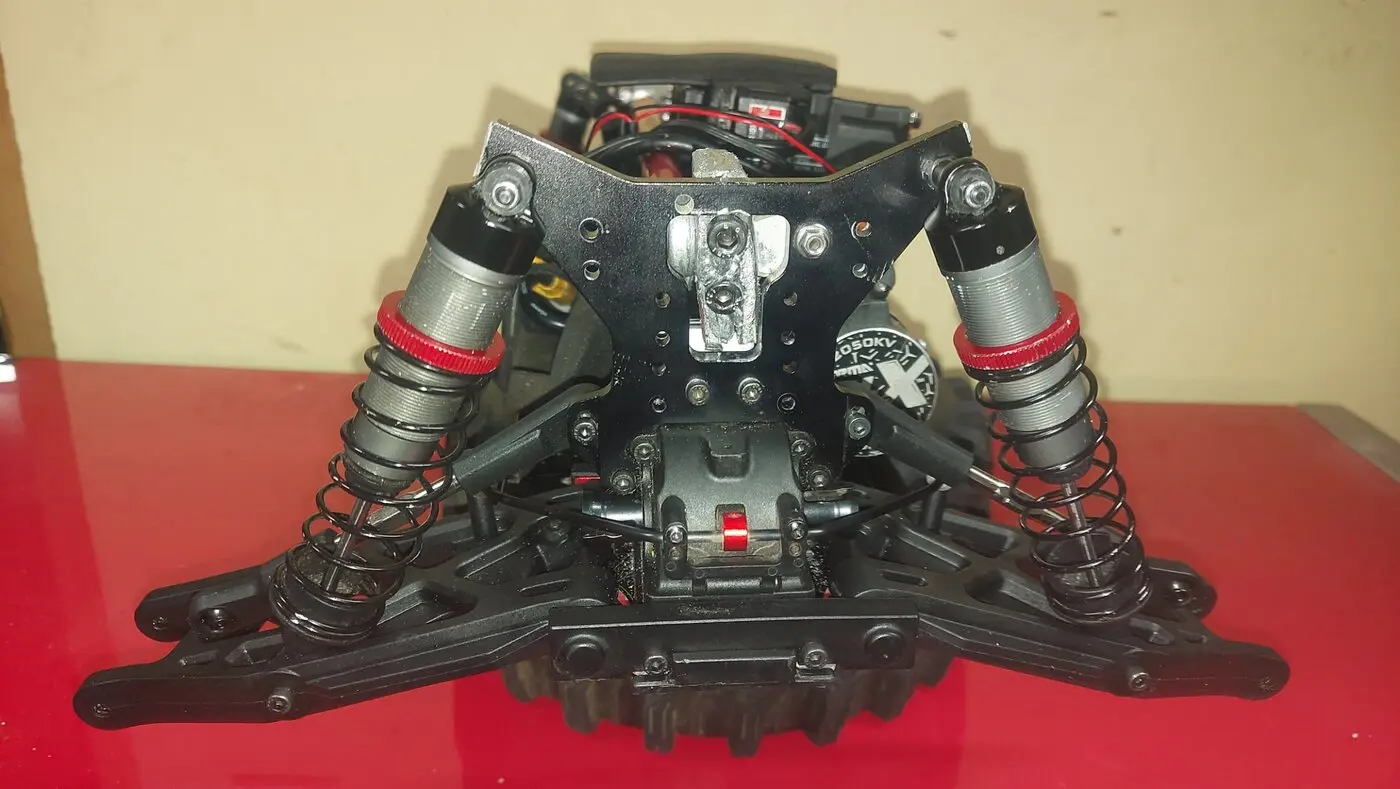

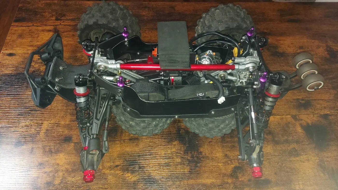

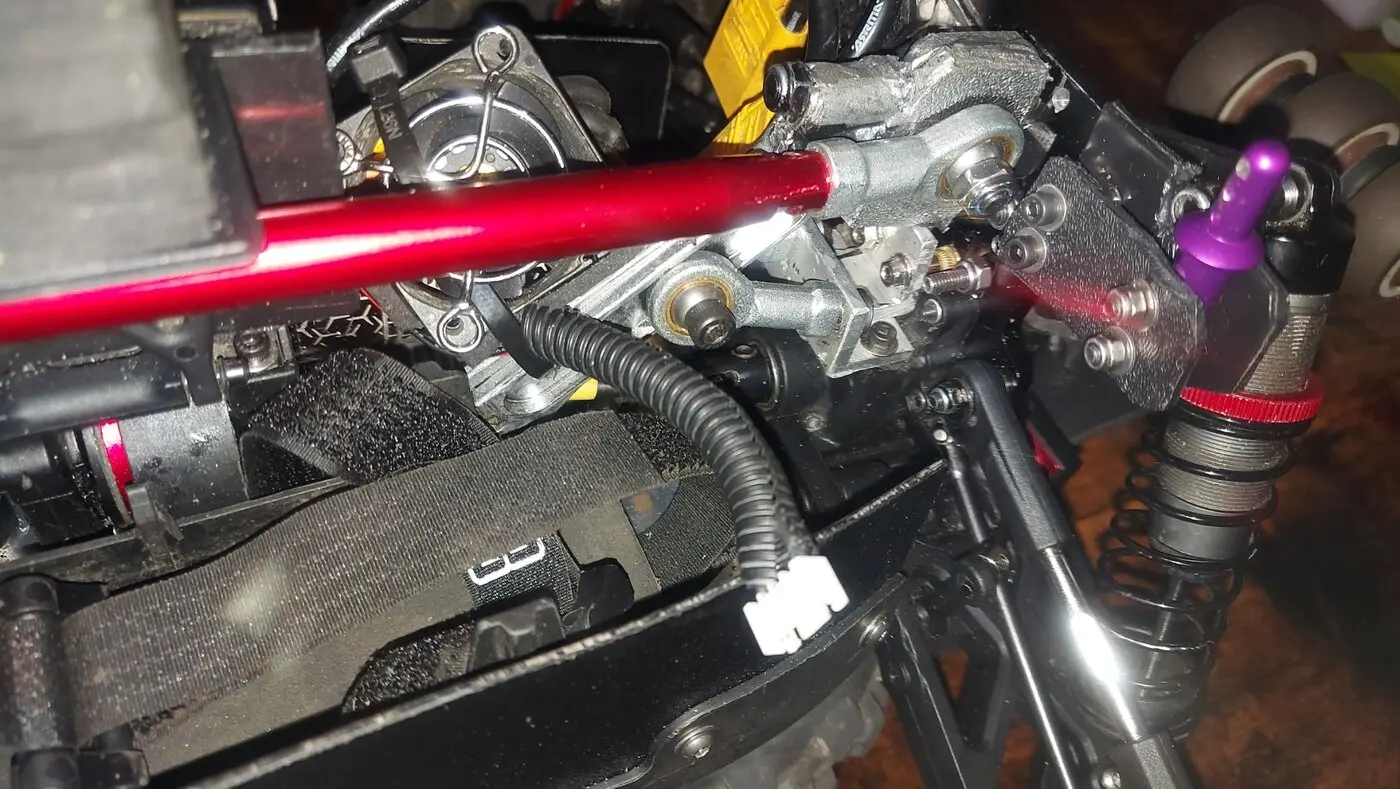

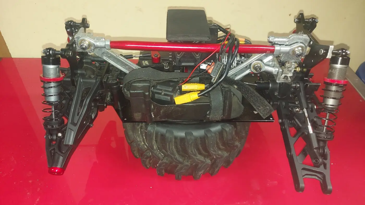

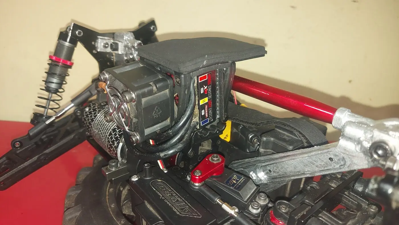

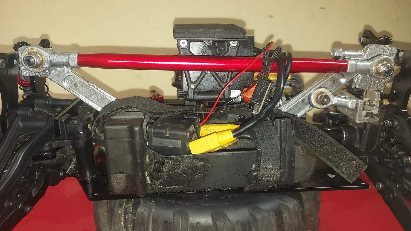

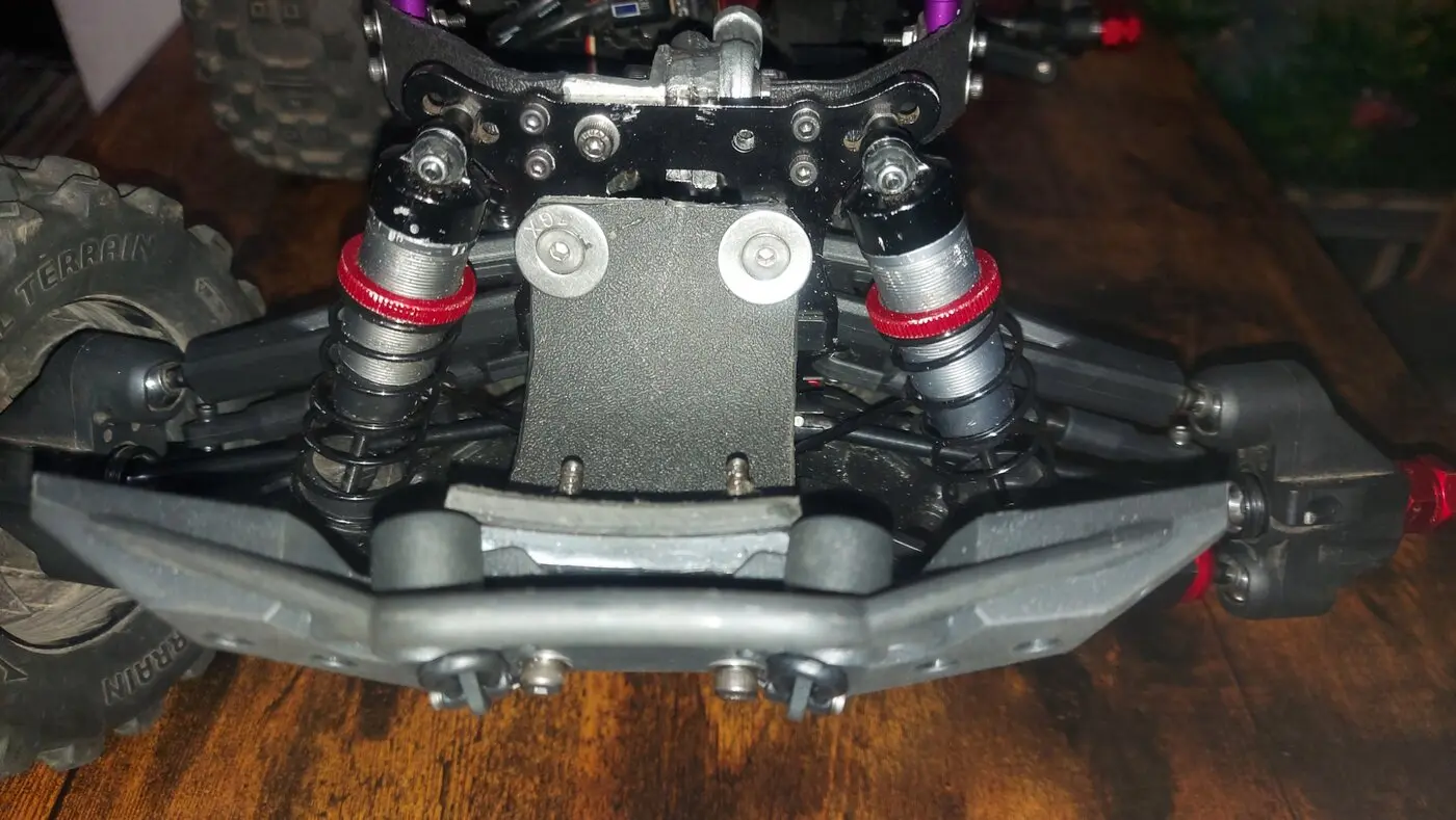

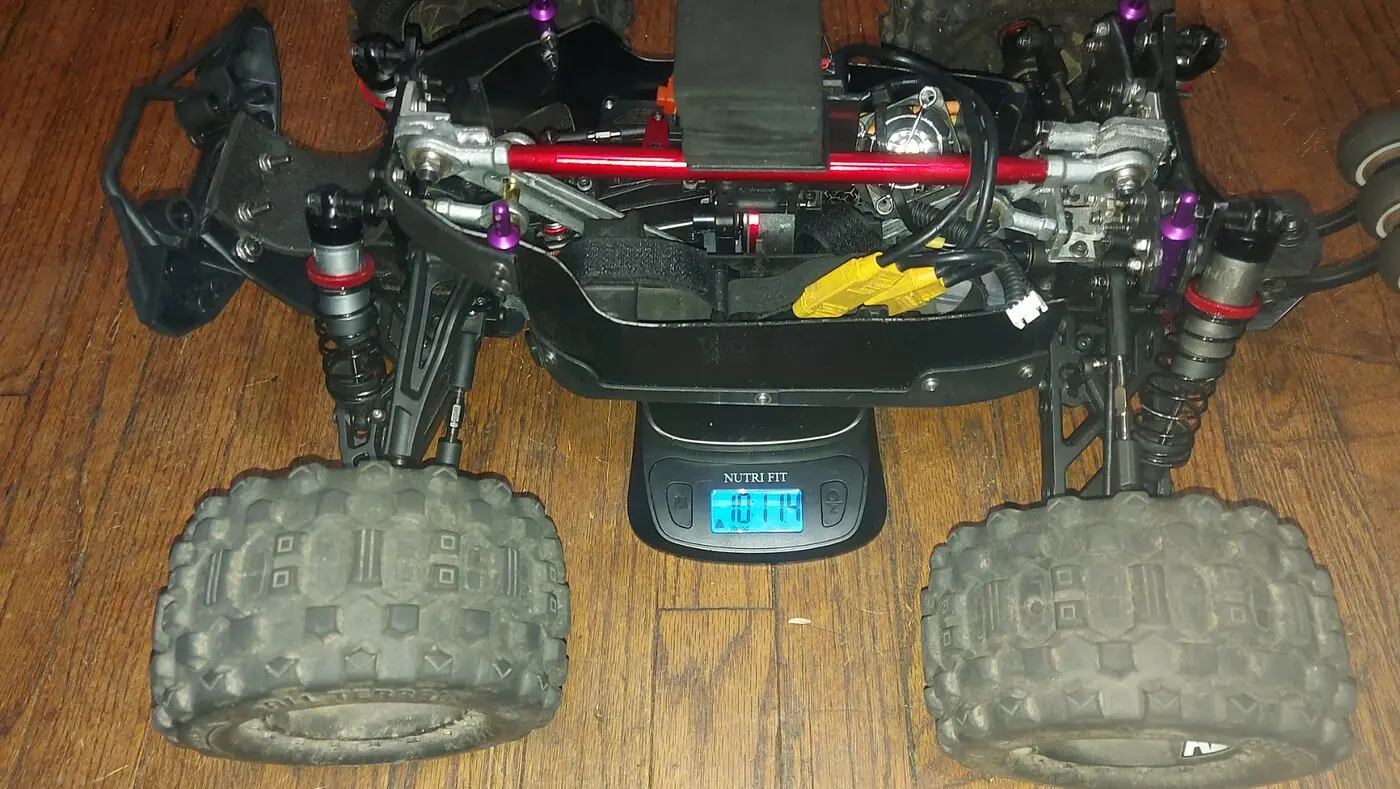

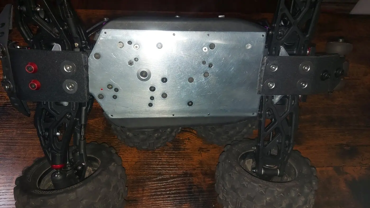

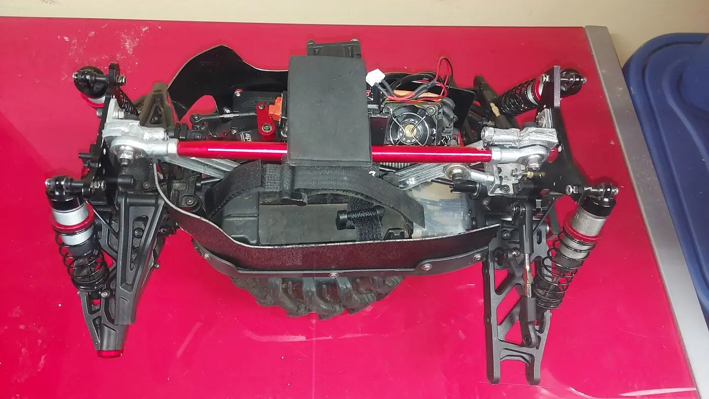

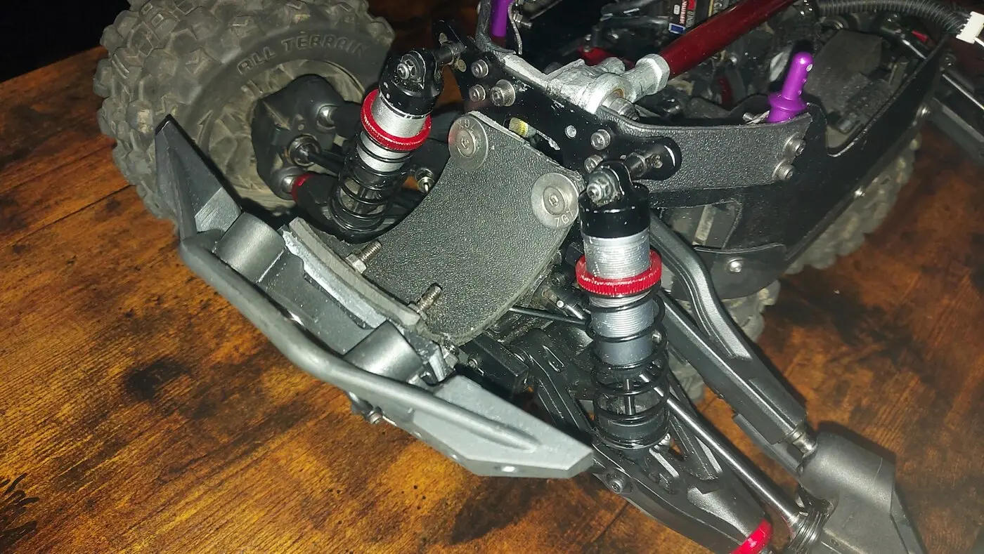

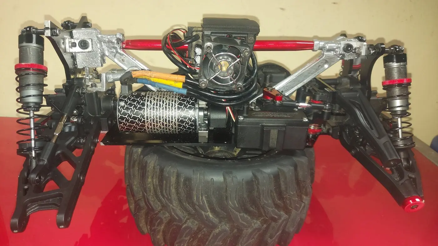

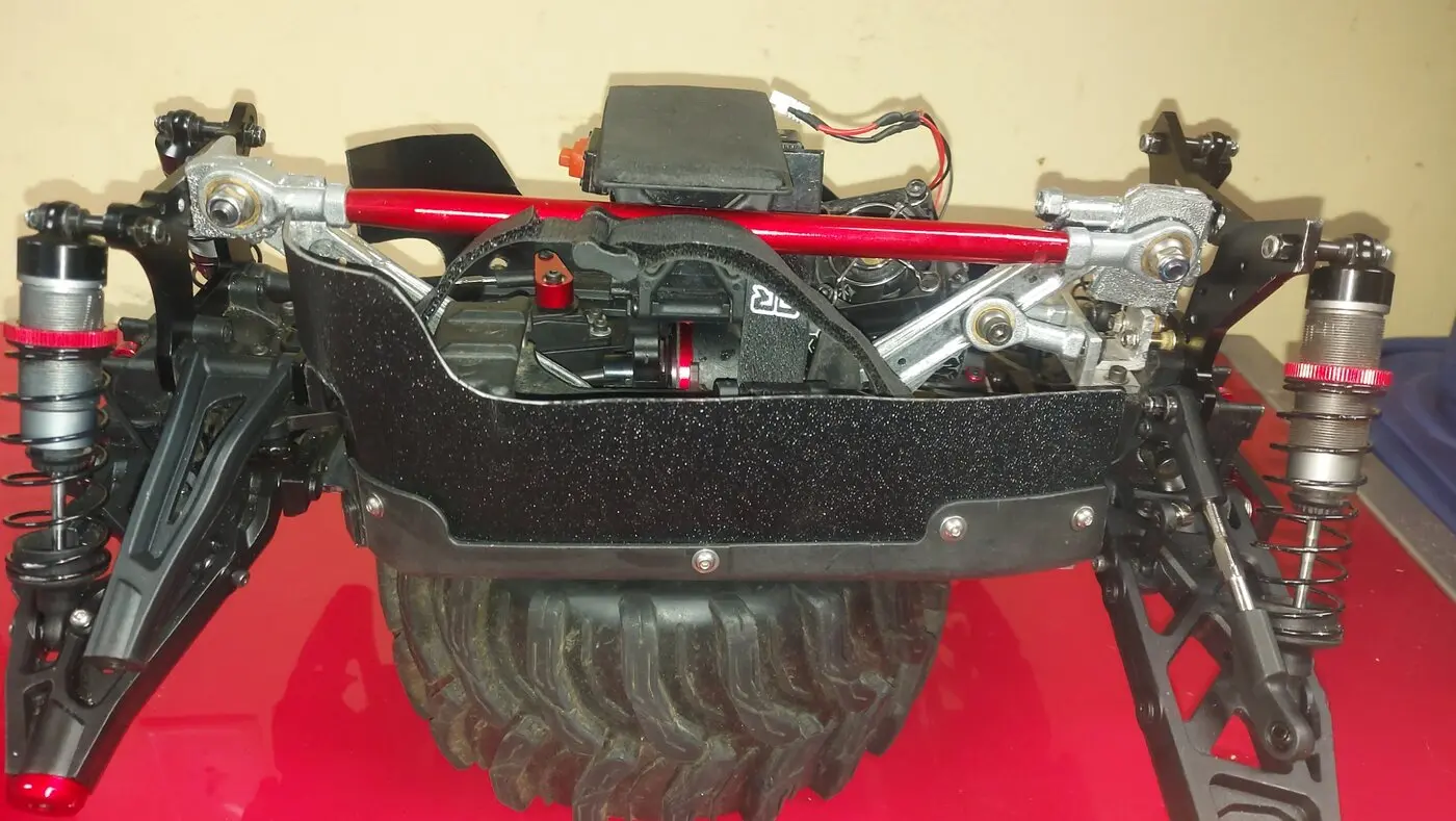

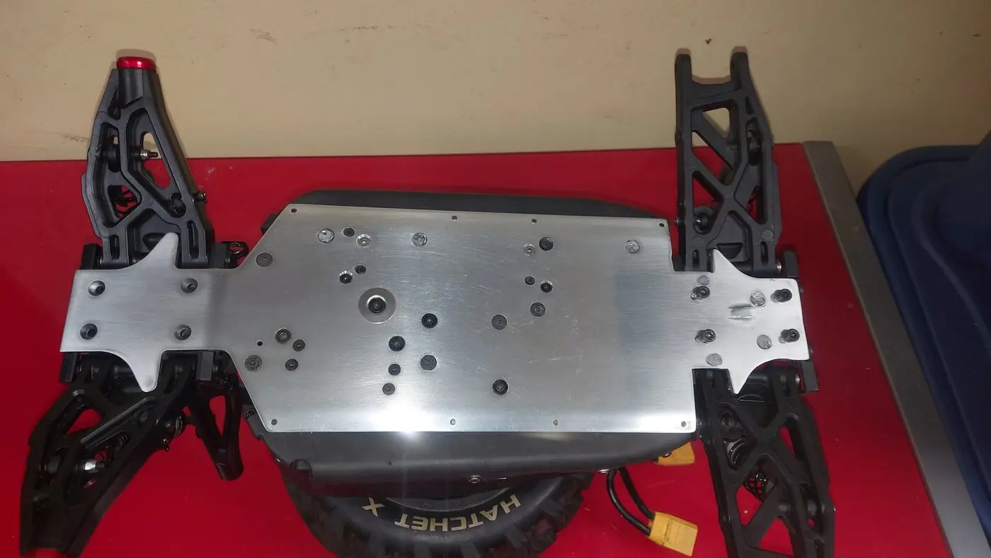

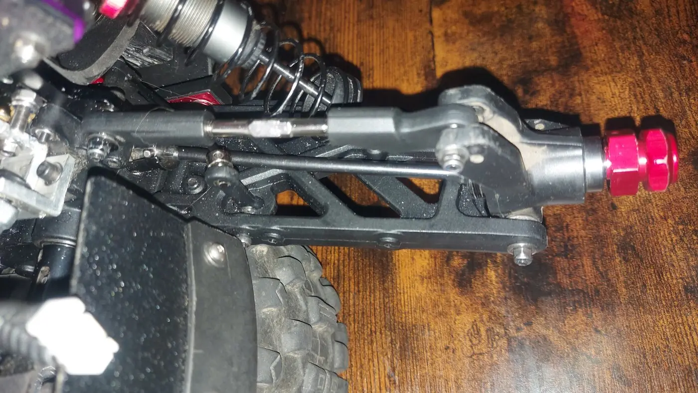

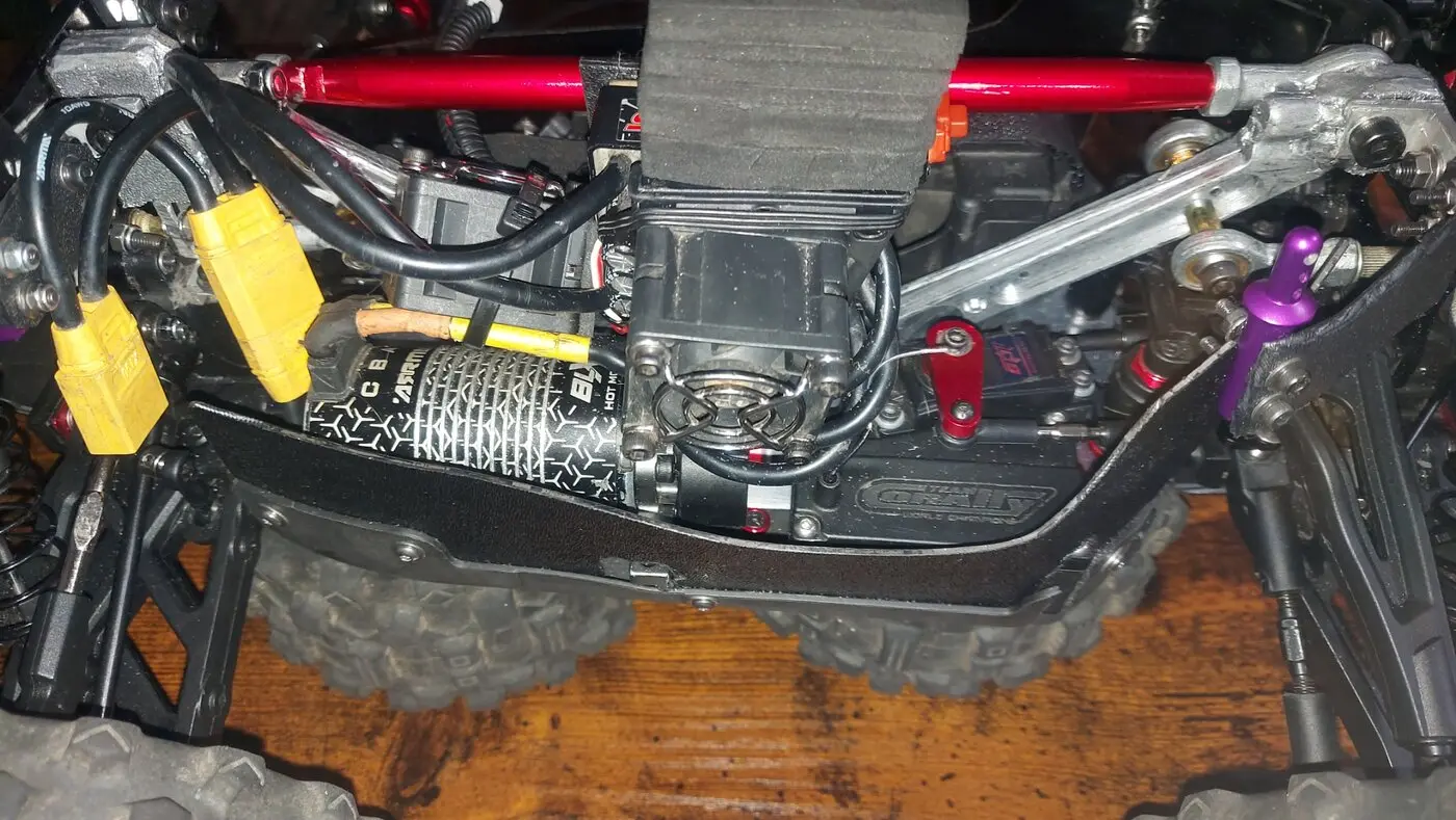

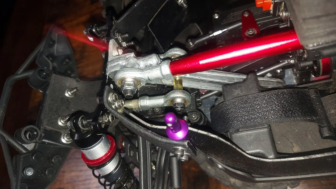

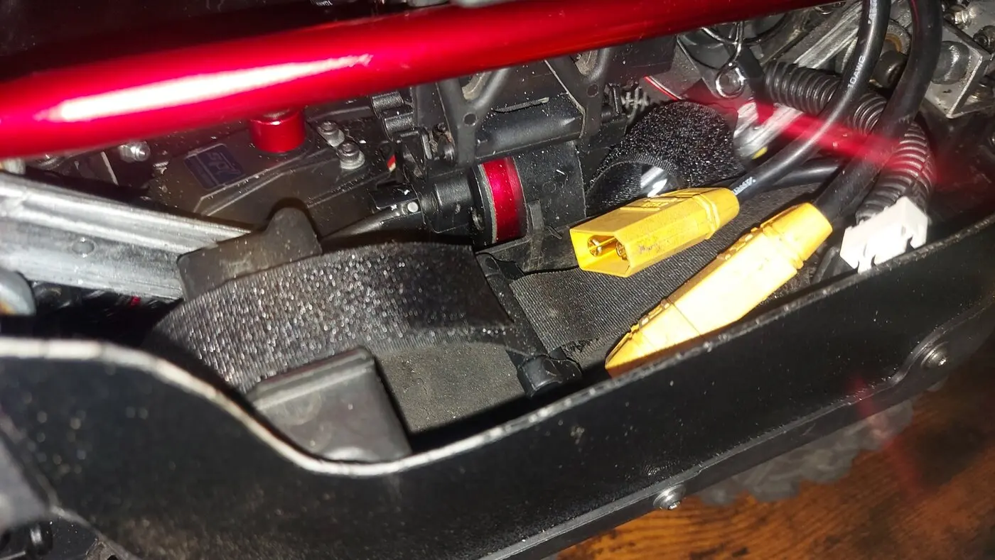

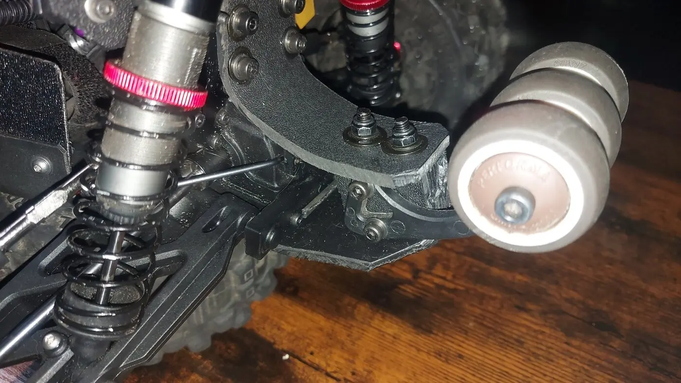

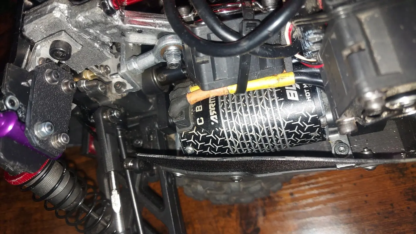

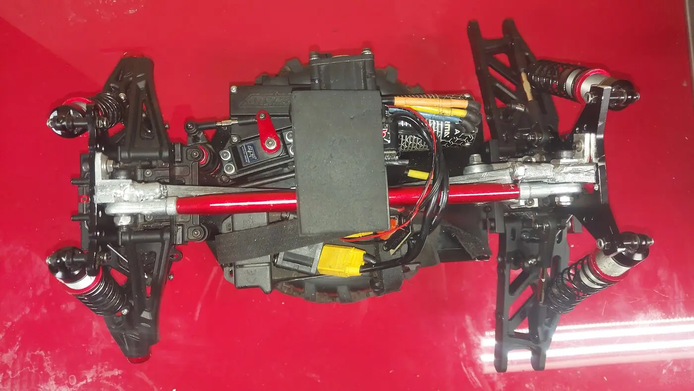

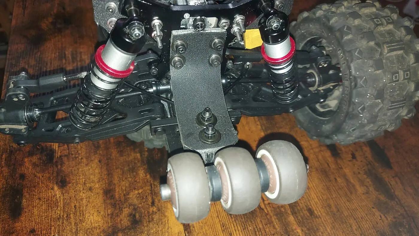

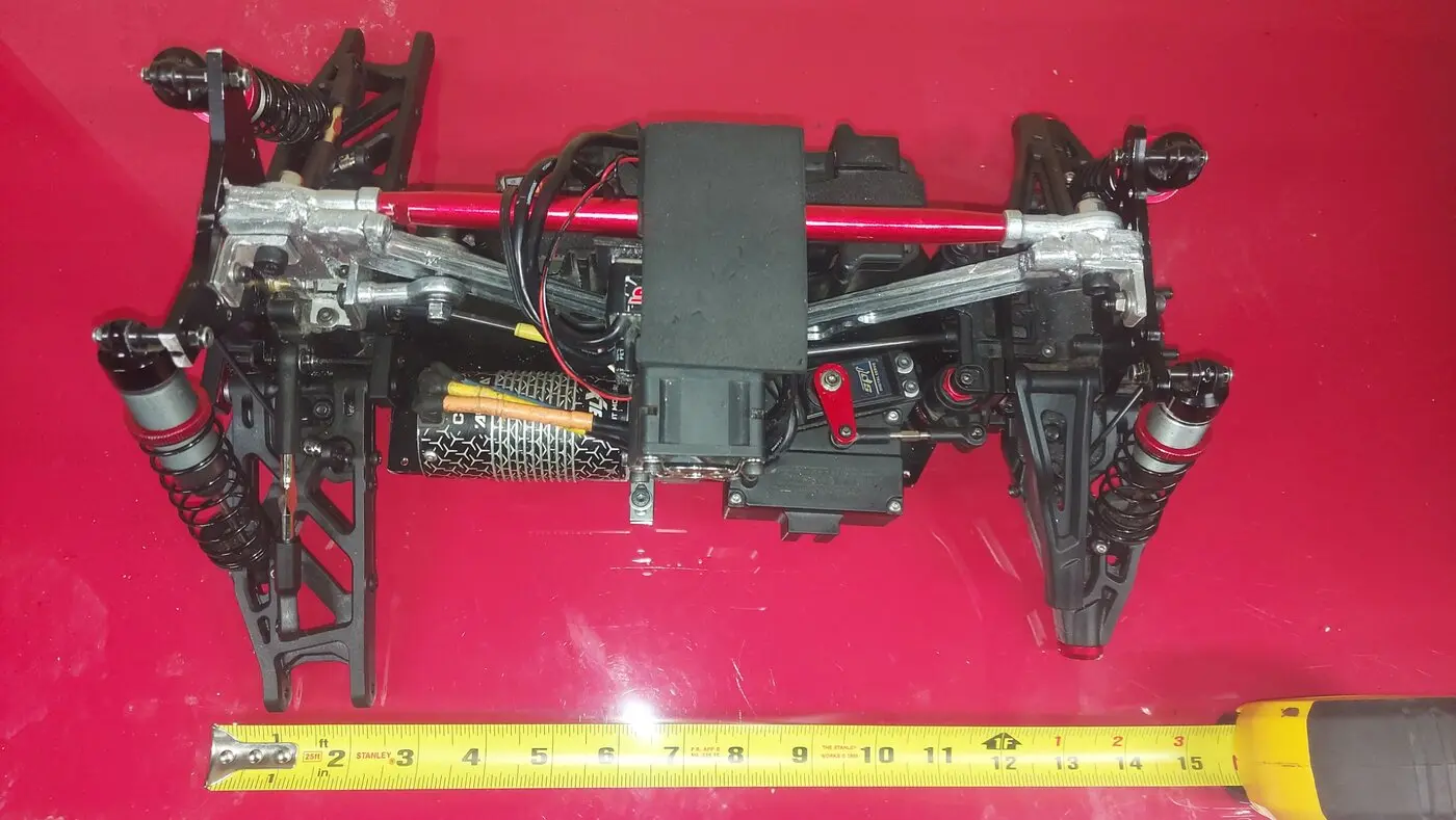

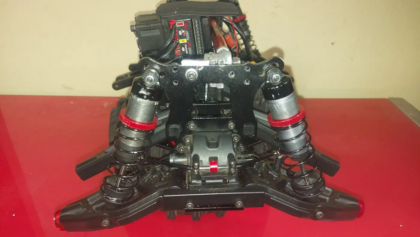

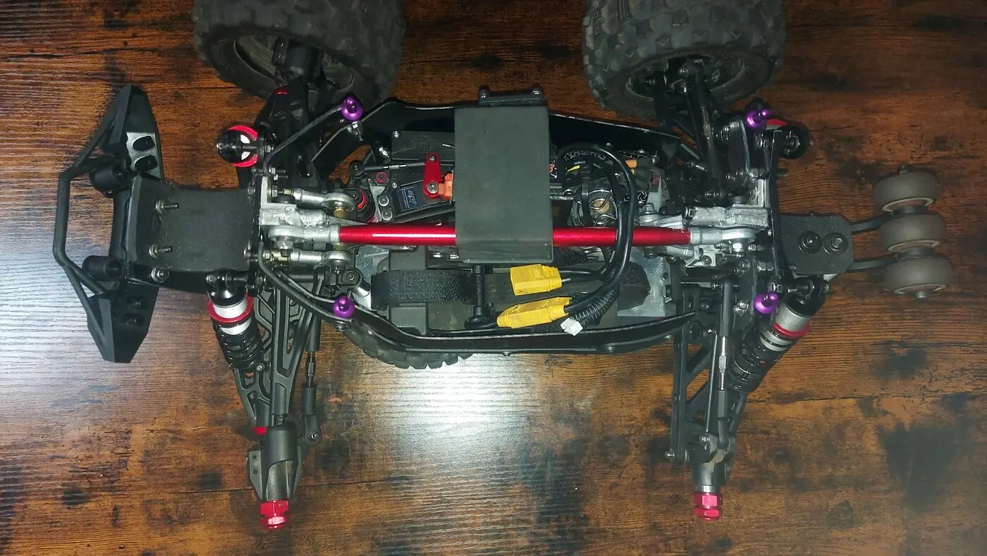

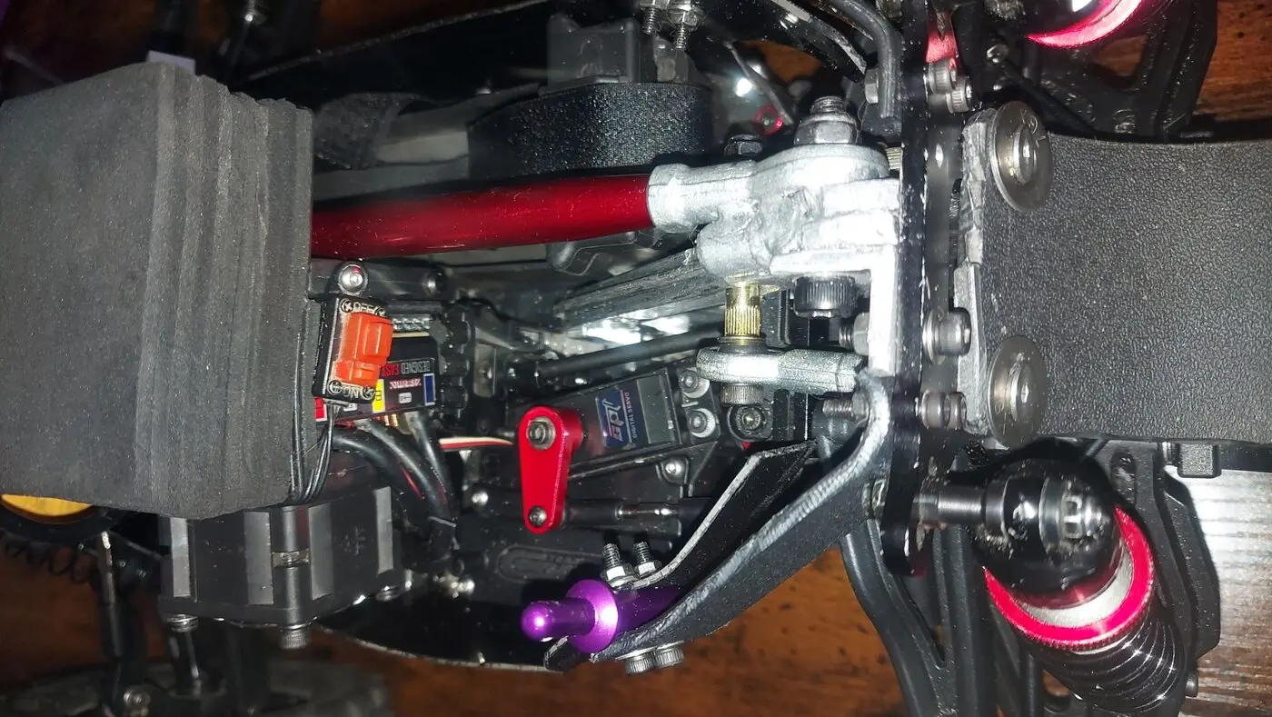

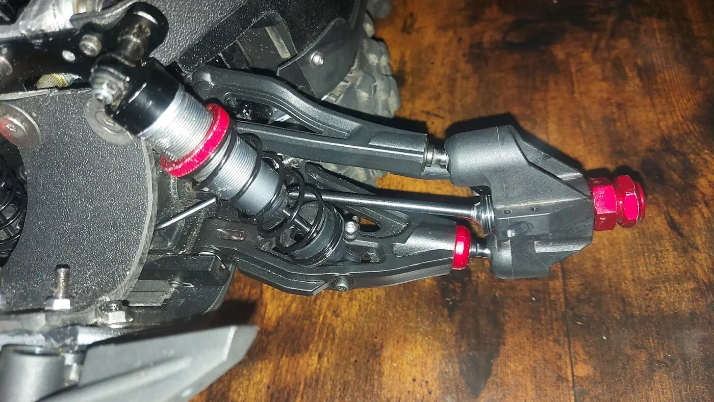

After playing around with the Sketer a bit, it started to scratch an itch with these brands being incapable of giving us a true 1/10 6s beefy monster truck. So I took the V1 Dementor that I blew the center diff & cut it up. There's way too much going on with this thing but I'll get around to all that later. It has super beefy Mojave arms & an Arrma battery tray. It also has a 46t aluminum center diff. I'm fairly certain it will be awesome on 4s & a nutball on 6s, if it ever see 6s. Even with all the beef, it's still light & the chassis is only 14.5" long. I'm probably going to attach more front bracing to equal out the rear bracing.
