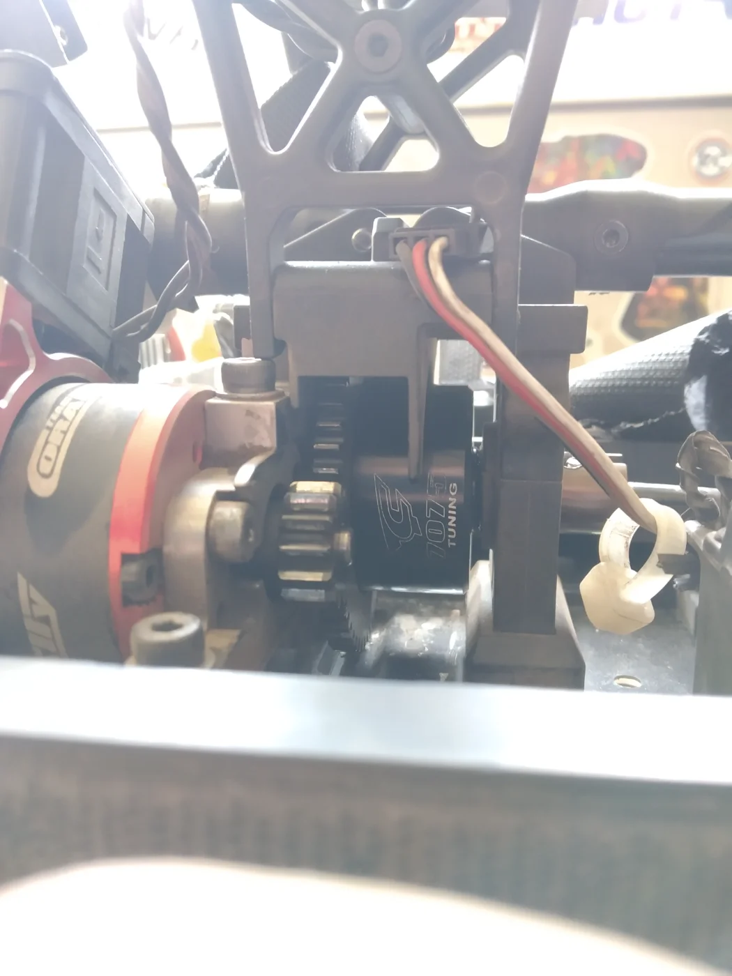

I have the 35mm Xtreme centre diff case C-00180-411 and the centre diff cross pins to fit it C-00180-184. Now I have the bits it's got me thinking 🧐....
My question is with the case only accepting the shorter pins is there any advantage to the longer pins that are in the stock centre diff case , I think they are 3mm longer & same thickness or am I overthinking this and just whack it all together and drive the thing 😅. Is my kagama 6s centre diff going to explode using this centre diff set up ?!!! 😆. Must be a reason why Team Corally use the longer pins in the kagama 6s.
Thank you 😊
Got it fitted cannot tell if it's made any difference but it looks nice and the inside has more meat holding the pins so I can see why it's called Xtreme :) also fitted the stock team corally 6s motor, I should of got one of these in the first place it's bloody lovely next to no cogging on 13t pinion loads of torque but as you all say it runs bit hot!
The ADU diffs are pretty nice too and are easier to service because they have a separate steel plate at the back with a lip around the edge that engages the center section. I recommend polishing the bore for the outdrive on that end with some 2500 grit sandpaper though. Not that's it's rough or anything but polishing the bore will make it nice and glassy smooth. I got the front and rear ADU diffs but I haven't seen a reason to replace the stock center diff.
