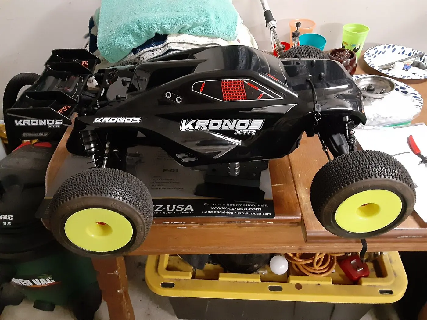

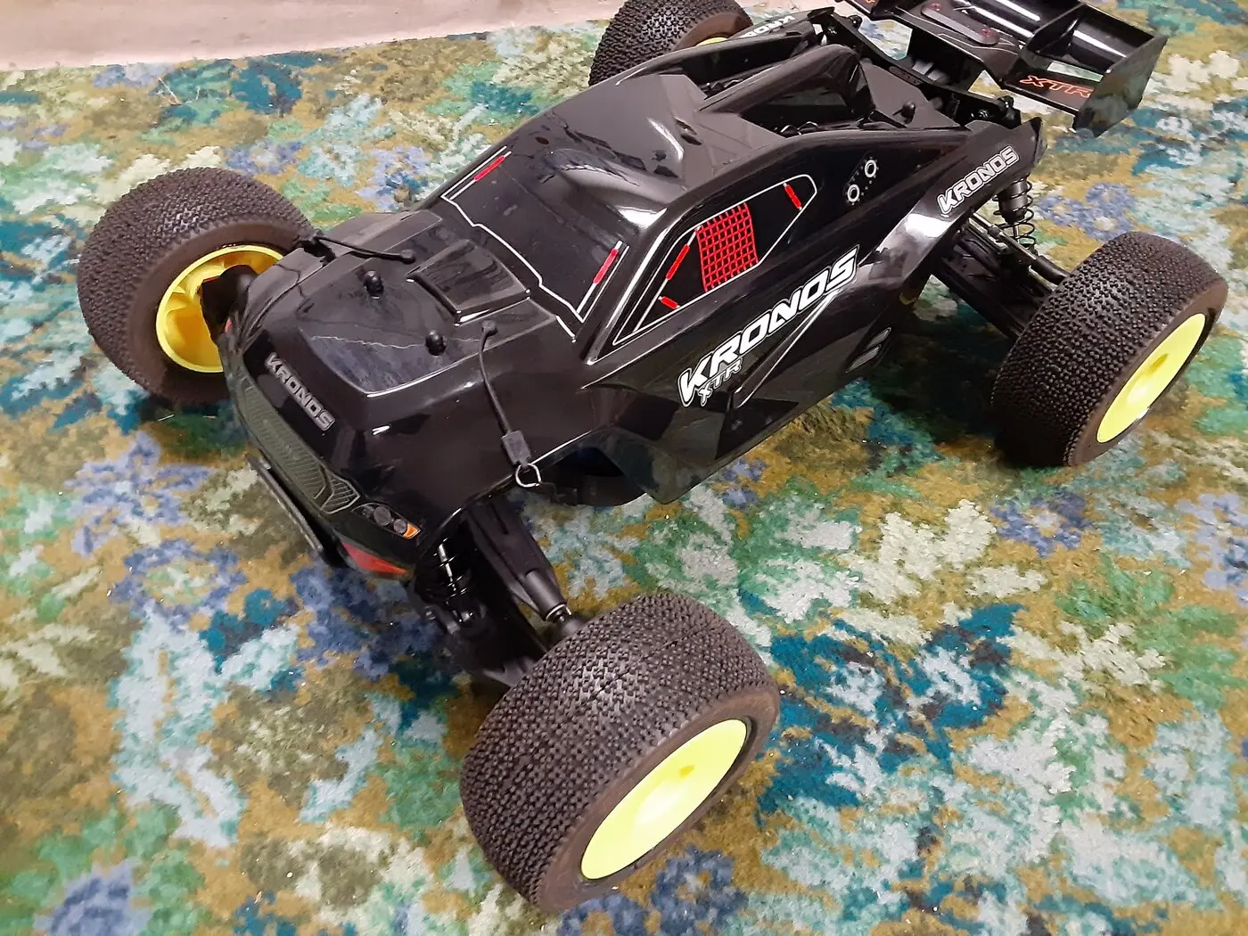

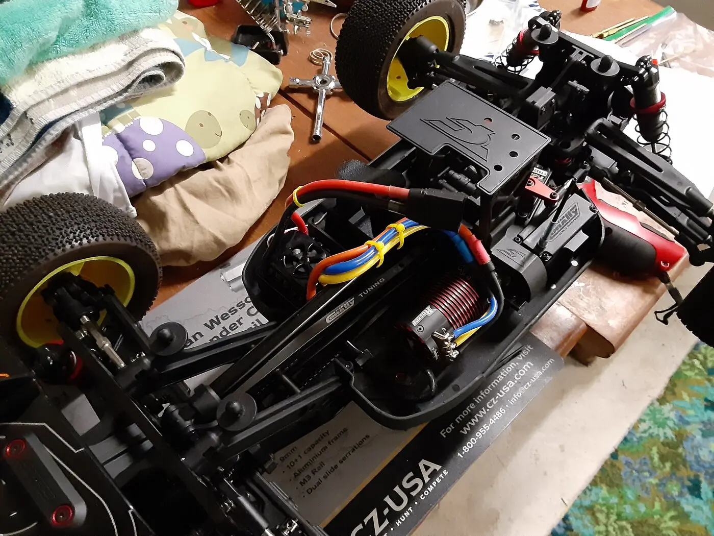

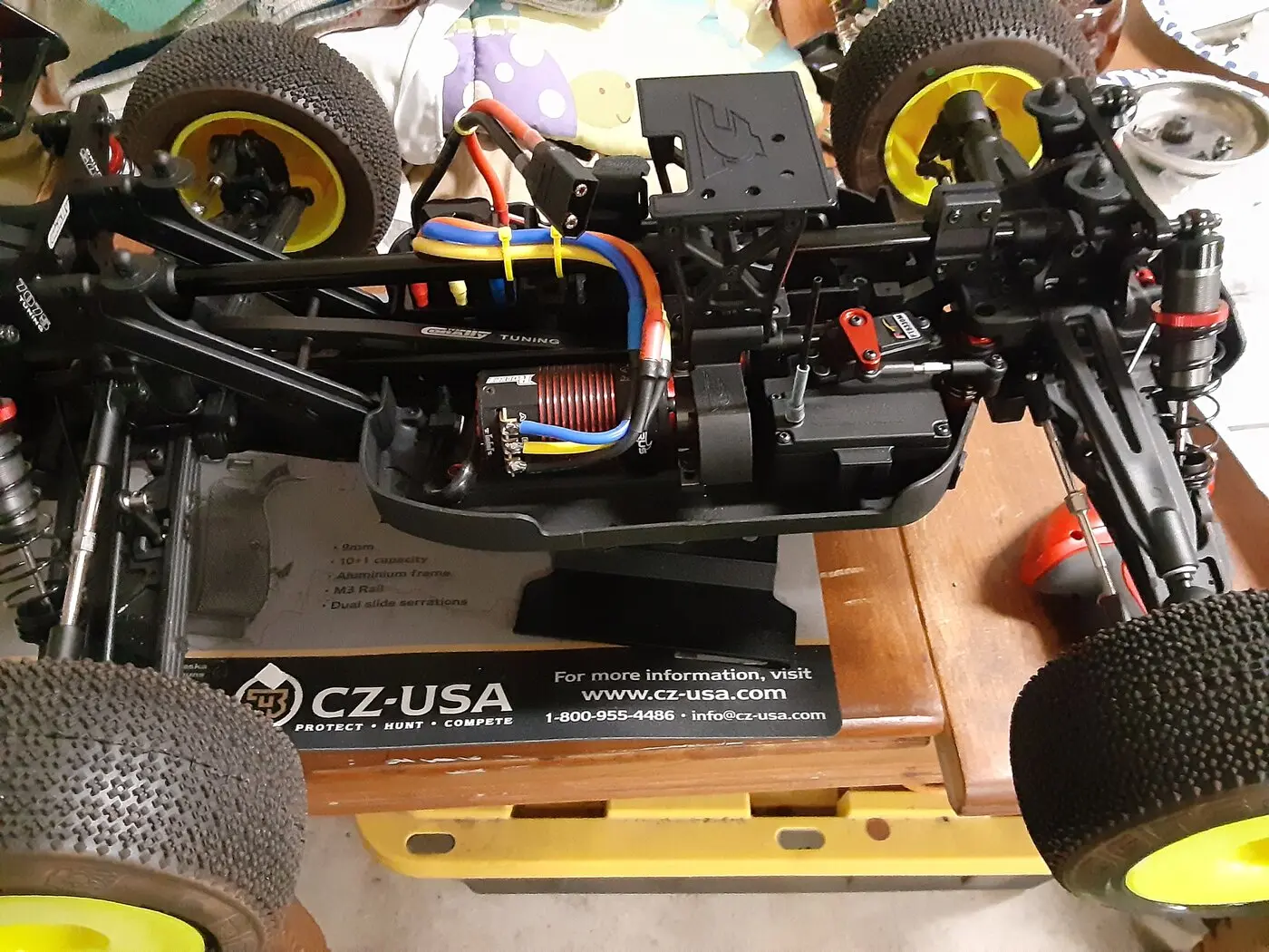

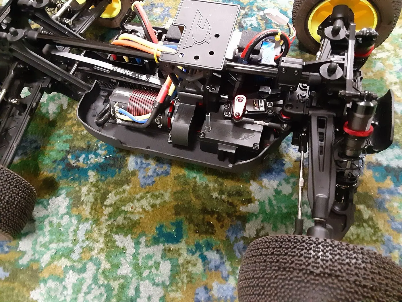

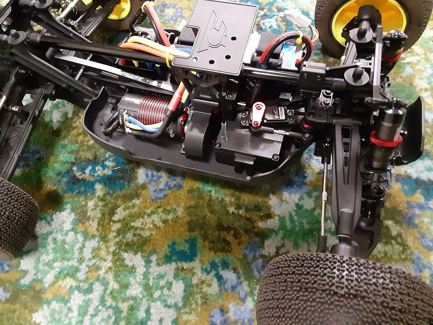

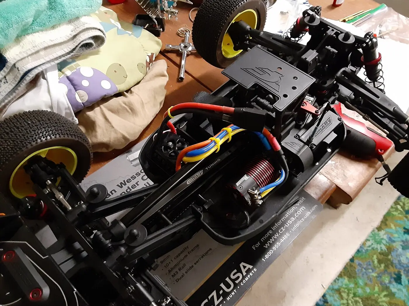

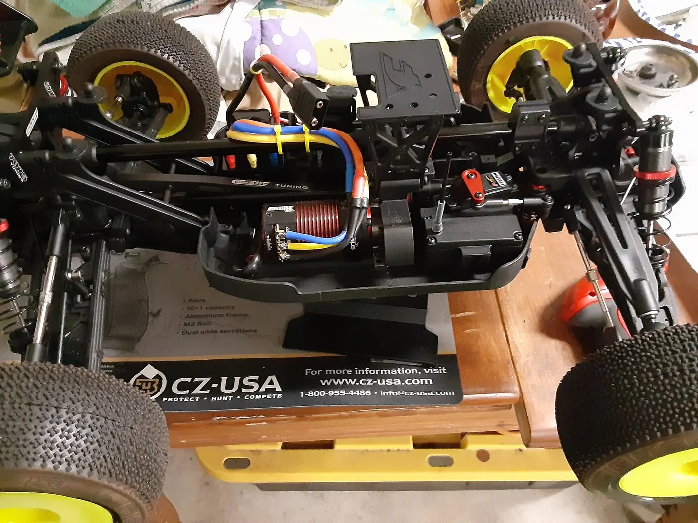

here's a Kronos XTR that I bought off ebay, it was incomplete but nearly new. the only body it came with was the clear one so I painted it black because that's the only color Tamiya rattle can paint that I had. I through in an inexpensive surpass hobby sensored 150a ESC w/single XT90 and a 1700kv Taurus sensored 4274 motor. starting with a 13T pinion 52t spur for now. refilled the diffs 60k front 100k center and 30k rear. the diff housings had very little grease on the inside and the diff fluid was low compared to my liking. Losi digits tires that i am going to change as well, i just wanted to get it up in running with extra parts i had around, I plan on putting a max 6 system. I also added the center brace as this wasn't the 2022 version.
