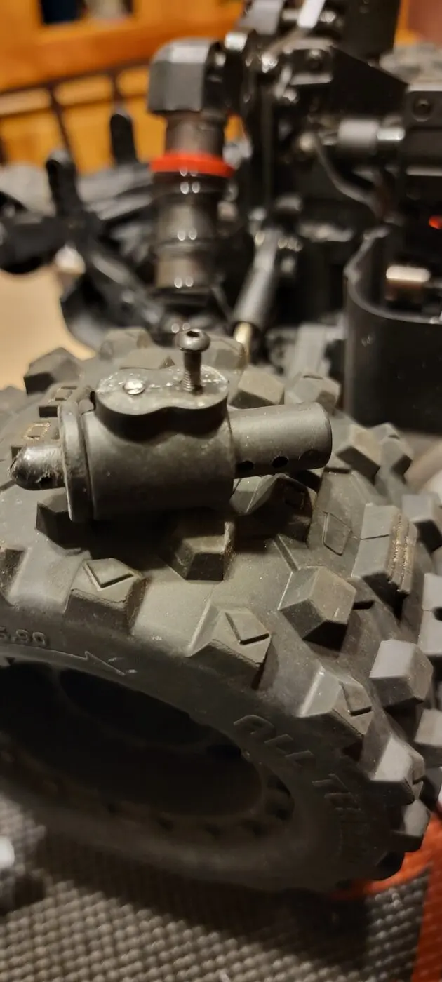

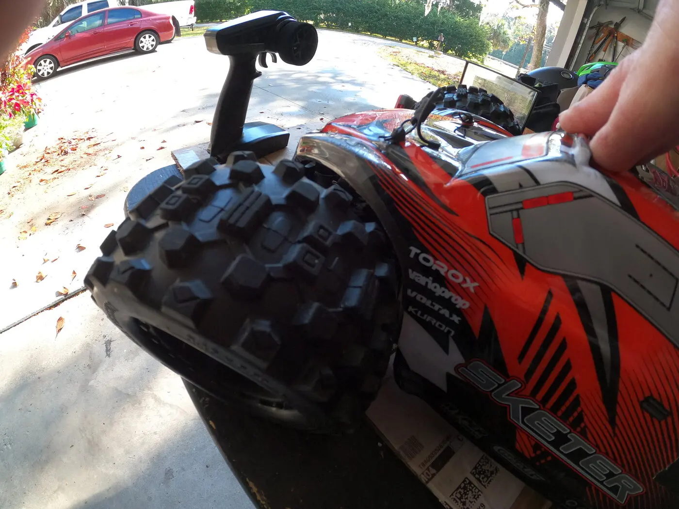

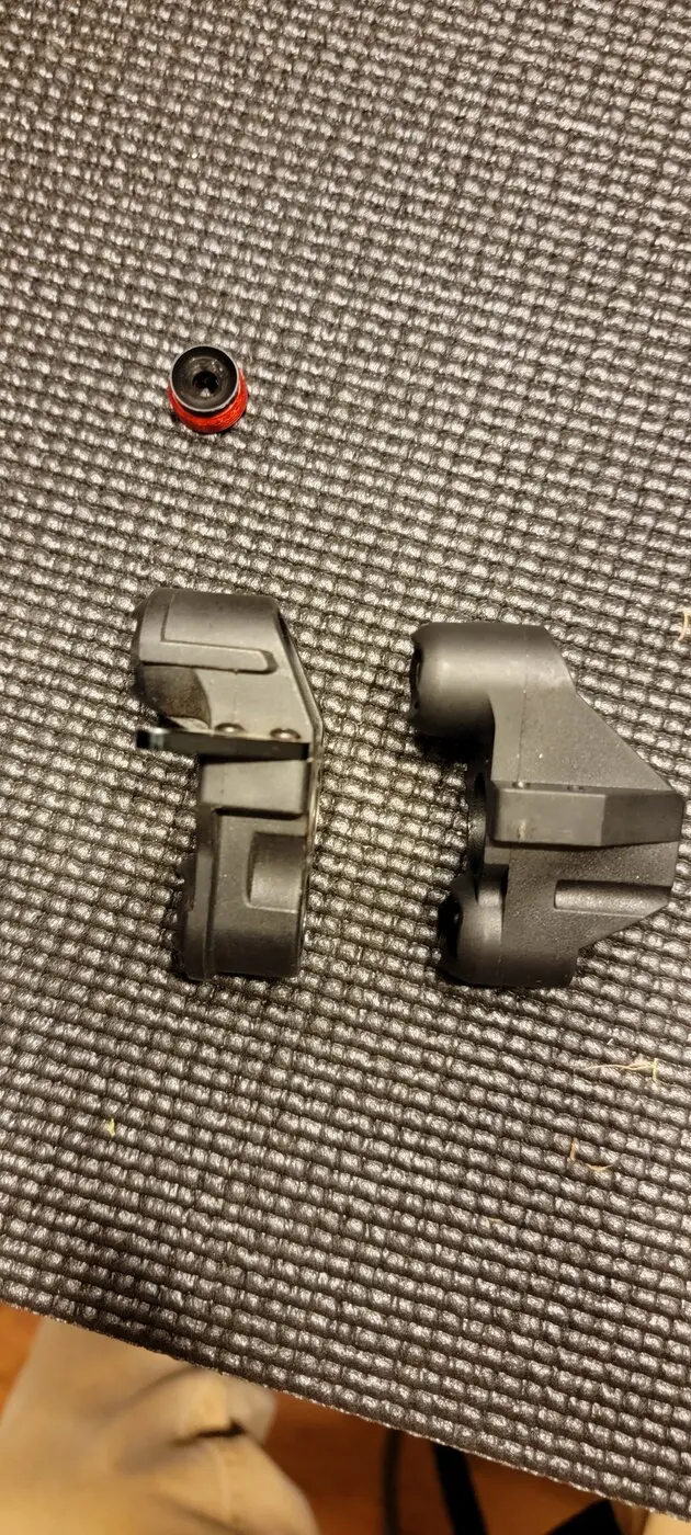

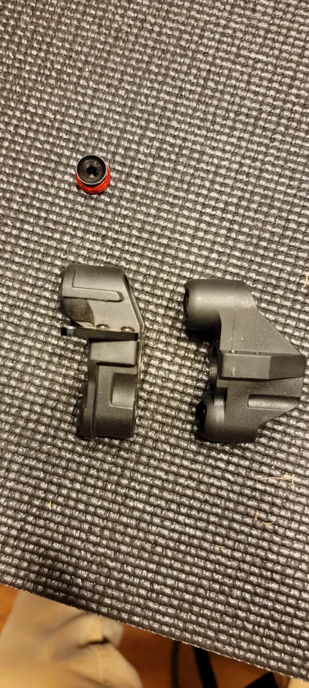

Here's a visual comparison between the Sketer hubs and the Kronos, etc hubs.

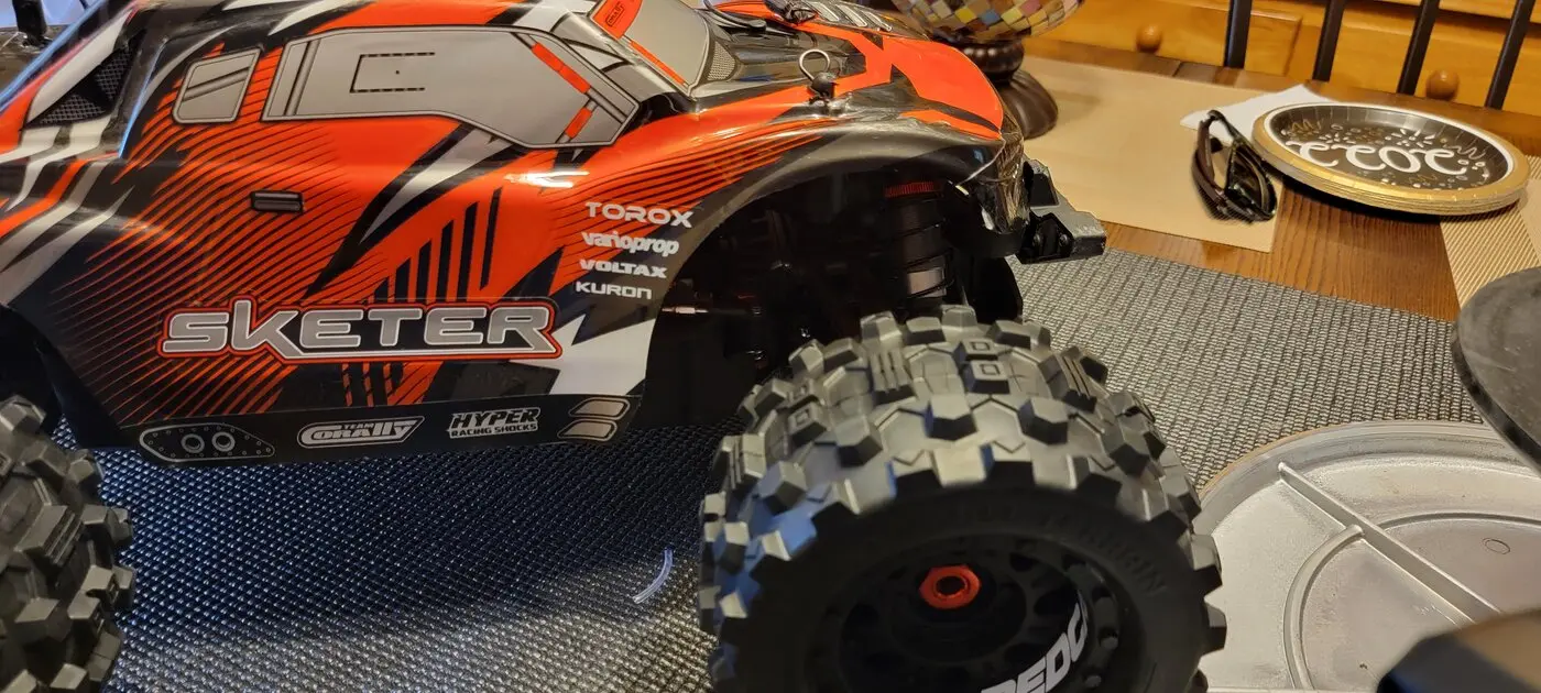

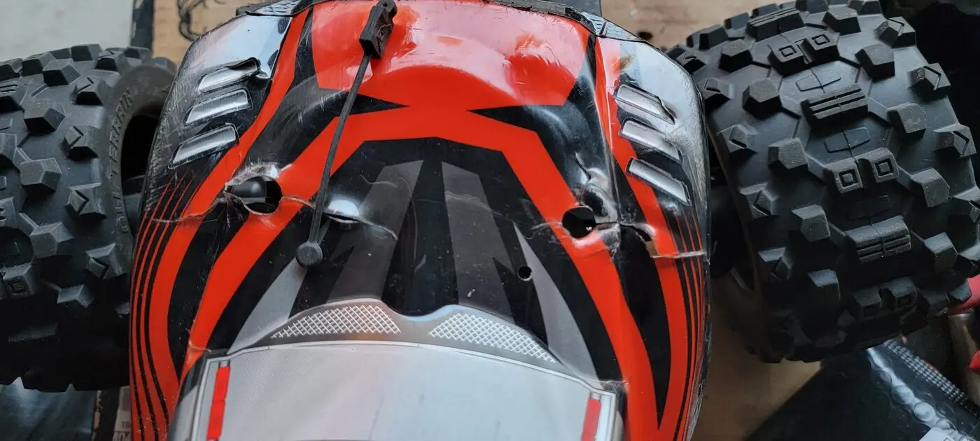

Can’t wait to see what you say about running it wide.. I feel like it would kinda take away from the feel of the “1/10 scale” feelingHere's a visual comparison between the Sketer hubs and the Kronos, etc hubs.View attachment 433View attachment 432

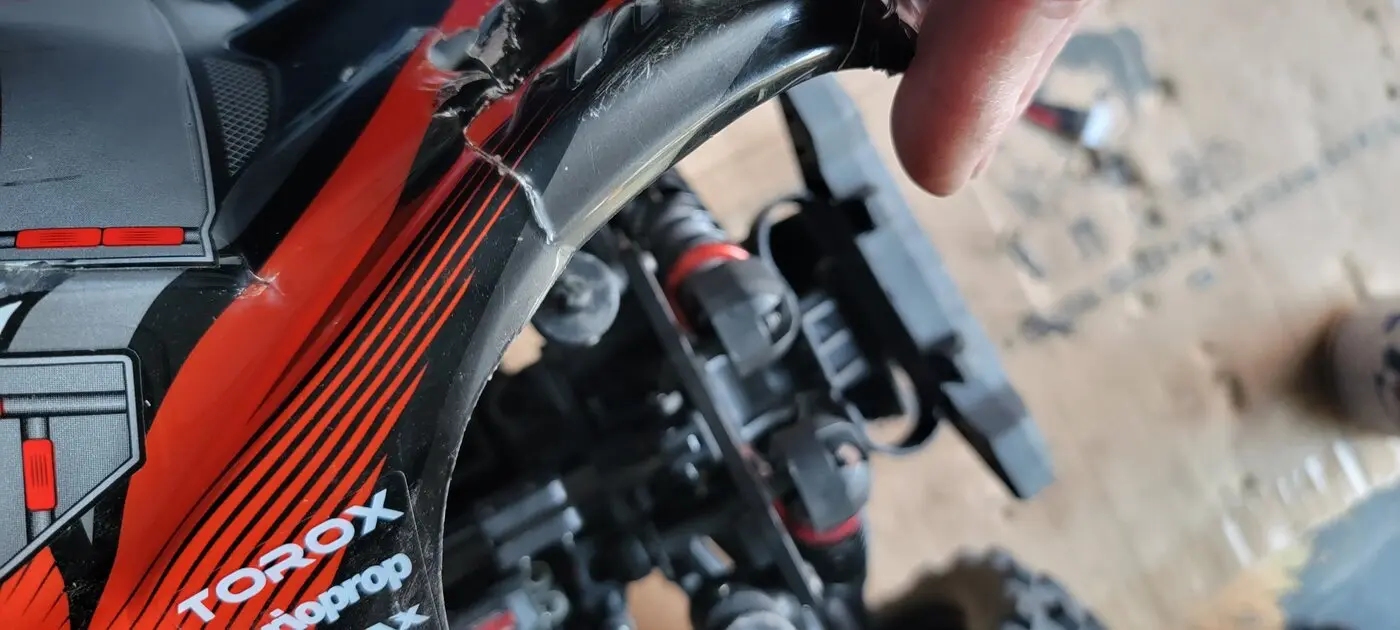

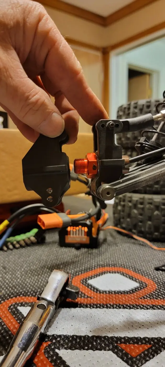

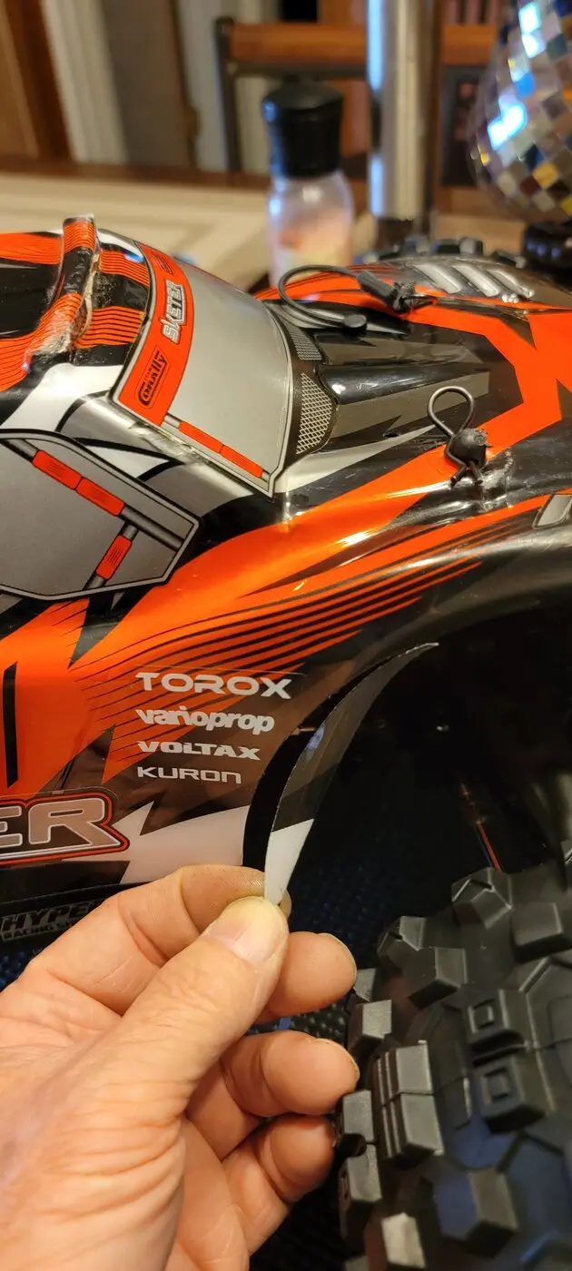

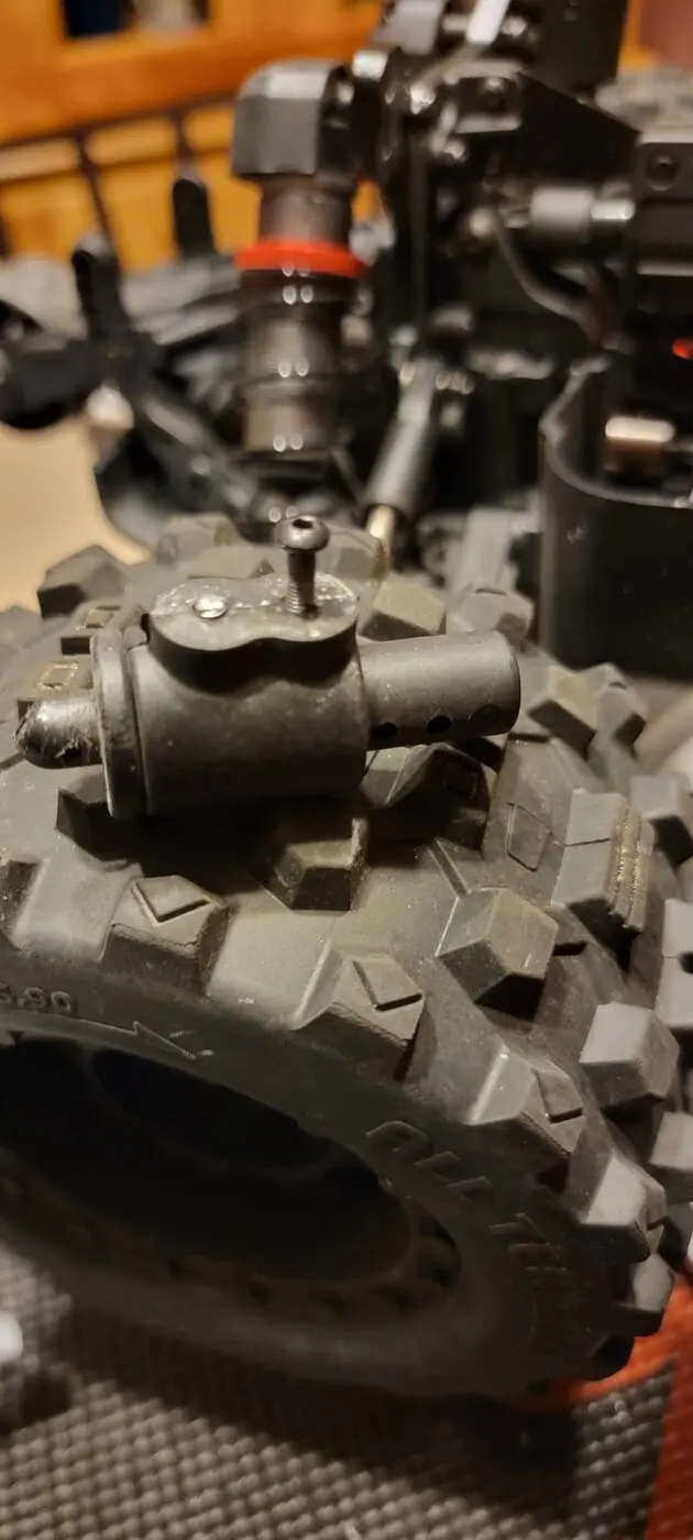

Lookin good bud. Too bad about the body… can’t even get a replacement yet! LolPreliminary report is in. KAIJU wheels will fit with the wide hubs and a small shave of the front wheel openings. Steering isn't all that bad IMO. Still handles pretty well, and is fairly maneuverable. Video to follow later.

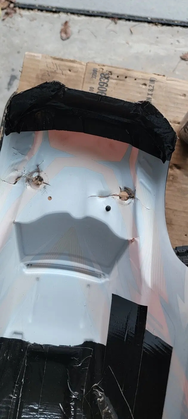

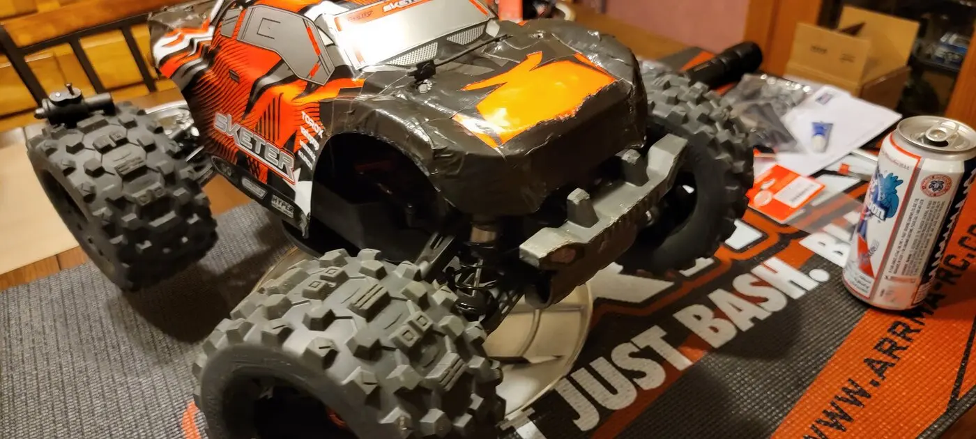

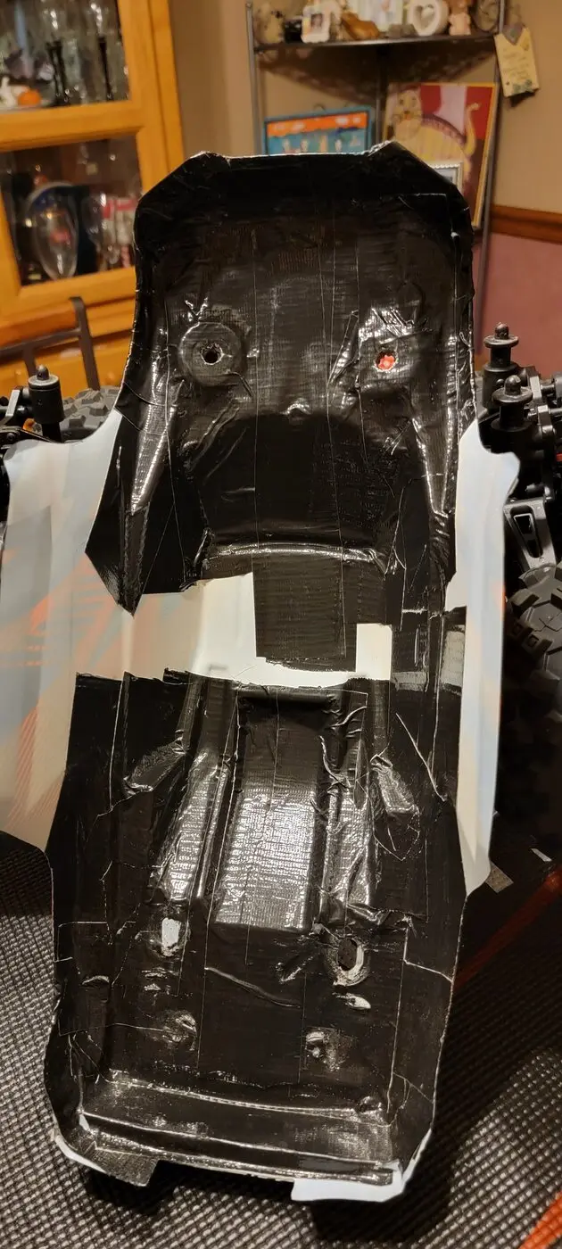

My body is destroyed. Tape everywhere now.
I know. Pretty soon I'll just be running a roll of duct tape.Lookin good bud. Too bad about the body… can’t even get a replacement yet! Lol
Kinda for sure, I can live with it though.Can’t wait to see what you say about running it wide.. I feel like it would kinda take away from the feel of the “1/10 scale” feeling
Dang! Giving it hell and still only minor breakages… not bad for a 4s RTR eh?I know. Pretty soon I'll just be running a roll of duct tape.

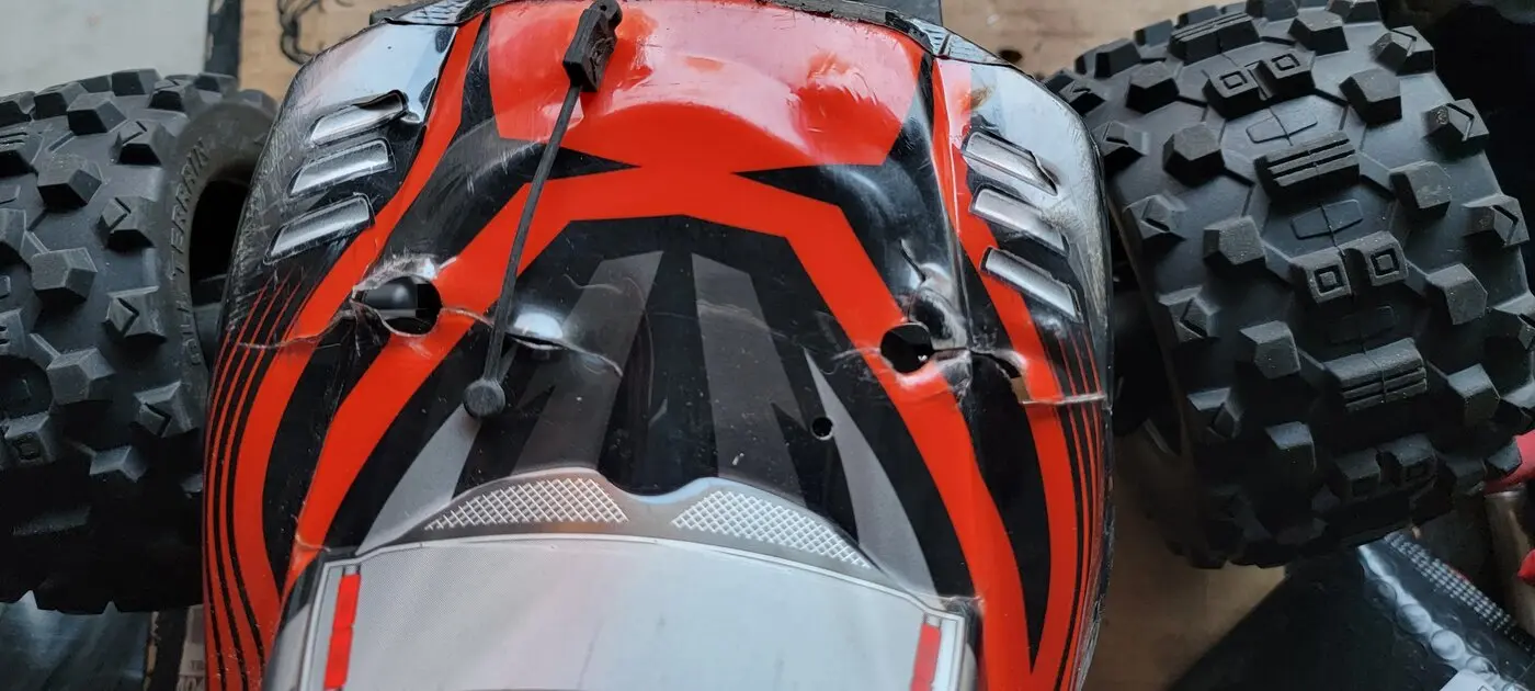

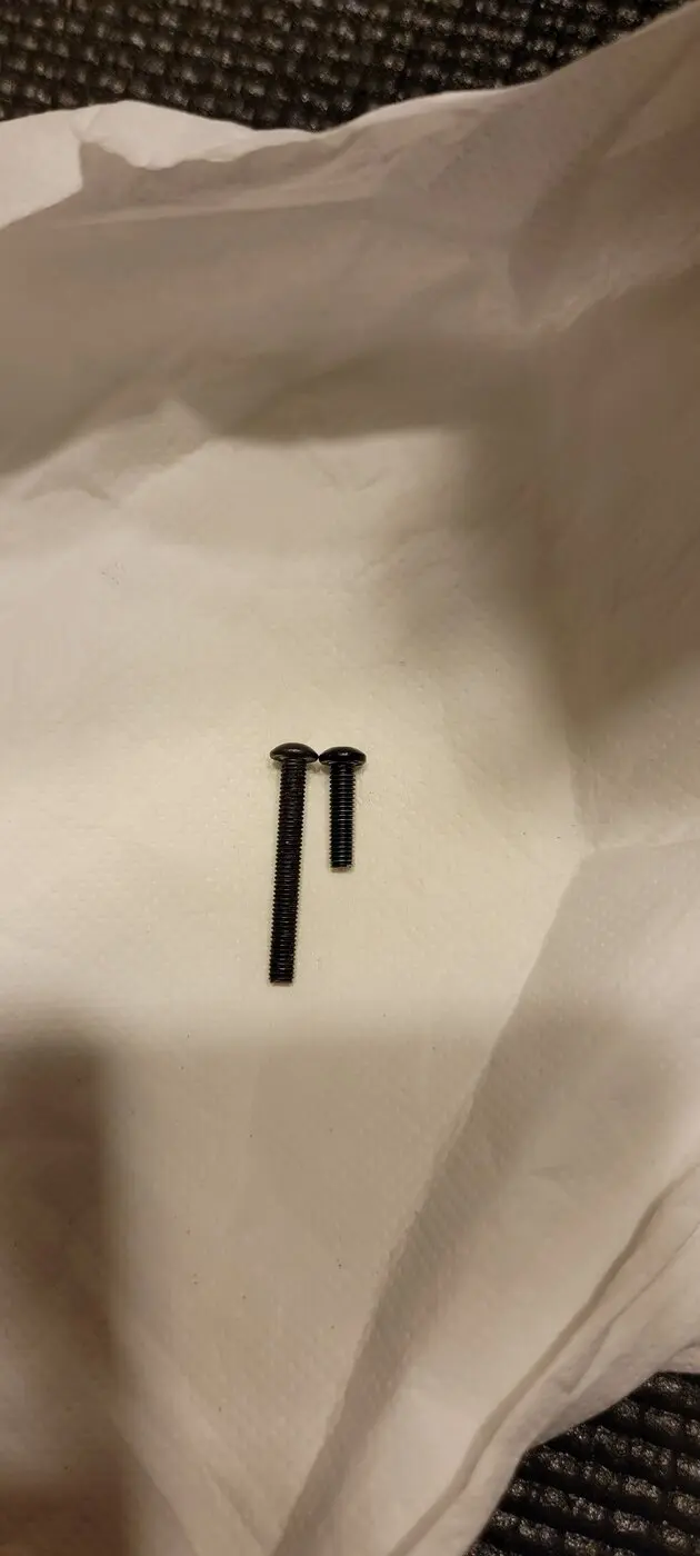

Sheared a screw from the right rear body mount. The mods I did to the front mounts worked, although the body didn't.
Kinda for sure, I can live with it though.![]()

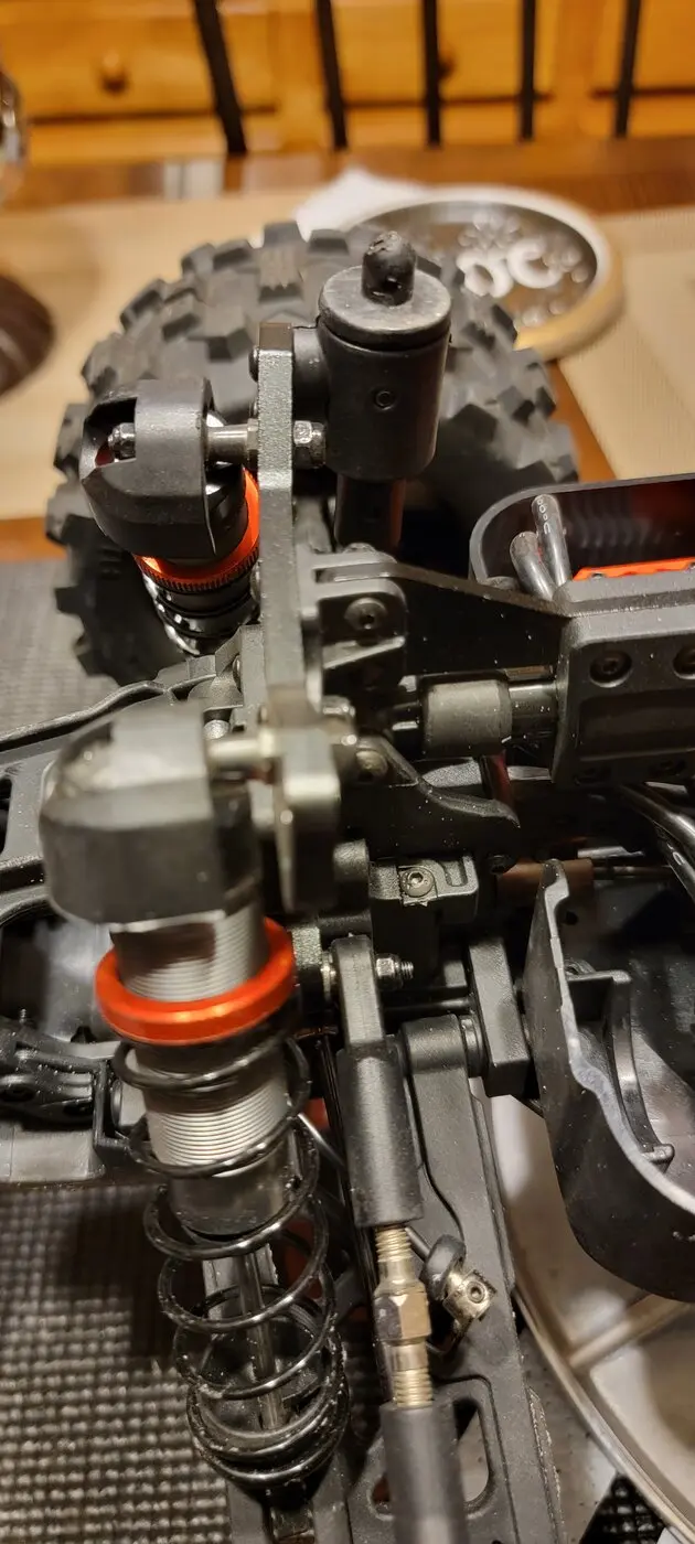

Rear shock tower is collapsimg around the center brace...Dang! Giving it hell and still only minor breakages… not bad for a 4s RTR eh?
Ahh that’s just a little normal bendage.Rear shock tower is collapsimg around the center brace...

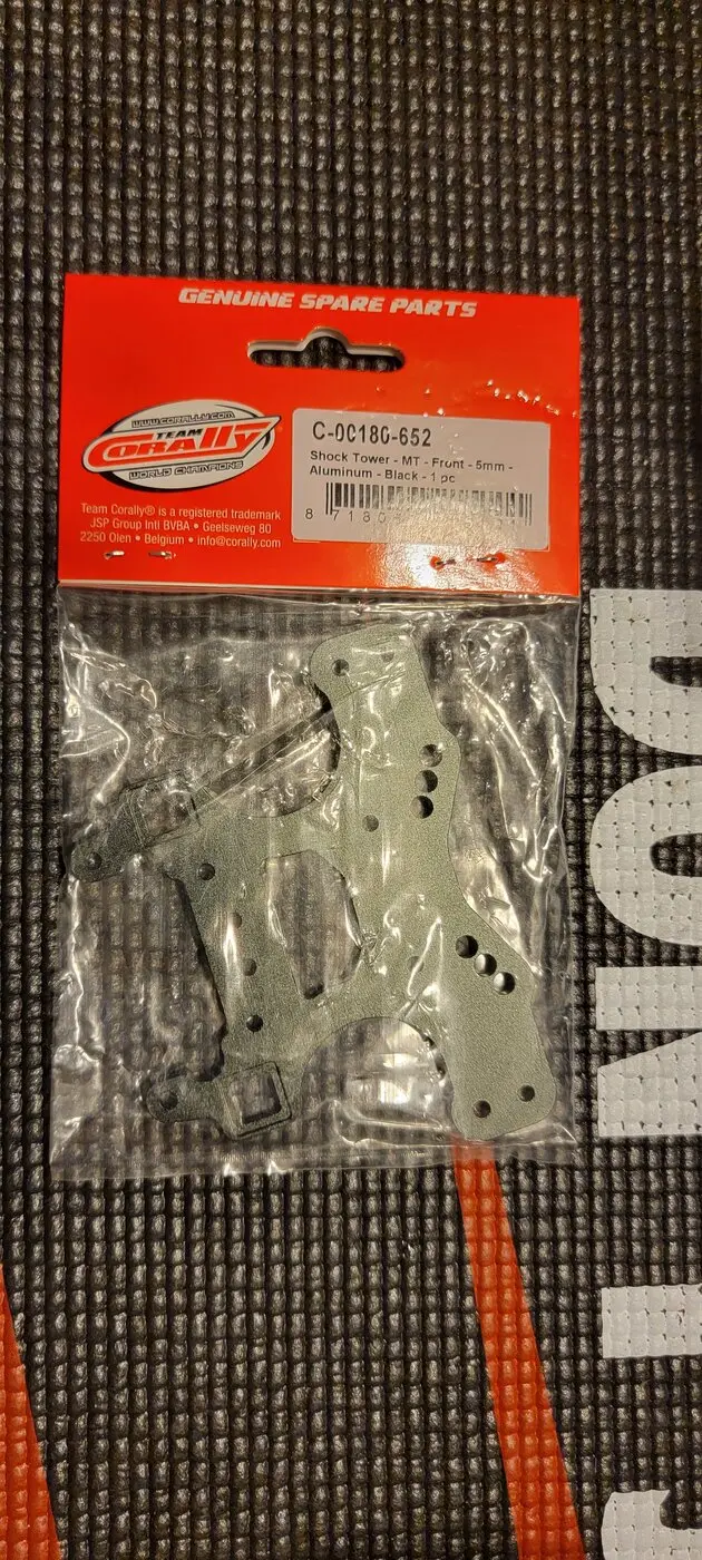

Wonder when they’ll release the Swiss 7075’s for it!

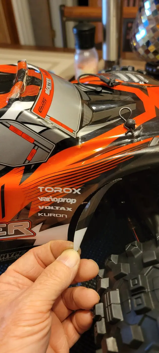

That's one tough body post, plastic totally intact but steel bolt broken..!!!
I ran these through them the second time. Done the fronts already.That's one tough body post, plastic totally intact but steel bolt broken..!!!![]()
