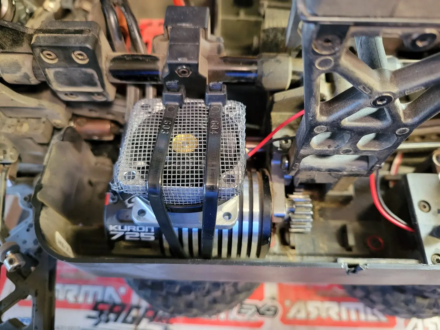

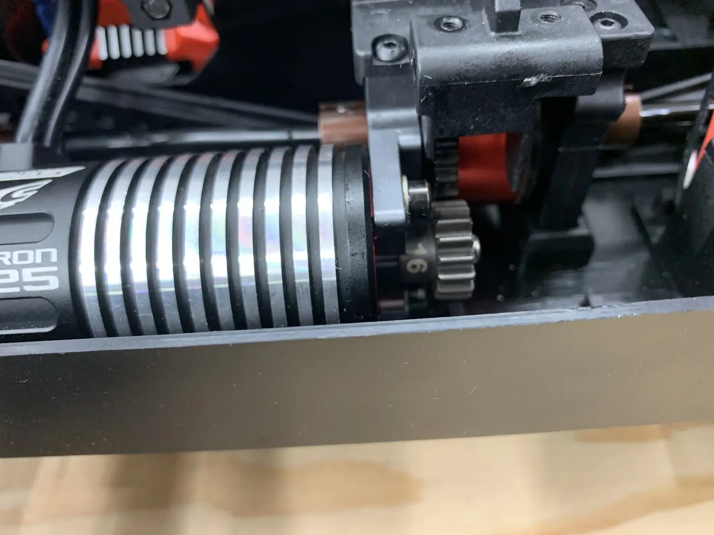

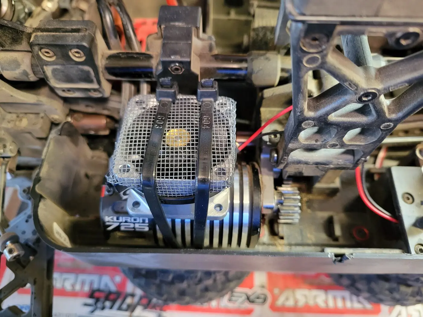

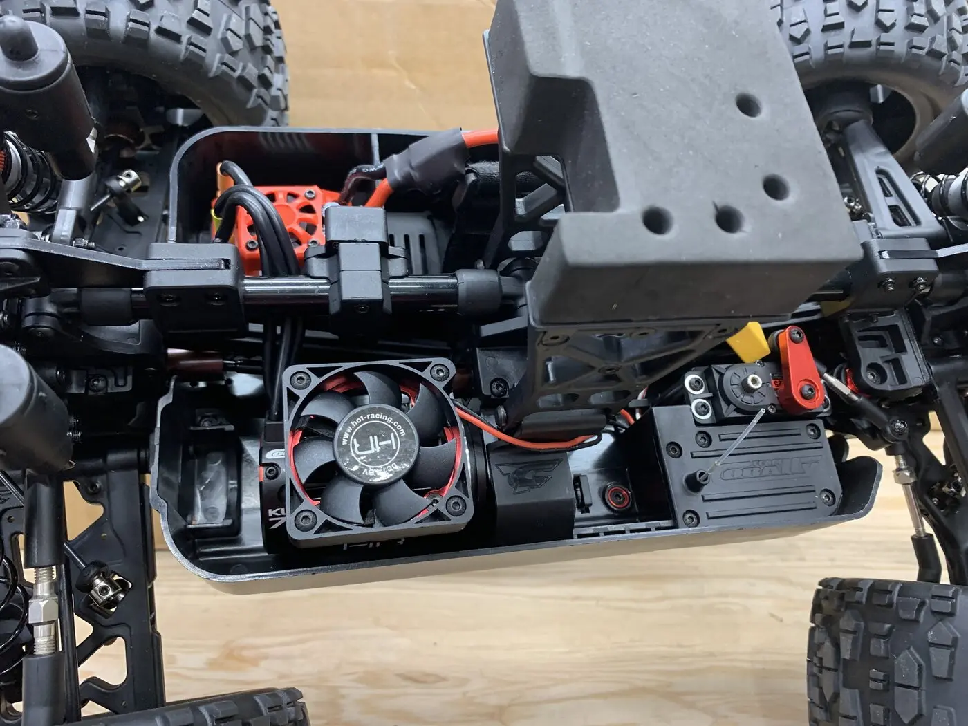

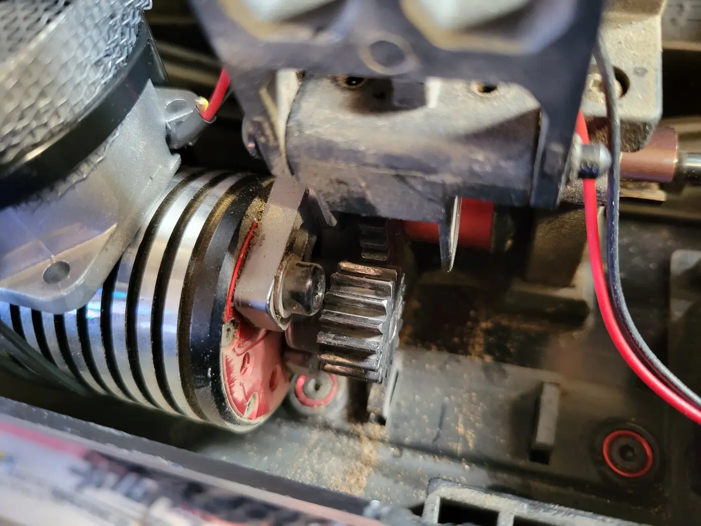

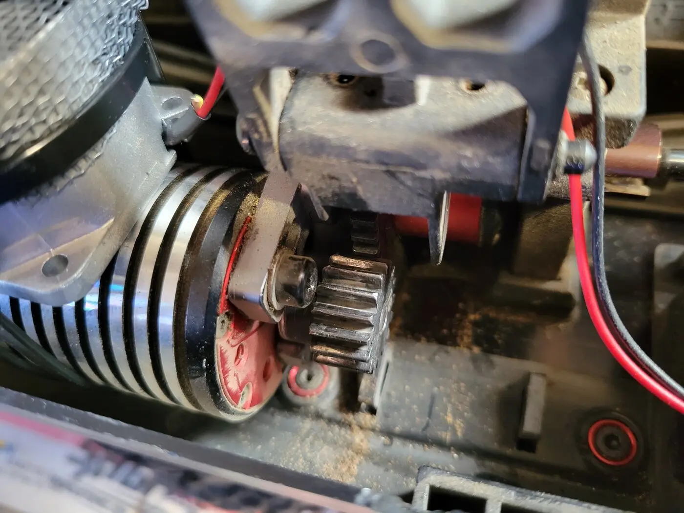

The other reason why Corally don't recommend higher than 13t/52t on the Kuron 825 is that it gets very hot. It's a beast on 6S, no doubt about it. Just make sure you keep it cool to avoid cooking your motor/ESC. Fans really help!I replaced the stock 13T pinion that came with my new Asuga roller with a Tekno 16T pinion with M5 grub screw. According to the Asuga manual, the 16T should give me 47 MPH on 4s and 70 MPH on 6s. The motor mount is at near capacity with the 16T pinion and 52T spur, and that's why Corally doesn't recommend that combination in the manual.
