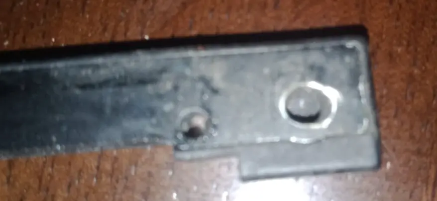

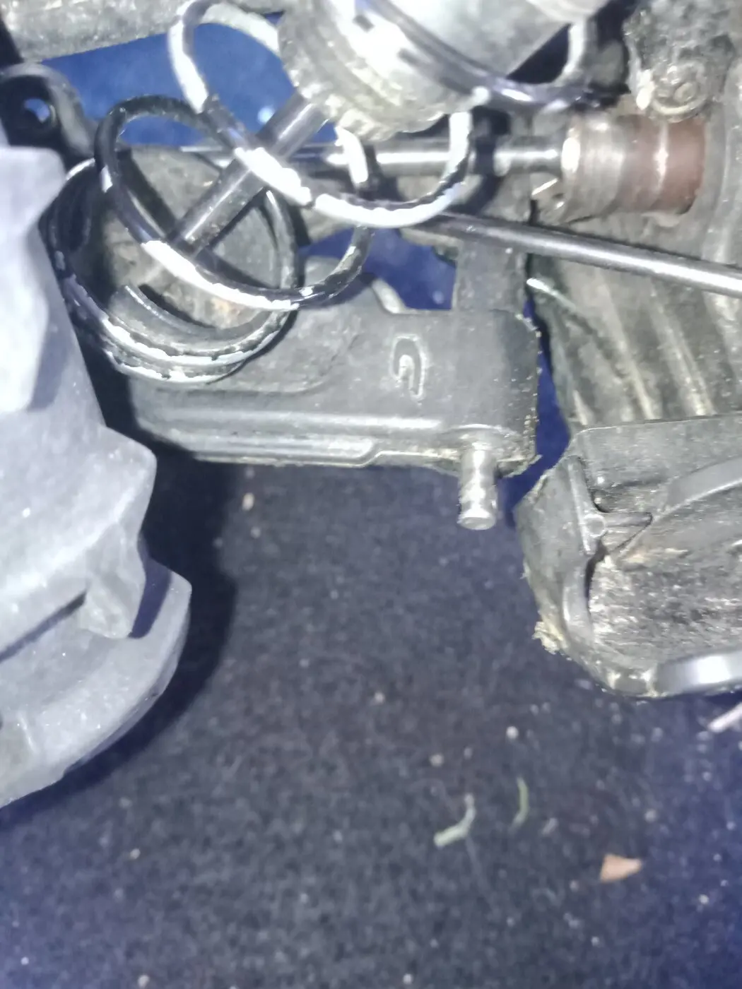

Hmmm. Here's the front piece that holds the hinge pin. It looks a little worn out/open wider than it should be. Does it look like this is the issue?
Here's the rear one. Does it look okay, or does it look like it needs to be replaced?

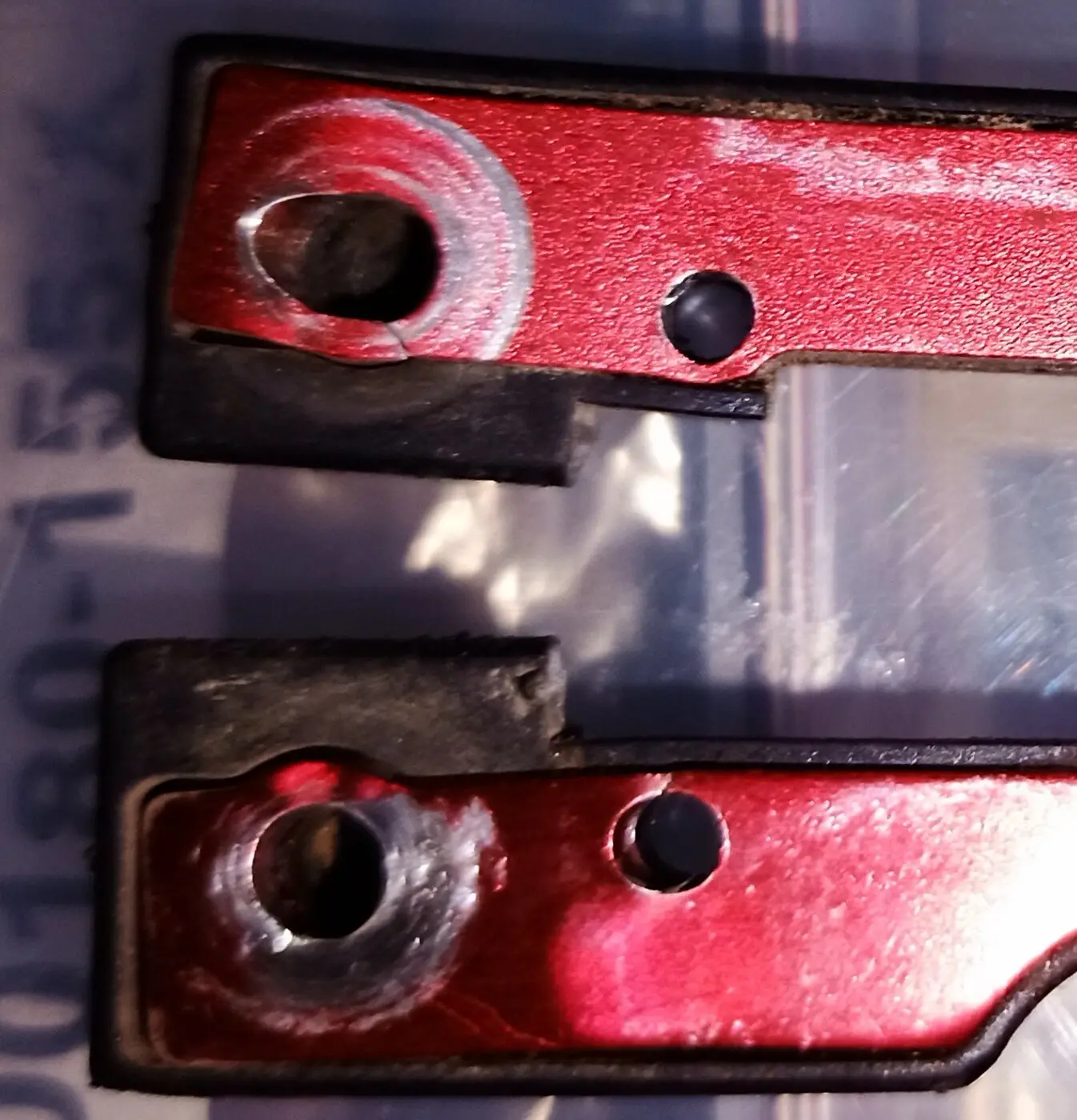

Well these were mine after I face-planted the back of a berm.
Both front and rear were damaged, as well as the pin snapping. I found the new pin didn't fit well, so I had to replace the braces too 😕
I think that the worn holes will allow the pin to slip out as it bends, rather than a good hole which will be more of a shearing force.

Okay. I'll order them. How does one replace the rear hinge pin plate? Will I remove the front diff to access it?
If it's the same as the 6s trucks, then the diff case can be removed from the chassis with 4 csk bolts, 2 from the steering posts, a couple from the front brace, one from the servo link, and then the whole assembly comes away for easy access to the hinge pin braces.
