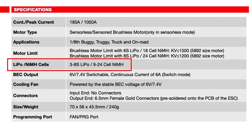

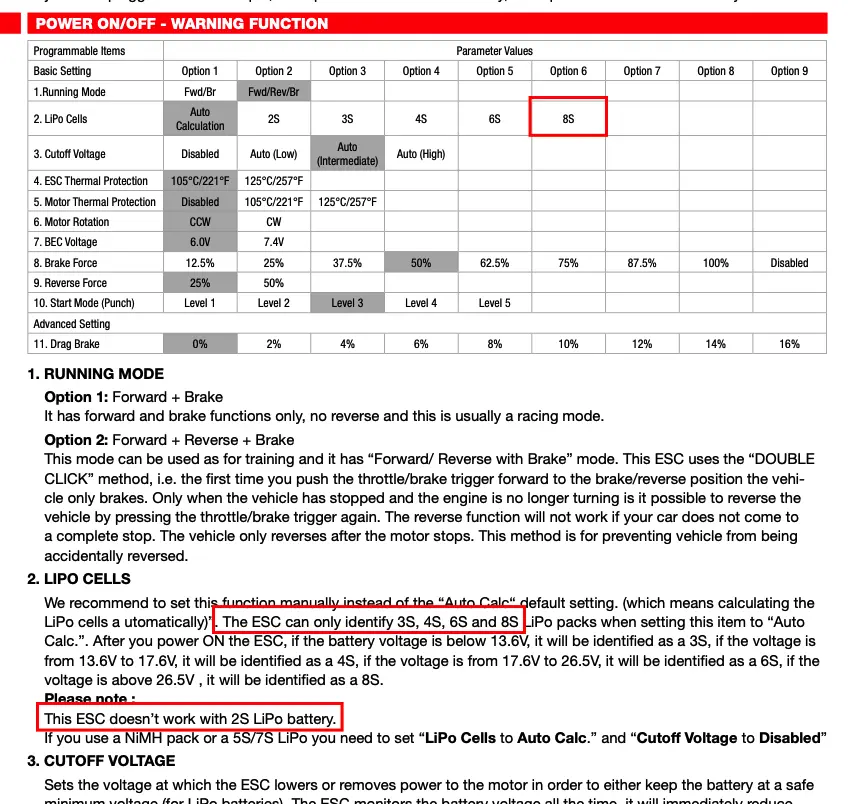

So I was just browsing though the Torox 185 manual and noticed it pretty clearly states it supports 3-8S lipos, in several places throughout the manual! I mean the front page says 2-6S, but if you look inside it says 3-8S, and it even specifically says not compatible with 2S.
So, what's all this about? 😱
The Torox 185 manual that came with my new Muraco, which is Version 2 of the Torox manual, does not say anything about 2-6s on the front cover, but both charts inside show 3-8s.

But it must be a mistake on the manual right?
Cant be right indeed but i wonder if someone tried 8s on there torox 185. I certainly won't try it. 4s max

I doubt it's a mistake. The Torox 185 is a Hobbywing Max8 upgraded from 160A to 185A, so they could have upgraded the maximum battery size when they upped the amperage.
I personally don't believe it, the max6 is only rated at 160a/1050a yet a rebranded max8 is supposedly 185a/1050a?? Anything is possible I guess but I feel it's just marketing wank, a shot at the blx185 perhaps? Bigger numbers make people feel special, the torox 185 itself only has 3-6s stamped on the side of it, at least the one in my xtr does, even if it could detect and run 8s there's no way I would trust it to handle it, just my opinion though
I think you'll find it's a mistake.

A lot of vehicles with this ESC have been sold with this mistake in the manual, so if anyone tried using 8s and fried their ESC, Corally would have to pay for new ones. Fortunately, there aren't too many folks who would try running 8s in a RTR vehicle advertised as being 6s.
I'm a bit late to the party, but it is NOT 8s capable it's a misprint confirmed by Corally some time ago 👍🏼
