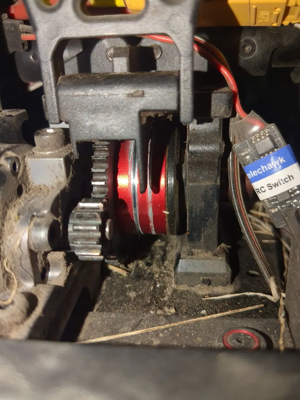

Oops, I thought my motor failed. Complete lockup of all wheels. Carried it home.
Never mind, I'm a big fat idiot. When I got home I took off the motor cover and a massive rock perfectly jammed under the center diff.

Thank Jeebus for metal diff cases. The rock did a number on it.

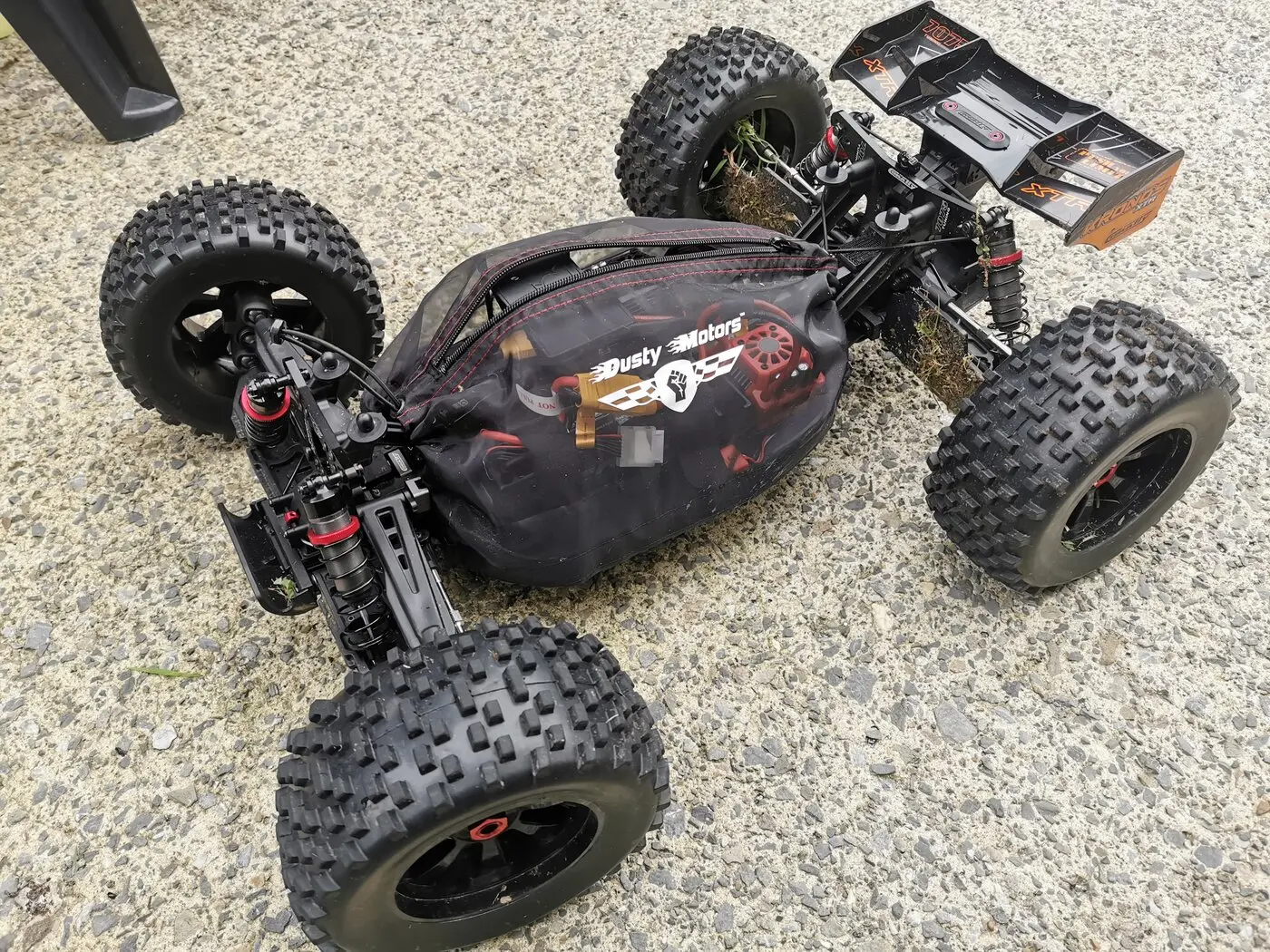

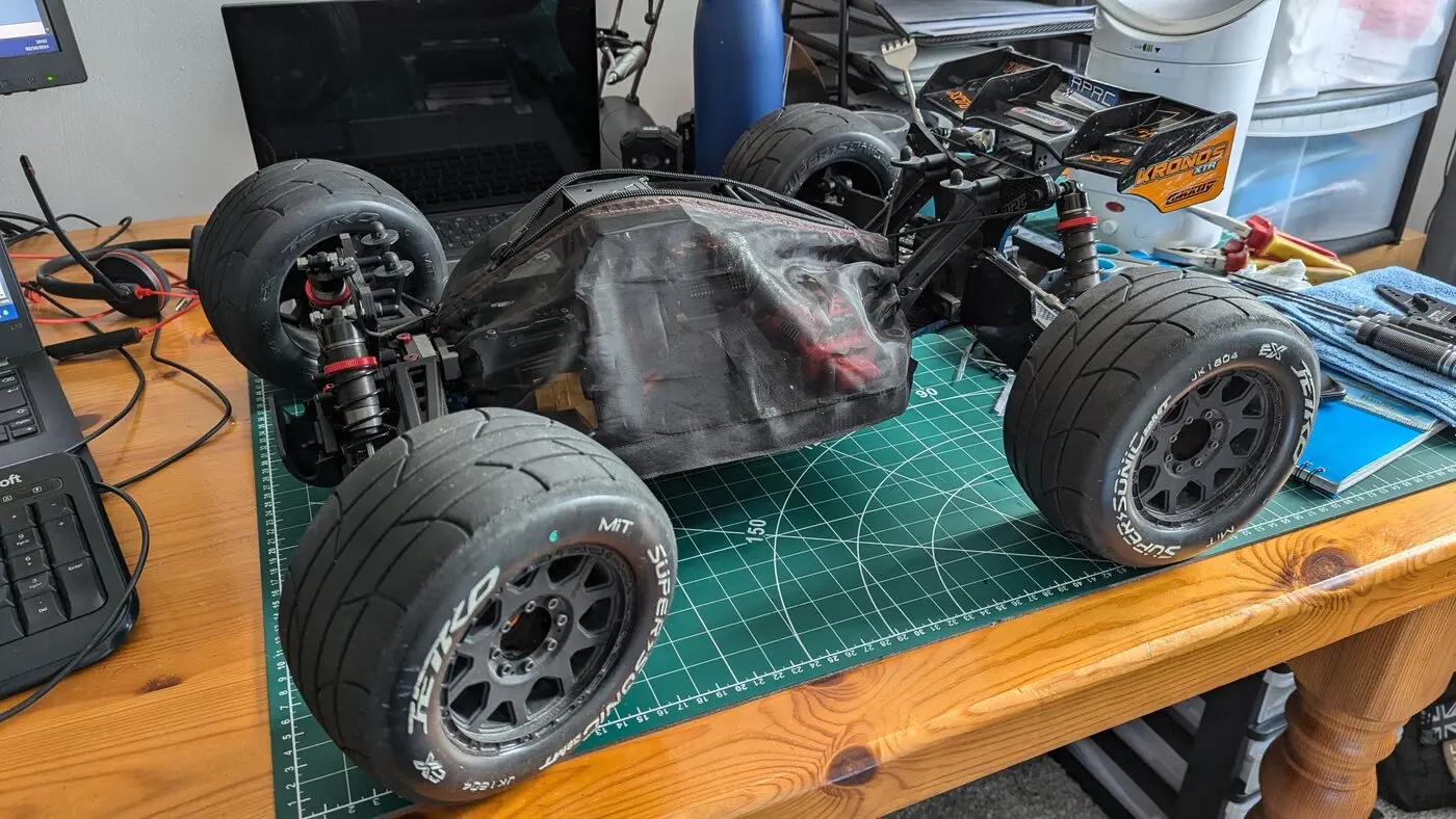

For that reason, given that such debris can jam fans resulting in rapid over heating and subsequent failure of expensive electronic stuff - principally ESC and Motor - you should run a shroud:
= Problem solved.
They make very little difference to air flow, so draw your own conclusions when you read people claiming overheating issues.
The conclusion I arrived at is that people were overheating their rigs due to usage and gearing, then attributing such failures to the shroud. I have had no such issues - but then I monitor my motors to ensure they never go over 160°F.

I will still be running mine, despite a complete re-configuration of the chassis. I don't want chippings getting in during speed runs, let alone all manner of crap when I'm running off road.
