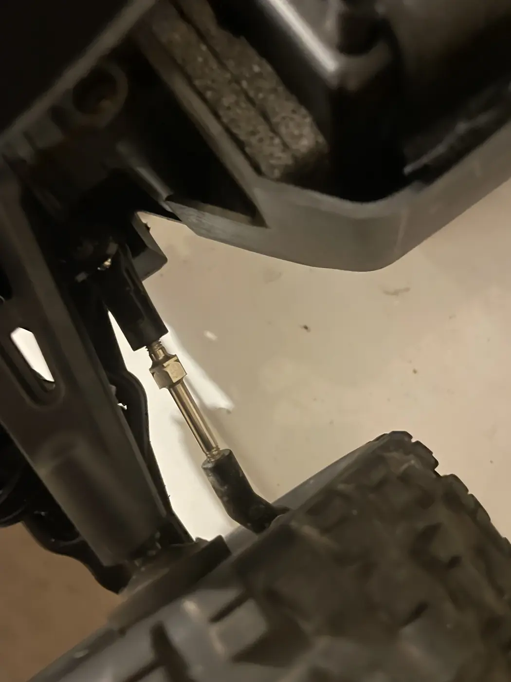

Sketer Trackrod adjustment on or off the car? 🤦

You'll note that these turn buckles have both a left and a right hand thread, meaning that you can adjust them in place.
It's worth while centering your steering and then measuring them. Ideally if everything is right, they should be the same length.
Being able to find tune the tracking, or choosing between a little toe out or toe in can really help hone the car the way you like it. 👍
