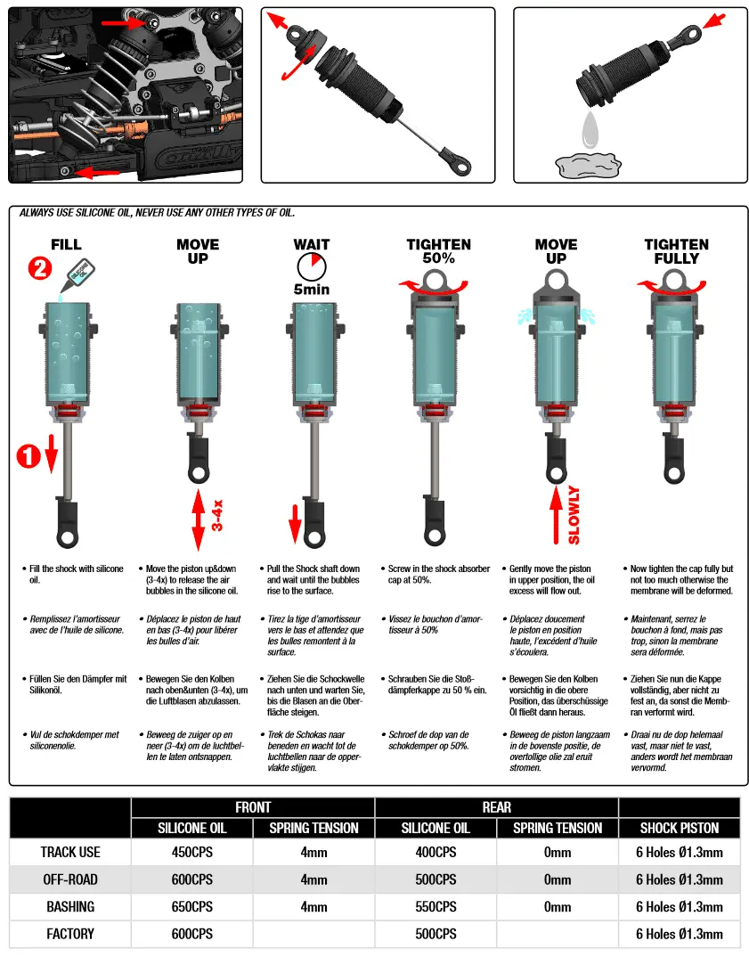

Dependent on how you drive and the type of terrain, it may be necessary to replace the differential silicone oil every 50 runs.
Similar to differentials, depending on your driving style and the type of terrain - it may be necessary to replace the shock silicone oil ever 40 runs or so.
Click here for a the complete Corally maintenance sheet!

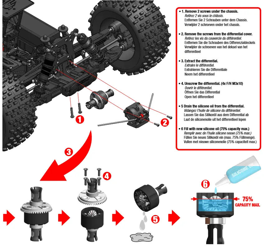

Corally Differential Maintenance
- Remove 2 screws under the chassis.
- Remove the screws from the differential cover.
- Remove the differential.
- Unscrew the differential (4x M3x10 screws).
- Drain the oil from the differential.
- Fill at 75% capacity with new silicone oil.

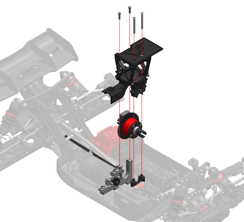

How to remove the Corally Center Differential
- Remove the four screws from the differential plate cover.
- Remove the diff plate cover.
- Now simply remove the differential. (see the section above for maintenance!)
Corally Shock Maintenance
