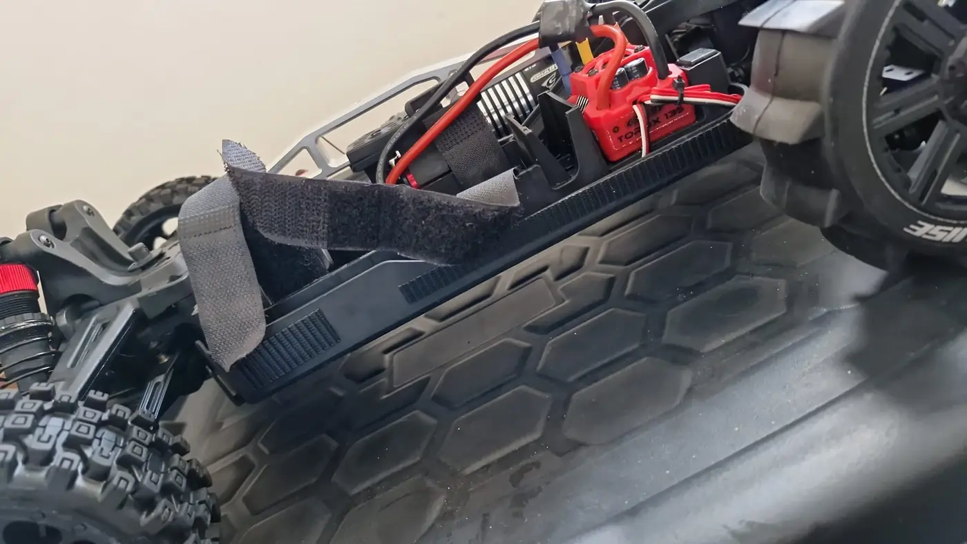

Shell sticks out with battery in place. Ive been using duck tape to keep the shell down when i go bashing. Any ideas how i could get it to fit. Or if theres a new shell i could use. Ive been tempted to make some holes and use a cable tie.

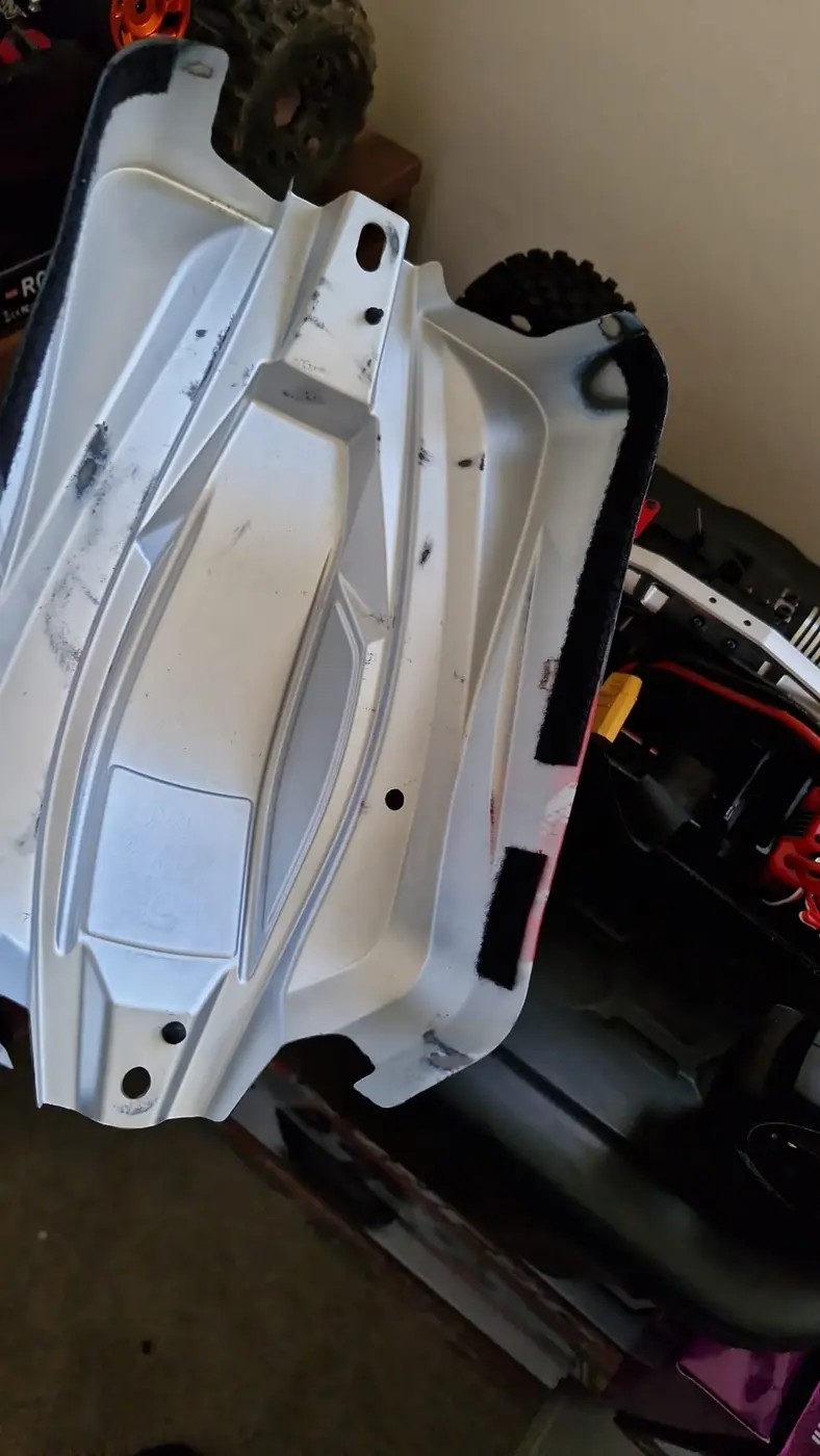

Velcro along the sides. Solves the flappy body issue. I use DXF golds which are quite a sizeable 4s battery. Been using the Velcro solution, since I got my Syncro 4.
Hard case 4S packs don’t fit well in the Syncro.
I use 5000mah soft case packs which fit perfectly. They are nice and light too so keeping the overall weight down, better for durability and handling.
There is a guy in the UK who makes 3D printed body post extensions which raise the shell up, that could be an easy solution?
Having tried some of the above I can confirm that velcro works great. Costs about a tenner on amazon to get a roll.
