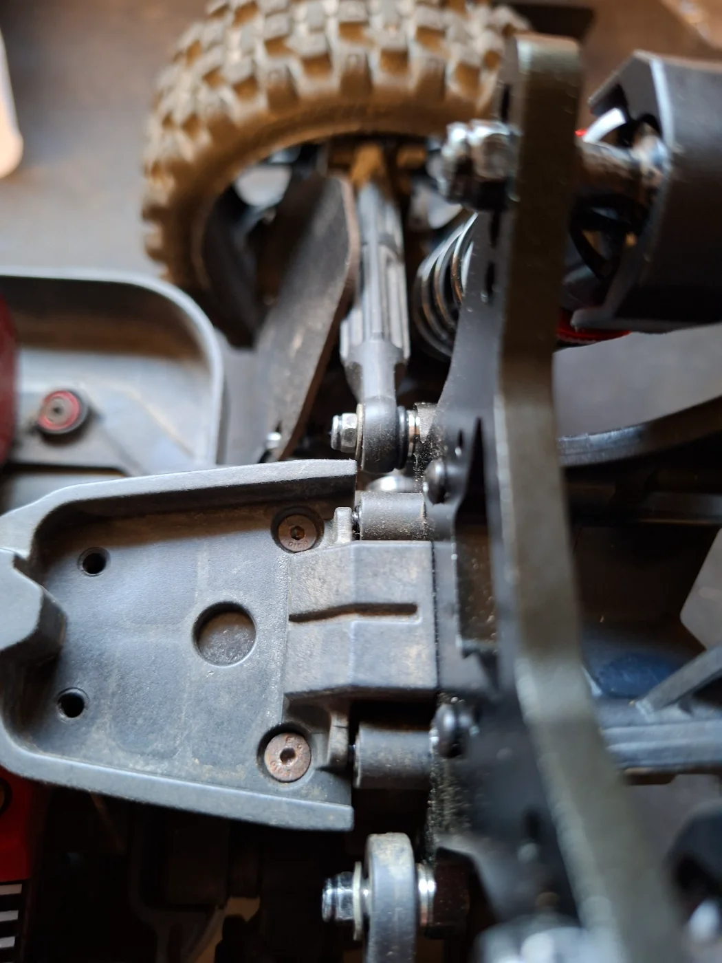

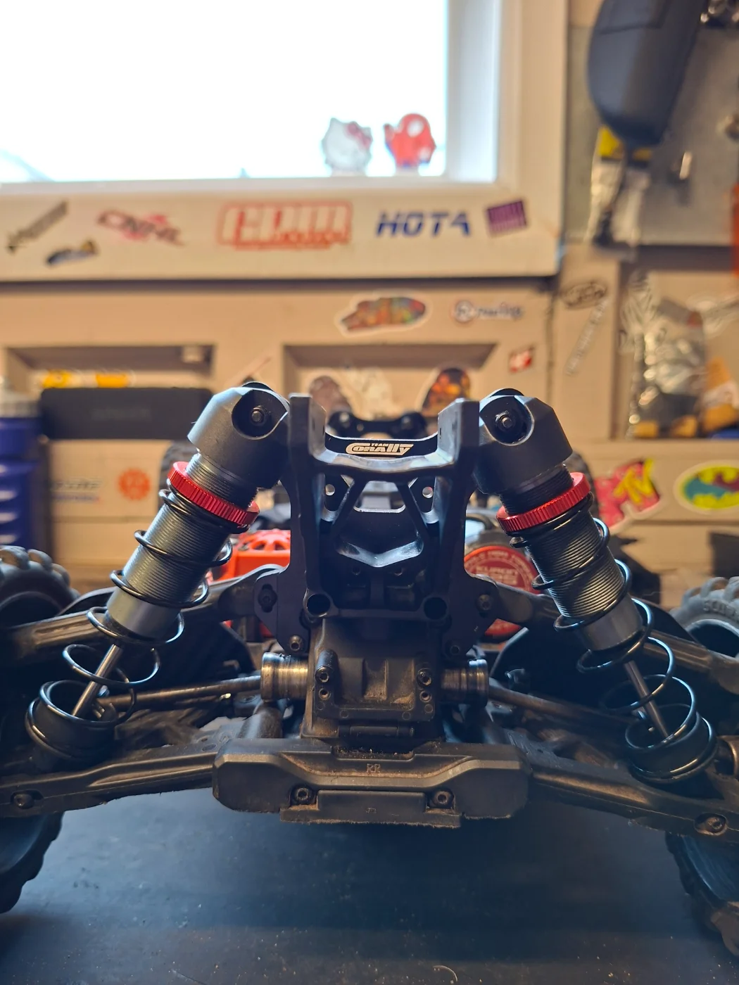

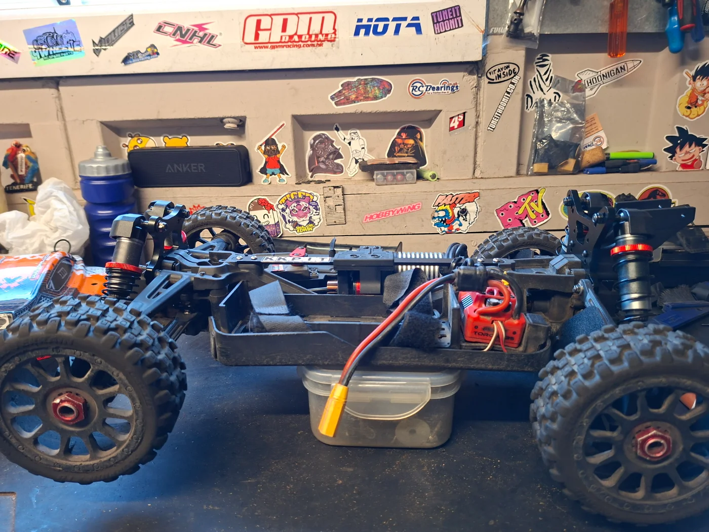

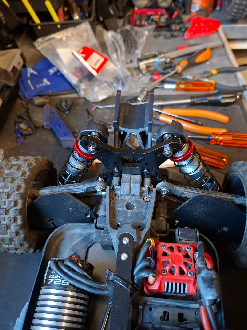

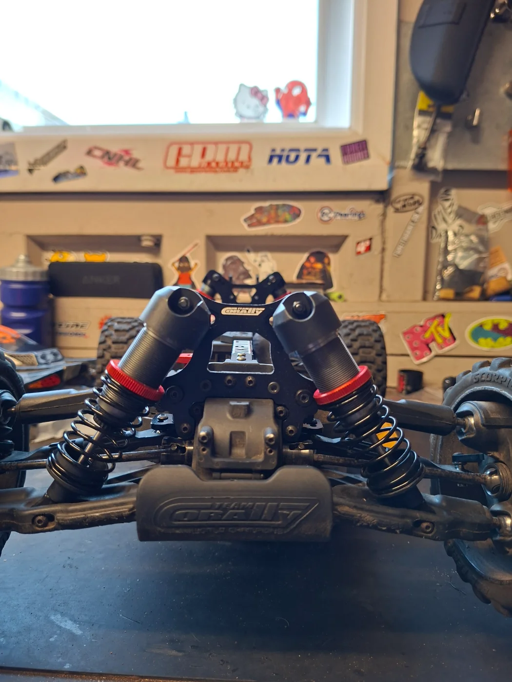

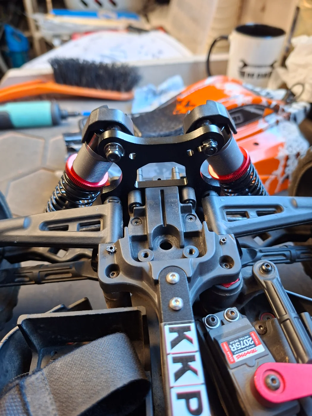

If anyone is wondering yes they fit but you will need a few longer screws to get a good grip on the captured nuts. Its a parts bin special so what ever fitted went in. Most the screws from the Syncro 4 fit :)
On both ends you will see these top spots with captured nuts :
Rear :- m3 x20mm
Front :- m3x15mm
You'll need a Spark wing mount and probably new wing because I think the holes don't line up, dunno yet have to wait till the new wing mount turns up but will update. Also 6s shock tower posts and shock cap protectors and associated nuts.
Still got to figure out body posts but reckon the Syncro 4 ones will fit with a bit of drilling etc.
Bend easy on crashing ? Dunno just wanted see if they would fit 😃, the stock set up is bullet proof not had a plastic tower snap.

I added the shock towers but my rear chassis brace and diff case broke pretty quickly in a crash - doesn't have as much material to support the aluminum towers. Ordered aluminum diff case and new chassis brace covers to hopefully give it more support.
Dunno yet not taken the thing out yet waiting for a few more bits n bobs, but I see what you mean about the back not holding the shock towers well bit of flex on it when I push back on the tower 😅
