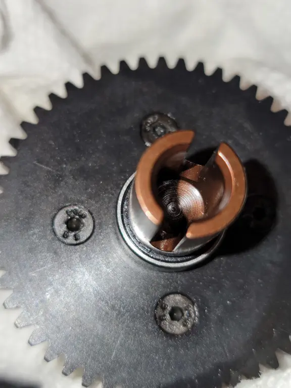

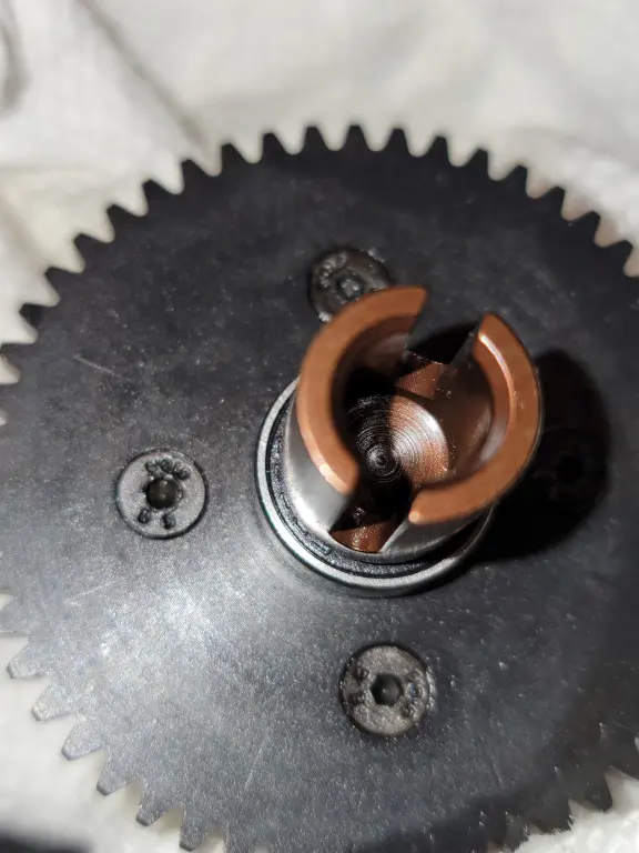

They are just rounded off 2.0mm screw on the center diff. I fiddlesticked up and didn’t heat them up and I was also using a dynamite hex kit which in my opinion sucks. Too late but I ordered some new drivers MIP. I will try again later today.

I've had success drilling the head off..I think they are 3mm screws holding the spur onto the diff cup? That should be about 1/8" drill bit. Only drill deep enough to get the head(tapered portion) of the screw off. Then after removing the remaining screws and spur,you should be able to remove the remaining part of the stripped screw with pliers.

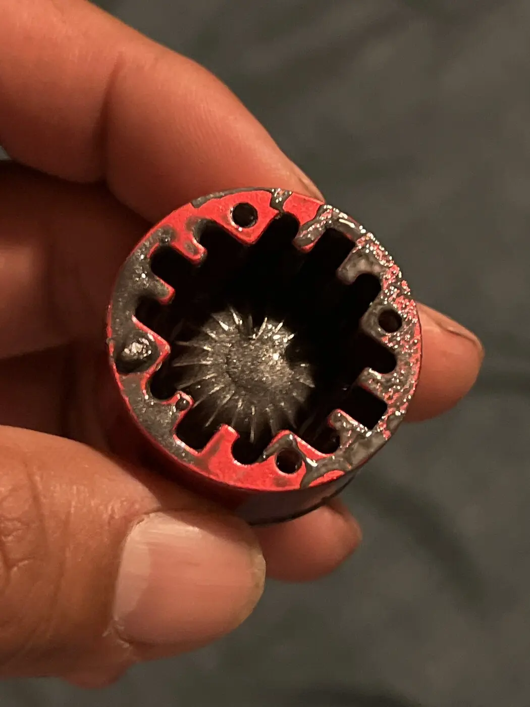

I tried that and couldn’t get it out. I drilled out the screw and was able to get the top off but the screw is still imbedded in the cup. What else can I do?? I could easily order a new one but I want to exhaust all methods before ordering a new one. Any advise on what to do from this point??
Clean off the grease, get out the dremmel and make a slit wide enough for a flat head screw driver, it looks like enough left to do it, or just buy a new diff
Trying that at the moment.

Ohh! I thought they were cheaper last I looked a few months ago. I was able to get the other 3 screws loose, but i still think it was stripped from the factory...or their screws are made from butter. This was mine....the left screw.
What I did learn was that I should apply heat before trying to back them off. And my current driver set Isn’t the best quality. So I wil be upgrading that set shortly.
