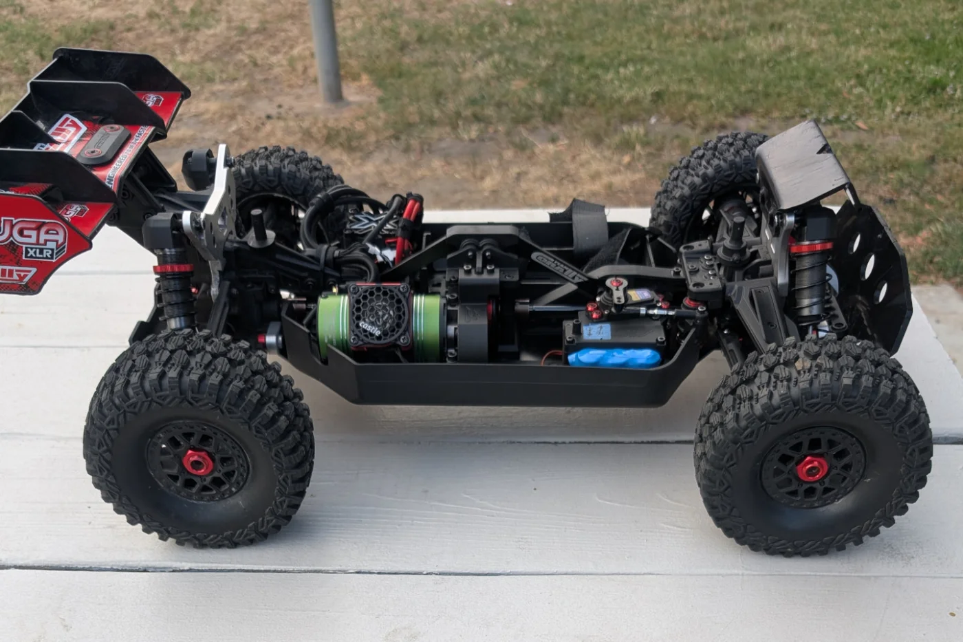

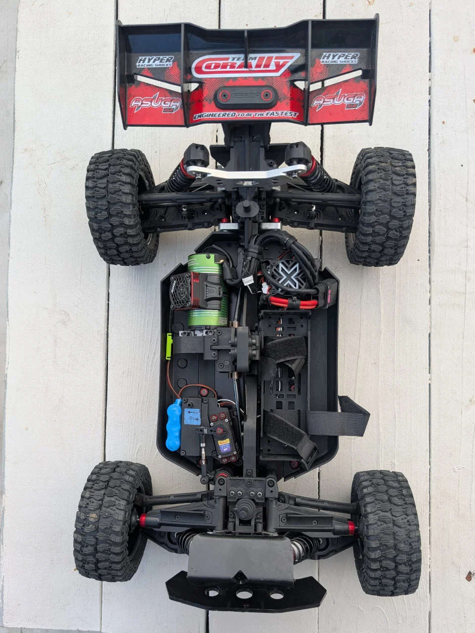

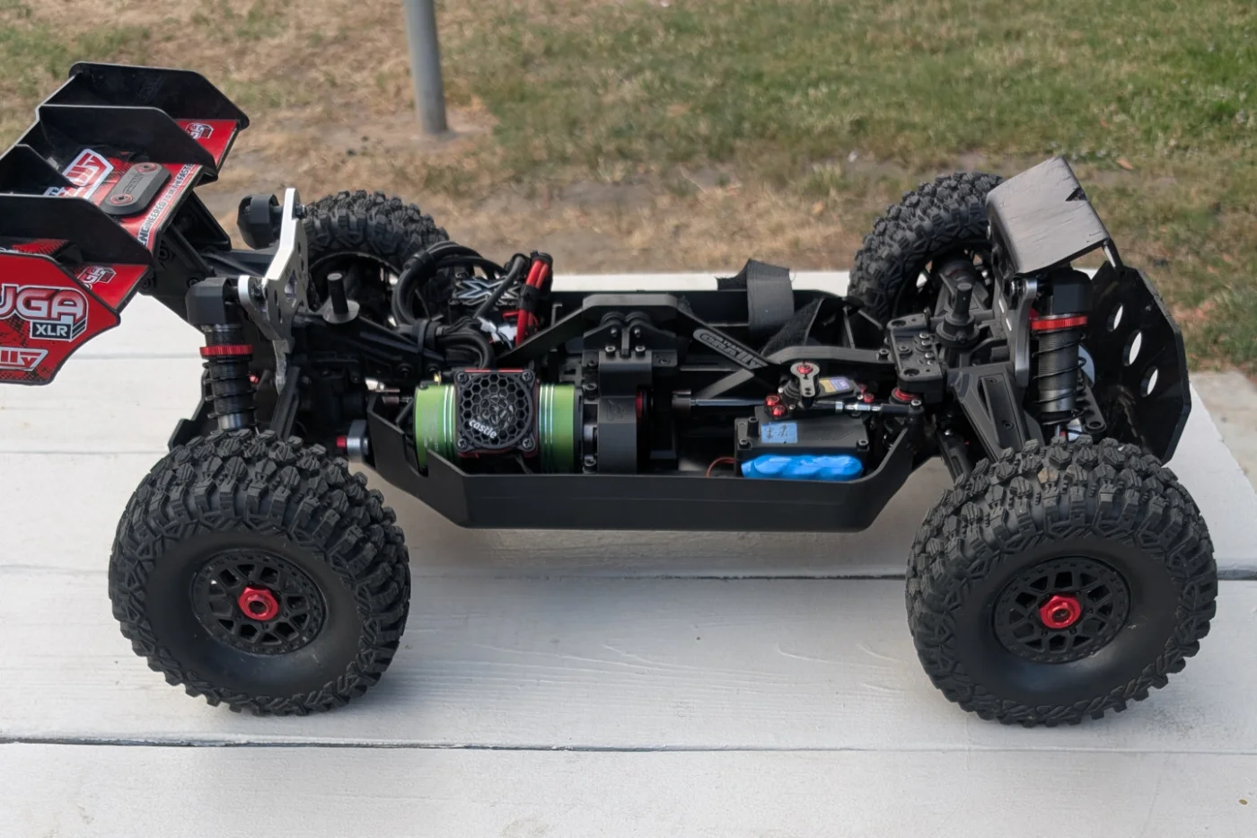

The tomahawk SGT's are great on grass especially in turns. I'd reccomend the 1/2 offset for these not the 0 offset because the suspension can touch the inside of the wheel at full steering and full droop with 0 offset. Also both front tires came unglued first pack, idk what I'm doing wrong but this keeps happening with preglued tires even "good" brands.
Tomahawk SGTs with 1/2" offset. These tires are great for grass it's actually kinda hard to traction roll with them. The offset seemed to improve steering as well maybe because the tires now turn from the center instead of the outer edge. I ended up having to completely re-glue the outside bead on all of them, oddly the inside bead held fine. Fortunately the wide bead makes it easy to get the glue in there. Maybe they don't use enough because I didn't spare the glue and they seem to hold fine now.

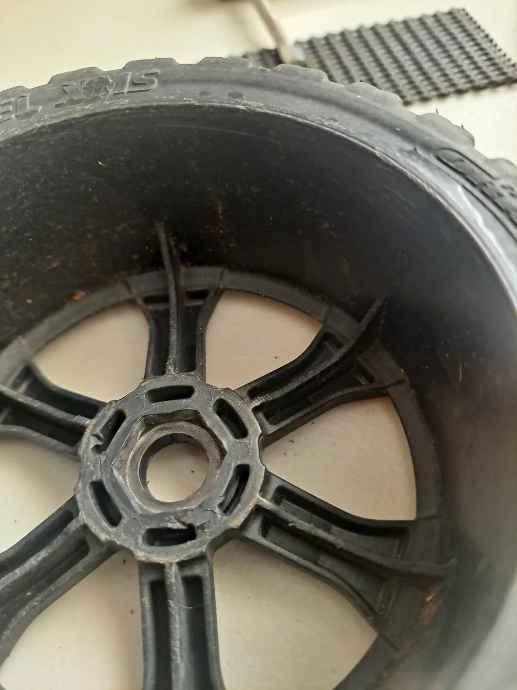

I had this problem a lot with the stock wheels on the Asuga, the plastic that the wheels are made out of is kind of poor, the hexes stripped out a lot, despite using serrated hex nuts.
