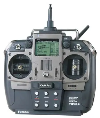

I'm sorry - but I don't understand this conversation! 😝
I'm still using the Futaba 3VCS that I'm familiar with. 🤣
