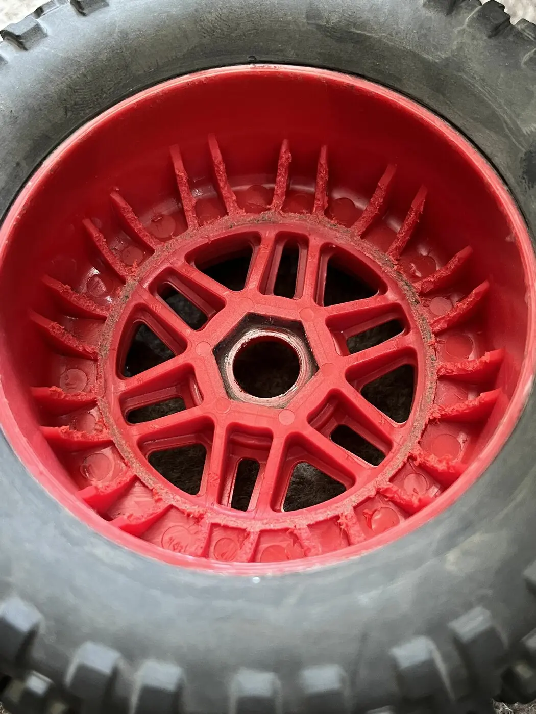

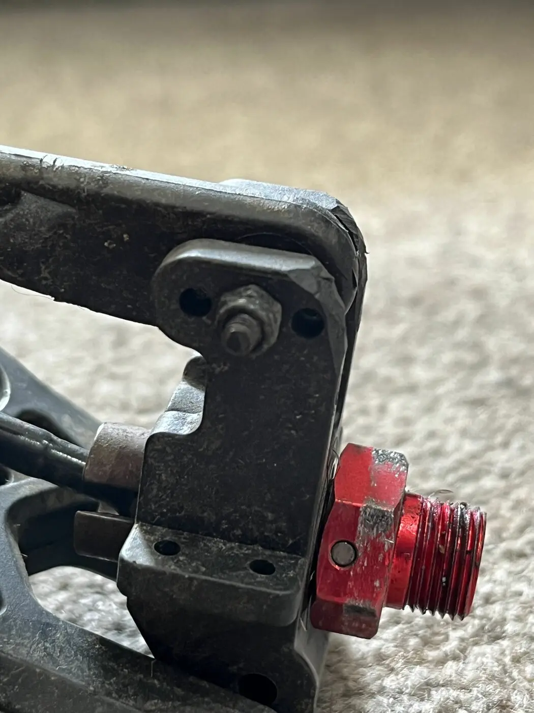

I have decided to go with the Mojave wheels for these reasons, however the issue is that the rear wheels catch on the top of the hubs and on the lower hub suspension hingepin. My options here are to fit wider hexes such as the M2C 3160 kit or to sand down the ribs inside the wheels.

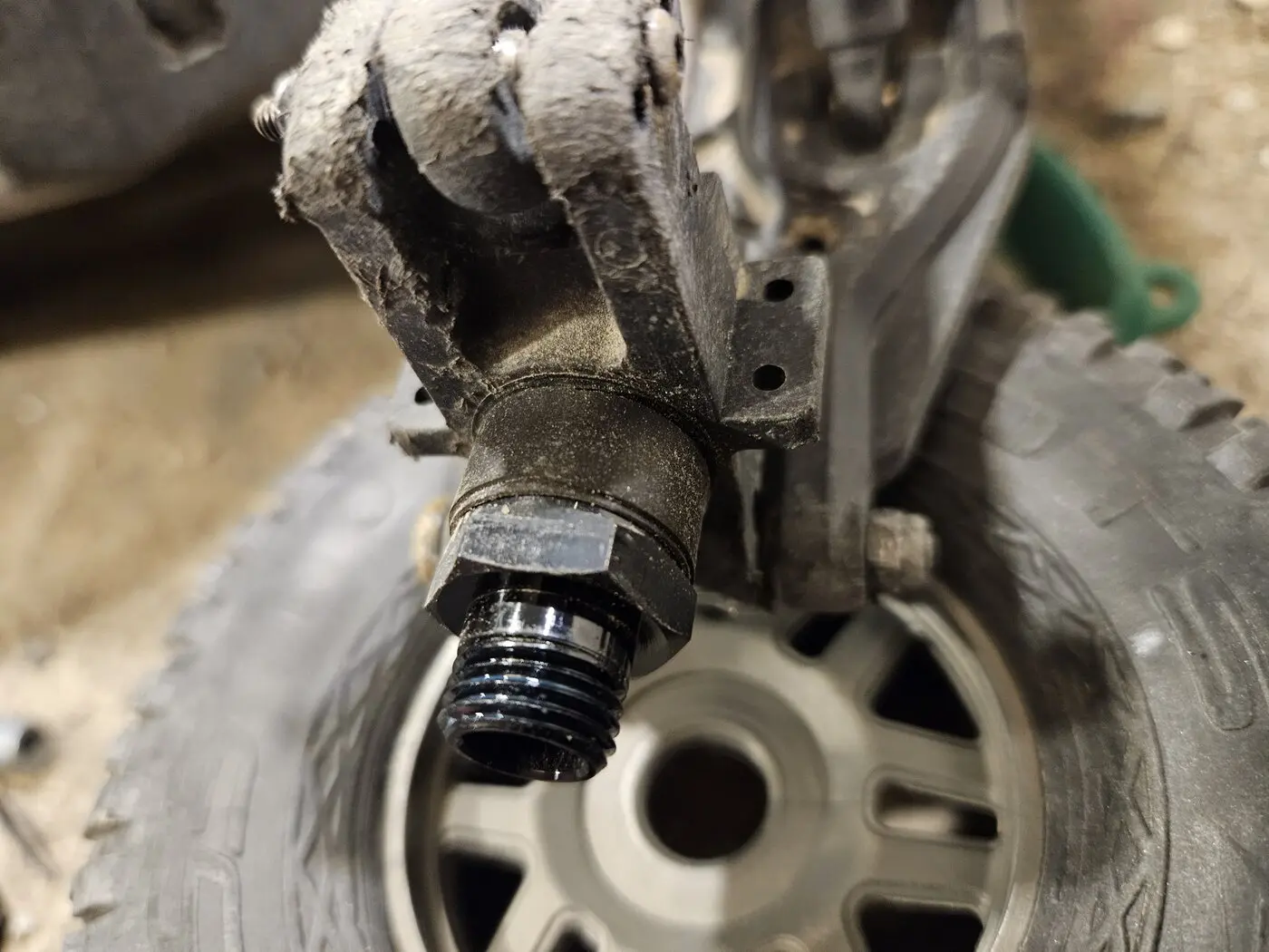

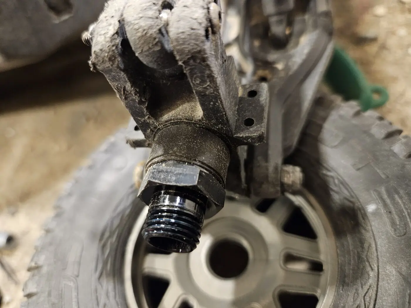

I fitted the Mojave wheels/tyres and have run the car for several hours, it drives great, steering and handling is very similar to the originals but there is noticeably more air control which allows ore confidence when jumping and makes backflips a possibility!
The handling is not hampered due to the wheels being the same offset as the originals as well as they tyres not being much wider and only slightly larger diameter and higher weight.
Bearing in mind though that it is necessary to modify the inside of the wheels and the rear hub carriers, see photos. The front doesn't need any modifications.
