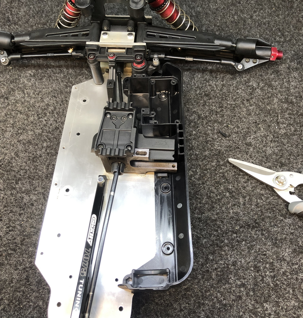

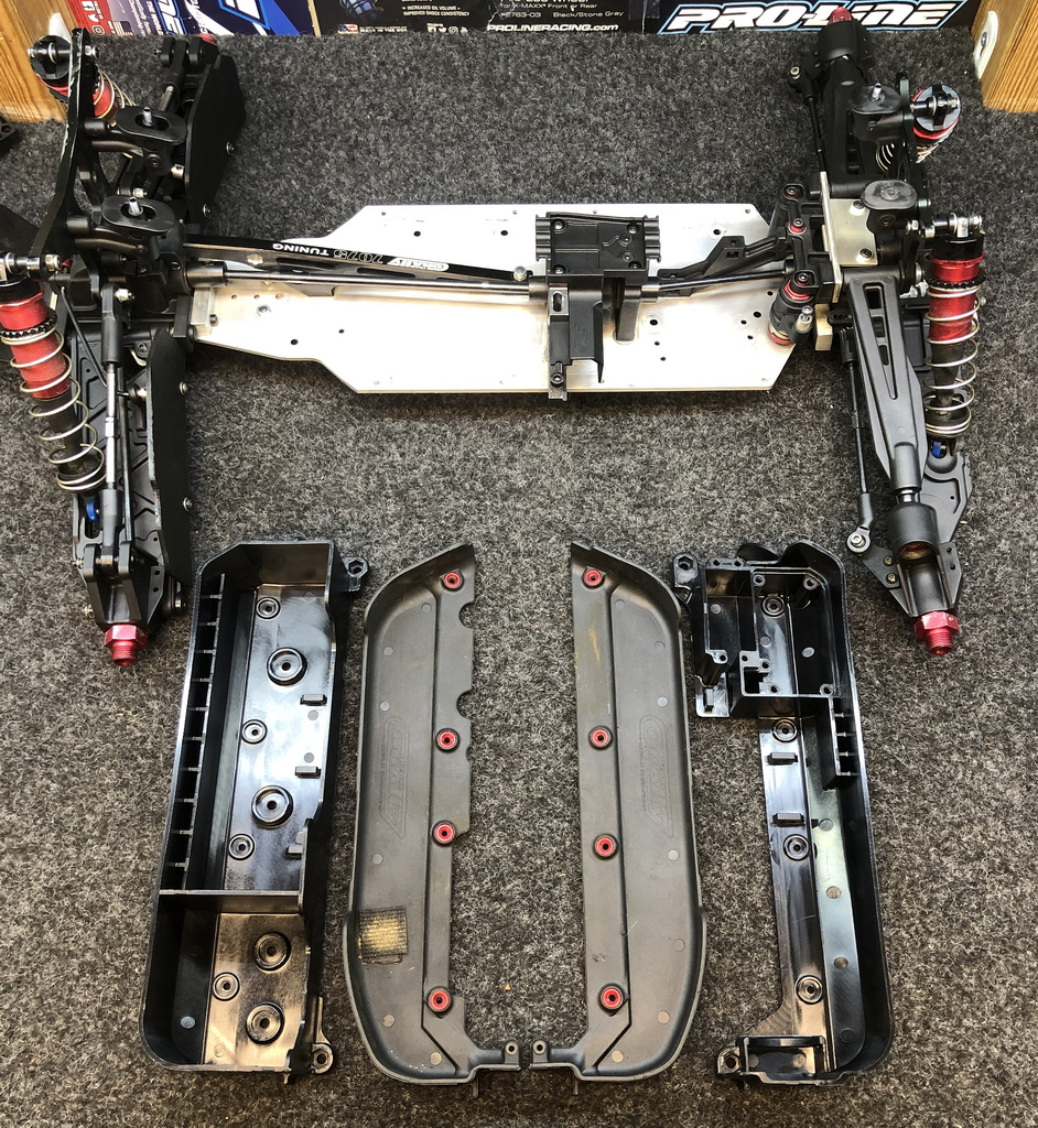

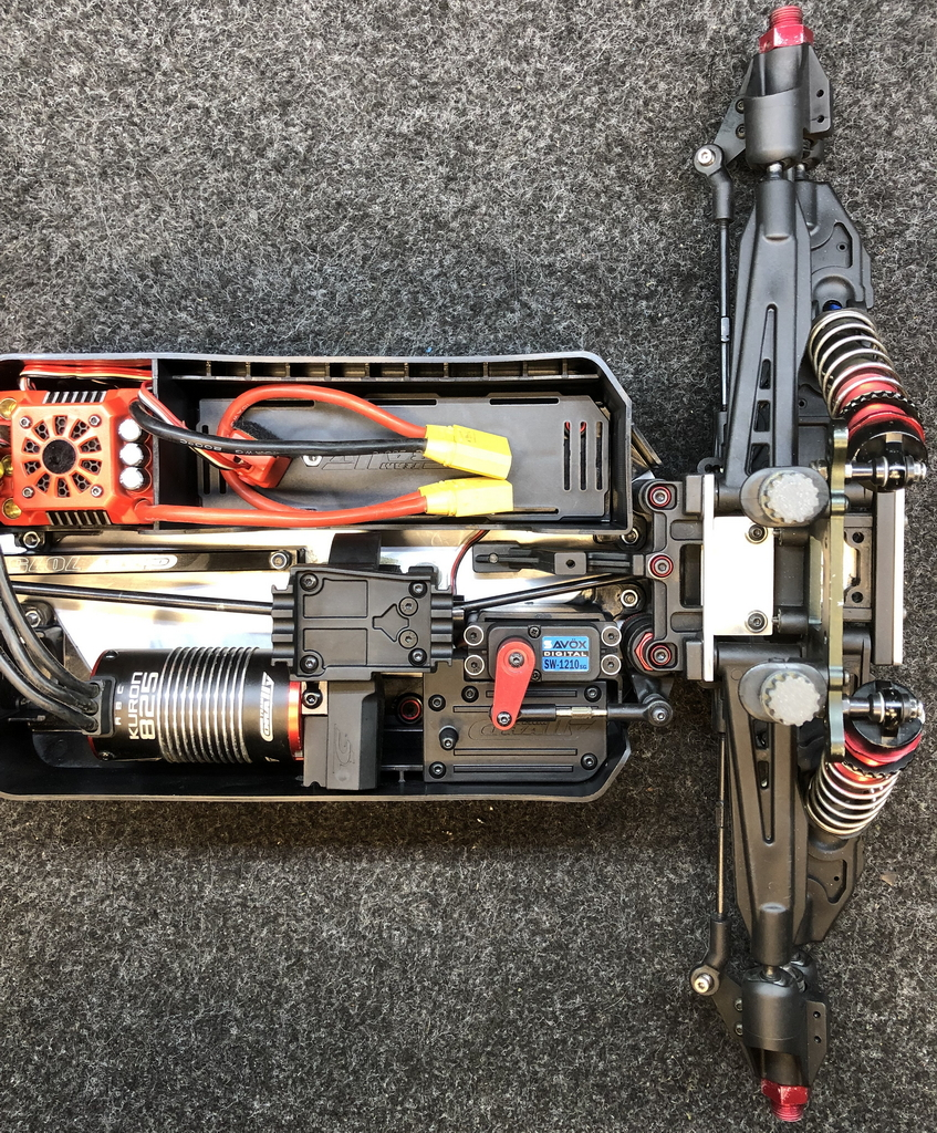

Kronos Sketer side guards on Kronos, not really a direct fit but done, love it 😎
JMS RC
95
167
148
Sweden
  1. Kronos

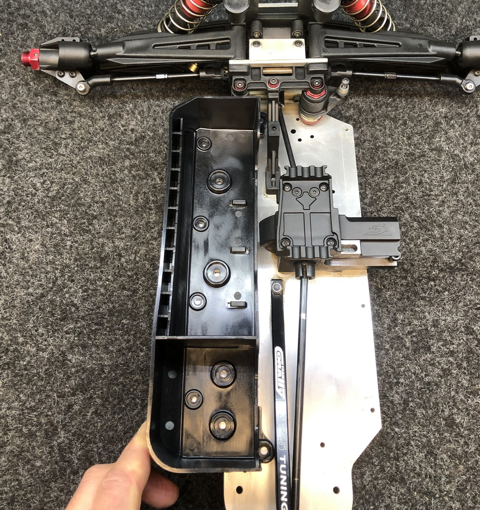

Sliding mount is in the way but i kinda figured that out before, hence the different mount on the Sketer.
Too bad the outer holes in the chassi didn't line up, lots of extra holes to drill if one wants to fit 'em.
Gonna take some modding for sure, well worth it imo.

Can see the benefit for sure!
Yea that battery ain't gonna fly out anywhere soon 😂 surely better protection for a bunch of stuff, another benefit imo is the narrow waist, more body options

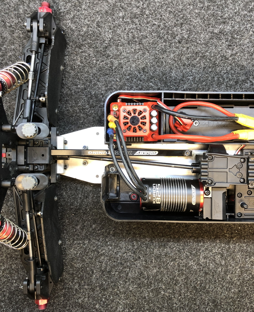

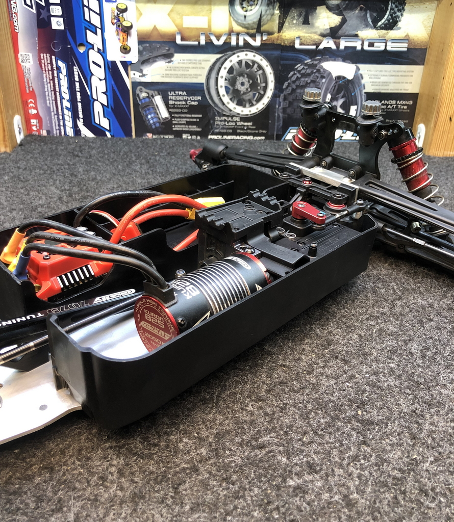

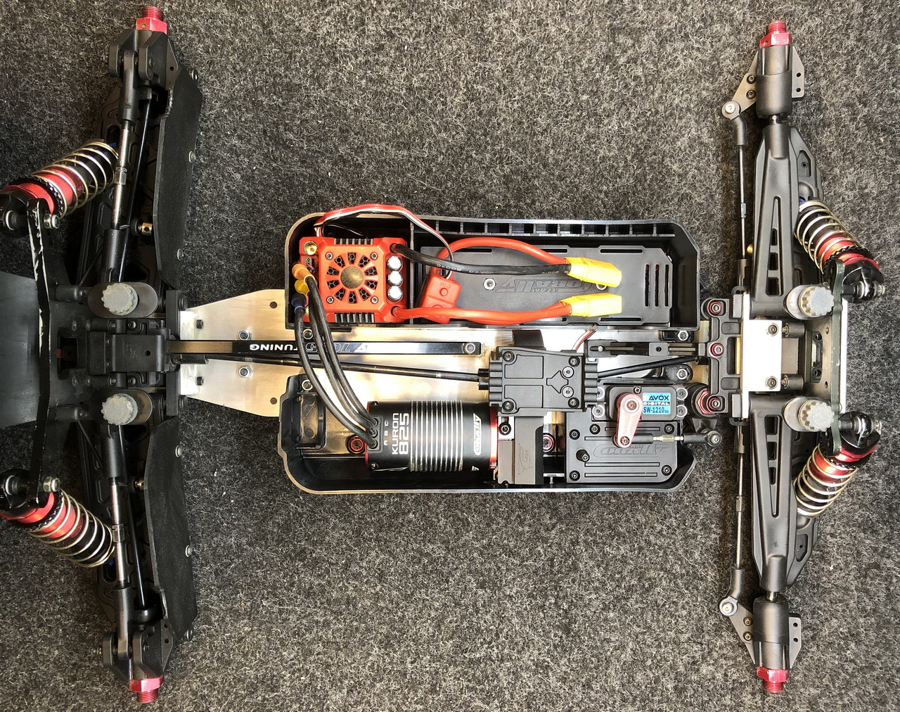

Kronos with Sketer guards done
Love It
waist went from 187 to 152 mm and the added protection is great. Just need some straps and extend the motor wires or maybe turn motor. Sketer guards does not seem to be any kind of upgrade or option for any other corally basher, just fits the Sketer chassi without modding. Kept my sliding mount so largest pinion with my mod is 14t with a 52t spur.

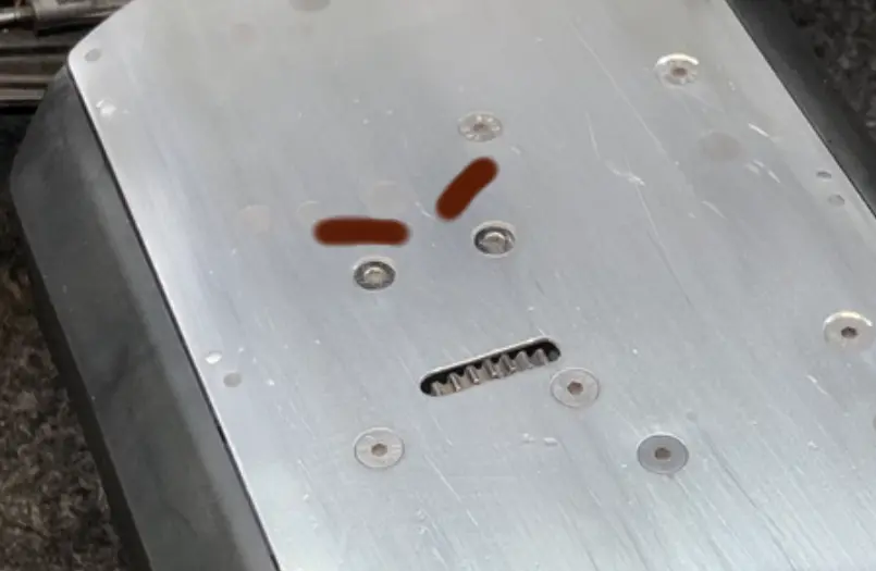

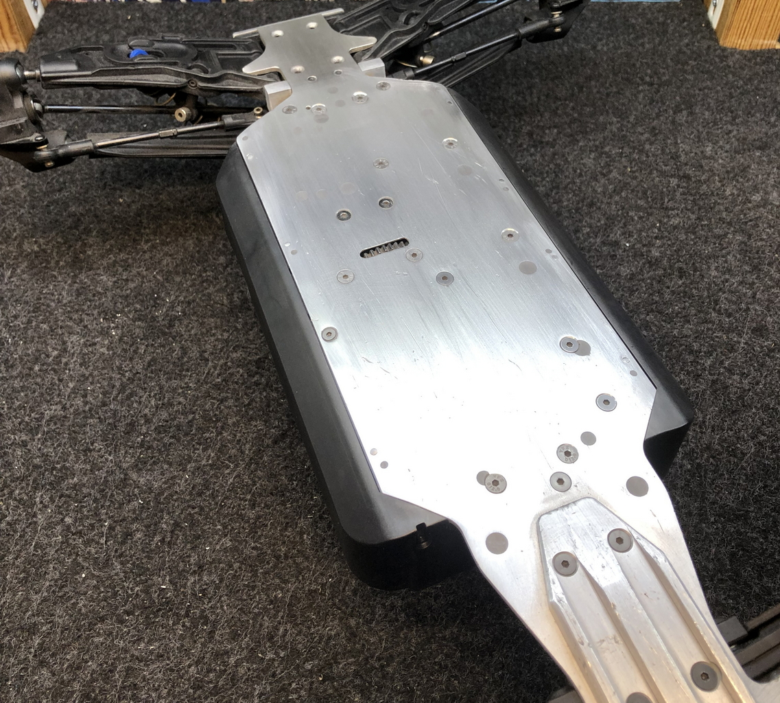

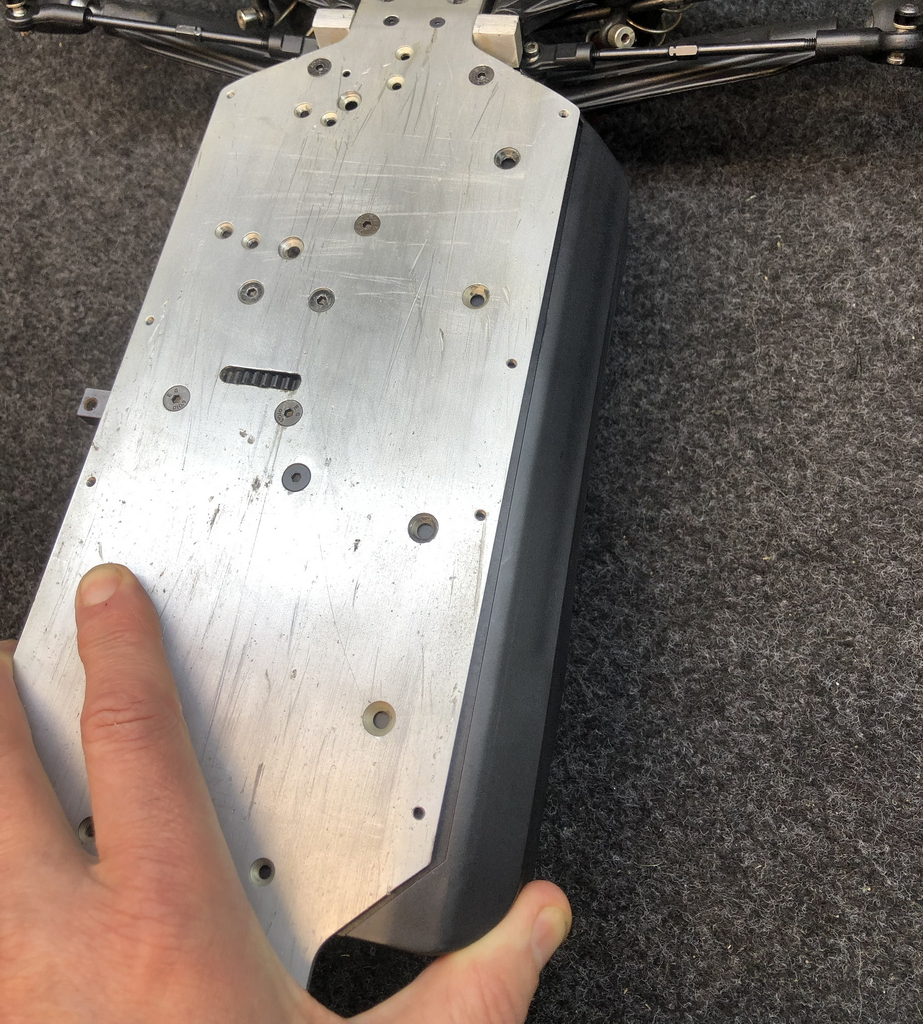

How many extra holes did you have to drill ?? You got any pictures from the bottom underneath ??
Looks good (y)
Looks good (y)
so many i nearly lost count, 15 😂 not a single hole lines up, not sure you wanna see the underside but will post a pic later
