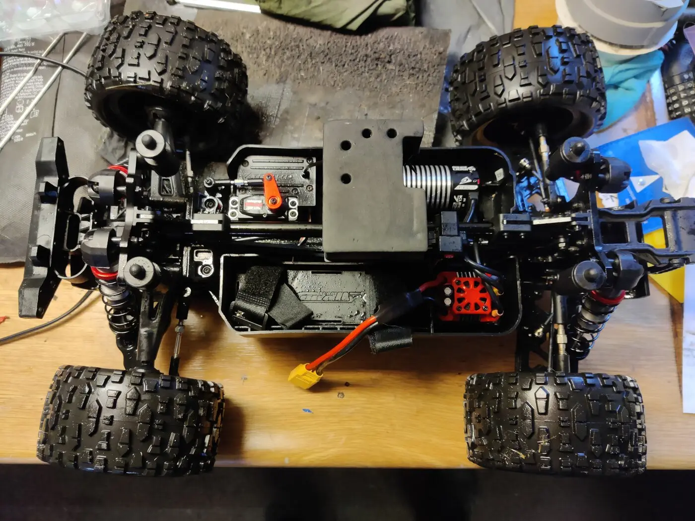

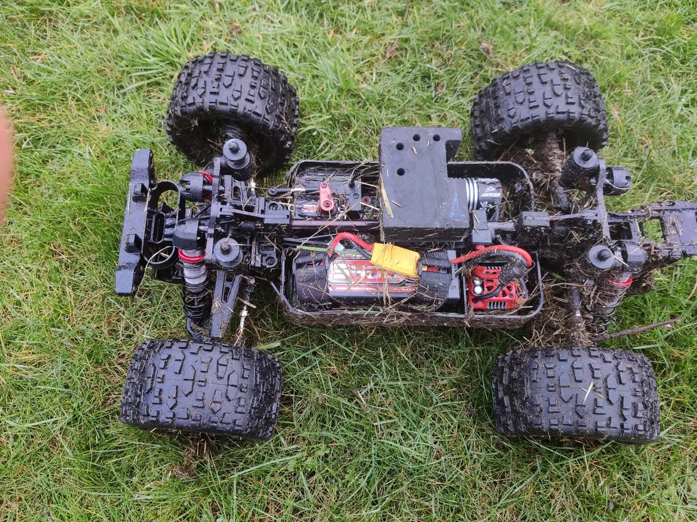

The first steps after a bashing session are probably the same for most of us: Eventually first cleaning with water, then compressed air and then … what?
I know WD40 is very popular, but there are also concerns about compatibility with plastics and about washing out lubricants.
Then there is the Silicone-spray fraction, where I’m in currently. It is known to have positive effects on the plastics and metal parts as well.
Some others use PTFE-sprays …
What are your preferences?

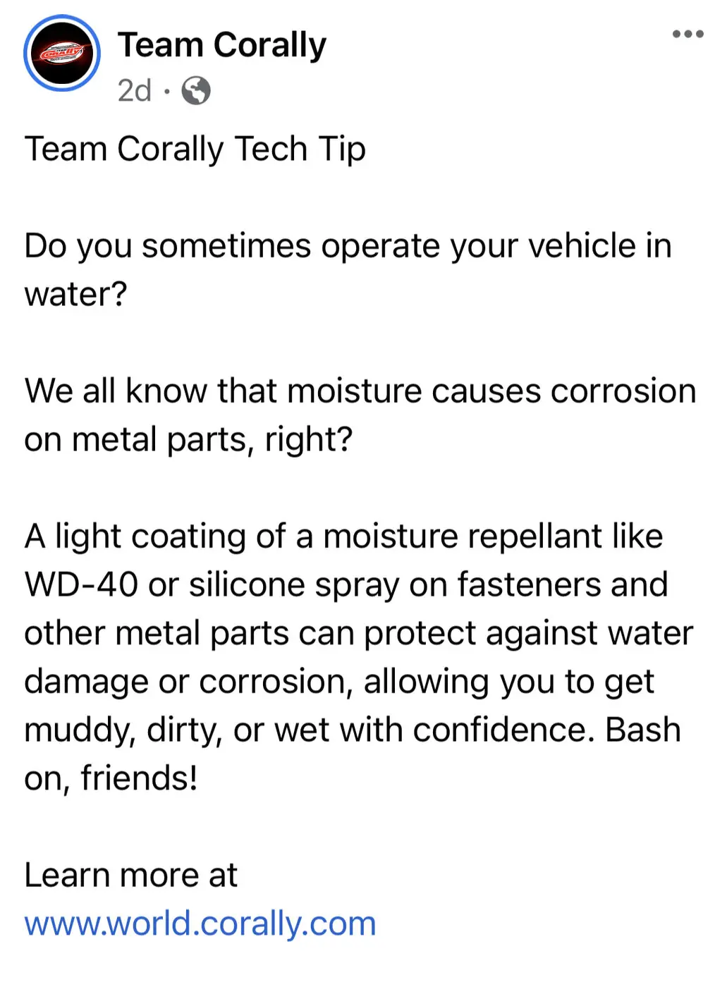

A lot of people worry about WD-40, but I’veUsed it in all my cars, never a problem. And it’s what Corally recommends.
The pink cleaning stuff from Muc-Off seems to be pretty famous in the biking-community and I just found it heavily discounted in a shop here, so I will give that a try.
For afterwards I will probably stay with the Silicone-spray … that’s what Team Corally recommends beside WD40.
