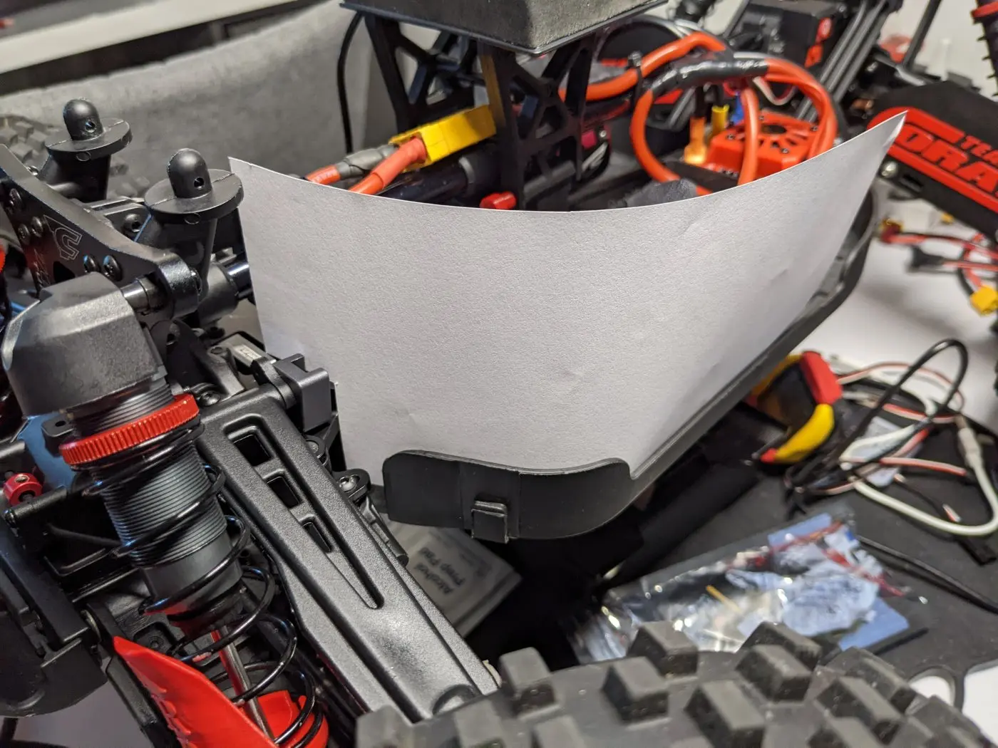

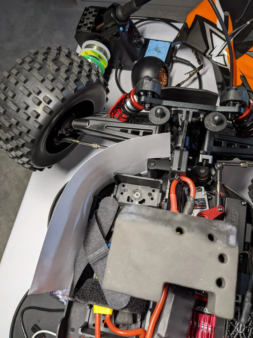

I was thinking it would be nice if the side guards where taller to avoid debris from getting in. I don't know of any aftermarket parts for this, but it should be a very simple thing to build, all you would need is a lexan sheet and then it can be cut to size and attached to the side guards with screws, nuts and some washers.
I've built a very quick mockup with a piece of paper just to show what I mean. The side guard can be cut at the top to match the body lines so it should be well covered and protected. I like that it could wrap around at the front all the way the the braces and it could even go around from side to side as a single piece.
What do you guys think? I know this would restrict some of the air flow, but maybe it won't be too bad.

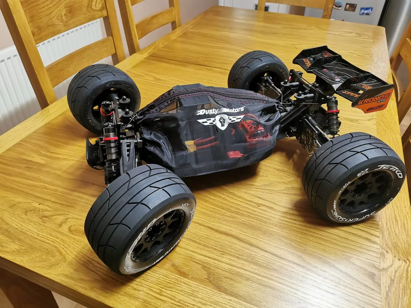

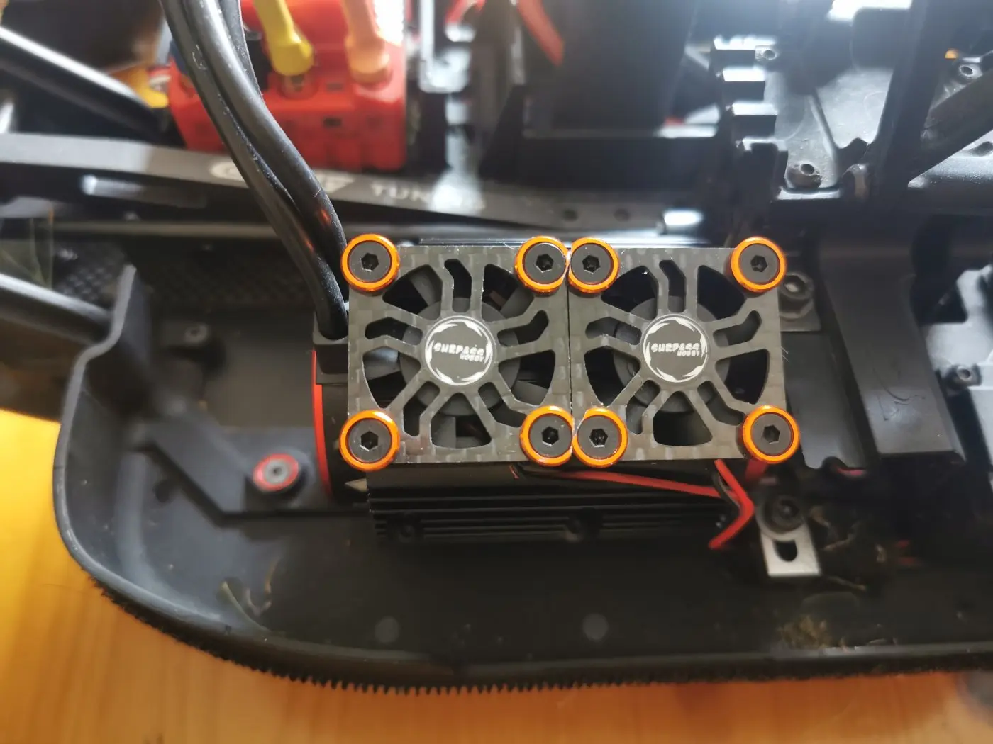

I'm perfectly happy with my dusty motors cover though. It keeps out debris, but still allows enough air to flow - it's made from mesh.
Using motor cooling fans is a must anyway on the XTR, regardless of how you go about preventing dirt getting into the works.

Motor cooling fans are essential either way...

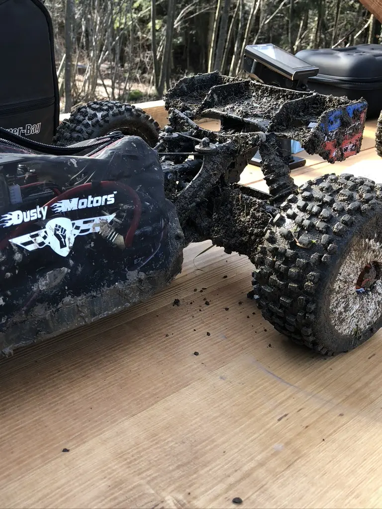

No more grass or chippings inside the chassis. Even during the 90°F heat, the Motor didn't get hotter than 160°F using the dusty motors and dual cooling fans.
And it's not like I was taking it easy.
