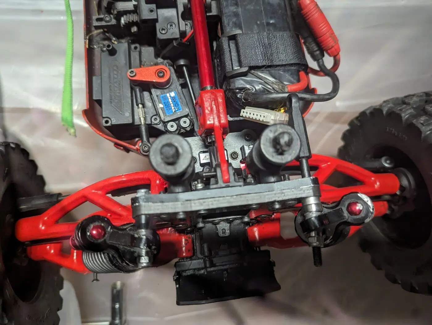

I've had not problems with the stock standoffs on my Skeeter or Kronos XTR...until this weekend when I managed to break two (on separate runs).
I have pack of replacements on the way but curious what other people are running.
Maybe I should just stay away from the skatepark...left home with 4 rigs this morning and came home with 4 casualties of concrete: 1 shock standoff & broken shock piston (Kronos XTR) 1 snapped shock shaft (Rival MT10), 1 snapped camber link (Granite) and 1 dead motor (Big Rock).

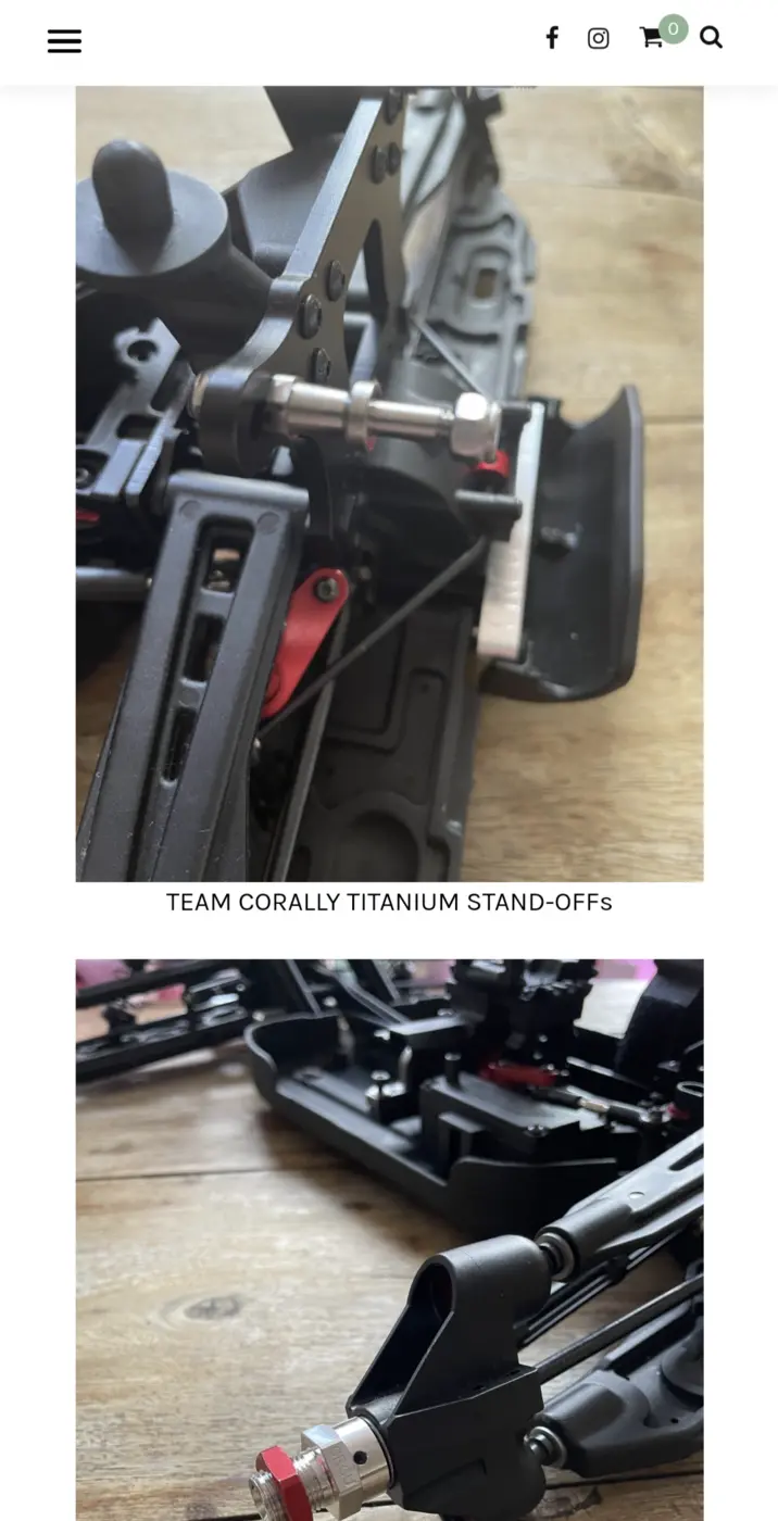

I saw some interesting shock standoffs on AliExpress - a slightly different take on them, with a machined threaded standoff, and a standard 12,9 steel hex head screw through the middle.
https://www.aliexpress.com/item/1005006172839189.html
