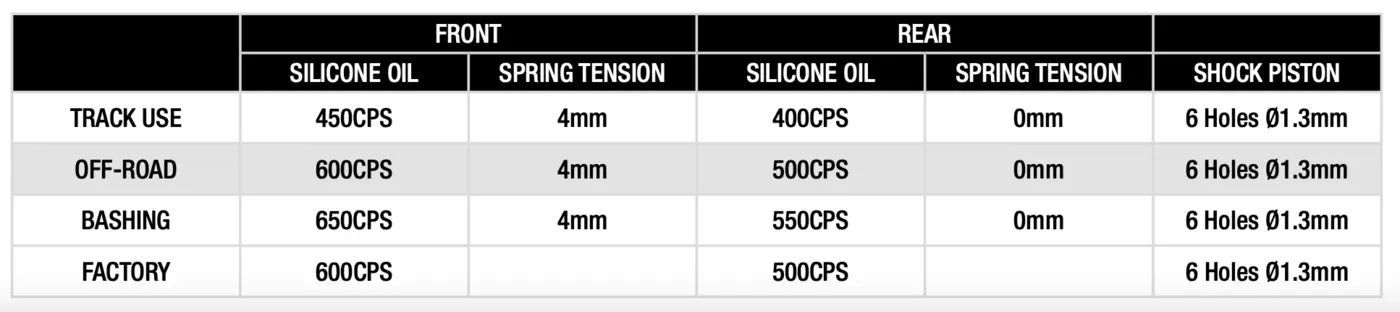

Kronos XTR shock setup
I believe these are the 2022 specs 👍🏼

I haven't changed out fluids yet, but did order up some Kraton 6s EXB springs front and rear.. I believe I went with the heaviest option Arrma offers since the xtr is actually heavier(I think). I would have bought TC springs, but needed some Traxsux parts too, so Amain was where I ordered. They don't sell TC..
changed all my silicone oils now. don't think kraton springs will fit will they :unsure:
Hope so,they're on, and I have been running it🤣
Actually, I believe I've seen @razorrc put complete rear shocks from a kraton onto a kronos xtr? Def saw someone had them installed.
The kraton shocks have thicker shafts I think..and better rod ends. At least better than v1 xtr. Not sure about v2(2022).
thats good to no then (y)
I think the front shocks are different lengths between the 2 rigs,but close enough for the springs to work. FWIW, I haven't had any issues with the v1 xtr shocks, just the factory springs are too soft for my liking.
