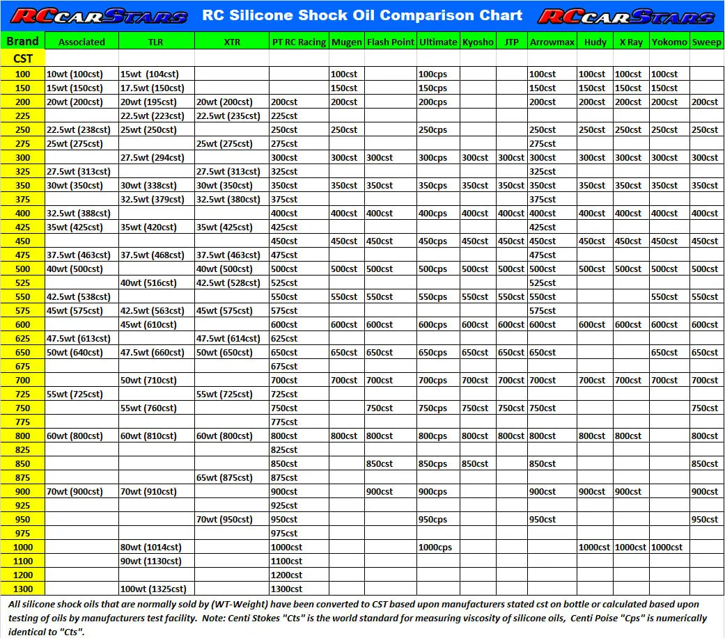

I'll start of with this:
Helps when choosing oils.
