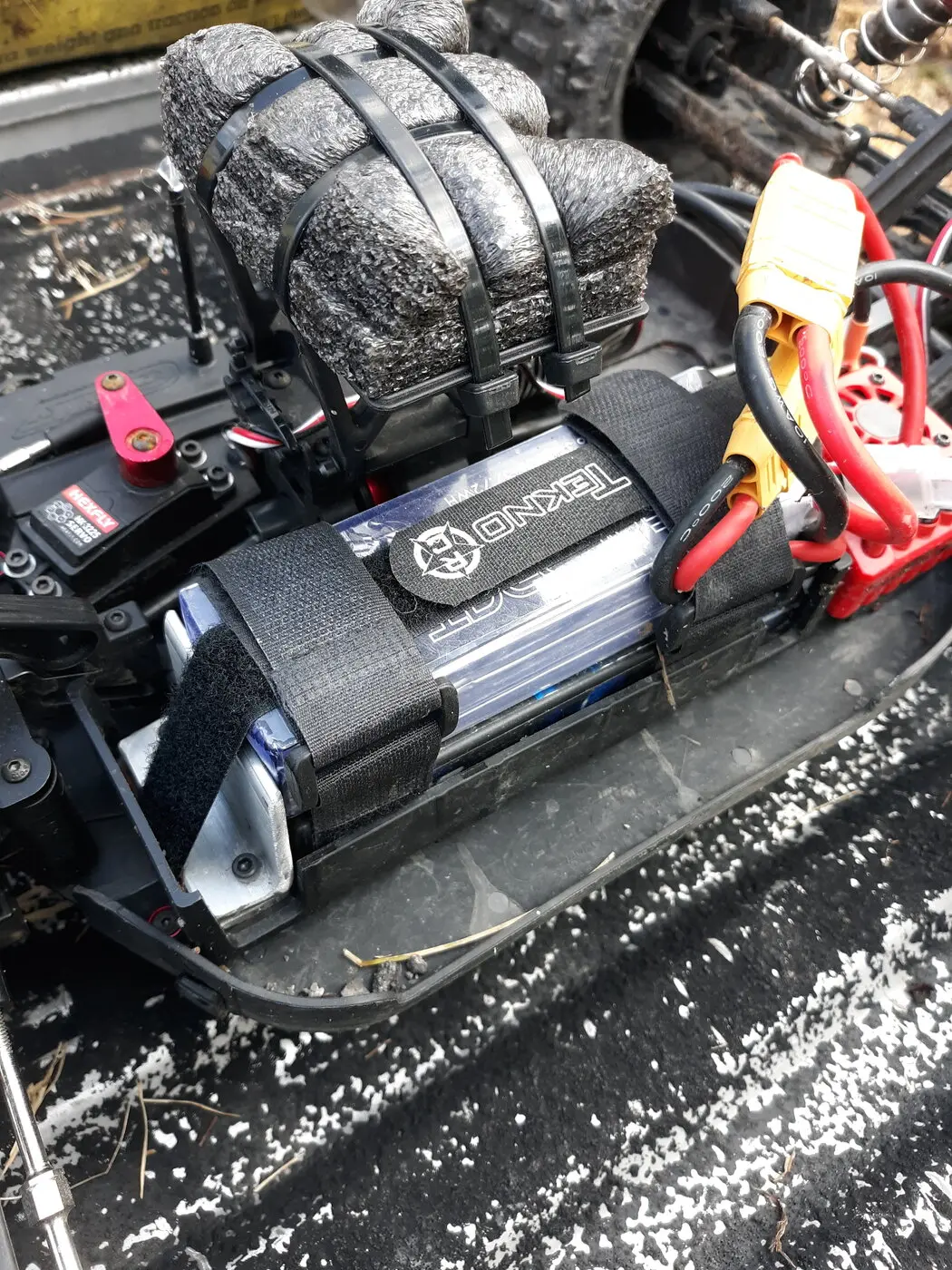

I ended up modifying the tray with a taller stop and an additional strap runnining front to back so I could stack my 3s packs. I don't do big jumps so I wasn't as concerned about the vertical force impact so much. Here's a picture of what I did, some aluminum angle stock. I think it's 6000 series. I removed the stock plastic stop and mounted the taller aluminum angle in it's place. I'm sure hard case would be a better choice(always).

Edit: the picture above is actually 5s, one hard case 2s and 1 softcase 3s..but 2x3s does fit pretty well too.

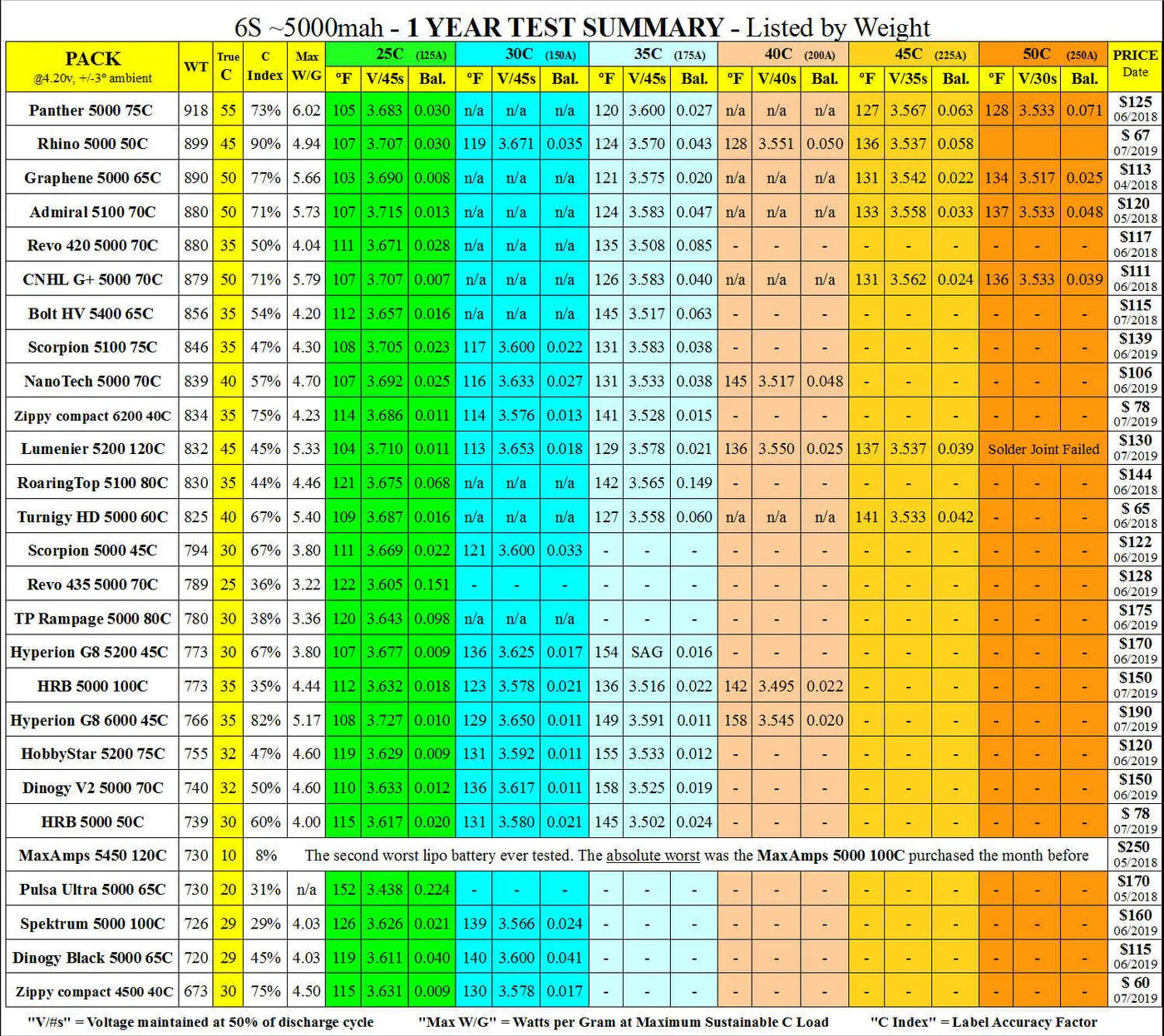

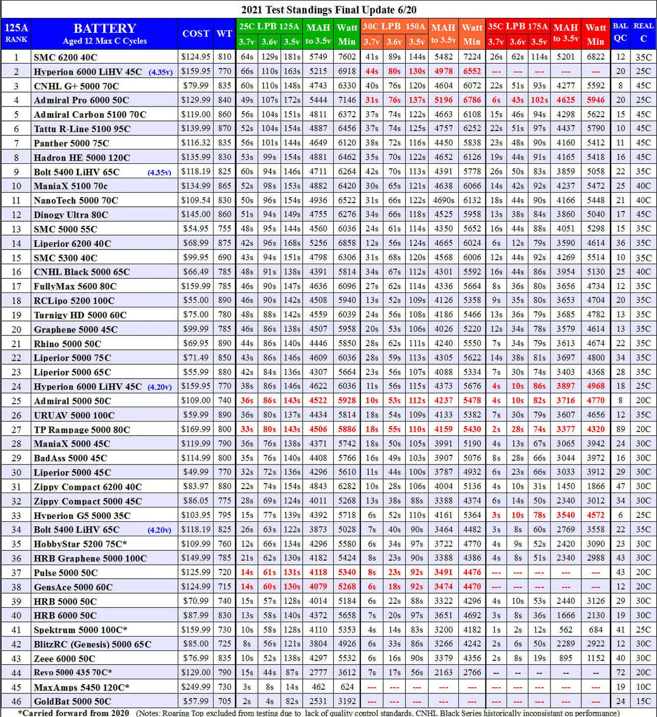

There were some that could do around 50C but they could not sustain that over multiple test so he changed his testing method to see the highest sustainable C rate and all the batteries dropped down about 5-10c.
This was his test summary from 2019

This is his most recent with the modified testing.
