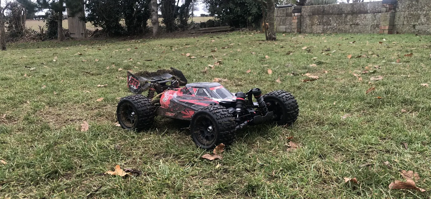

hello, I wonder if anyone can recommend a slightly wider rim / tire for an asuga xl that will fit without extending the hubs, just buy and put there
grass/dirt,,if I understand correctly, the team corally sketer rim/tyre should fit directly on?What type of terrain or what type of driving are you planning?

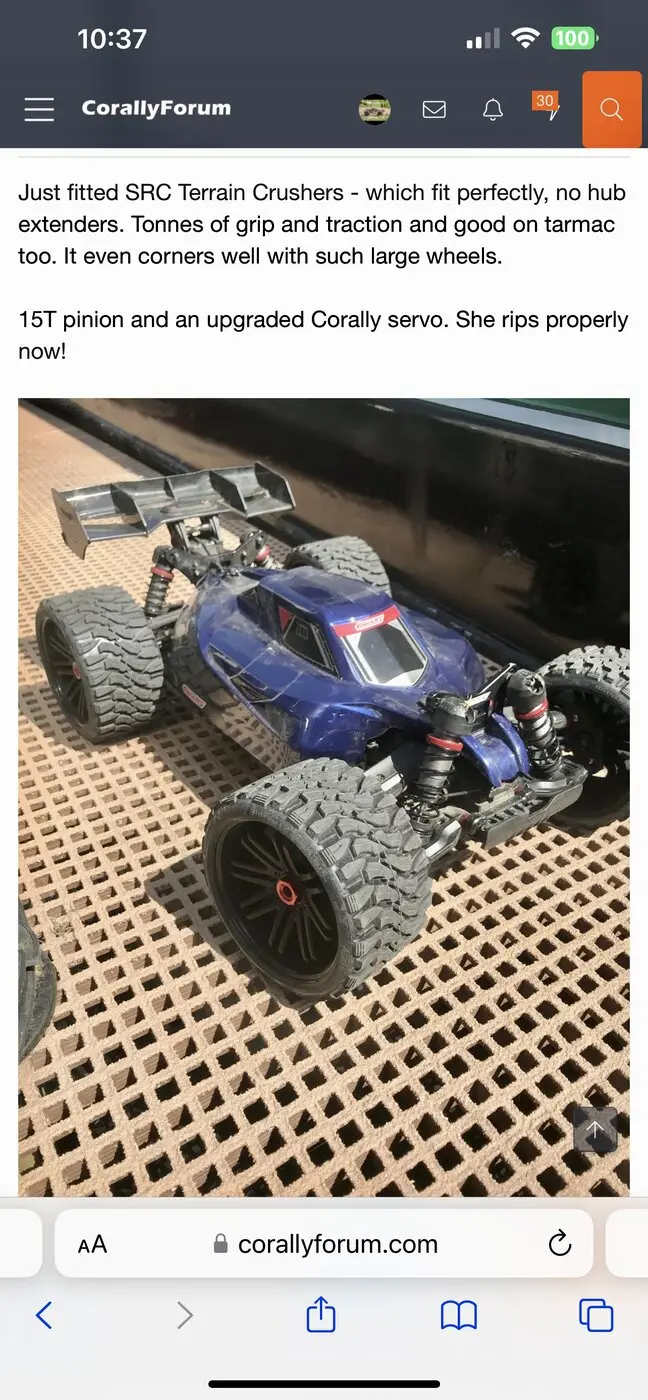

Thread 'Wheels/tyres and pinion/servo upgrades.'
https://www.corallyforum.com/threads/wheels-tyres-and-pinion-servo-upgrades.807/
I believe that this was on an older post. I think it was Owenrc.
There are probably a bunch of options due to the popularity of 2/8 buggies/truggies.

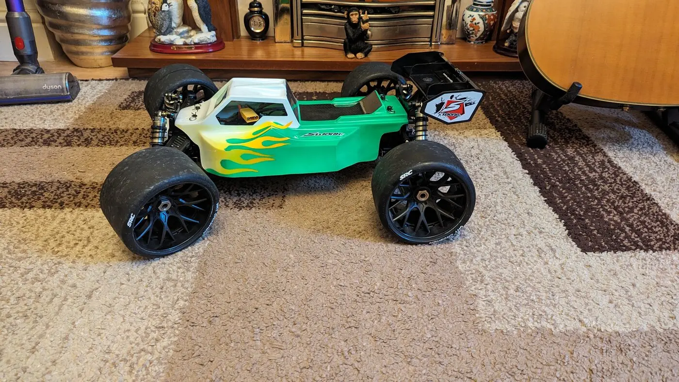

Hi mate I have Sketer wheels /tyres on mine and it's great.. Same outside diameter as original. Thing you have to watch is if you go bigger the shocks bottom out before the chassis destroying the shocks over time..hello, I wonder if anyone can recommend a slightly wider rim / tire for an asuga xl that will fit without extending the hubs, just buy and put there
That's a really good point! Silicone tubing bump stops can help.Hi mate I have Sketer wheels /tyres on mine and it's great.. Same outside diameter as original. Thing you have to watch is if you go bigger the shocks bottom out before the chassis destroying the shocks over time..
