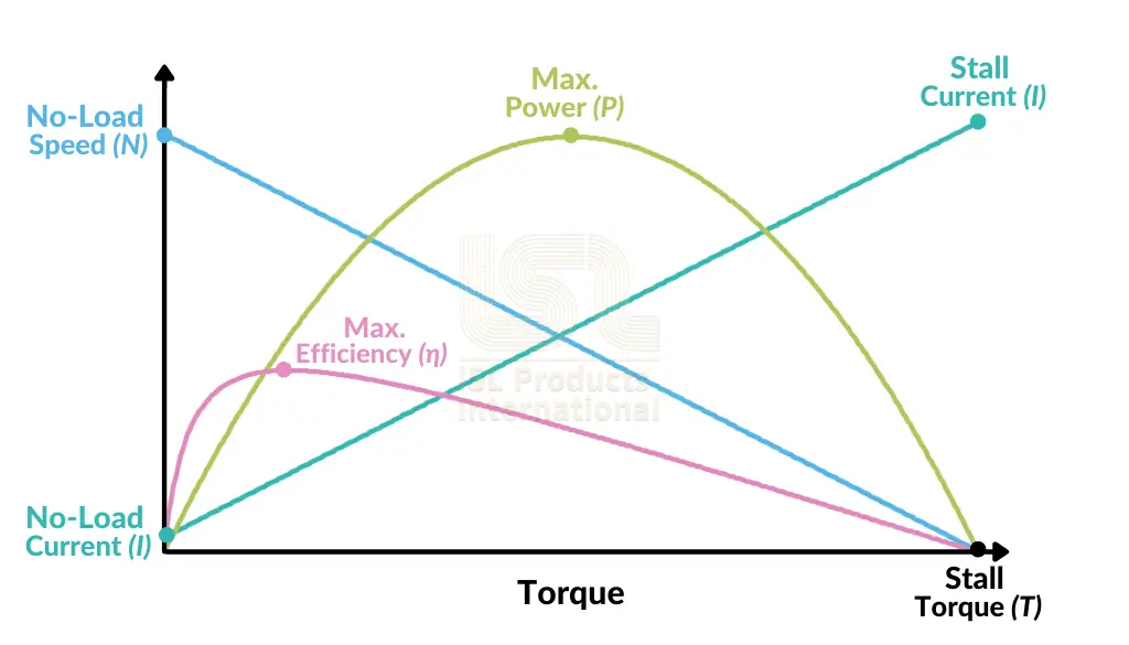

That's an interesting graph Horatio...very illuminating. I guess its back to the drawing board to try and figure out why I'm getting so much heat from my low KV motor.
It's a great graph - things are not as they seem with electric motors.
They're at their most efficient about a third of the way along the power curve.
And they produce the highest torque from the moment they start to turn. No wonder they accelerate so much better than IC engines. 🤩
Hrmm...a third of the way? Then I guess I've been more or less close to the mark for most of the time. In theory I try to keep the RPM range to around 10K; usually around the 7-8K range and sometimes in the 9K. The 1570 was sitting at roughly 6 thousand-something RPM, which is why I was wondering if it was undergeared.

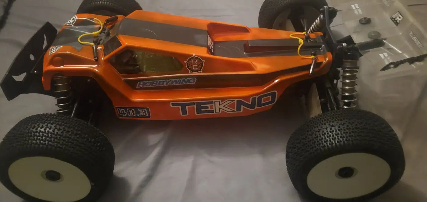

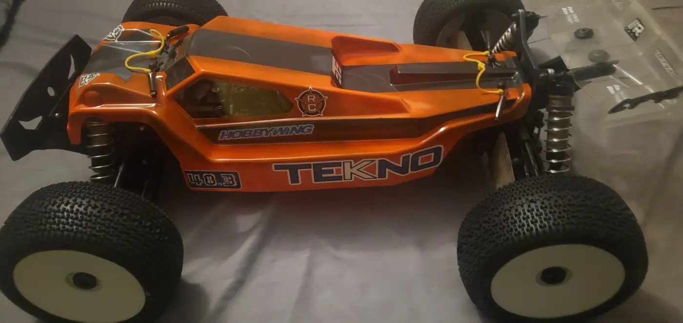

In the meantime, I have this little beauty set up at 16/44. 2200KV Hobbywing G2 and a XR8 Pro. I'll see how she does on her shakedown. I may go to a 14T or even a 12, depending on how the batteries take to the load.

In the meantime, I have this little beauty set up at 16/44. 2200KV Hobbywing G2 and a XR8 Pro. I'll see how she does on her shakedown. I may go to a 14T or even a 12, depending on how the batteries take to the load. View attachment 5409
And regarding this little beastie...I nailed everything all nice and proper. After about a 10min race-paced run, her temps were pretty good.
Motor: 116
Esc: 138
Batt: 105
I do believe that she's ready for the competition. Handles as smooth as butter and floats through the jumps. The only thing that messes up on her is driver input. Aside from that she's golden. (y)
