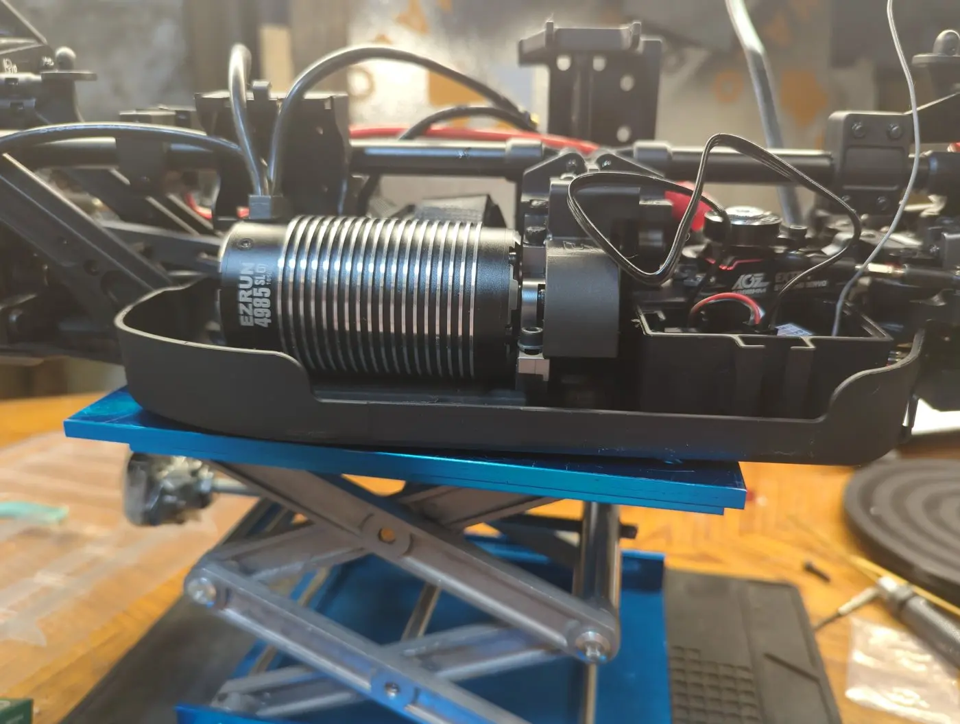

In trying to do a 20t on my max 6. Trying to find a mount to mod the gear to
max6

I want to do the same with my XTR, put in a Max6 with a 1650kv 4985 motor. Nice to see somebody already is busy with that and I can read about it.

Still no ideas yet on how to get a 20 and I also have a 26 I wouldn't mind getting on there just curious what would happen 🤣
Got the 20t pinion to fit and tested a few times. Absolutely insane. I put gps on it and at half throttle it back flipped 1 1/2 times and broke my GPS!!!. So I can't tell tea about a speed run yet but it's looking possibly 70s low 80s potentially will get video
