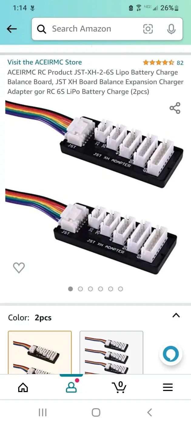

I got a set of these... little shorter than i would have liked but they work for me.

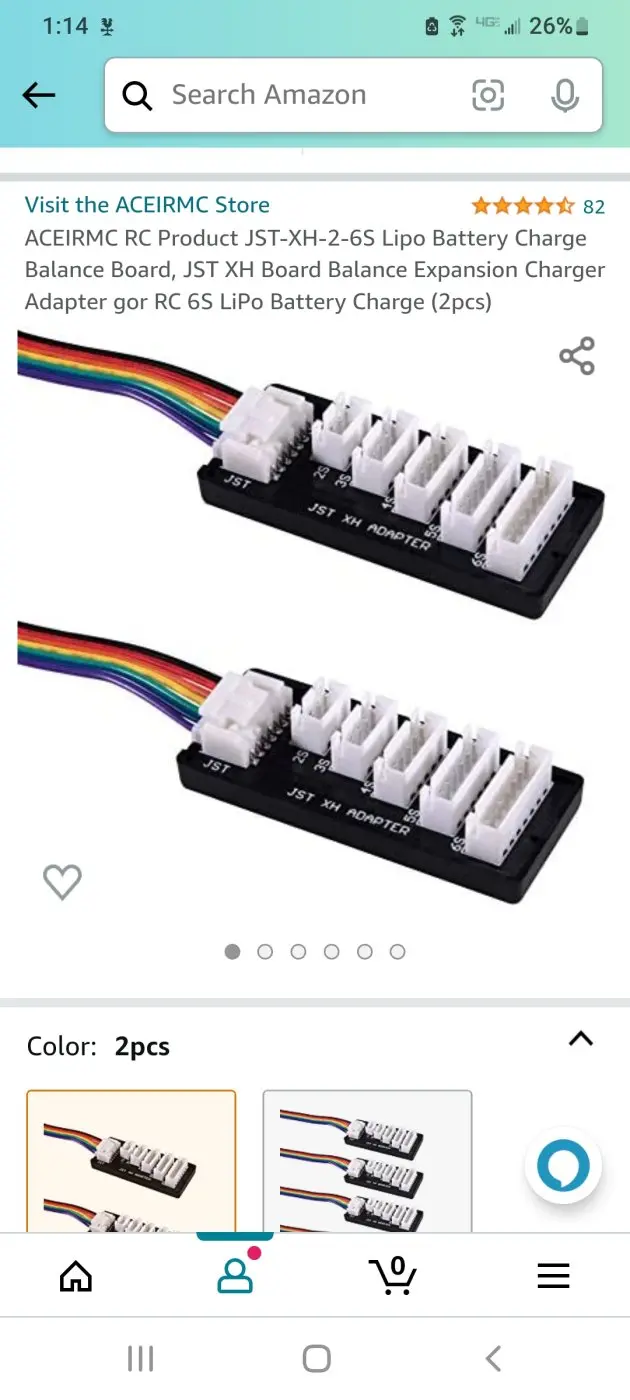

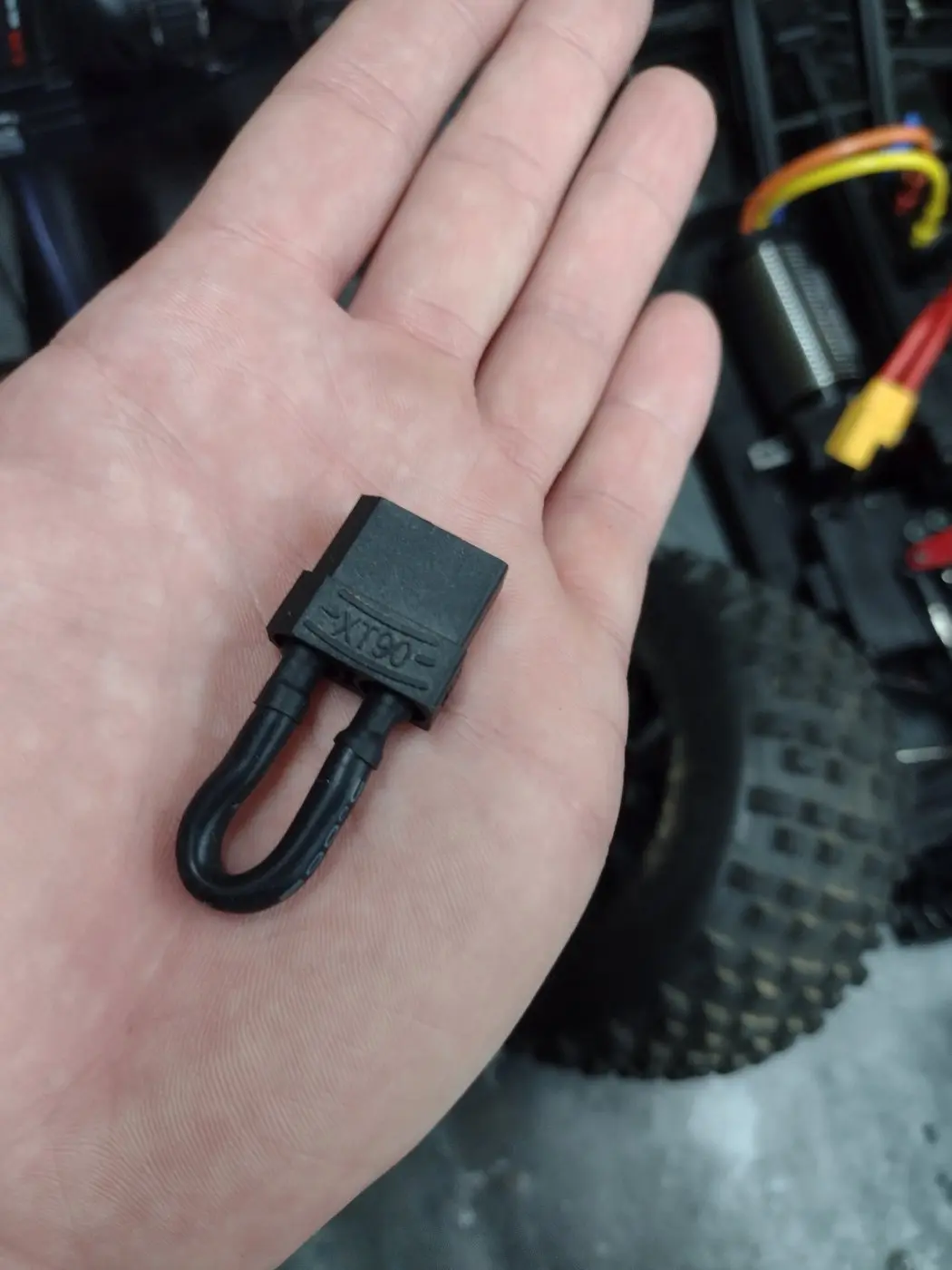

Brett, balance boards are pretty universal among chargers so you shouldn't have any issue ordering a board or two without concern of it working with your charger. As far as the no power issue, without seeing what you've got going on all I can do is guess so my question is I'm guessing you've left the esc battery wires as they were out the box, mean you have a set of series wires (2 battery plug ins) does the unused plug have the jumper wire installed?
Correct, I left them as is. One plug is bare, but no jumper came with the Torox 185 ESC, was it supposed to?
I don't know if they typically comes with one or not just buying an esc separate but that's your problem, you need to jump that connector together and you'll have power to the esc
