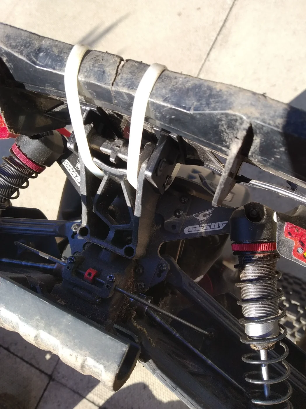

Two cable ties around the wing and wing mount will save the wing mount screws pulling through see pic :).You could get the updated one off the Limited Edition but this is cheaper :p.

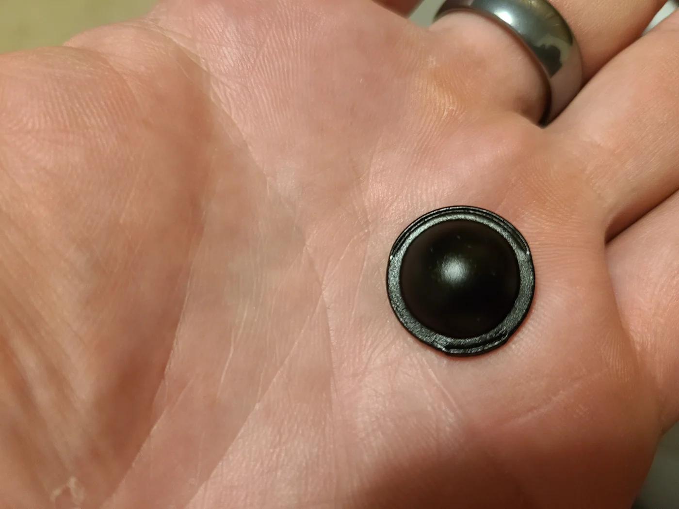

So I took it apart & the bladder wasn't installed correctly at factory or I'm not sure what happened, here's a pic, looks deformed & almost as if there wasn't an even seal, have u seen this b4?

Got plenty zip ties I'll try this, what's ur diff oil setup?
Have u seen this on shock bladders? Is that seal pattern normal? I got bladders & orings for all 4 shocks already

If your replacement bladders don't have that indent then it's deformed, every other type of shock bladder I have is smooth on the underside.
