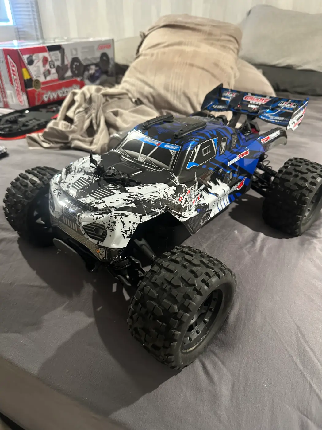

Kagama My new kagama 4 so far

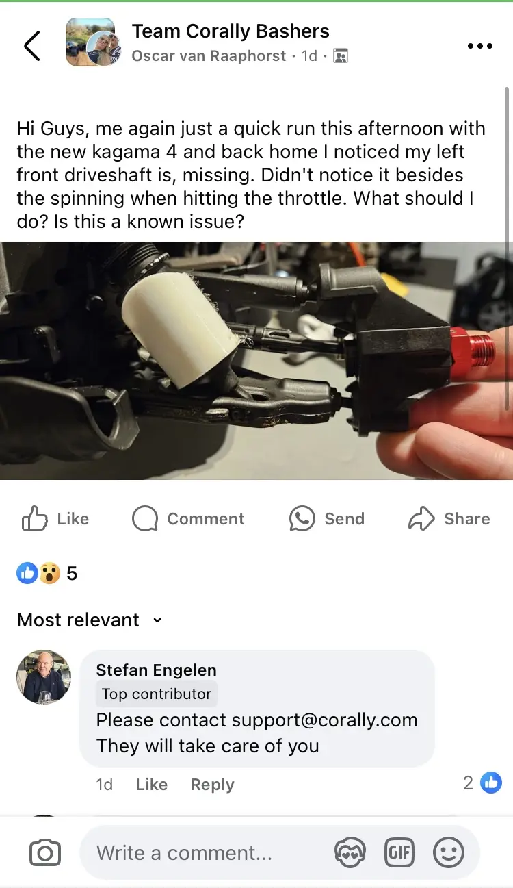

They are stefan a ceo or high up in corally group. They pretty good at resolving issues.
Same as ours lost front LH shaft then rear diff blew up that I brought new buggy last Saturday afternoon then 15 mins later noticed buggy not running ..checked it noticed sharft went missing.. heard loud cruching at rear diff.. oh f#$k just under 15 mins .
Contact TC support they will send out the new front CV repair kit, I installed mine on my Spark last night. I know was meant for the Kagama4 but it’s been bulletproof since my mod. The CV update kit super easy to do, I just ran a full pack in the wide body Spark zero issues and I’ve snapped pins all kinds of things until I did like TC before there fix to make a longer center CV pin. TC warranty department is amazing second to non
