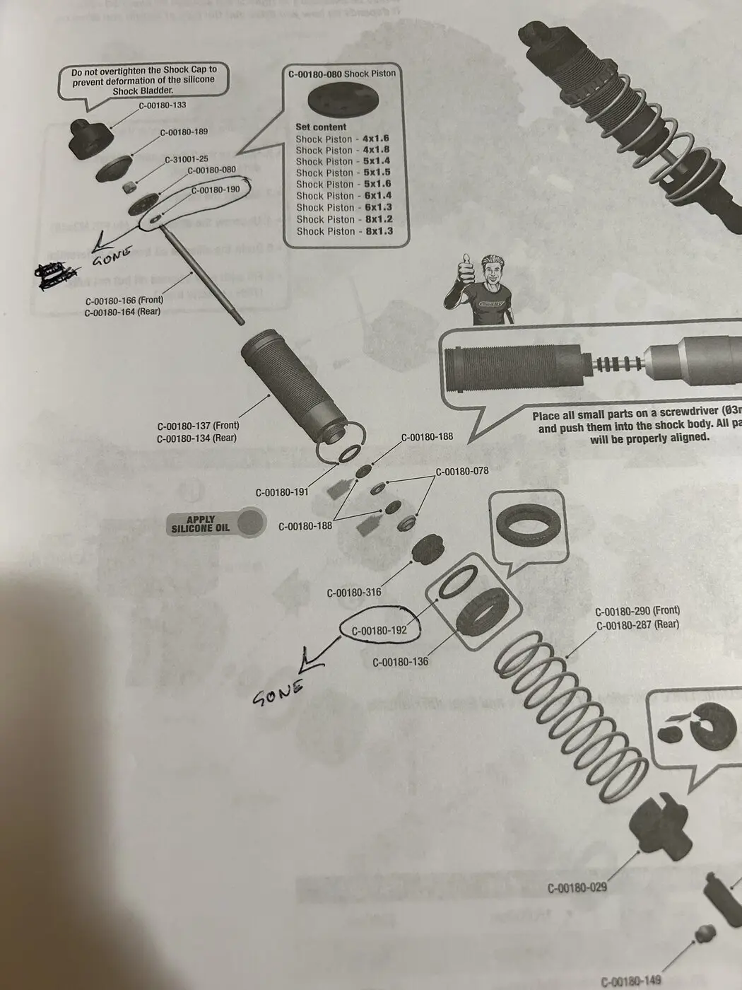

Thought I’d post this for information sake. Got a half dozen packs thru my Muraco and love it. But I had a front shock go limp and leak, so I completely took it apart and the piston was cracked in half. I don’t send the truck sky high, but it broke in half anyway. Stuff happens I know. Here’s the interesting part. The parts that I circled on the diagram were missing all together. I carefully double checked each part and they were never there. So I just put in an order for them at RC explosion along with pistons. The other three shocks are still rebounding fine, and not leaking, so I’m not going to dive into them until necessary, but I thought maybe I should let everyone know to take a careful parts count when you inspect your shocks!
