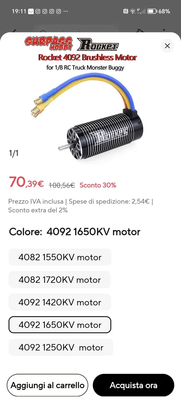

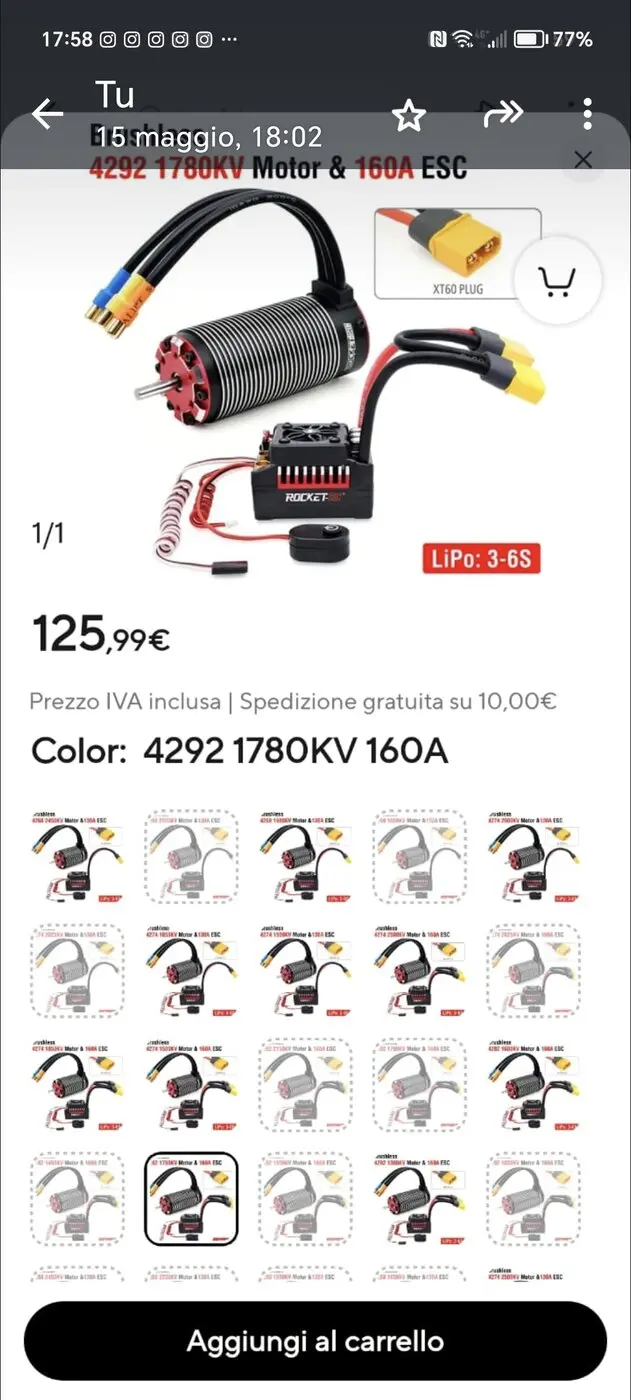

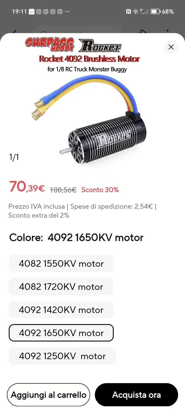

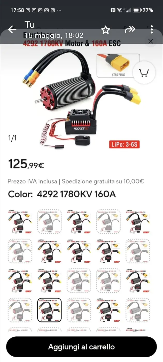

A friend of mine mounted the Rocket 4092 1650 kv on the Kraton, rocket esc (the same one present in this photo where it compares the 1780 motor ), 20 pinion and spur gear of the Arrma felony, excellent result, very fast😱
View attachment 6087View attachment 6088

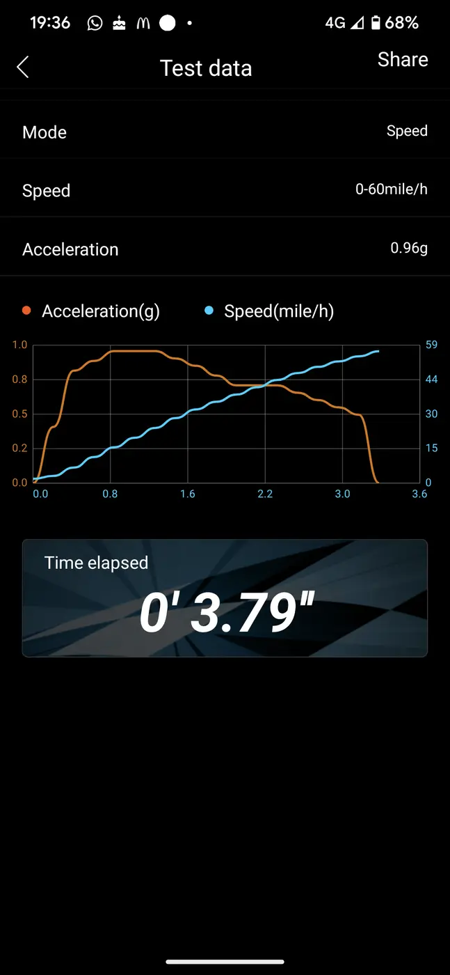

Get your friend to show us how fast it is!! 👍
He can screen-grab a SkyRC GNSS/GLONASS GPS. It's an excellent bit of kit and satisfies curiosity! 😅
I'm all for making our rigs fast, but I think people ignore 0-60mph performance, which is the very essence of what makes our cars feel fast.
The challenge of having one fixed gear ratio is that what works well for acceleration acts against top speed and vice versa.
I know it's super hard getting our rigs into 100mph, but so too is getting decent 0-60mph times - without electronic driver aids.
Here's my PB with the XTR, using the 825 on 13t.

0-50mph in 2.99 seems very quick to me. And if you do some simple maths, you can see that the Sworkz is actually 'quicker'. The G figure doesn't lie.
No real surprises as it's lighter than the XTR by a comfortable margin and both are being powered by 6S. It's all a matter of temperature, traction, gearing, rollout and getting the power down as quickly and smoothly as possible.

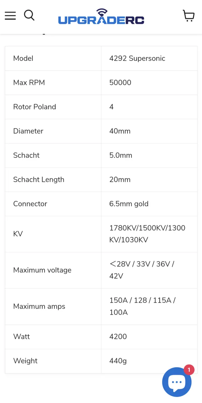

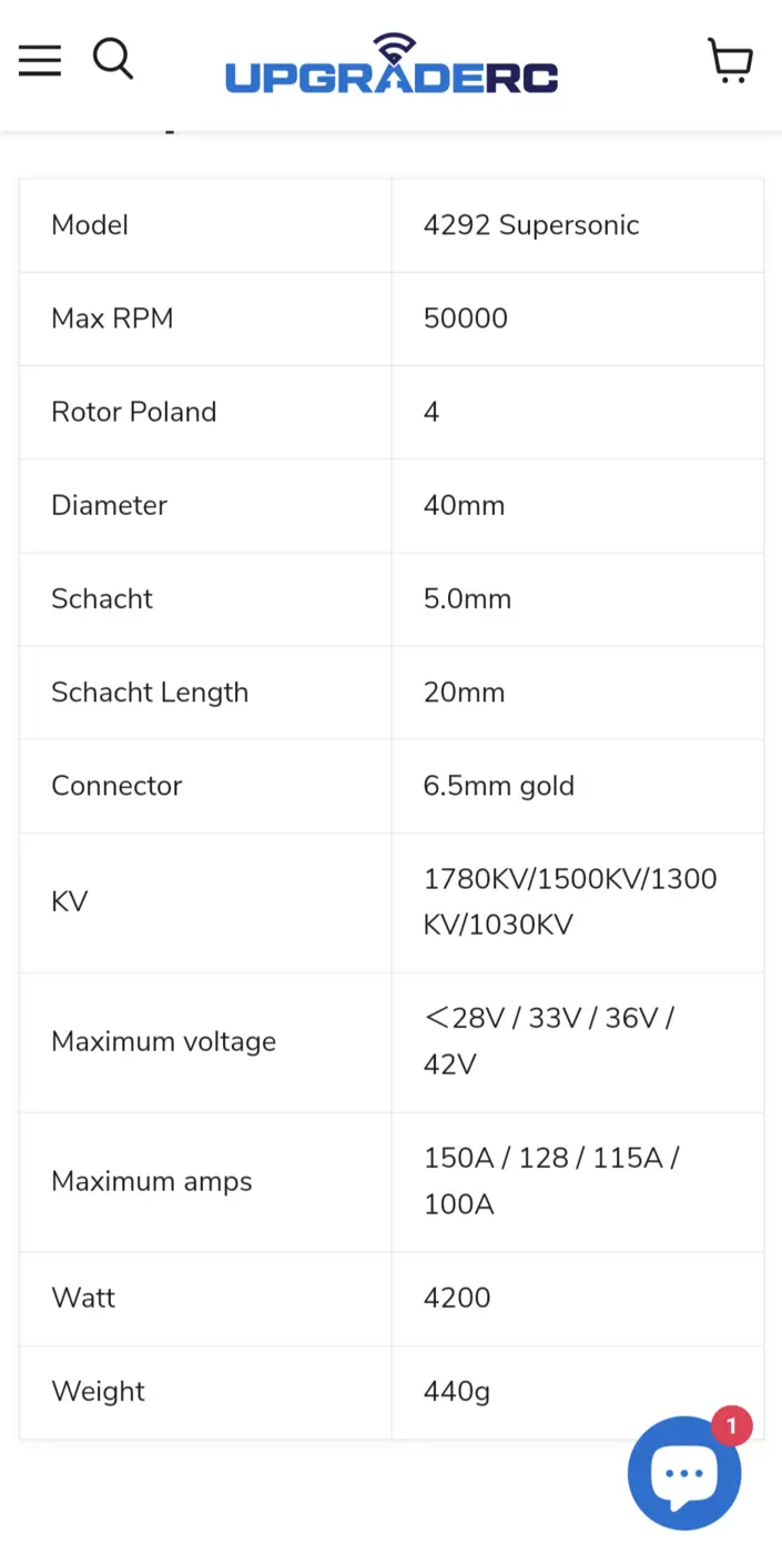

So far, my Torox has been fine with the 4292. I have no concerns. According to the specs, it's actually able to handle 185 amps. The 4292 is supposed to draw no more than 150a. 🤞
The debate continues, because we all believe the Torox is a rebranded Max 8 and some have stated the specs are 'wrong'.
However - the firmware is 'special'. 😜
The Max 6 would be an upgrade to the Max 8 - both of which are rated at 160a.
The Max 8 recommended no larger than 4278. The Max 6 recommended no larger than 5892.
