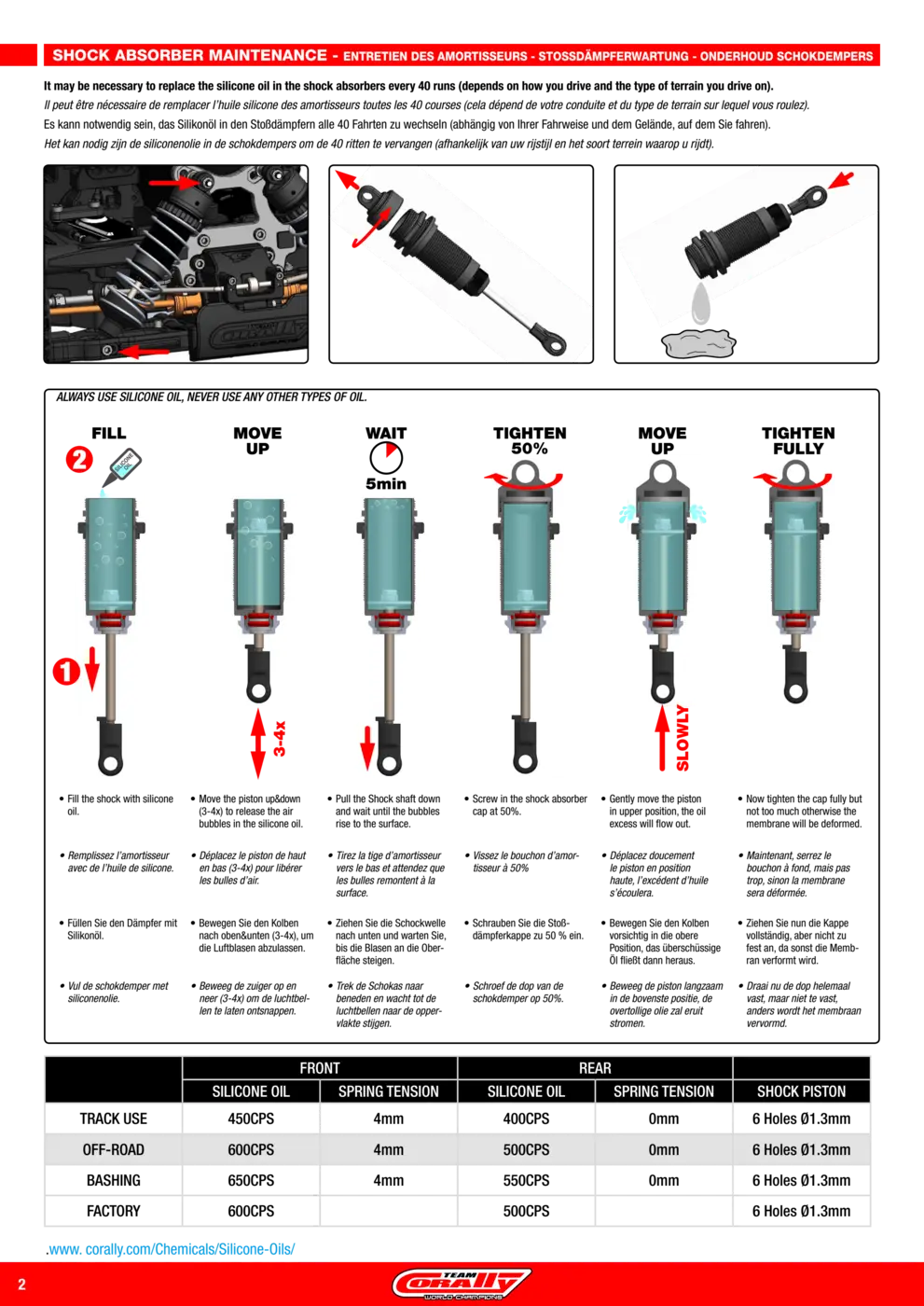

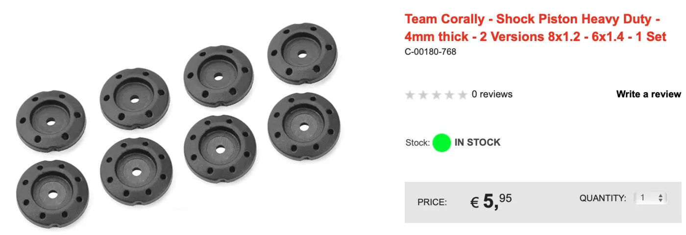

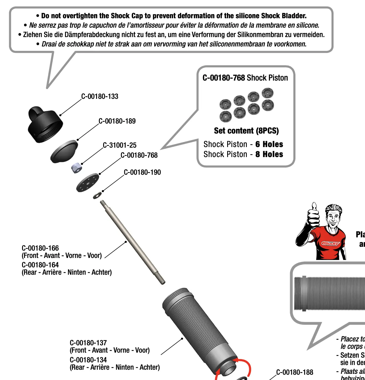

Can someone with a 2022 XTR please let me know what pistons are used in which shock ??
I know Corally use a 8x1.2 and 6x1.4 as the new 2022 pistons, there is no mention in the manual as to what is used in what shock front or rear..!!
