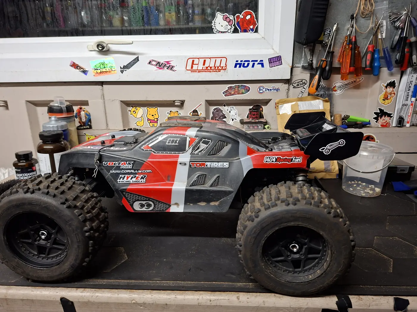

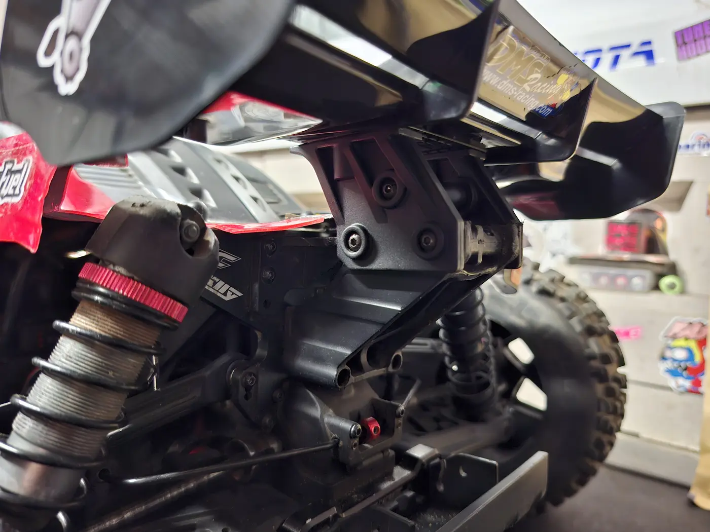

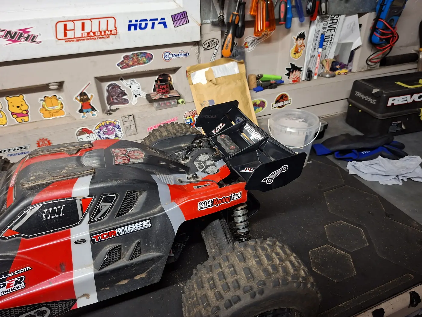

Got sick of cable tieing my wing on because these stock wing mounts are crap :rolleyes:.
Seems TC updated the wing mount and made the wing super flexible on the kagama limited edition but I cannot seem to get the part in the uk and didn't want to pay postage for a cheap part from TC.
So after seeing how the Asuga has what looks like the updated wing mount as stock I got one of them and a Syncro 4 wing as they are really flexible. Its on a bit of a angle than stock but you can flip it and bring it closer in if you so wish.
Part numbers:
Wing mount: C-00180-894
Black wing: C-00180-1127-B
My LE wing seems to have been more brittle than the Asuga wing.
To make it more robust I printed TPU wing washers and the wing mount in TPU. The flex allows everything to last longer.

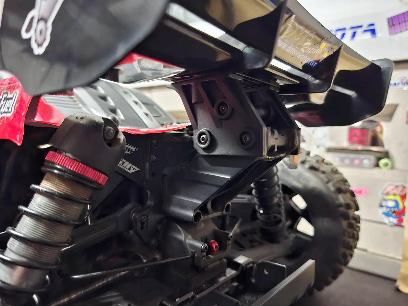

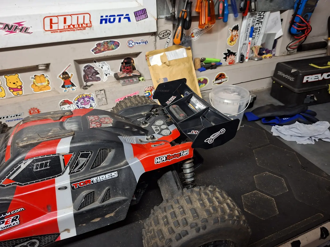

View attachment 11966View attachment 11967View attachment 11968
I think it looks 👌👌🫡🫡
Well finally got out to play seeing how the rain has stopped for 5mins 😄 .
This wing mount and wing combo work spot on, the Kagama crashed quite a bit seems I am well rusty driving this thing 😅. The wing stayed on and the mount is still in one piece, this is with some flipping / crashing that would definitely broke the old wing mount.
