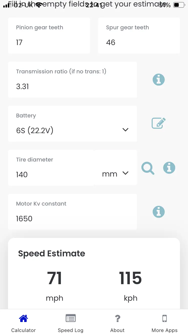

Sorry if this is a repeat of someone else's post, but I've got a Kagama 6s roller on the way and I'm thinking about gearing for the different power systems I plan on running. I'm planning of starting with a max8, and then swapping to a max6 with a 4990 from my speedrun typhon once I'm satisfied with the speeds I hit. I'm planning on sticking with the stock 13t pinion for the max8 with the 2250kv, but im not sure what the gearing should be for the 1650kv one. I'm also curious if anyone has insights on good buggy gearing for a max8. Thanks!

19t for a typhon was right about what I was guesstimating. Thanks! I'd imagine the stock arrma setup will provide a good baseline, I mean I've heard the Kuron/Torox combo that comes in the rtr runs pretty hot, so it'll be interesting to see how the arrma system does

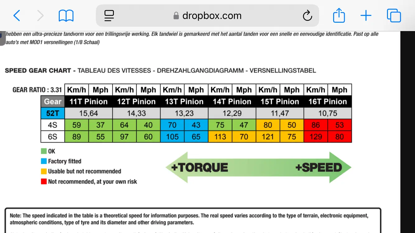

If you look in your manuals there also available online there is a gearing chart, for the stock electronics so with slightly higher kv motor maybe get a slightly higher top speed but should give you an idea for gearing.
Sweet! Are most 1/8 scales 3.3 ratio, or is this just something you know for the kagama?
