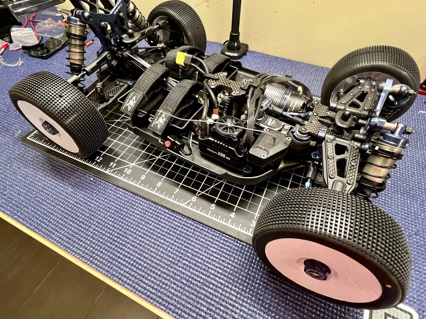

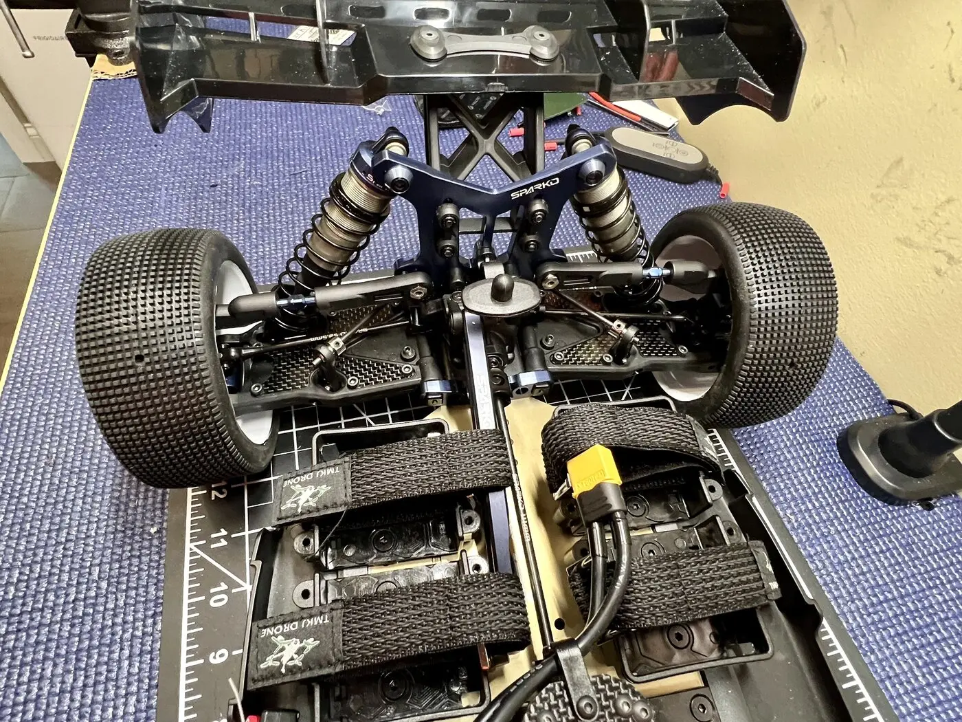

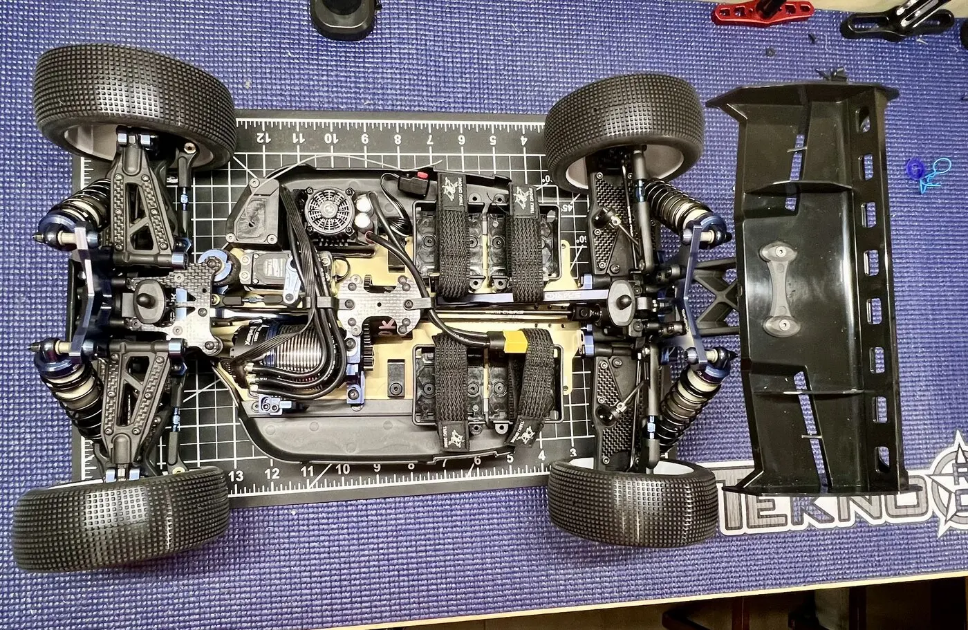

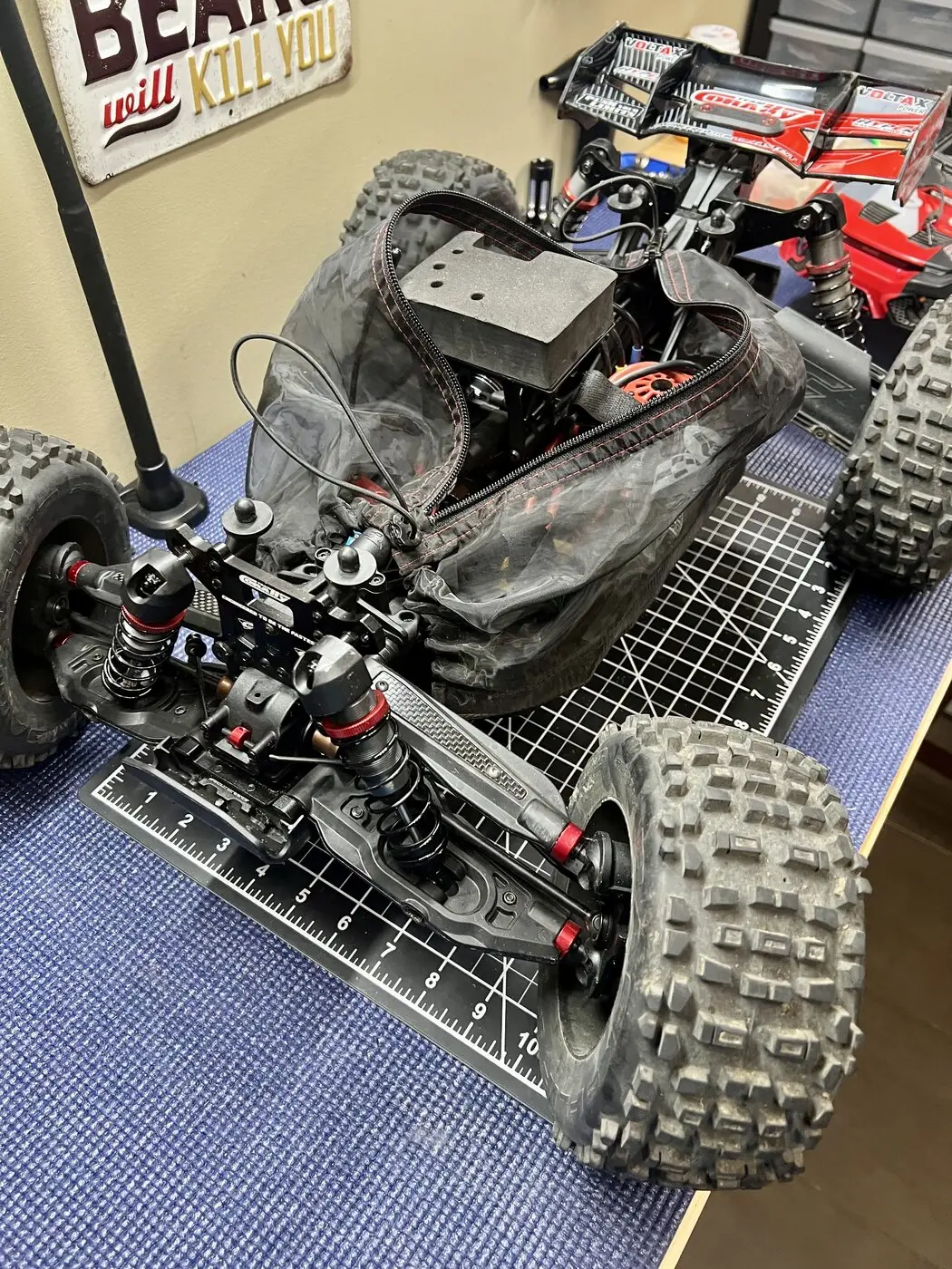

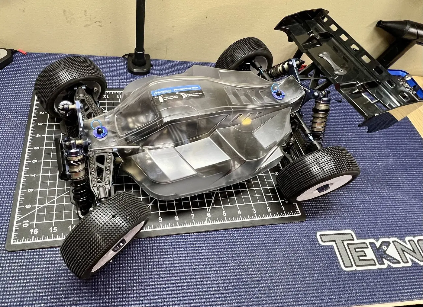

I’m just running
I’ve changed about everything at some point, and then I chaged it again. Currently I’m running the Kraton springs on my Kagama with the arena 6s bf’s or Sweep Terrain Crushers, kinda preferring the Sweeps unless I’m really bashing hard.
The SSTE’s are still around, you just need to look for them, at least in the US. I can usually find the RTR for just under $500 US and the ARR version is usually between $300-375 US. I have only ever used the ARR. it’s a really good deal for the $$$ imo. The only drawback for me is that they are already built. 😦 At least with the ARR, you can source the electronics and set it up how “you” want it. That parts dope! 👍👍👍👍.
I dropped the same electronics as come stock in Kagama, just a different servo so I jokingly say it’s “Corally Powered”. It’s definitely one of my favorites. Beyond RC has a good review of them on his YouTube channel. I may order a second for my street basher project but I’ve got a couple of other things to pick up ahead of it.
Order is in!
