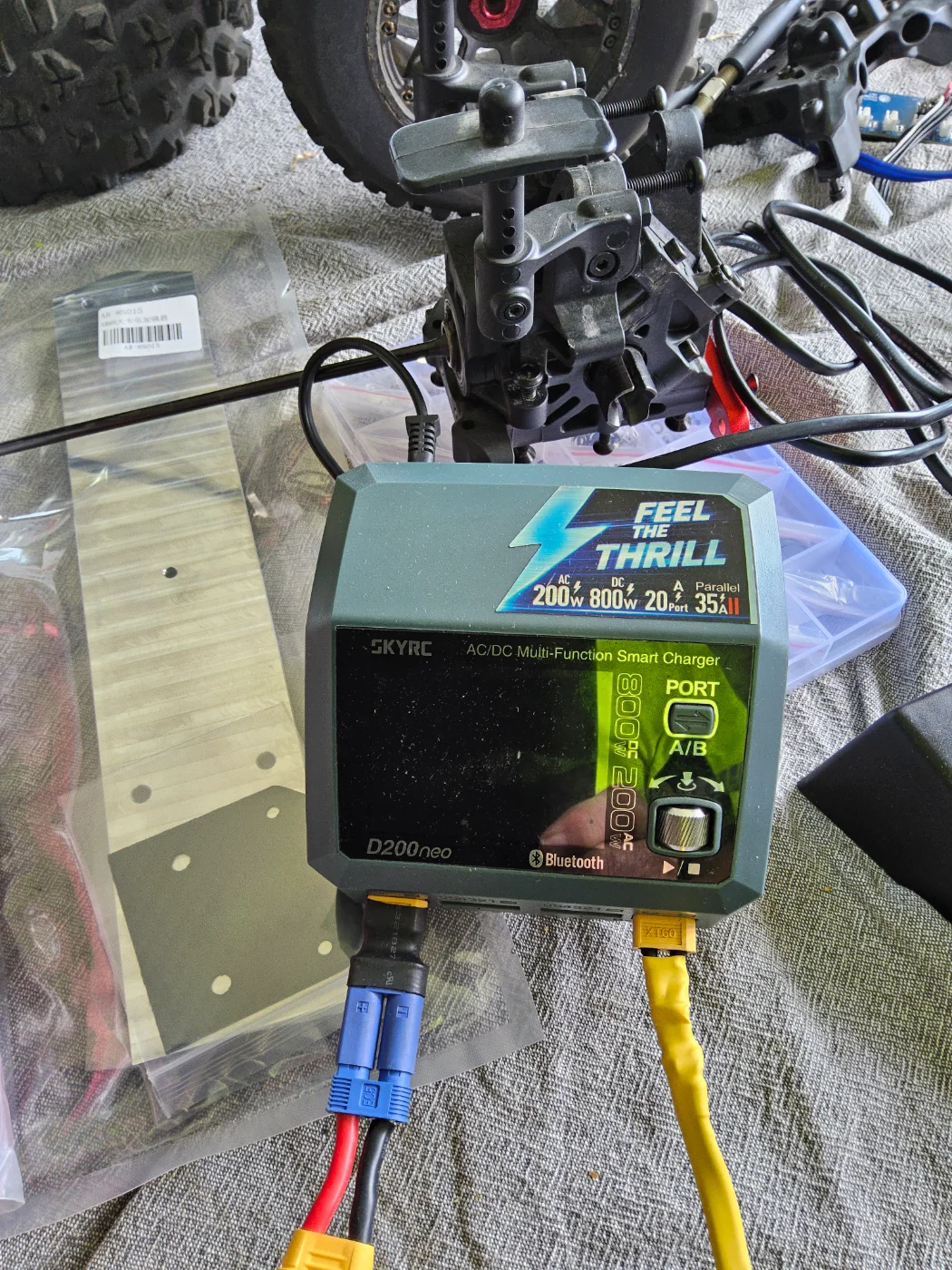

I run a D200 neo but it’s connected to a 30amp DC power supply so it’s able to run at the full 700/800watts.
