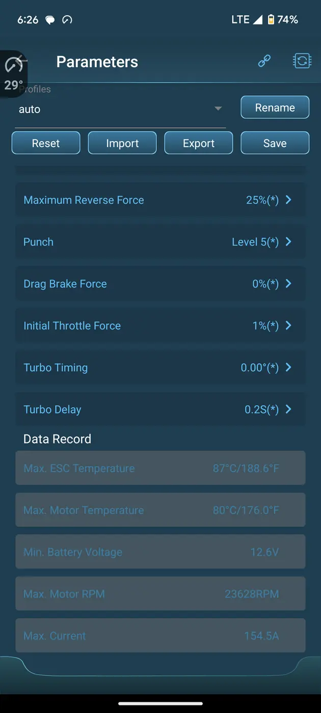

Yeah, I have a temp gun, and my ESC has logging features. These are the temps I was getting (running on gravel over blacktop) on 6s with 13t pinion and everything stock except shock standoffs and front shocks tower 7075 ADU Racing upgrades. I have a small area I practice in, so there is a lot of start and stop, which plays hell with the temperature. I run a 40mm server fan at 1 amp 12 volts with a 7.4 v BEC.

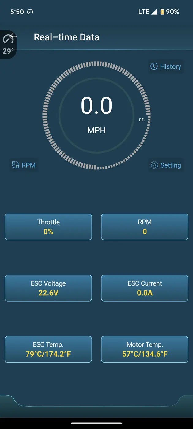

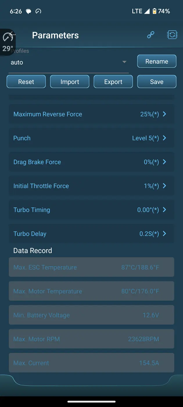

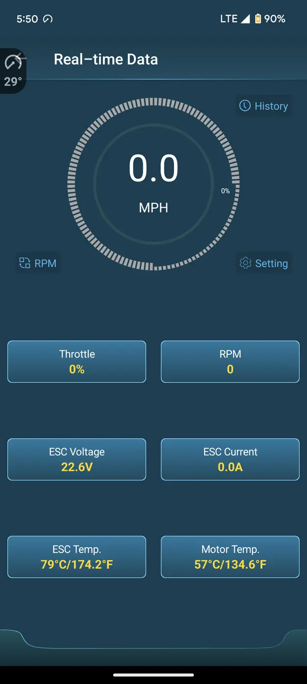

Yesterday I switched to a 11t pinion and my temps are as seen in second image: way cooler.

That's a great looking app/interface! Temps look under control. My first outings on 13/52 resulted in motor temps over 200°F on my Kuron 825. It's a miracle it didn't fry.🤠
I check temps with my temp gun from time to time, especially since I've been running higher gearing, and avoid going over 160°F. 👍
