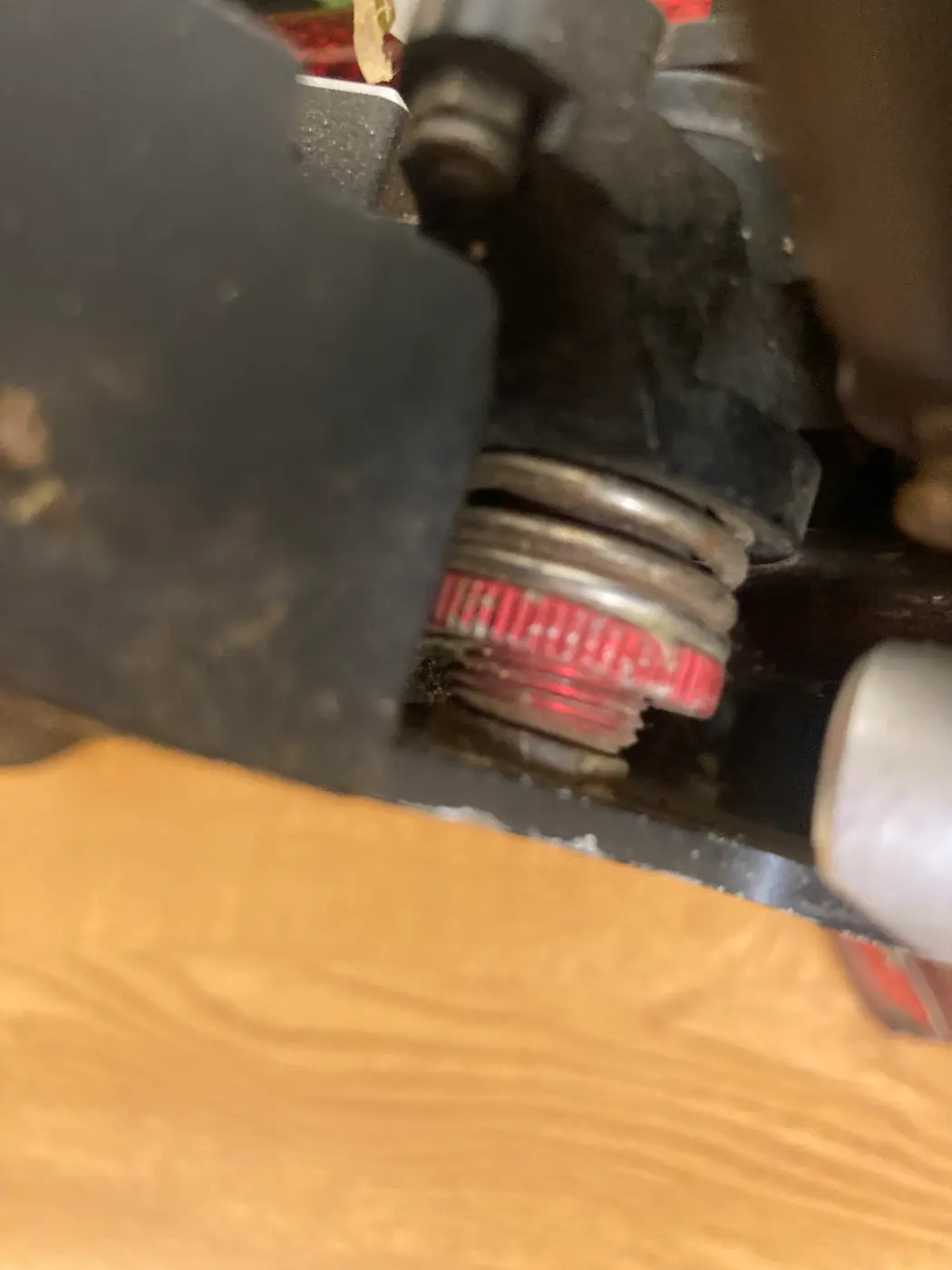

The much discussed LC 085J 0 M spring arrived today. Got it installed and my steering is binding terribly.
The only thing I can think of is with the new spring installed and the servo saver left as "loose" as possible, the saver assembly seemed to be higher than it was with the stock spring.
Wheels are very hard to turn by hand and with truck powered up, my servo no longer returns to center after steering.
I just had my truck out earlier today and there were zero issues with my steering and centering.
Last night I even installed an aluminum servo saver lower piece (the part that attached to the steering link coming off of the servo horn), and the spring replacement today was the very same process of teardown and installing 90% of the same components that I did flawlessly last night. I installed all the parts and rebuilt them today in the same manner. Everything went back in place just fine.
Do I need to tighten the saver more so that it is not taller than it was previously?
That's the only thing I can think of that's different: the saver assembly is definitely higher up because it's taller with the new spring.
Any insight would be superb.
I guess I'll take it apart again and tighten the saver more. I just didn't want it over tight.
Some pics might help. I sounds like you made a small mistake somewhere because I can't think of how the spring would cause problems. And what do you mean that the saver assembly is higher up? The only thing that should change when thightening and loosening the spring is the height of the retaining nut.

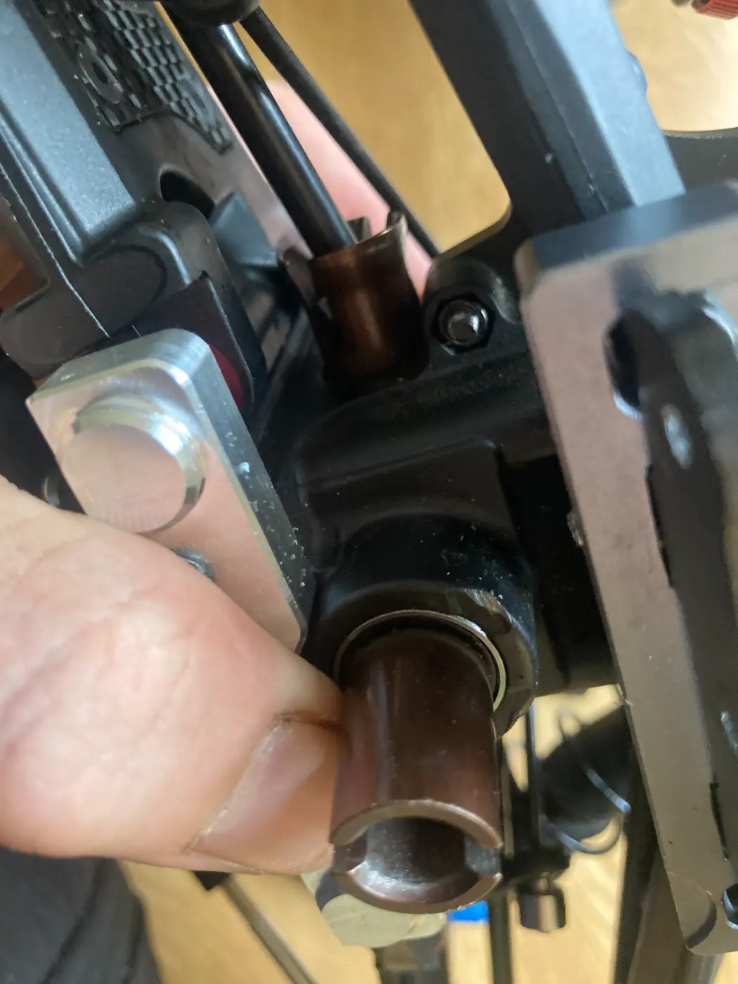

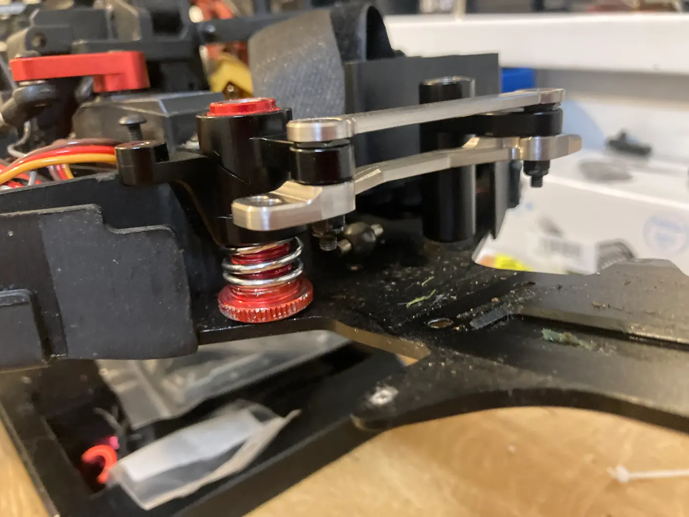

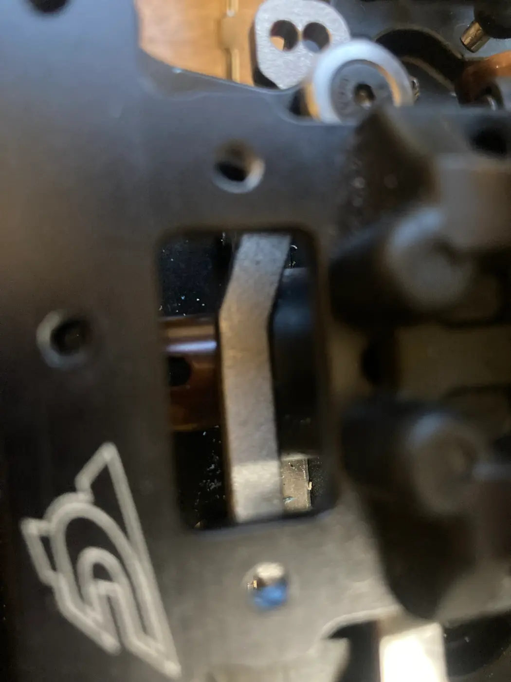

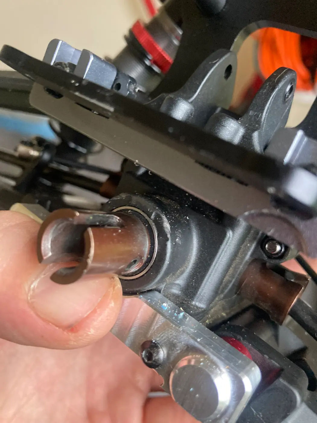

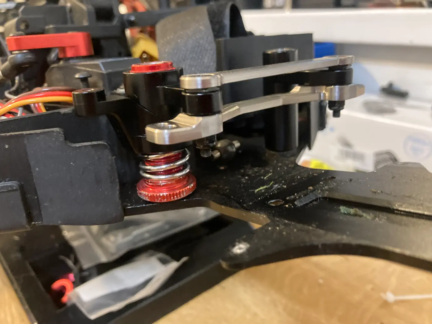

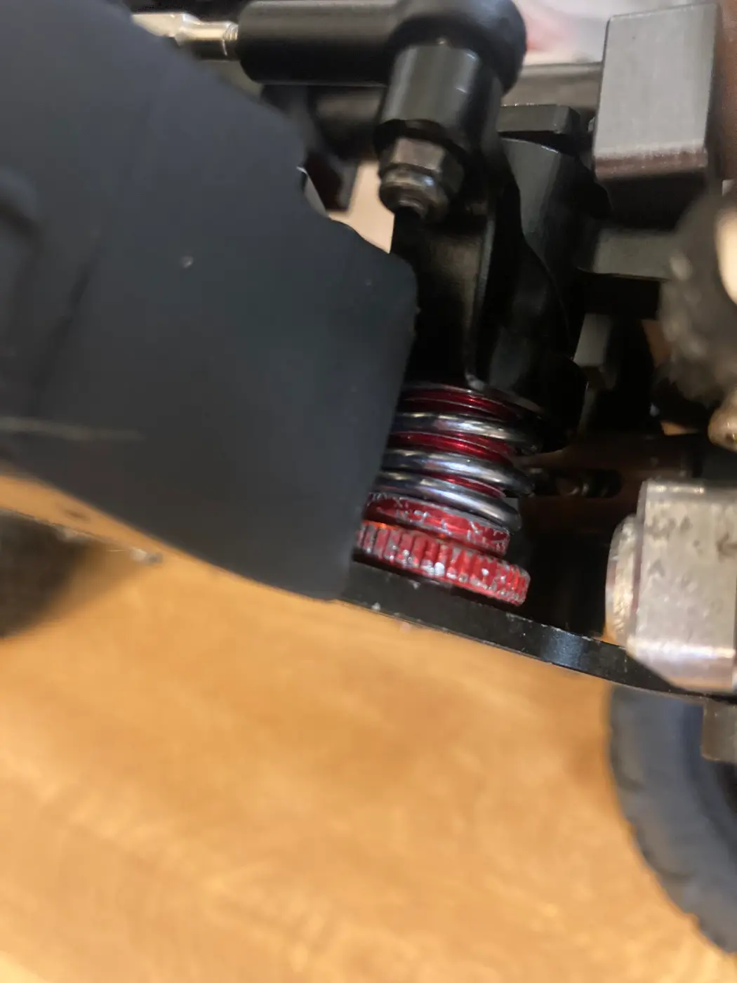

If it’s binding I’m guessing the Ackermann is hitting the diff case something not lined up right though there’s not great clearance myself & others have gound off some material there. Pic of my buggy servo with stock spring wound pretty tight, and Kronos with upgraded hpi hard spring if it helps.

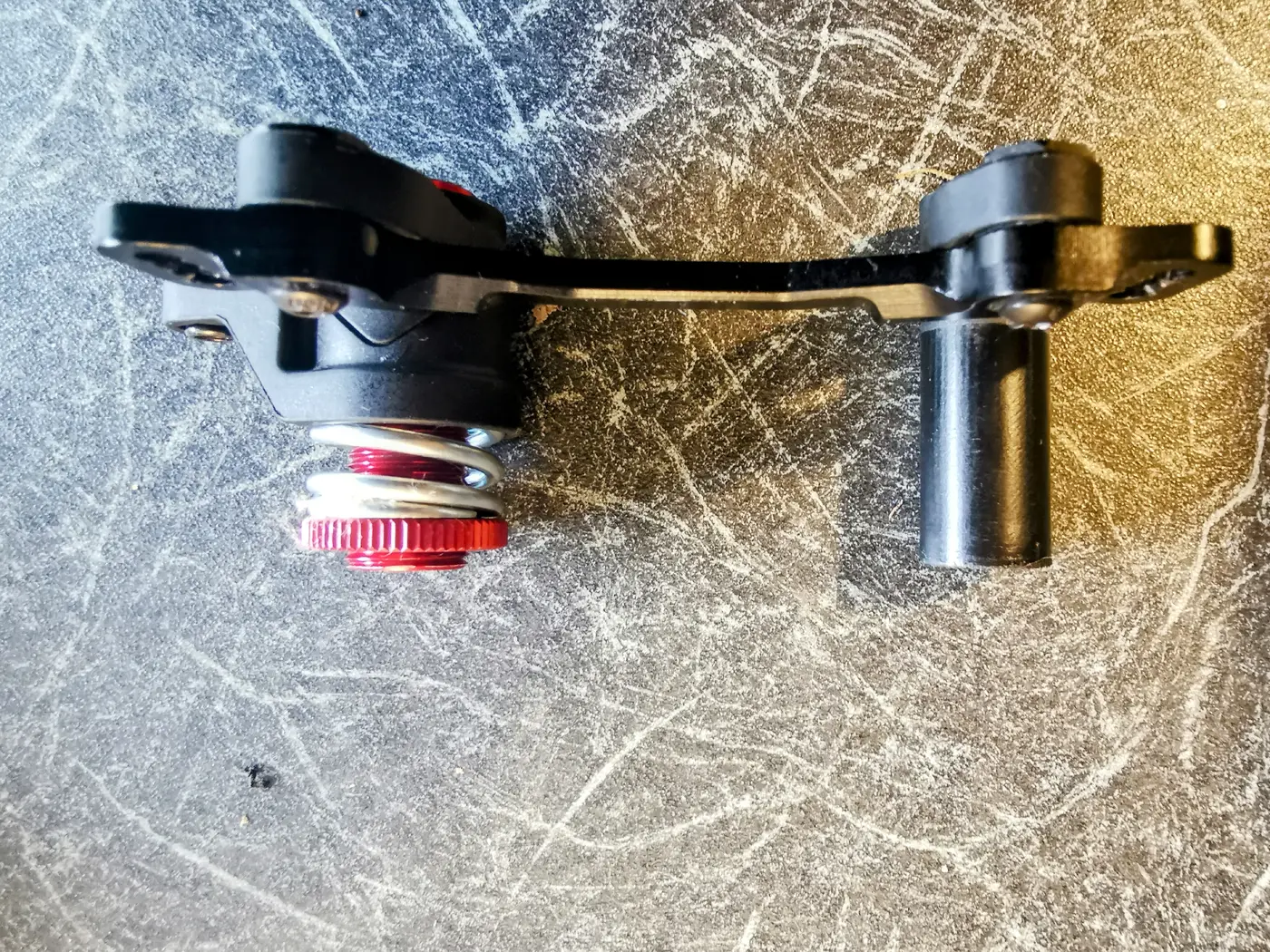

Once the spring is fitted, it should look like this:
Note the collar. Pressure has to be applied to the collar whilst it is lined up with the threads, as the spring is longer than stock by a few millimetres.
This does not alter the size of the servo saver or change the geometry.
If something is higher with you or rubbing - it sounds like an assembly issue or something is bent. Possibly both.

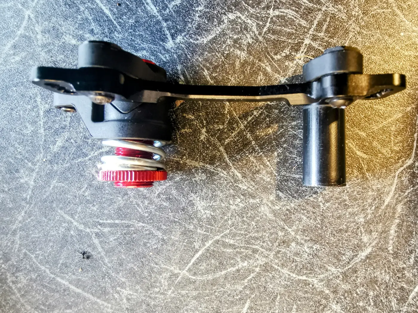

I also made mistake of installing Ackerman upside down that will also cause it to bind
