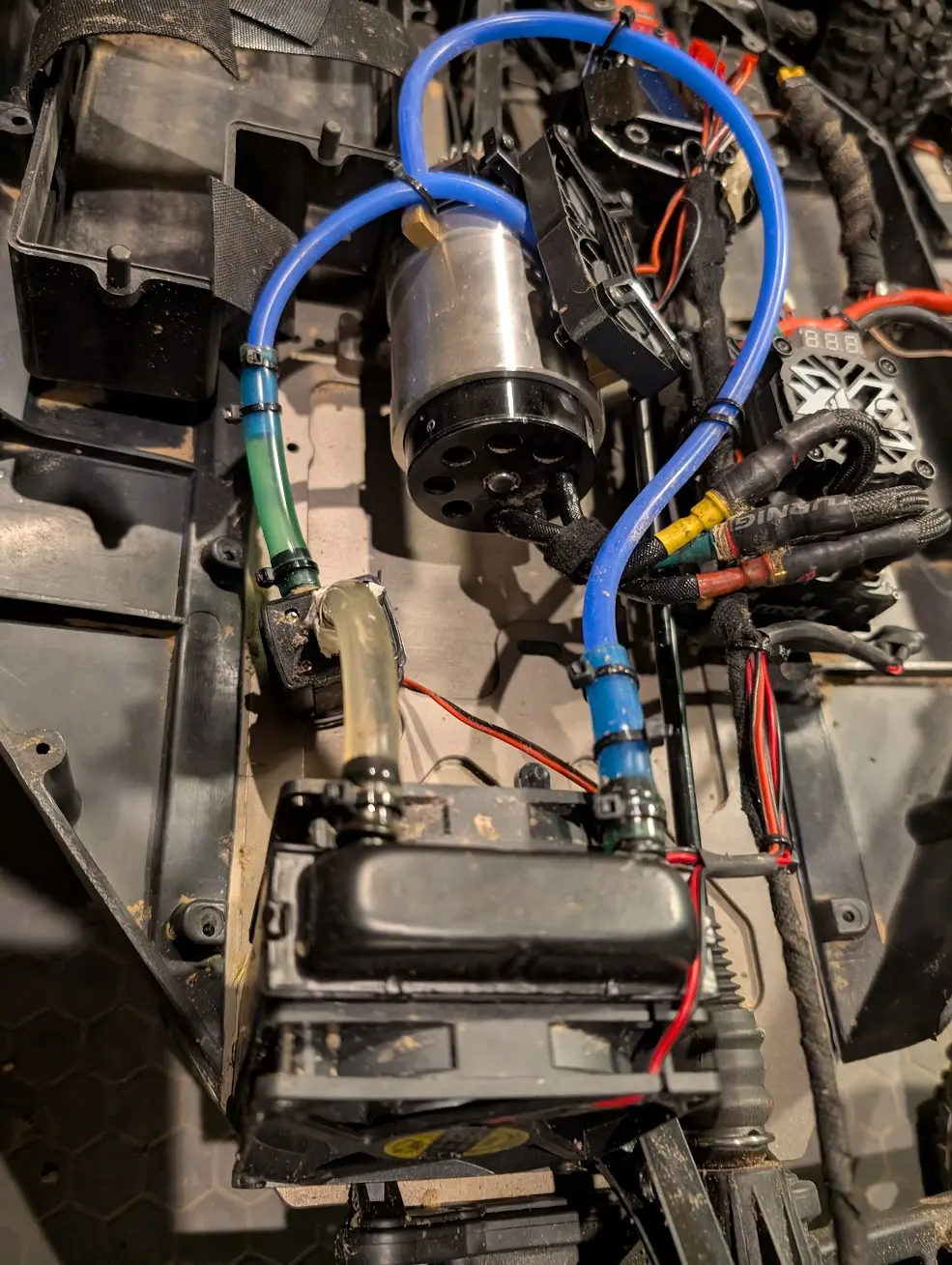

Or just add watercooling to the motor, thats what i did :)
This is my WC testsetup, I will make a cleaner install. Got a different motor and WC-sleeve coming in. As i can't change the gearing easily i am replacing the current 1100kv (6-8S) motor for a 650kv (8-14S). I am considering to take my HW seaking 300A (up 14S) out of my boat and add it to the loop.
But like i commented on the 14S above, it does not support braking, only dragbraking.

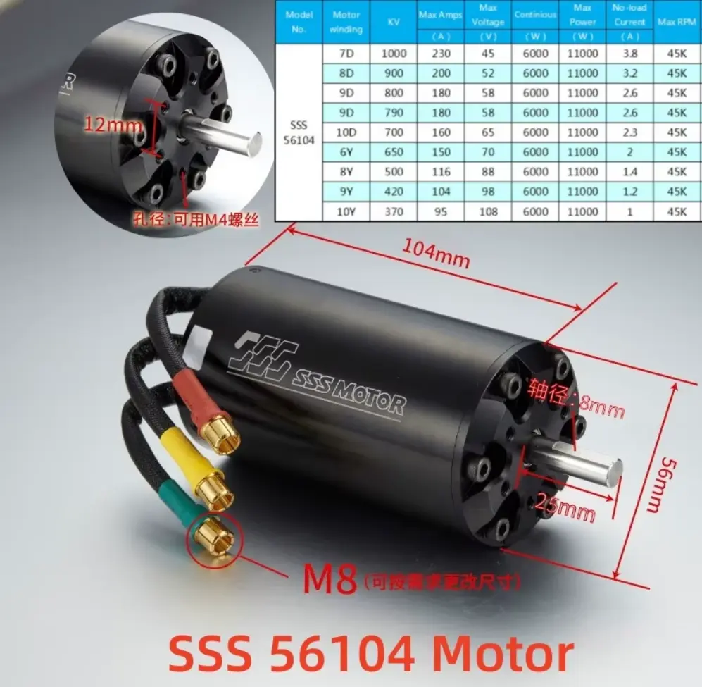

i do understand the advantage of higher voltage, but what about the total weight ? what lipo do you use to get 14s ? what motor has a low KV to suit 14s ?
14s is 58.8v, so all of these below 800kv would work:
I'm putting a 650KV in my Rofun
Weight is kinda relative. If your RC suspension/handling isnt ruined by it, it should be fine.
