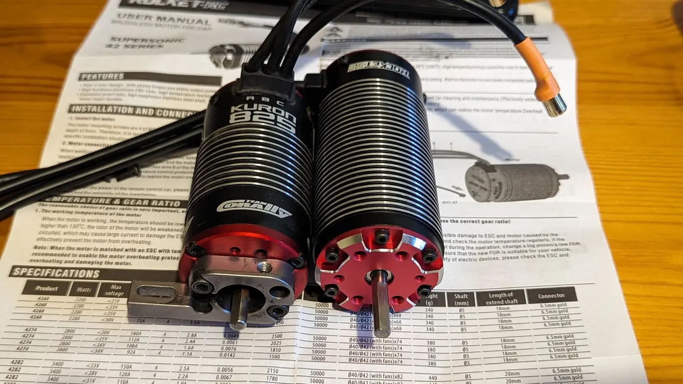

A comparatively inexpensive Surpass Rocket 4292 1780 KV is 4200 watt motor, compared to the 825 3000 watt motor.
It pulls higher gears and tends not to get anywhere near as hot.
It is heavier though and the 825 pulls off better 0-60 times, but driving the 4292 around, it has a wider spread of useable power and hits 69 mph on 18/52. 💪 It barely got warm.
My next planned speed run with the XTR will be with 19/52 and 19/46 ratios, where I expect to see 70-75 mph. 🤞

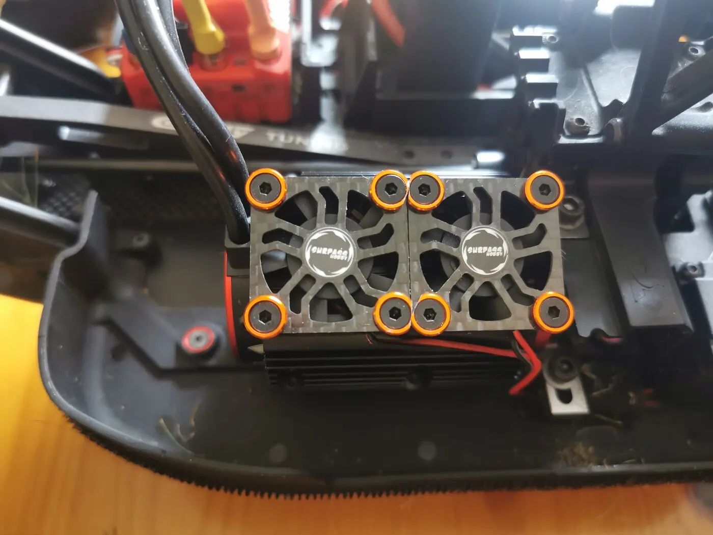

I'm using this Yeah Racing dual fan mount, with Surpass Carbon Fibre covers.
These are available in the UK, so there's no need to import from China. Unless you're on a budget. Or like waiting. Or both! 🤣

The standoffs supplied with the YR item are designed for the purposes of fitting between the top heatsink and the bottom clamp - for those running bigger diameter motors (like the 4992 for example) etc. This is simply fact.
But the weirdy instructions written by an individual who is not allowed to be questioned under any circumstances because: politics - states that the standoffs are designed to be placed under the fans.
If you possess functioning eyes and an IQ higher than your shoe size, you'll quite rightly ask the question: how come there are only 4 standoffs if they are to be used for 2 fans?
Well according to the instructions, they show fans dangling (literally) off just 2 standoffs each.
This is absurd.
So guess what? They're really supposed to be used like this, because: common sense.
Used in this fashion, they work very, very well.
Or you can do it this way, if you like repeatedly breaking stuff:
I mean, seriously! 🤣😝
You can't make this sh1t up!
Critical thinkers - you decide. 👍💪
I have ordered some yeah racing ones from model sport, So I will i might need an explanation how to fits as don't seem to come with enough collar if not i might fight like the blue ones :eek:
You don't need to use the stand-offs unless you're trying to fit it to a wide-boy motor. 😅
Then you'd fit them between the clamping plate (on the under side of the motor) and the heat sink.
Repeat: Under no circumstances do you dangle your fans off them, copy? 😝
