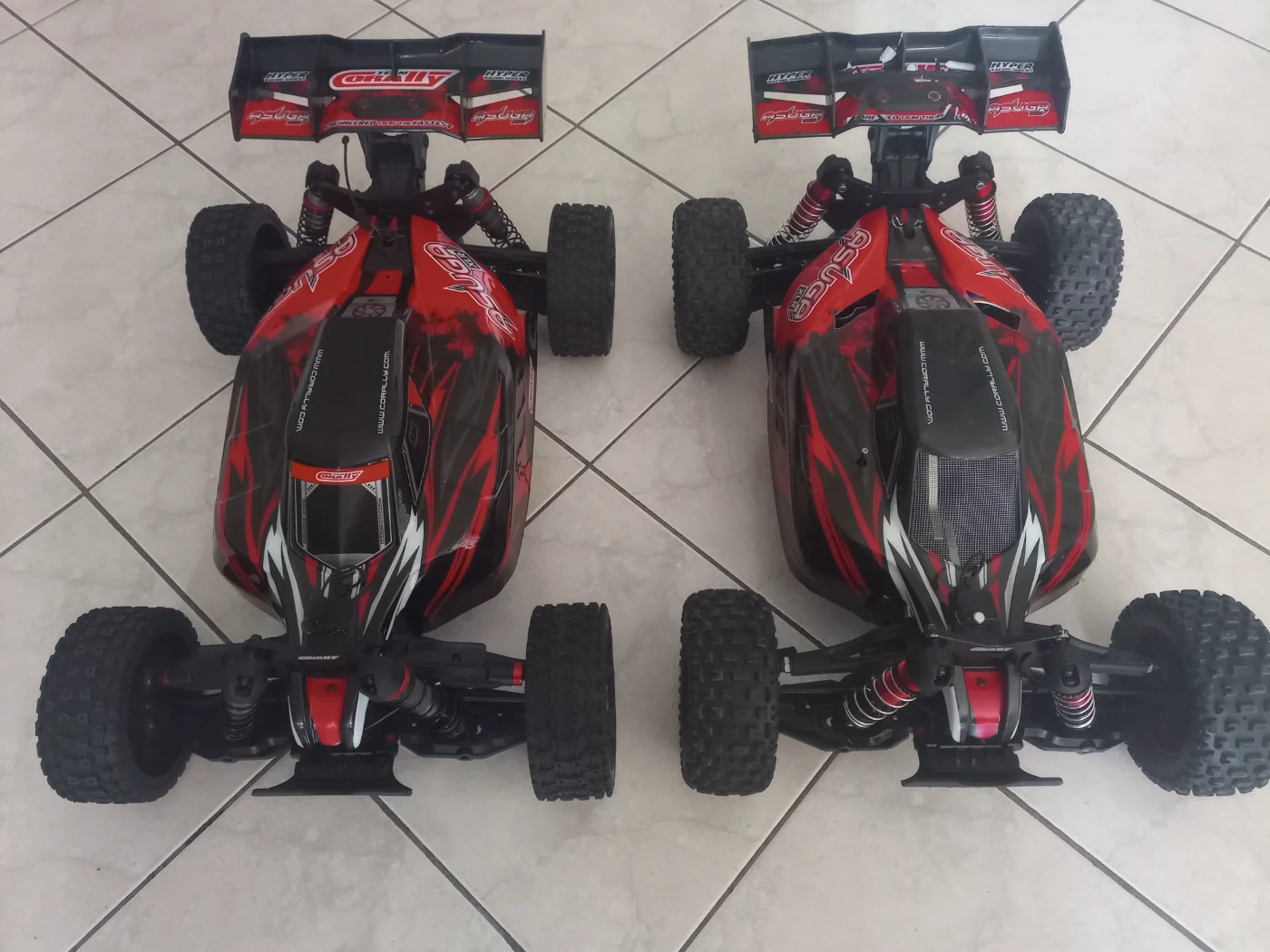

Asuga I found a nice deal!

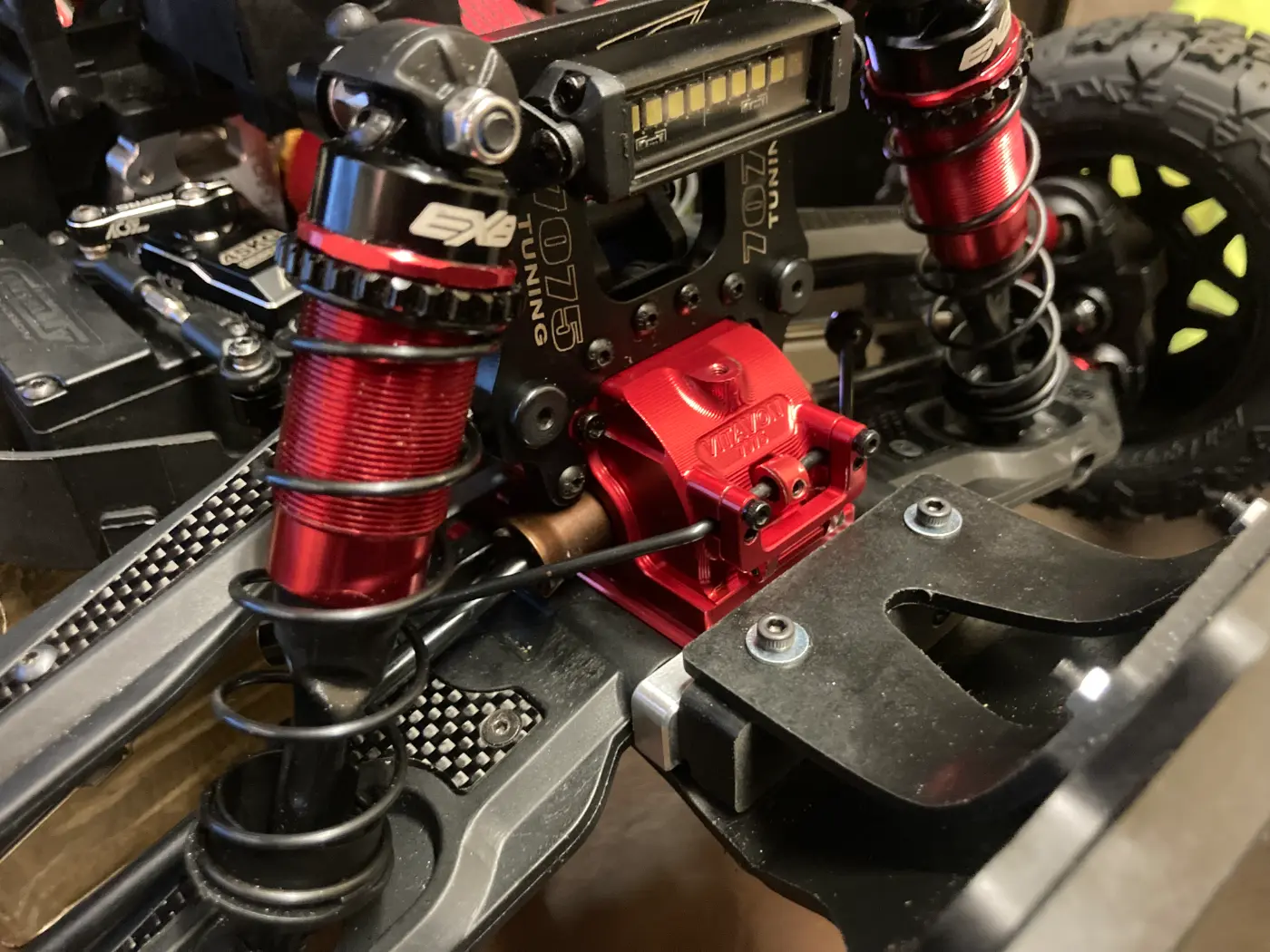

Your Asuga looks neet. Upgraded hinge pin holders, metal bulkheads, 7075 and carbon parts and all.
I did the metal bulkheads on my Arrmas, because i kept destroying diff gears.
I think it is caused by the amount of flex in the chassis. I may upgrade the chassis plates.
I don't have that problem with the TC's. They are fine as is. I did bend the front tower on the Muraco. The stock one is thin as paper. So i replaced that one with the TC 7075 tower.
I may order another set of the ADU braces and another TC metal diff mount, to put in this one. It looks like that's all i need to make it (my) bash proof.
I usually only do upgrades amd mods when parts fail, or when i expect them to fail.

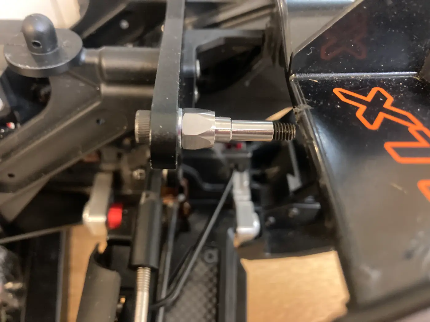

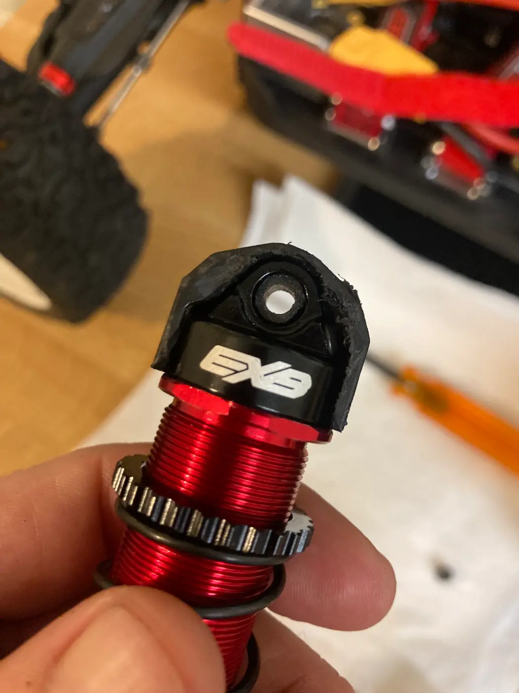

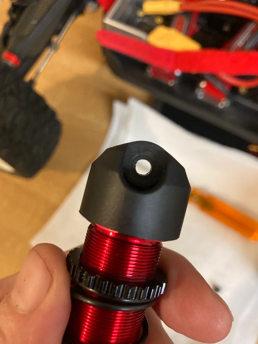

About the shock protectors. I like the TC ones better. The TC stand offs are fine with the 4mm bolt through the tower.
I broke an Arrma stand off and replaced two of them with TC. I drilled out the 3mm hole to fit them.

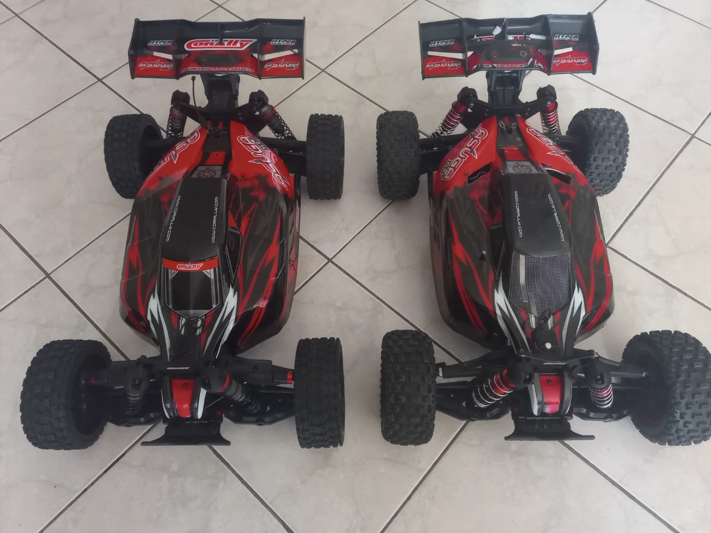

Ok. I think i just killed a Geensace 4s 8000mah with the Asuga on the current 4985 motor and 23/46 gearing. It got hot and won't balance charge in a normal time span anymore.
Also that battery didn't quite put out the usual power this last run. I did a second session with my second brand new Asuga with a same spec CNHL and the difference was quite noticeable. So much more power.
I am now convinced that gearing is too much. At least for running on 4s. There's no problem whatsoever on 6s.
I am going to order a couple of 21t 's
