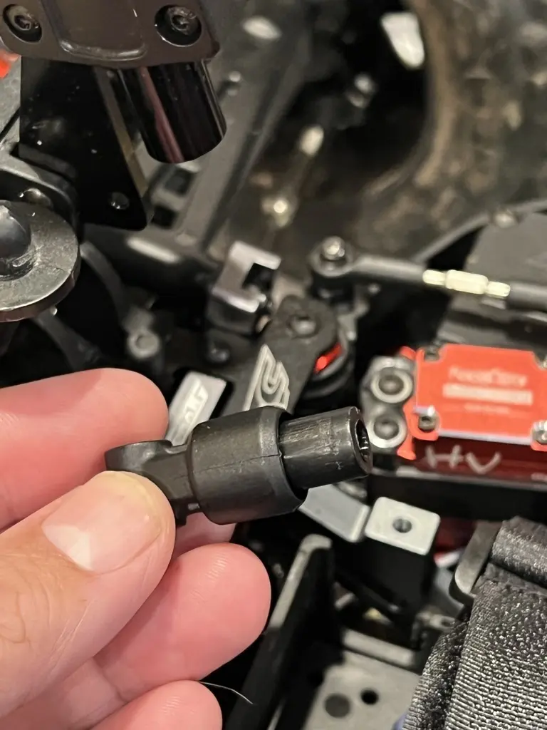

- As noted in RCP's unboxing video, the hexes don't have any serrations, just smooth on both sides. Swapped that out for serrated nuts.

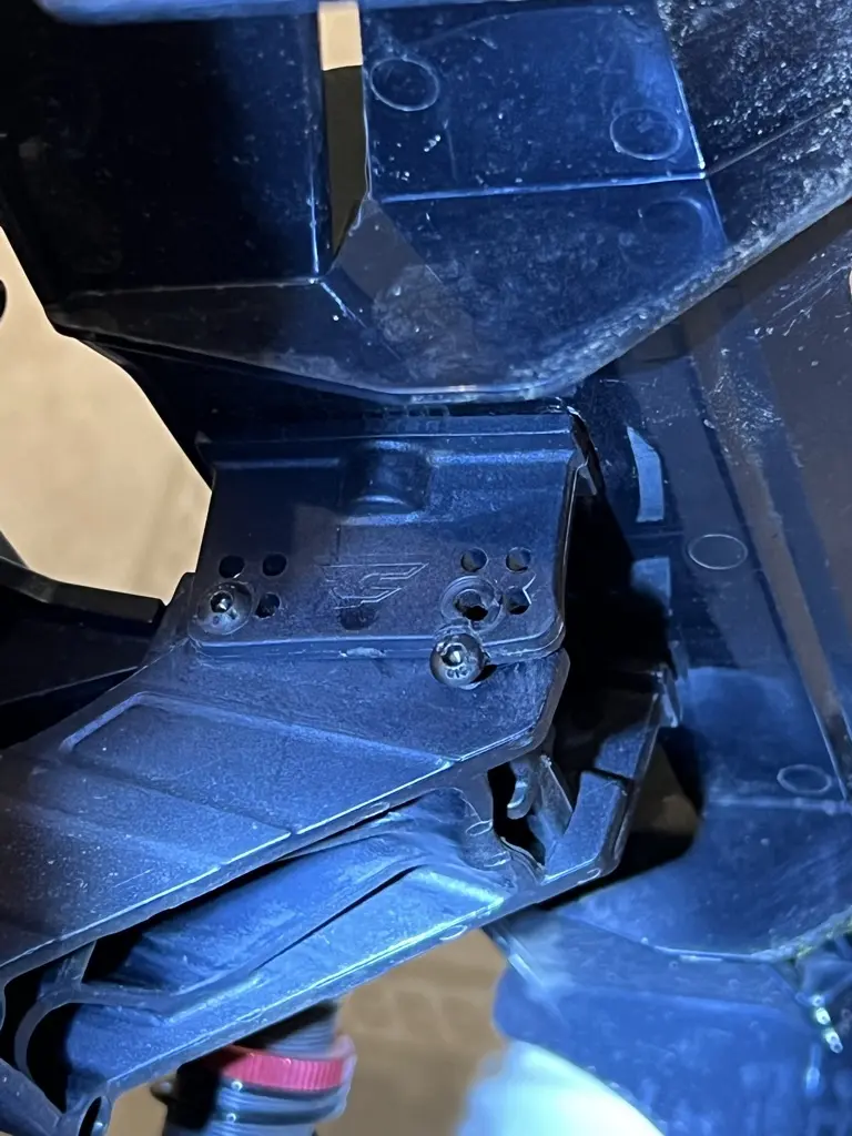

- The antenna tube doesn't have a way to retain it. Hopefully my hot glue fix doesn't look to getto.

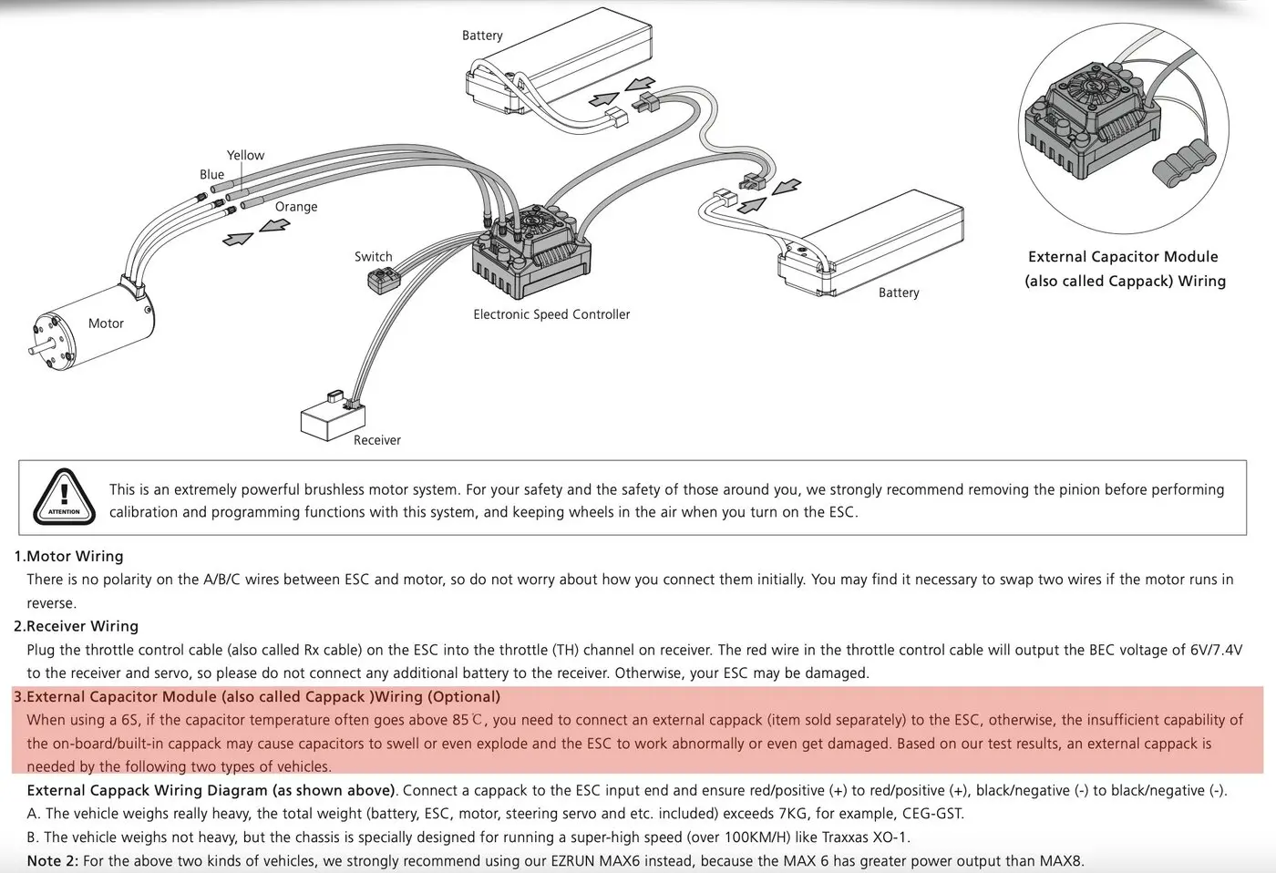

- This time the Torox 185 from Jenny's didn't have the cap pack installed. So I had to install that myself. Maybe a change in the kits?

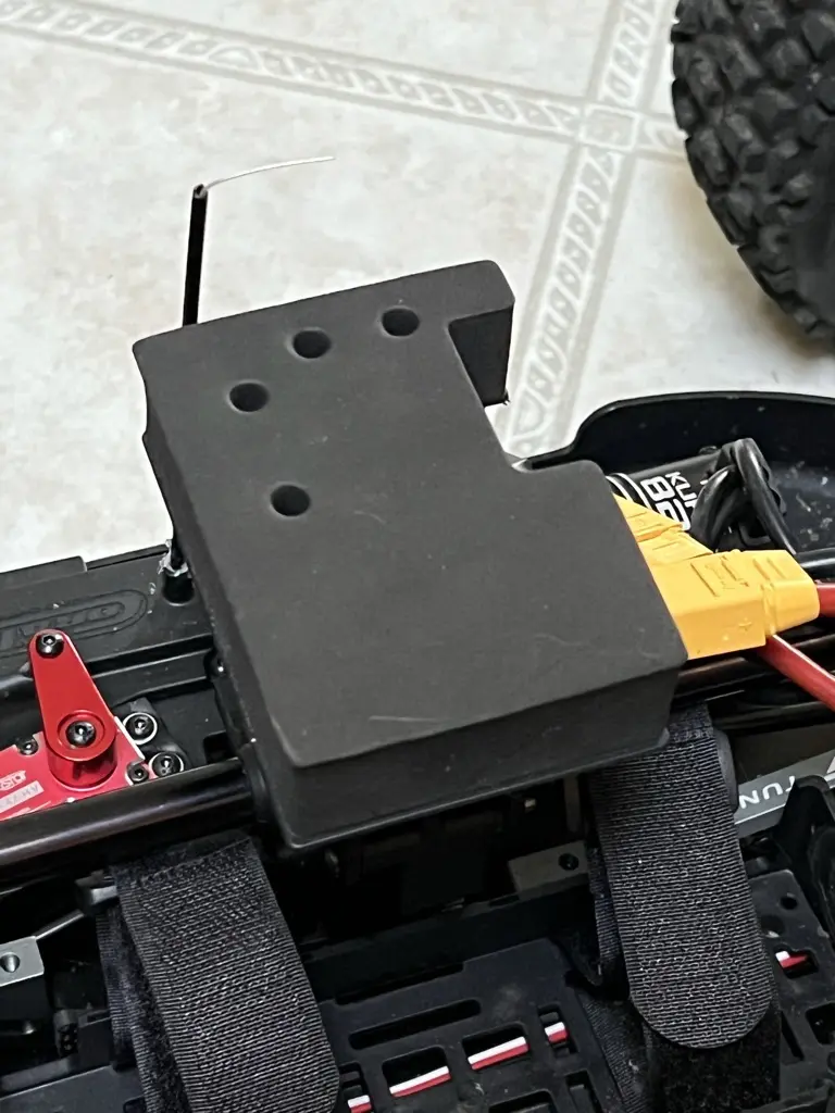

- The receiver box is a little on the small side. I put some thick (3/16th") servo tape to give it padding from jumps only to find that I couldn't get the lid to close. (and that is with the smaller of my receiver options.) I had to change to very thin servo tape.

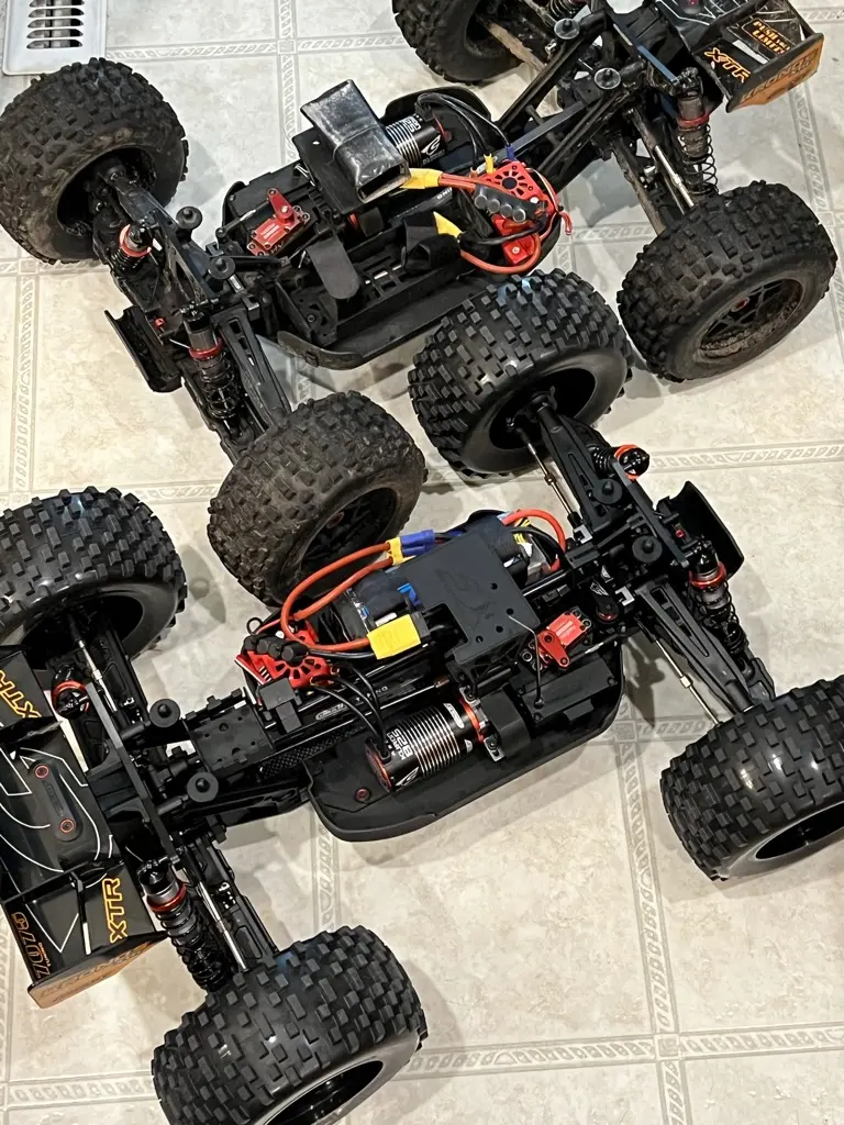

Hurricane
V1 top, V2 bottom

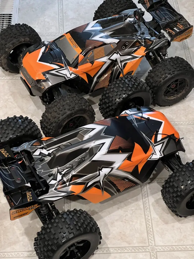

Hurricane
V1 top, V2 bottom
