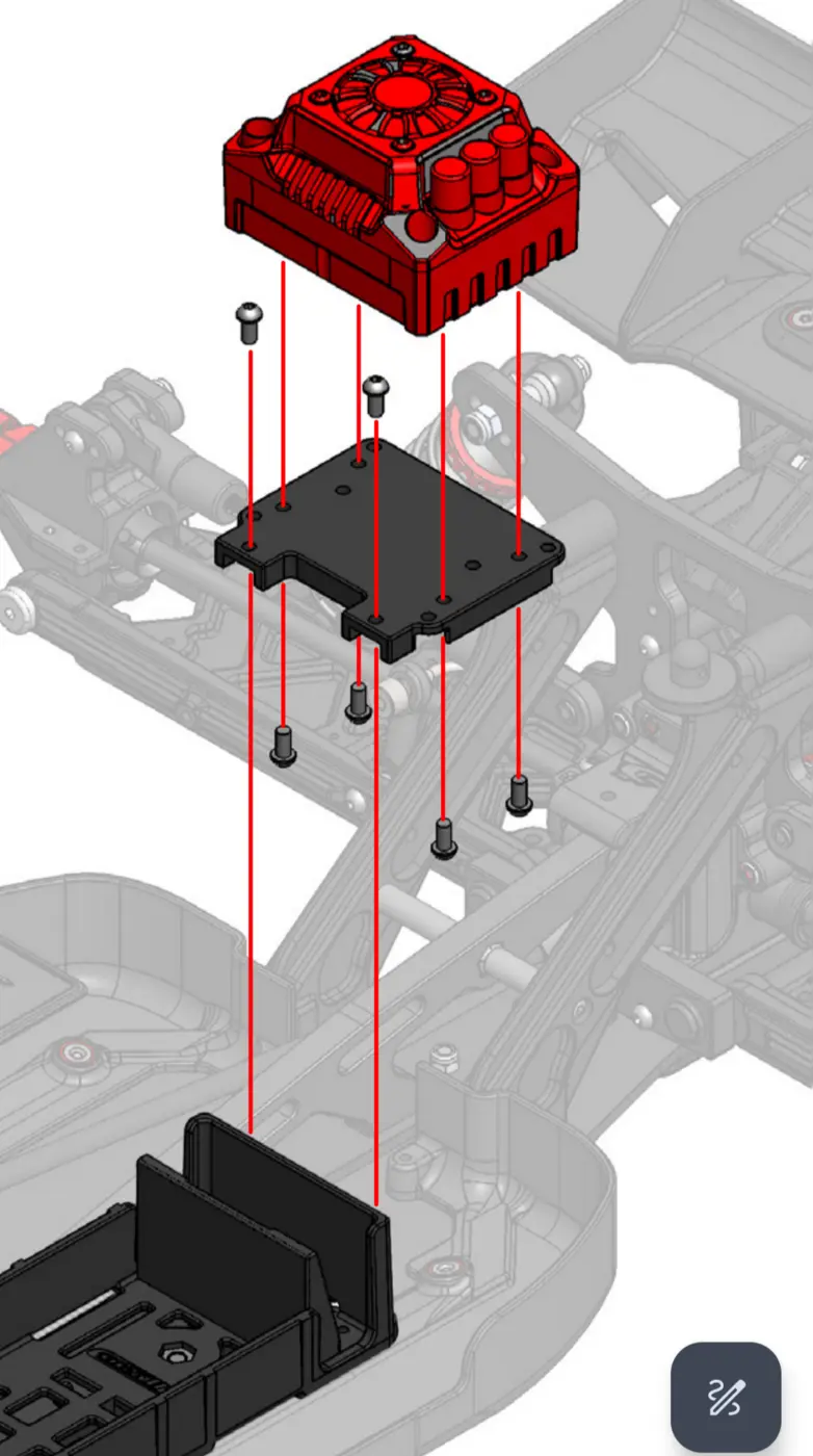

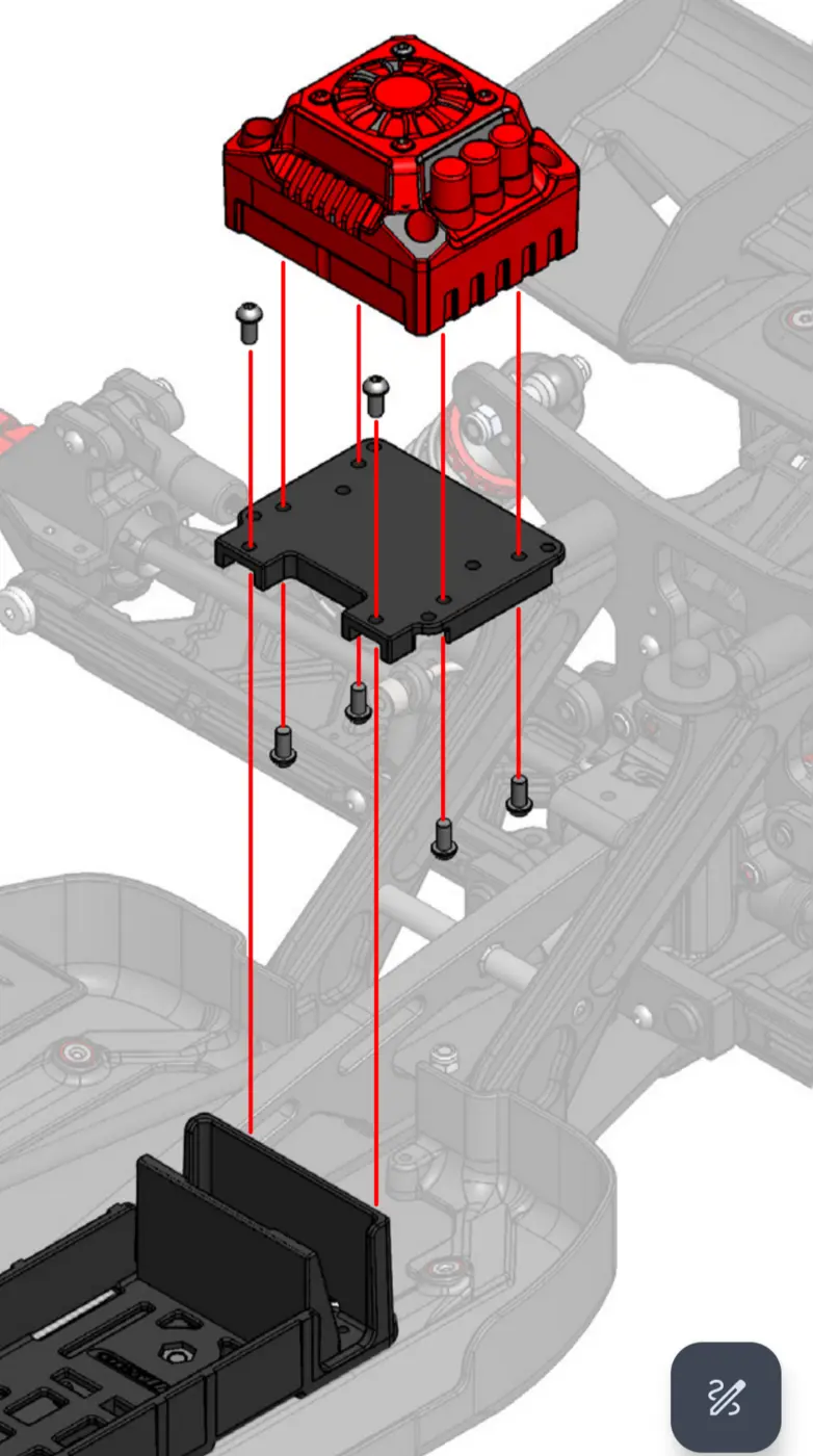

Guys I would like to remove the esc torox 185 from my shogun, I don't figured if it is glued or fixed by screws... Moreover I tried to remove the 3 cable but they are very very difficult to disconnect. Could you give me some help?
Thank you View attachment 7290
Like this:
However, I recommend that you use 3M dual lock for mounting your ESC to the plastic mount. Being on a layer of dual lock aids isolating the ESC from vibrations. As a bonus, you can remove and mount it to different rigs very easily.
As for the motor wires into the ESC - they're tight - very tight, so they need twisting/pulling and bit by bit and they'll edge out.
Mind your knuckles when they do suddenly give up! 😅

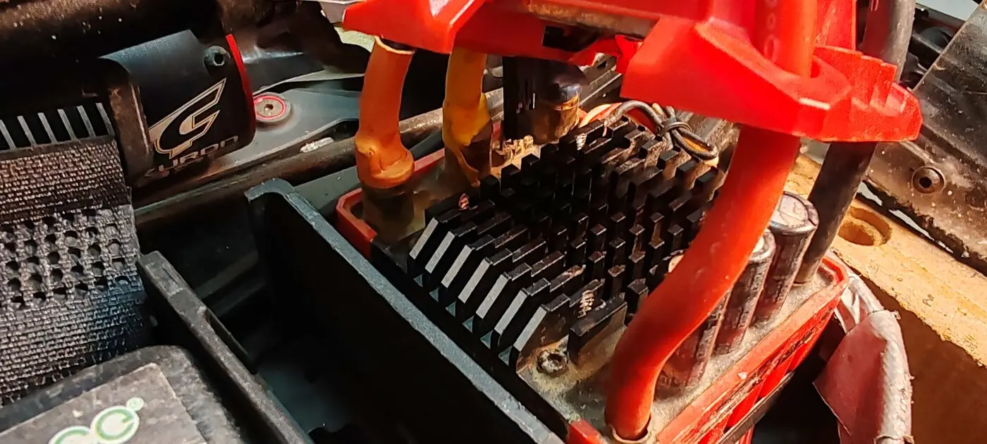

Like this:

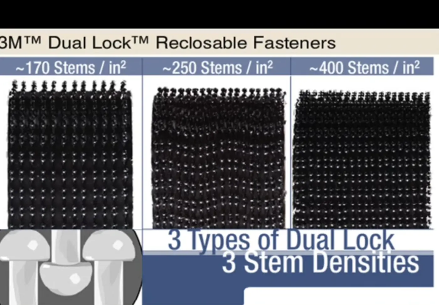

Yes, it will. You can literally pick the rig up by the ESC using 250. Using 400, you'll need to pry it off.
It's effectively VHB adhesive, with Dual Lock 'velcro'. Unlike velcro, which consists of 'Hook' and 'Loop', dual lock interlocks with itself.
In other words, you don't have put one type onto your chassis and the opposite type on to your ESC.
I use dual lock for my drones too.
There are 3 lock strengths, based on the stem count. If it worries you - pick the highest grip dual lock.

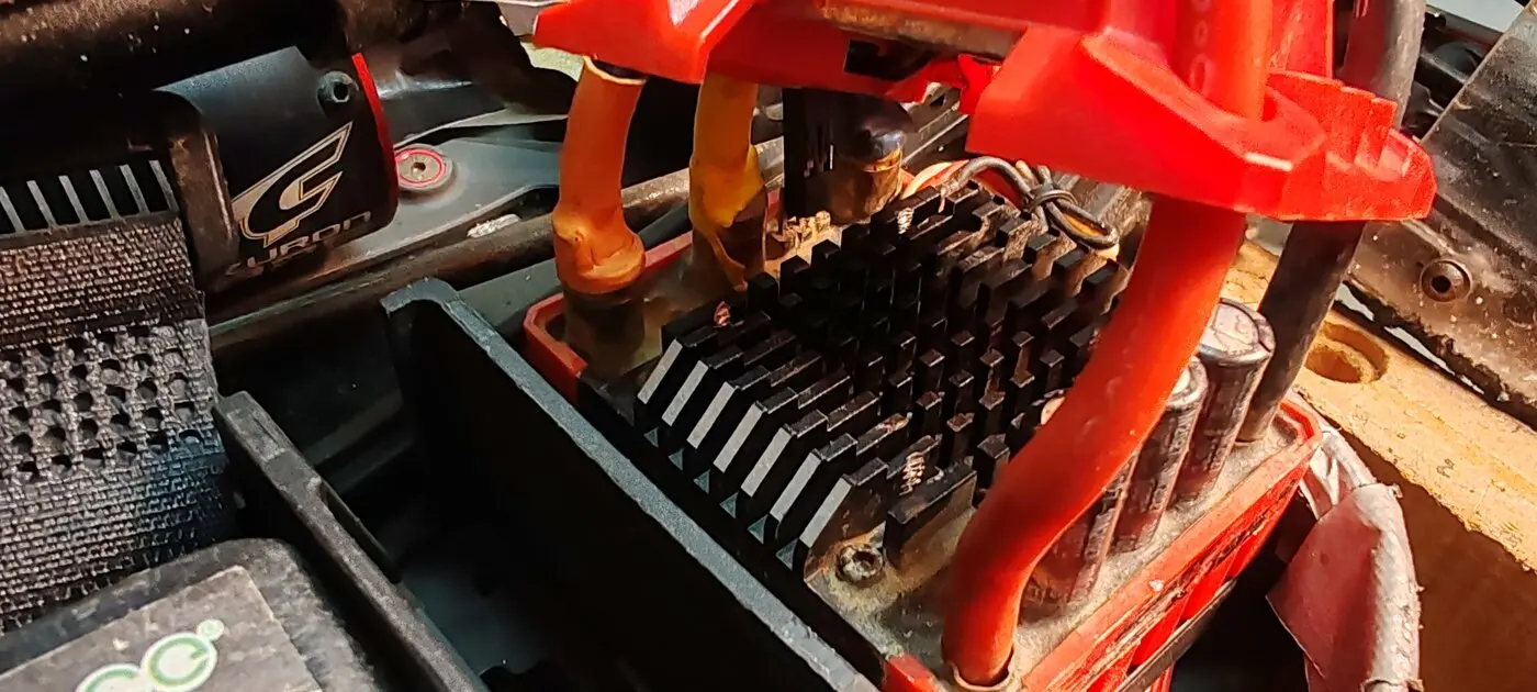

Every pit box needs this. It makes for super clean installs.
Batteries, ESC, Switch, GPS - all can be held in with this stuff. 😎
